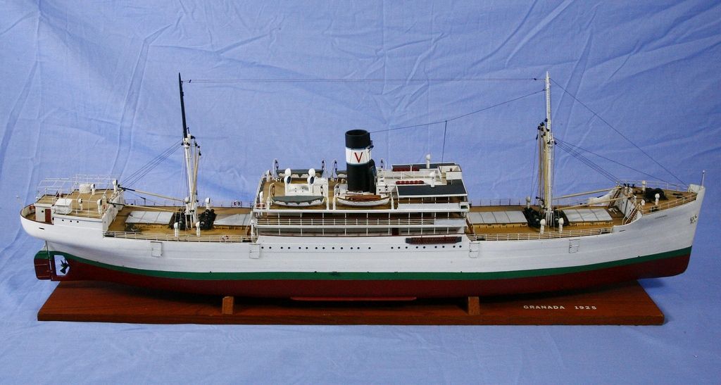

                  Athlone Castle and Capetown Castle had a pronounced sheer extending to the superstructure although it levelled off quite a bit aft of the bridge. There are some good online images.
                  My model of the fruit ship Granada of 1925 is shown below. In this case I used a bit of modeller's licence. The hull has a fore and aft sheer but the central superstructure is essentially flat but it still looks pretty much OK.

                    Just picking up on Colin's point, I think it can be possible to run flat decks and introduce an 'optical shear' with gunwhales, deck angles and other fittings to give a good approximation of the real thing.
                    I plan to do this on the Pilot Cutter as a simplification. However, mine's 'semi-scale'. Exact scale may call for something closer to reality.
