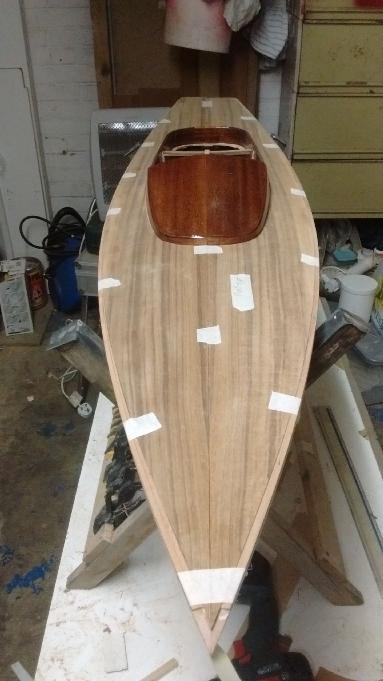

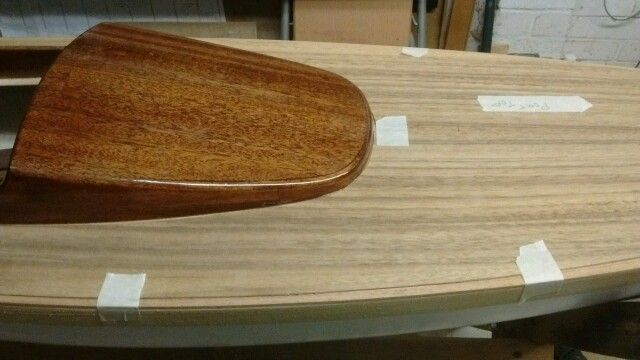

                              Hi Martin don't think it looks to bad do you ?? Once ive cut the teak into planks it going to look so good …markimg_20160217_190456551.jpgimg_20160217_190627002-640x360.jpg

                                Colourwise, no, but I thought you were planking it?

                                  Hi Martin I'm cutting that into planking strips obviously not full length and with a gap the width of my pins …mark

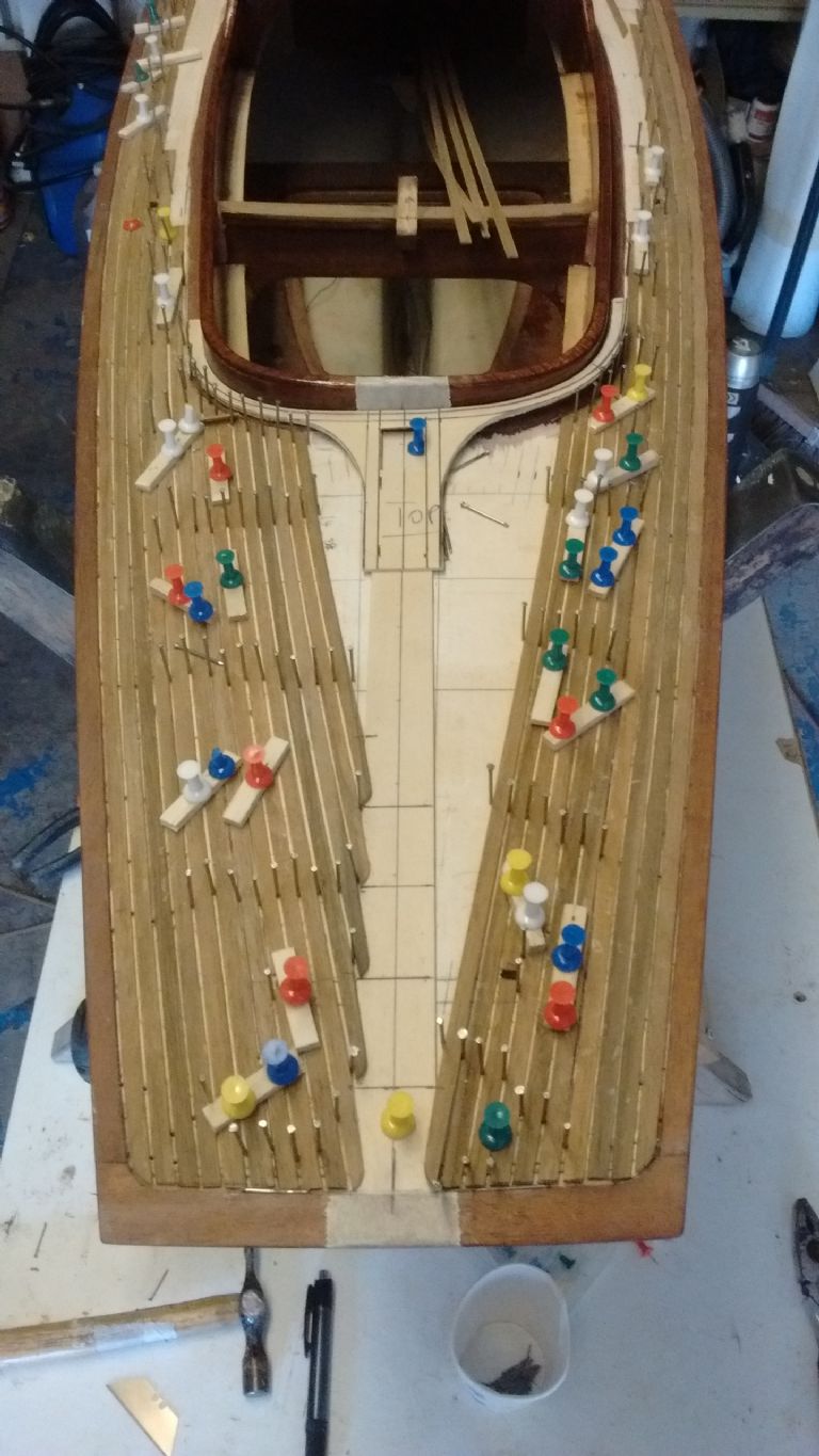

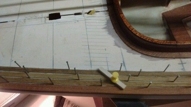

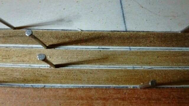

                                          img_20160226_183044132-640x360.jpgHi all I've got round to start decking my boat now I've cut all the planks to 5mm and had a dry run but now I've noticed they will have put back in my sanding jig and img_20160226_183203402-640x360.jpgsand down to 4mm so I'm able to have the correct amount both sides (18)

                                            Hi all I've been doing some more planking this weekend still not finished ! I've yet to cut the king plank noggins I'm laying onto 1.5 mm ply to make the pattern then I can cut for both sides img_20160306_122254612.jpg

                                              Oh, I'd have cut the king plank with joggles, then cut the planking to fit. You're doing it tother way round.

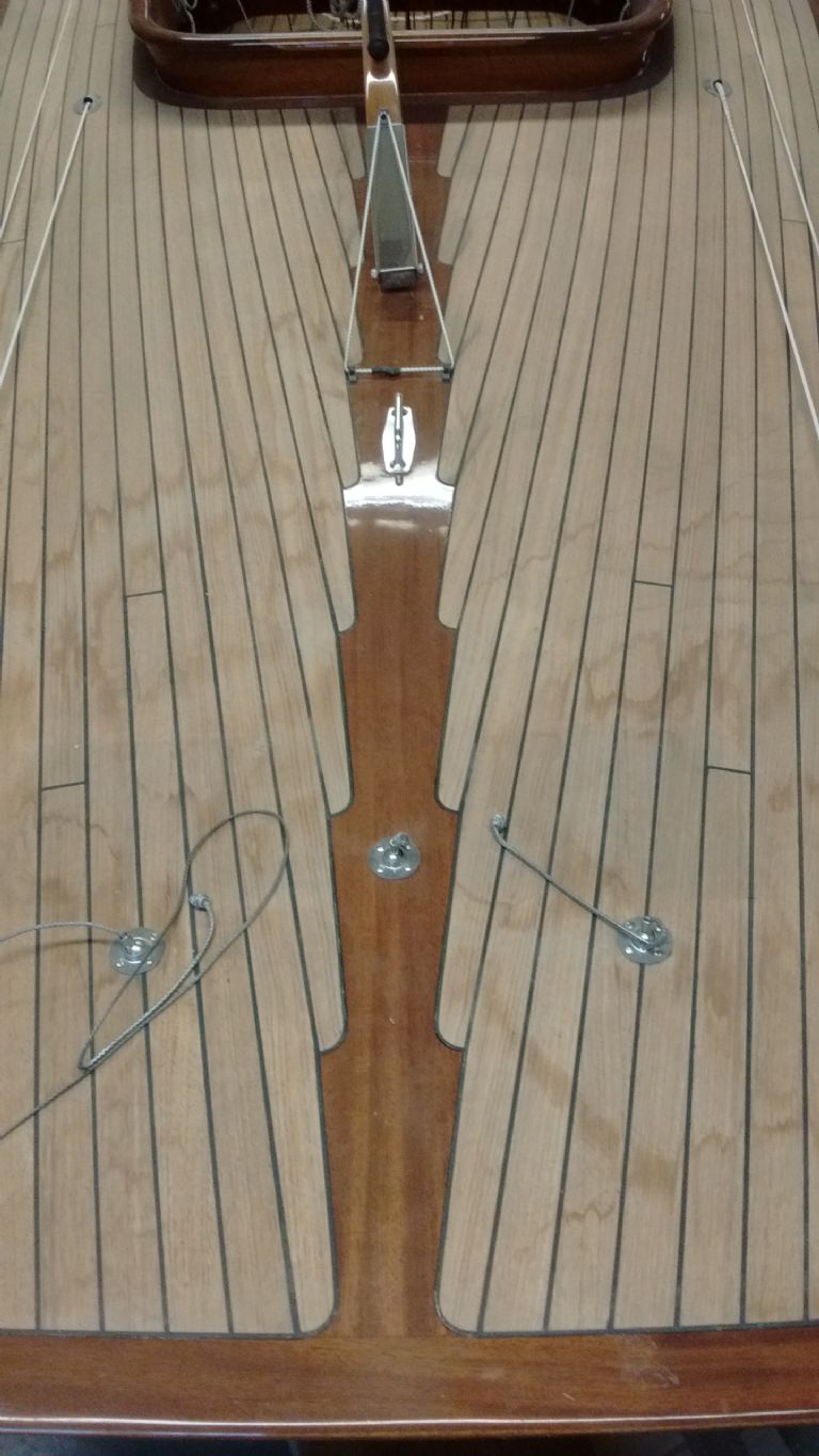

                                                Hi Martin got any upto date pics of your boat yet ? anyway this is what I'm aiming for on mine …….markimg_20151103_153745939.jpg

                                                  Very nice, a real yacht deck.
