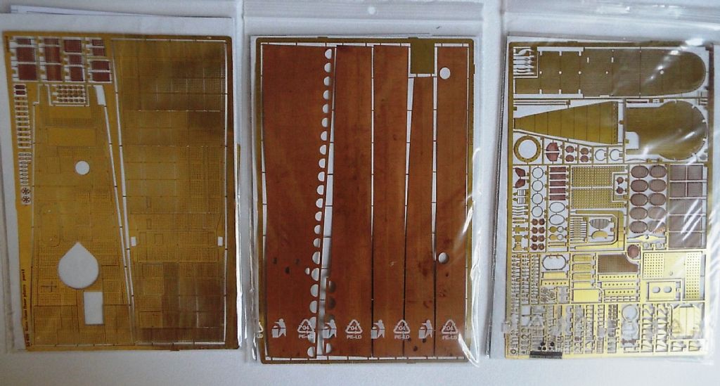

                    I have a pdf of a review of Eduard 'Big Ed' Gato detail set and a set of jpegs for a full RC conversion article. If you are interested I can email them to you.
                    Martyn

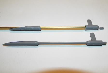

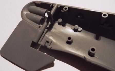

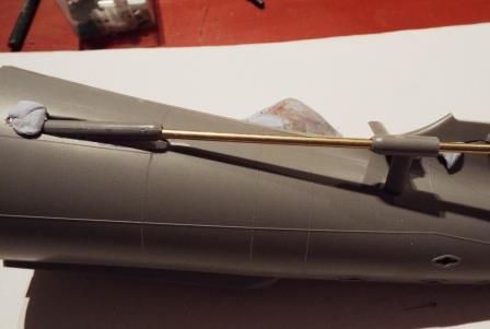

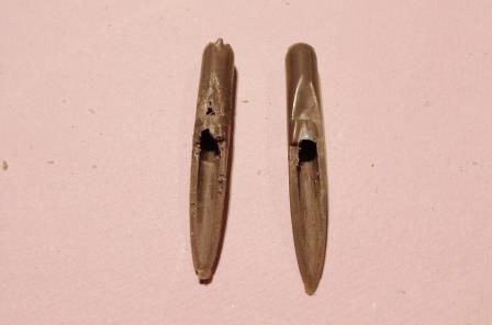

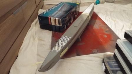

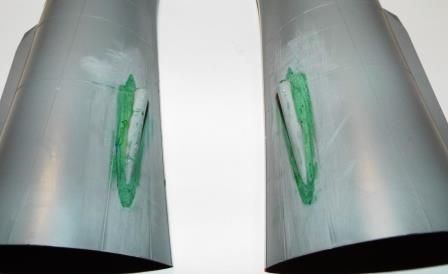

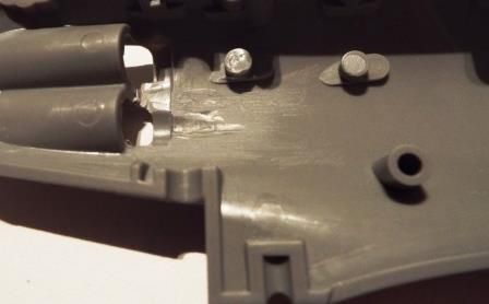

                                      Made a start on the prop/shaft mods, and nearly melted the shaft tunnels because I had the drill speed to high.
                                      Cut off the kit inner mountings for the rudder positioning, and ground back some of the surface to make clearance for rudder movement.
                                      Waiting patiently for the December edition of 'MB'

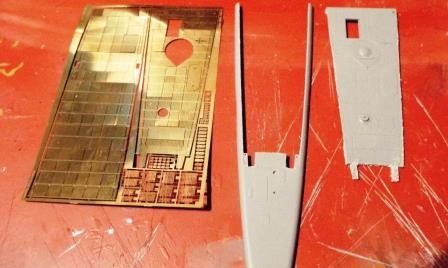

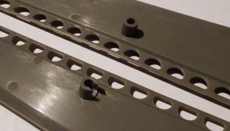

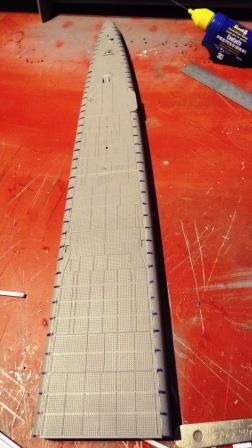

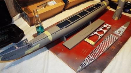

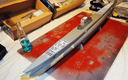

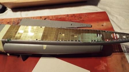

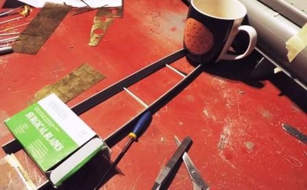

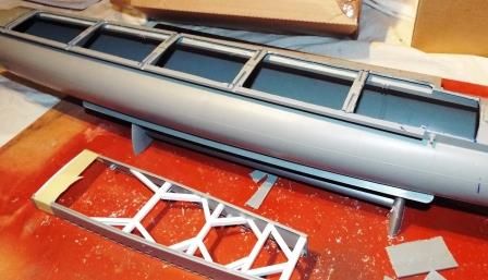

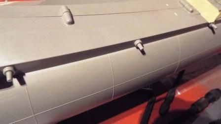

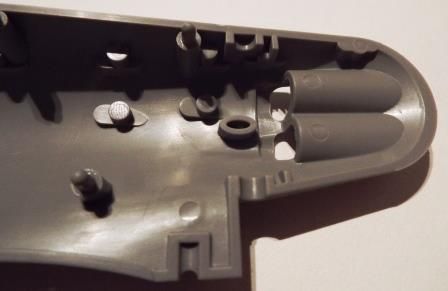

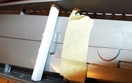

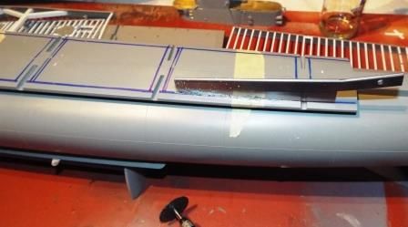

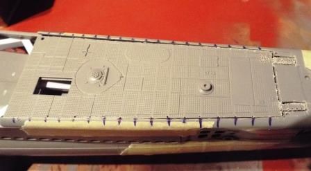

                                        Although I have purchased all the Eduard PE sets, I have realised that I no longer have the finger/eye dexterity required for much of it. I will stick to the larger bits that I can still seesmiley!
                                        I have made a start on the side plates & grated decking areas. The side plates have been slightly modified so that I can use the pins and sockets to be able to make the deck/side plate area removable. The side plates required some strengthening if I want them to be regularly handled.
                                        Having attempted (and Failed) to drill out the deck grating holes neatly, I made the decision to use the Eduard decking PE. This required the kit deck to be removed, & ribs installed to support the PE. Some of the moulded hatches/fittings will have to be separated from the kit decking and fitted to the PE in the appropriate places.

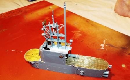

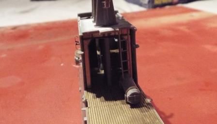

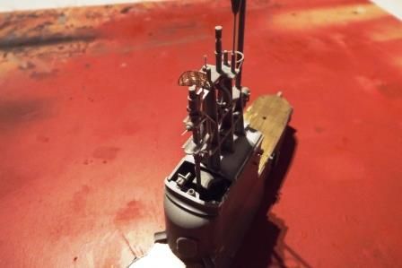

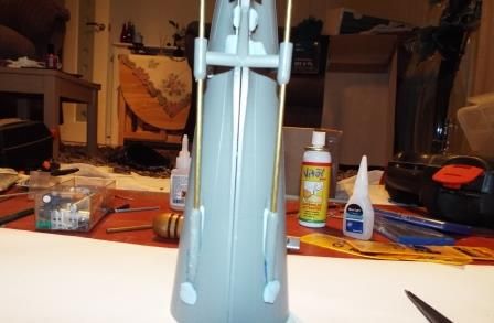

                                        Also got a little done to the Conning Tower/Bridge, and found the pre-formed tiny wire hand-rails a bonus, as I don't think I would have managed them otherwise
                                        Side Plate Pegs
                                        Modified Side Plates
                                        Side Plates Click Fit
                                        Strengthening Side Plates
                                        PE Support Ribs
                                        Front Deck removed
                                        Front Deck Marking For Ribs.
                                        Rear Deck marking For Ribs
                                        Rear Decking Removed
                                        Rear Deck  First Ribs
                                        CT Build
                                        CT Build
                                        CT Build

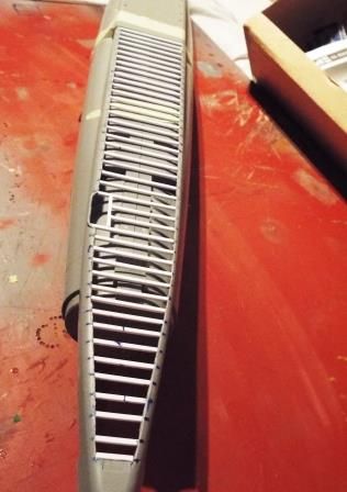

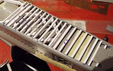

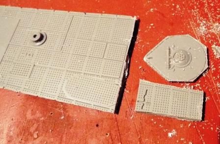

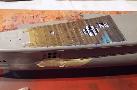

                                          Stern deck area ribbing, temporary PE fitment and one of the hatches removed from kit decking.
                                          Just needs tidying up before insertion into/onto the PE decking.
                                          Stern PE Support Ribs
                                          PE Support Ribs
                                          Temporary PE Fit
                                          Temporary PE Fit
                                          Hatches Removed From Kit Decking.

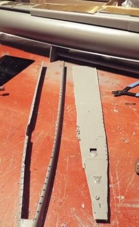

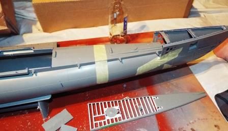

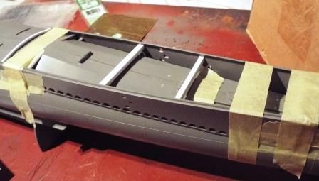

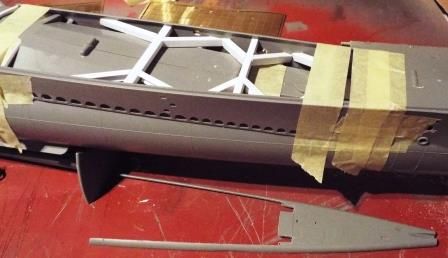

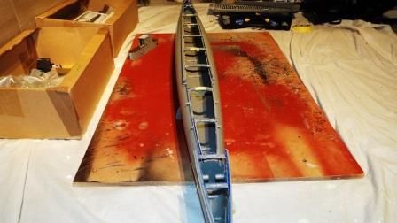

                                            Made a start on cutting out hull access areas.
                                            Gregg
                                            #54320
                                            ojays
                                              @ojays
                                              Last of the hull areas removed, being careful to retain the hull sides connecting pins.
                                              access cut out 4 (2).

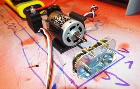

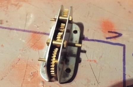

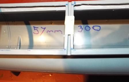

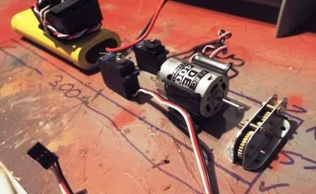

                                                Mocking up for the WTC, motor and 1 into 2 gearbox.
                                                Mocking Up WTC
                                                Mocking Up WTC
                                                Marking Out WTC
                                                1 into 2 Gearbox
                                                Gregg

                                                  Going well there Gregg. Not keen on gearboxes myself,you are not going to need the revs that a speed400 provides, likely, a pair of 385 would be my choice; subs need much less power underwater than equivalent surface craft. remind me what size your props are please? Ashley
                                                  #54888
                                                  ojays
                                                    @ojays
                                                    Hi Ashley, thanks for your input as I am always open to suggestions from someone with knowledge of the a genre that is new to me.
                                                    My past experiences were with R/C aircraft, so I am assuming that keeping weight down and finding the centre of balance (CG) is important. Plus keeping the electrical gubbins to the minimum, to keep the operating temperature in the WTC down.
                                                    The props are 32mm, and when I took the label off the motor it has 380 imprinted into the can surface!!!
                                                    I am trying to use as much equipment as I have in my stash, without buying too much in. Funds are at an all time low at the moment.
                                                    The gearbox is just an experiment at the moment, as I only want to run with one motor if possible.
                                                    I will only be building as a surface runner as not confident in my abilities, and all my radio gear is 2.4GHz which apparently doesn't work underwater.
                                                    Gregg
