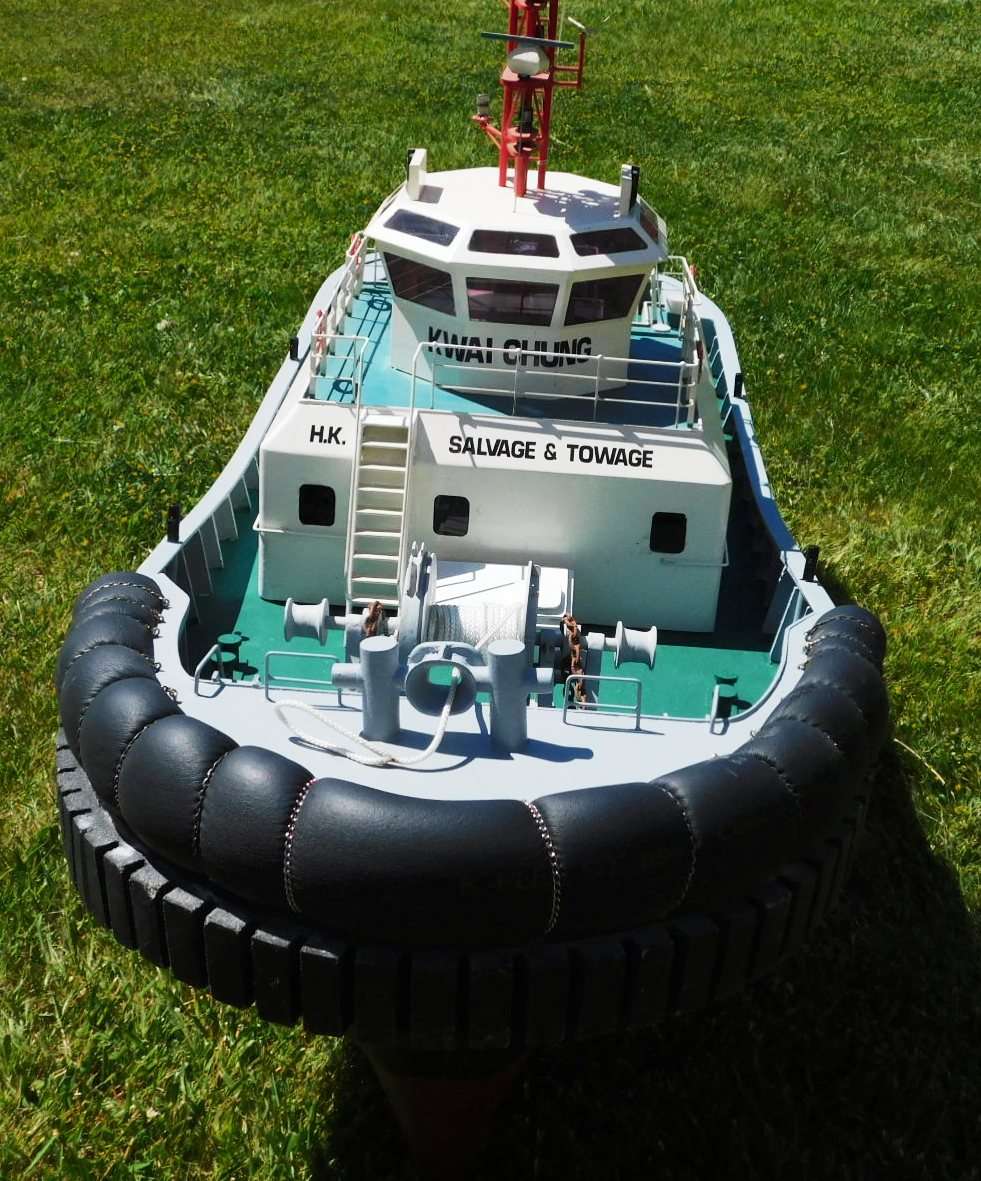

  • #124610

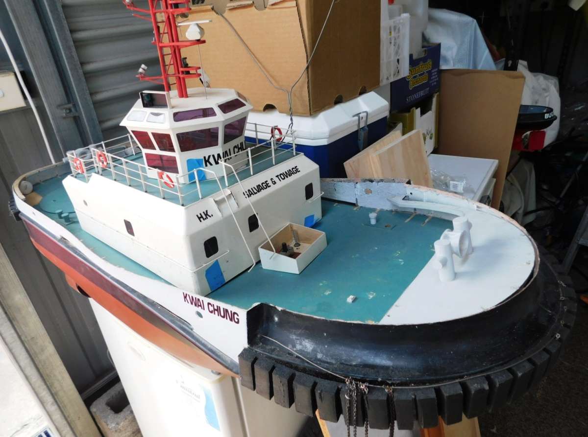

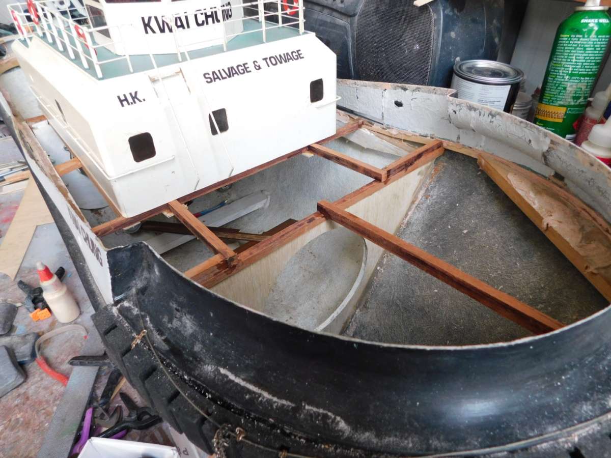

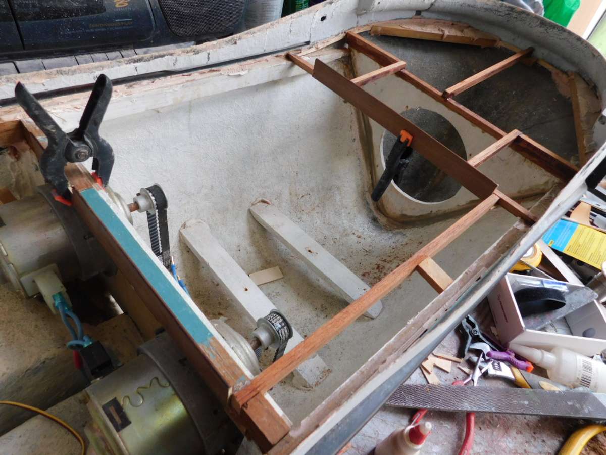

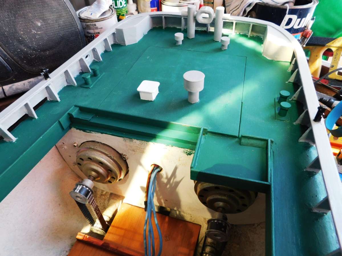

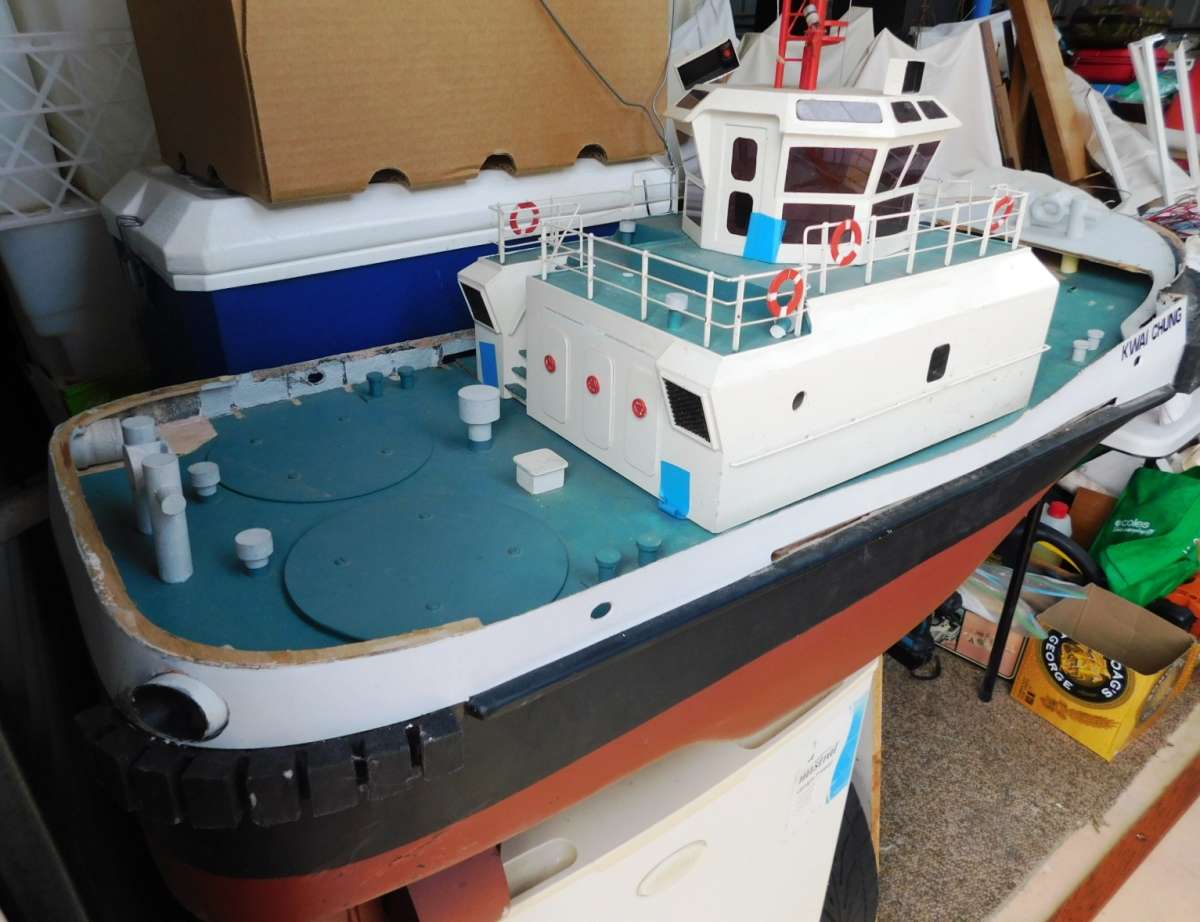

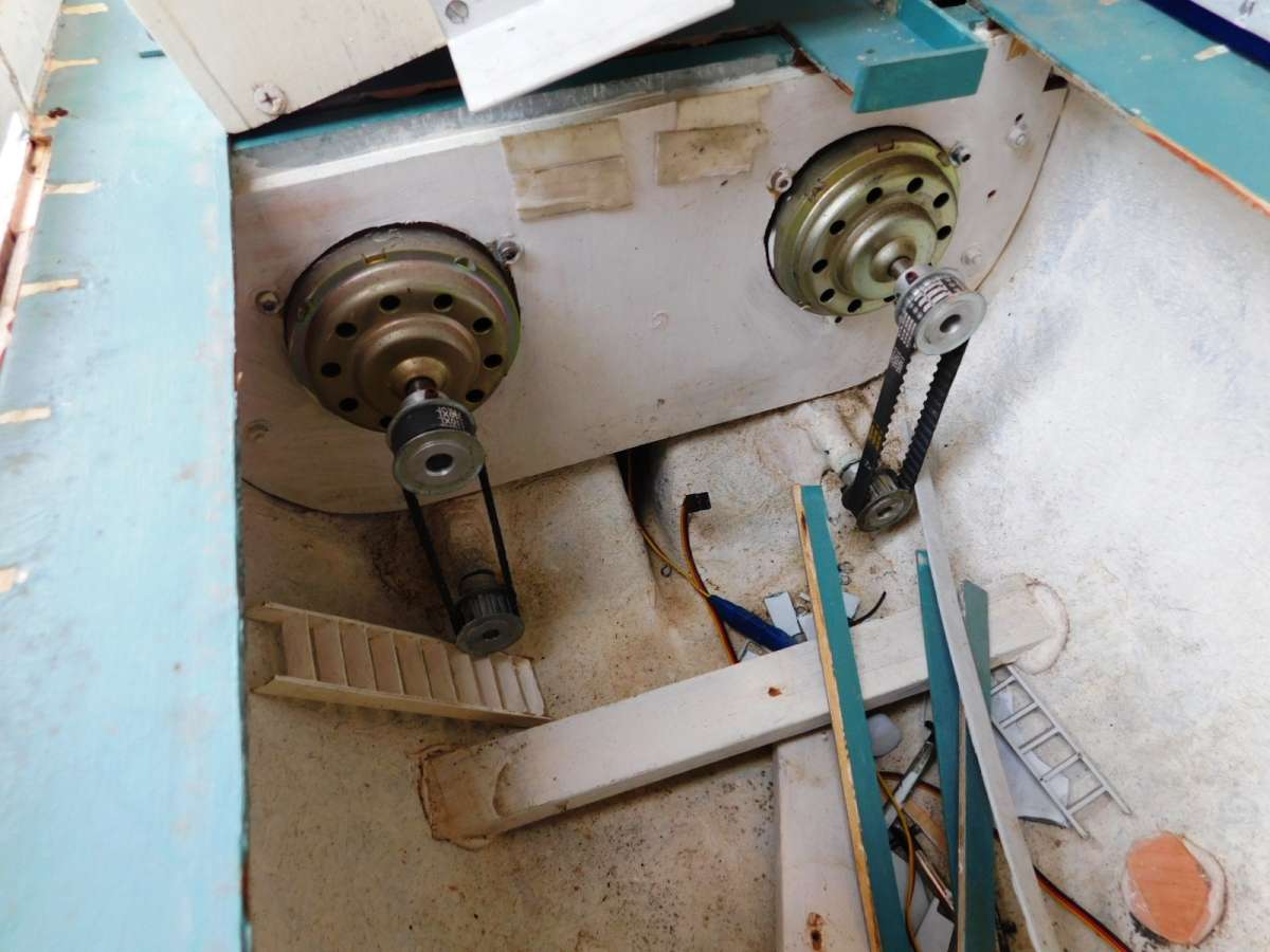

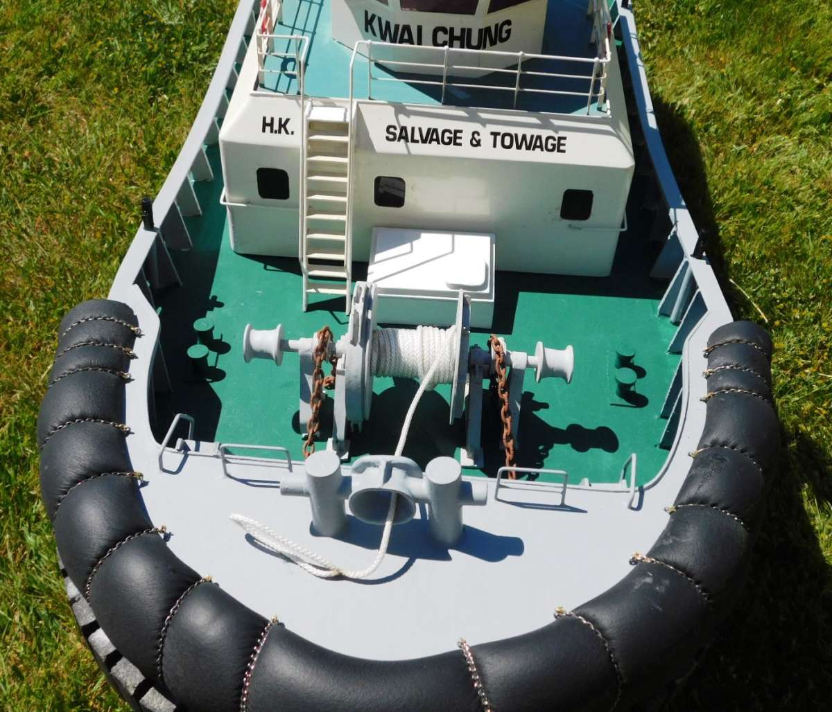

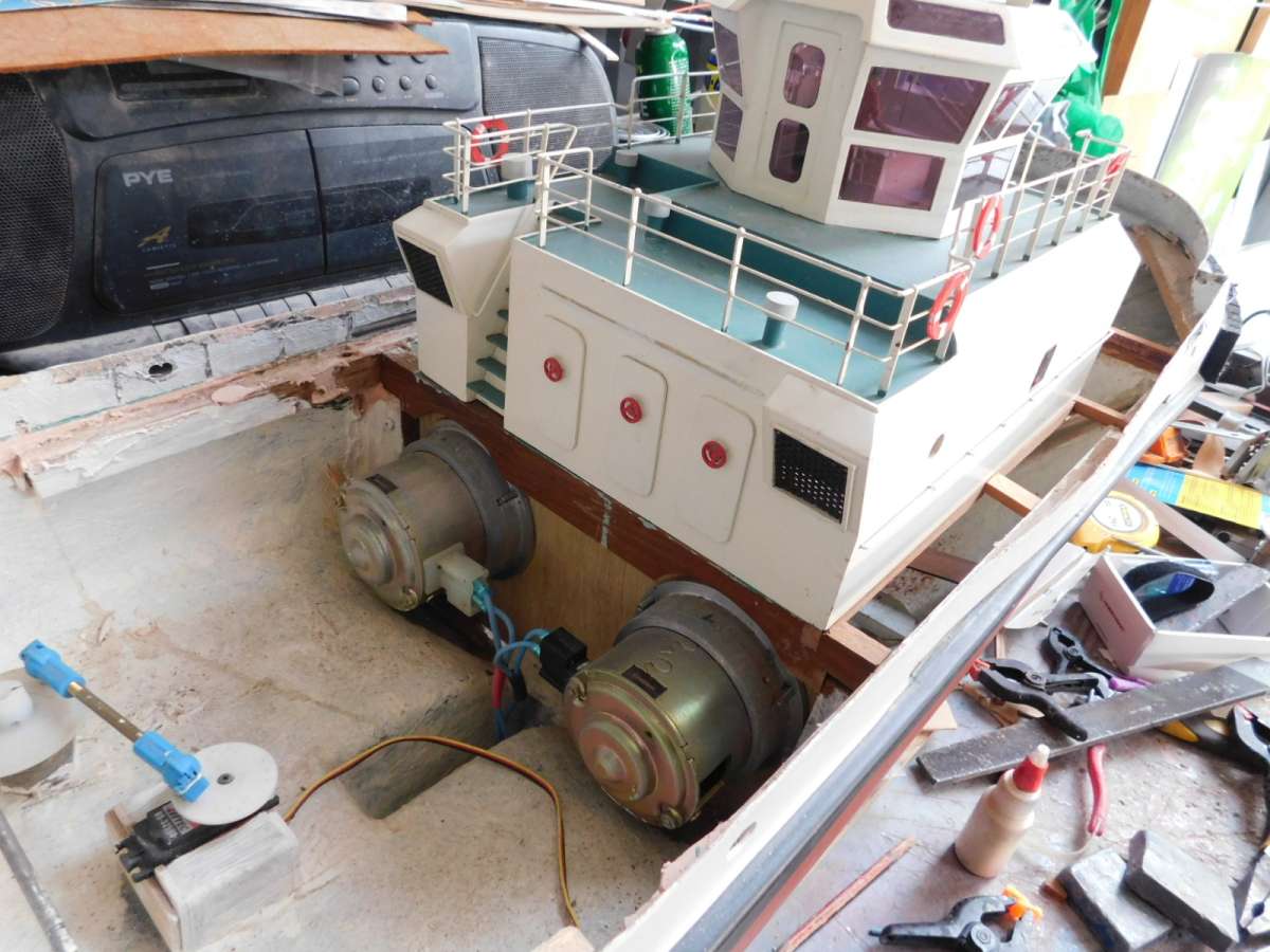

      Hi All
      One of our club members is more of a collector of model boats !!!
      So he ask me to repair a deceased members Cervia tug boat.
      So paid me (not a lot) to repair it .
      I charged him for my costs, but no time.

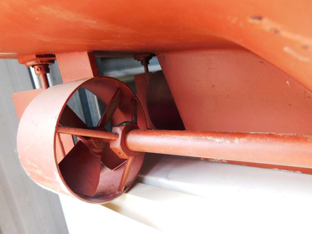

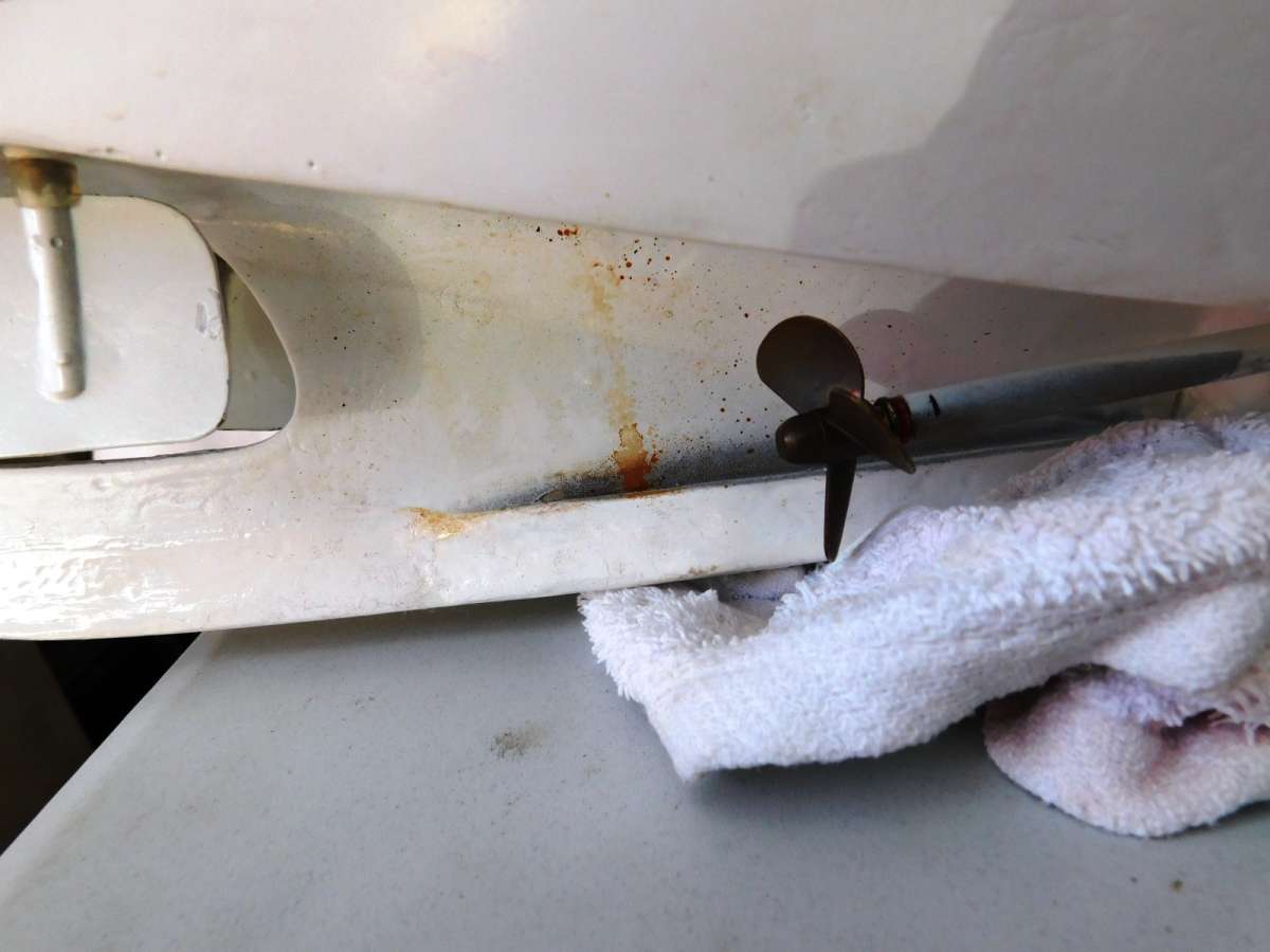

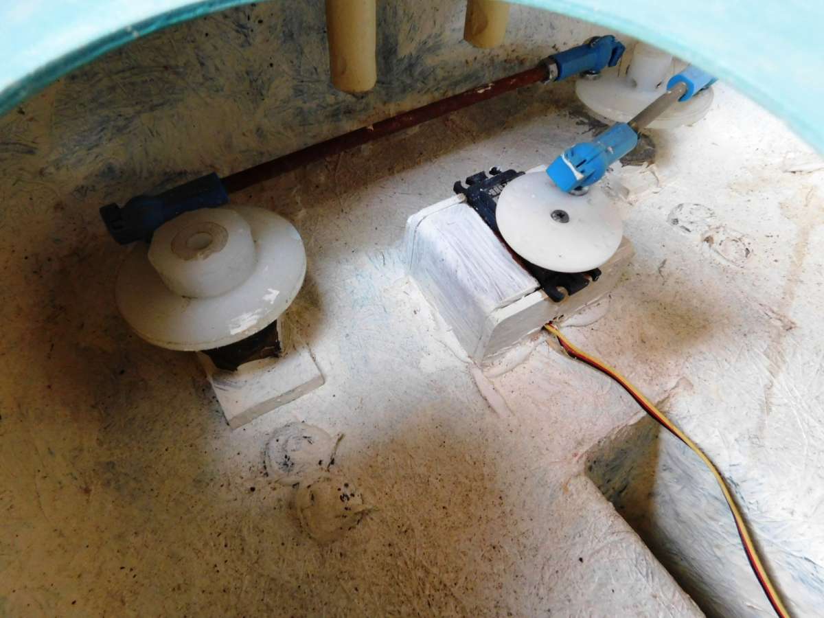

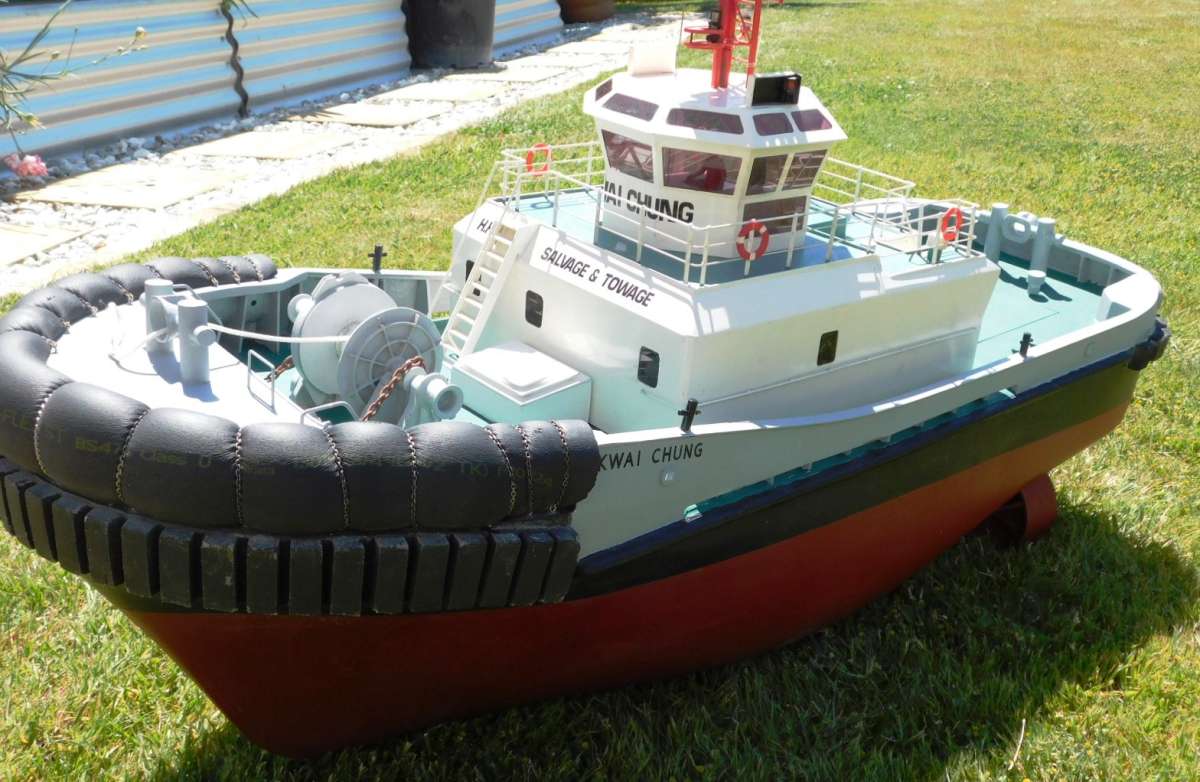

      So some months later, he arrives with a dam BIG tug boat.
      Half pulled apart, no deck frames, it looked like it was at some time ago a kit boat with a fibreglass hull.
      It’s a HONG KONG TUG ( KWAI-CHUNG)with twin large brush motors with 70mm 4 blade props in nozzles.
      The belt drives were totally past using .
      The two frames in the boat did not get to deck level.
      So reverse designing frames was interesting !!!!!!
      The access to the rudder and servo was totally in the wrong spot, so another mess to fix !!!
      I did find some pictures of the real boat and some other of the same company.
      HarryKC 1KC 8KC 2KC 3KC 4KC 5KC 6KC 7

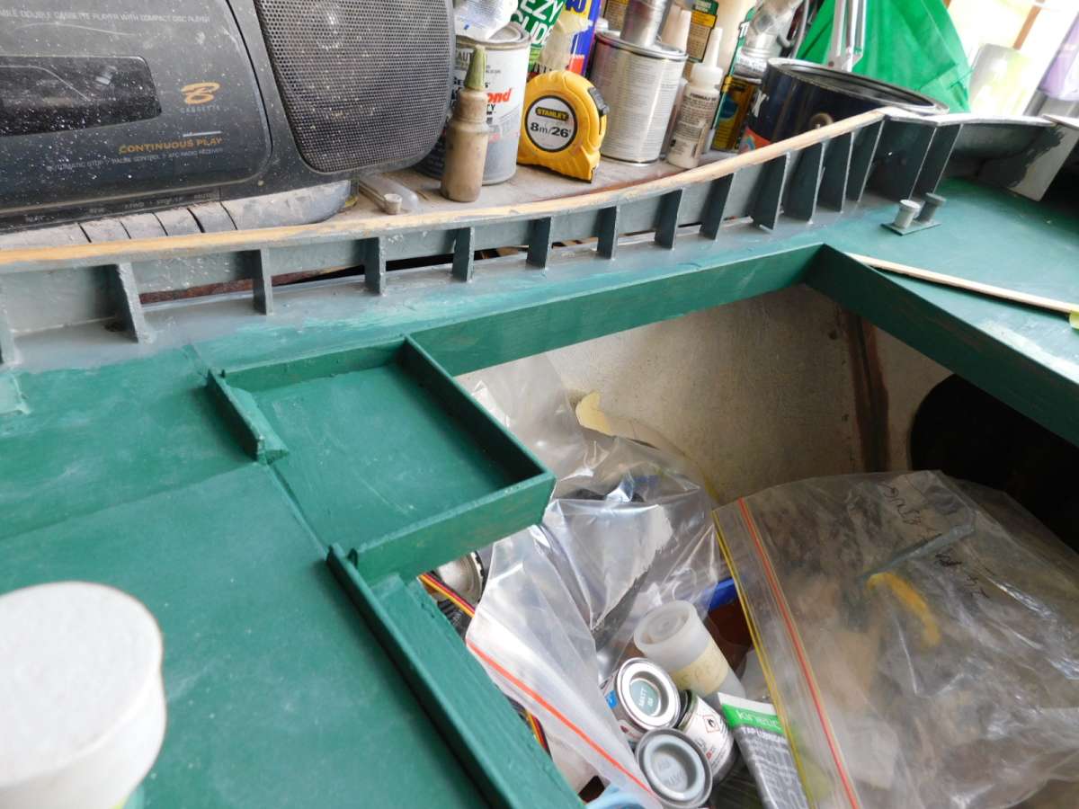

      #124611

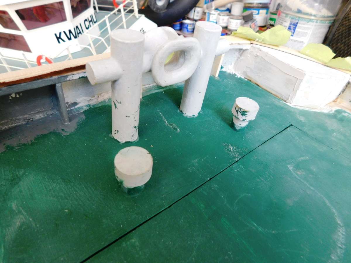

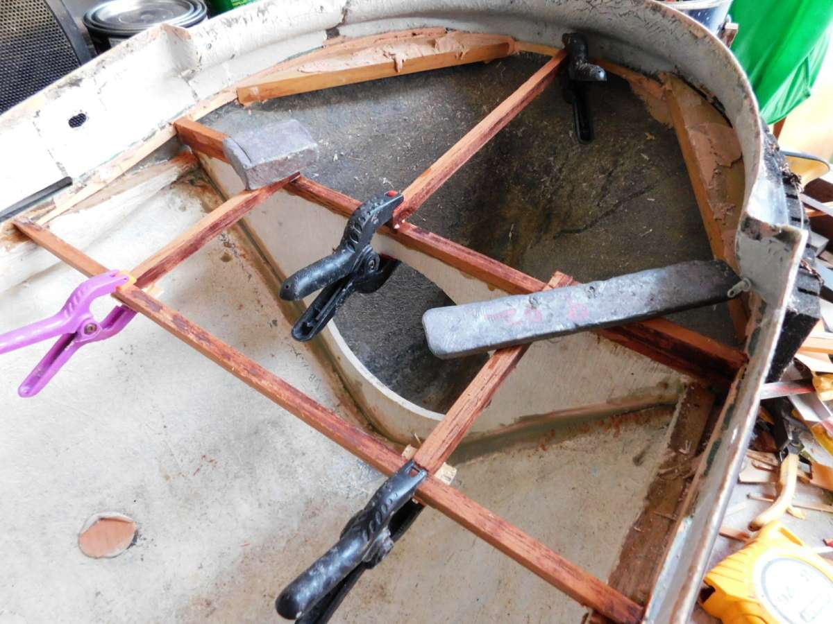

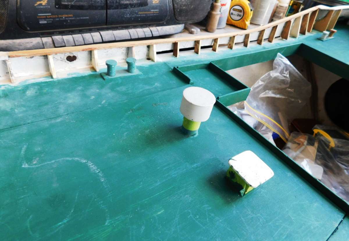

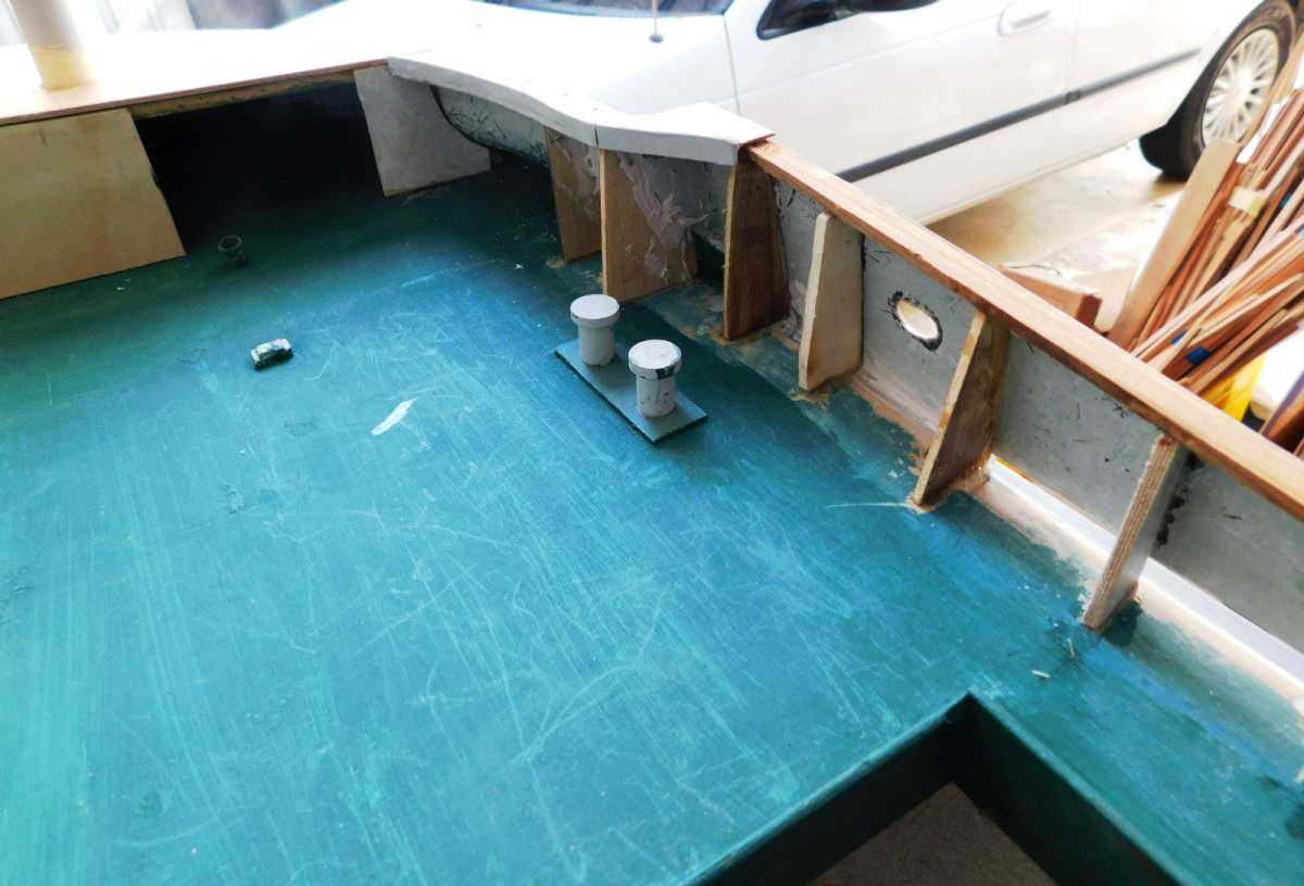

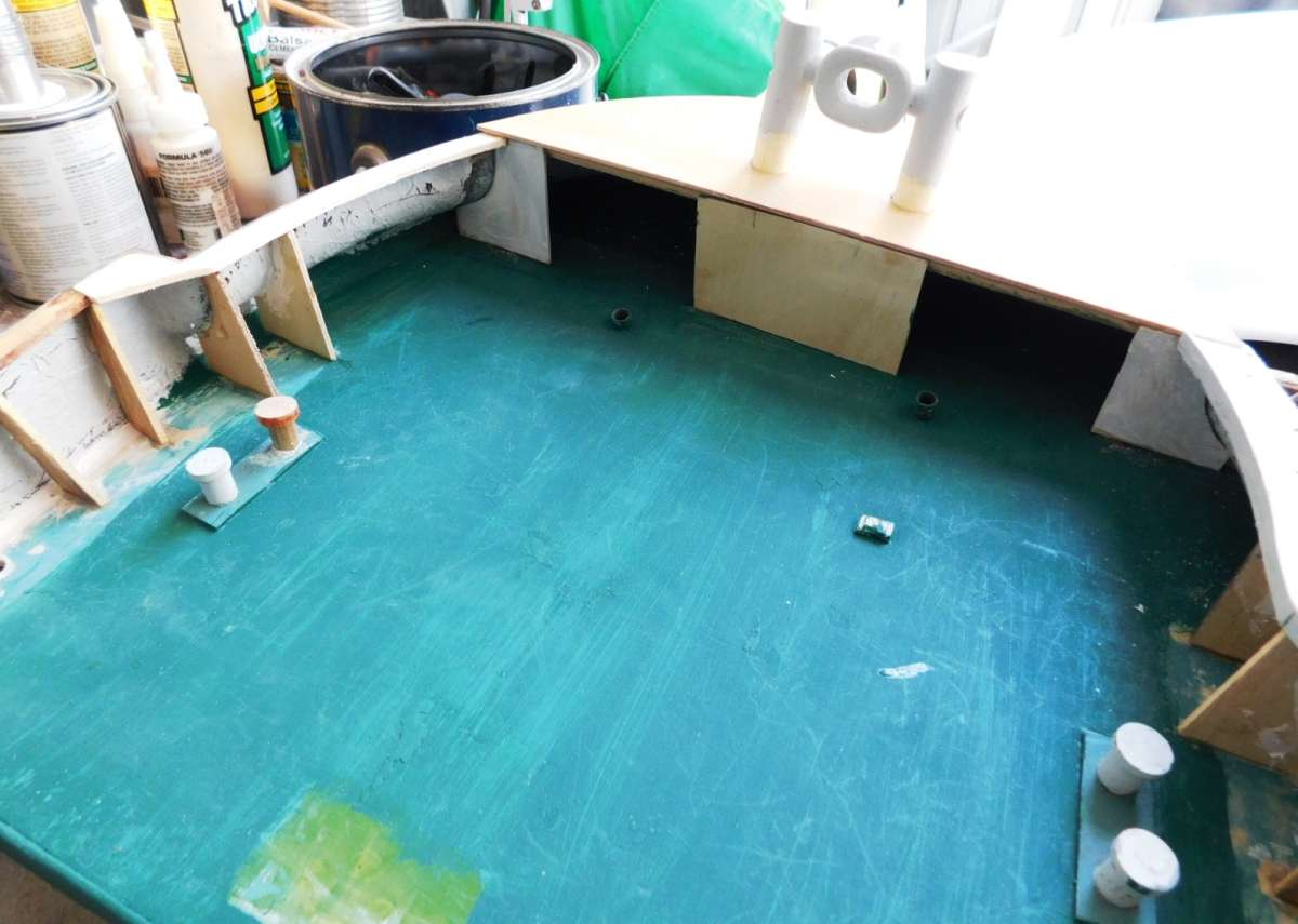

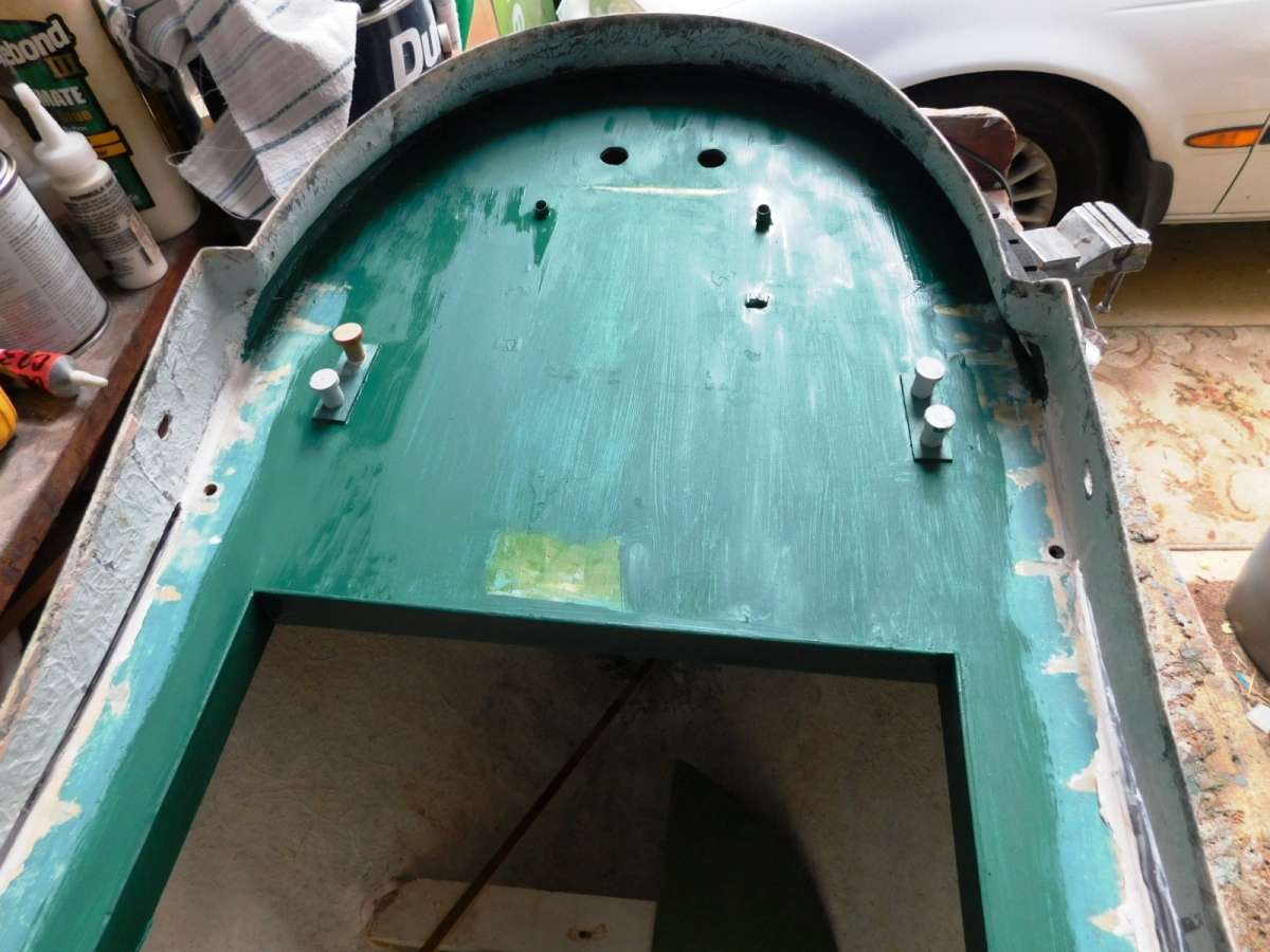

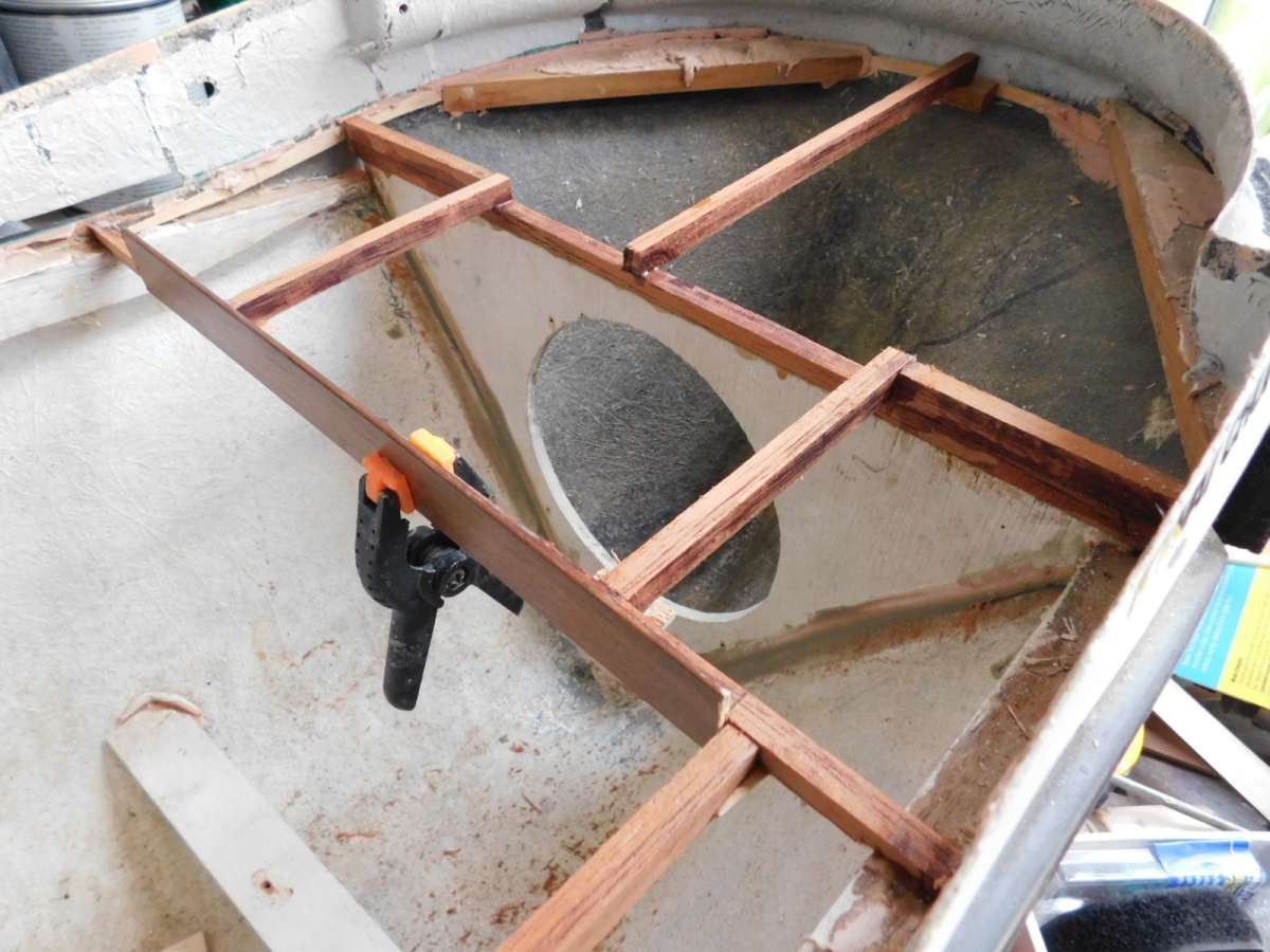

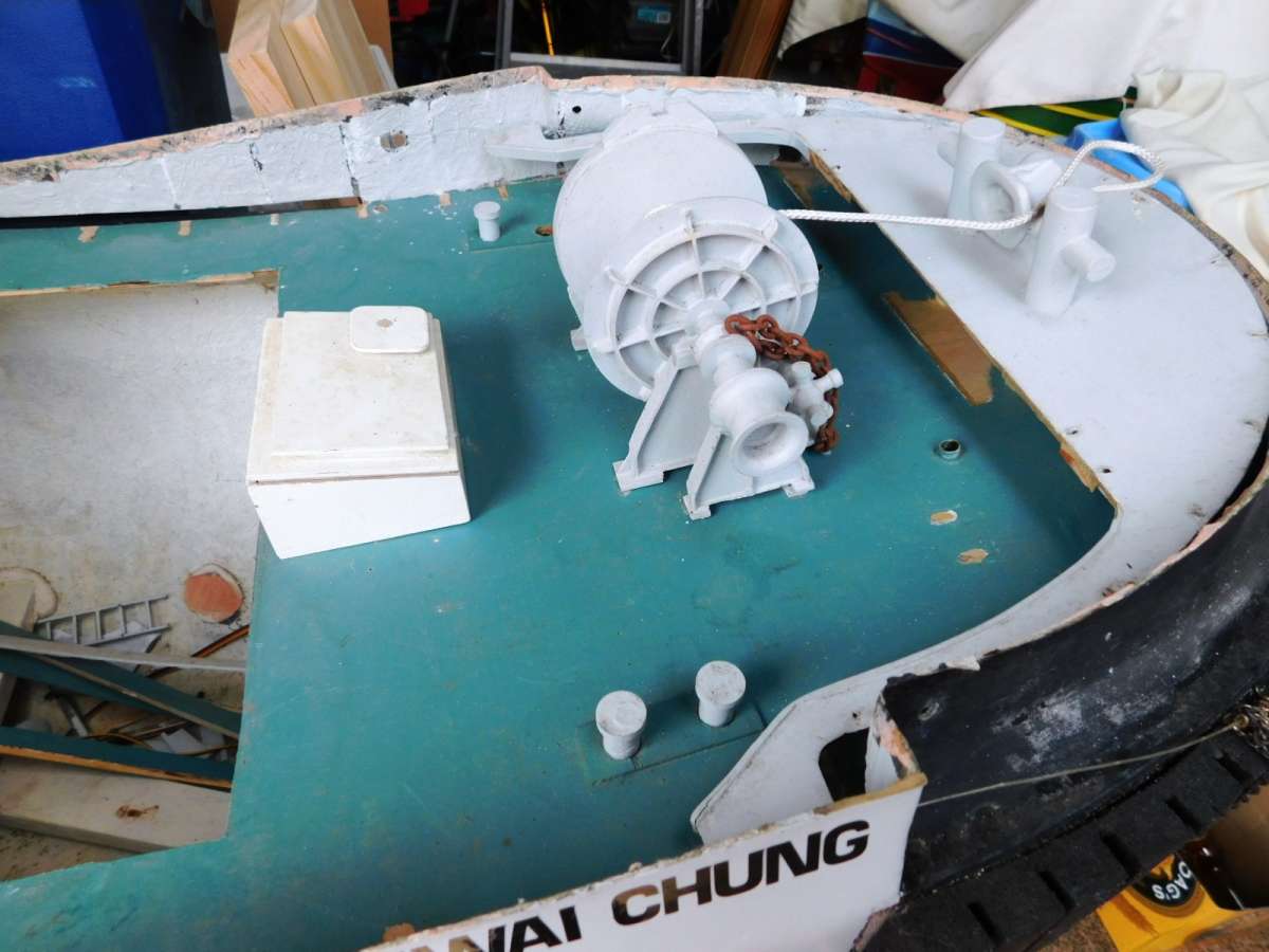

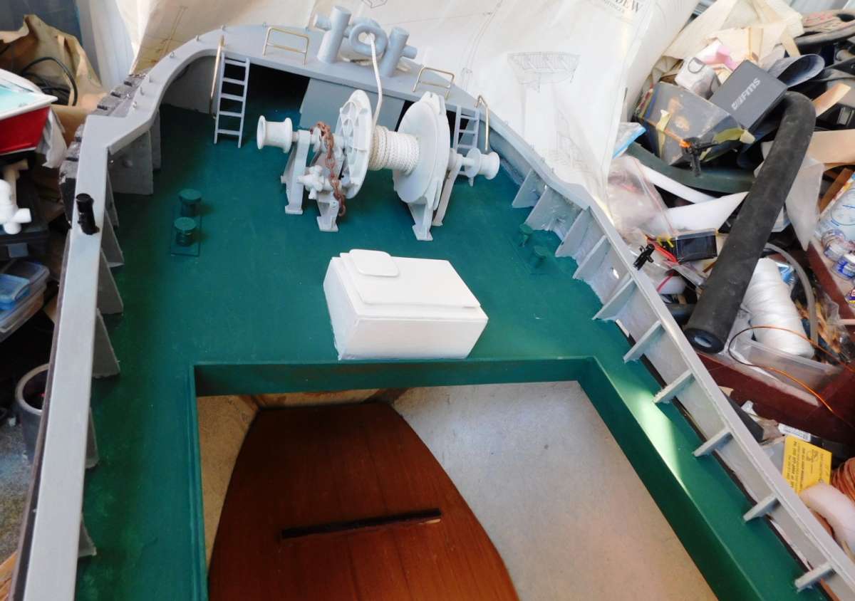

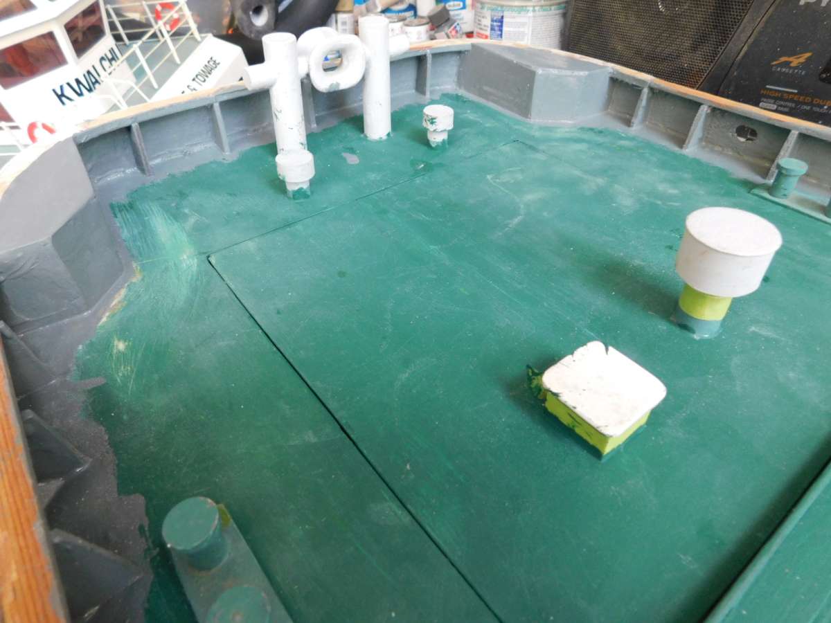

        Hi All
        So on to deck frames !!!!
        HarryKC 23KC 9KC 19KC 20KC 21KC 22
        #124612

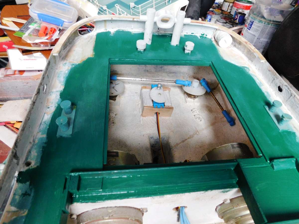

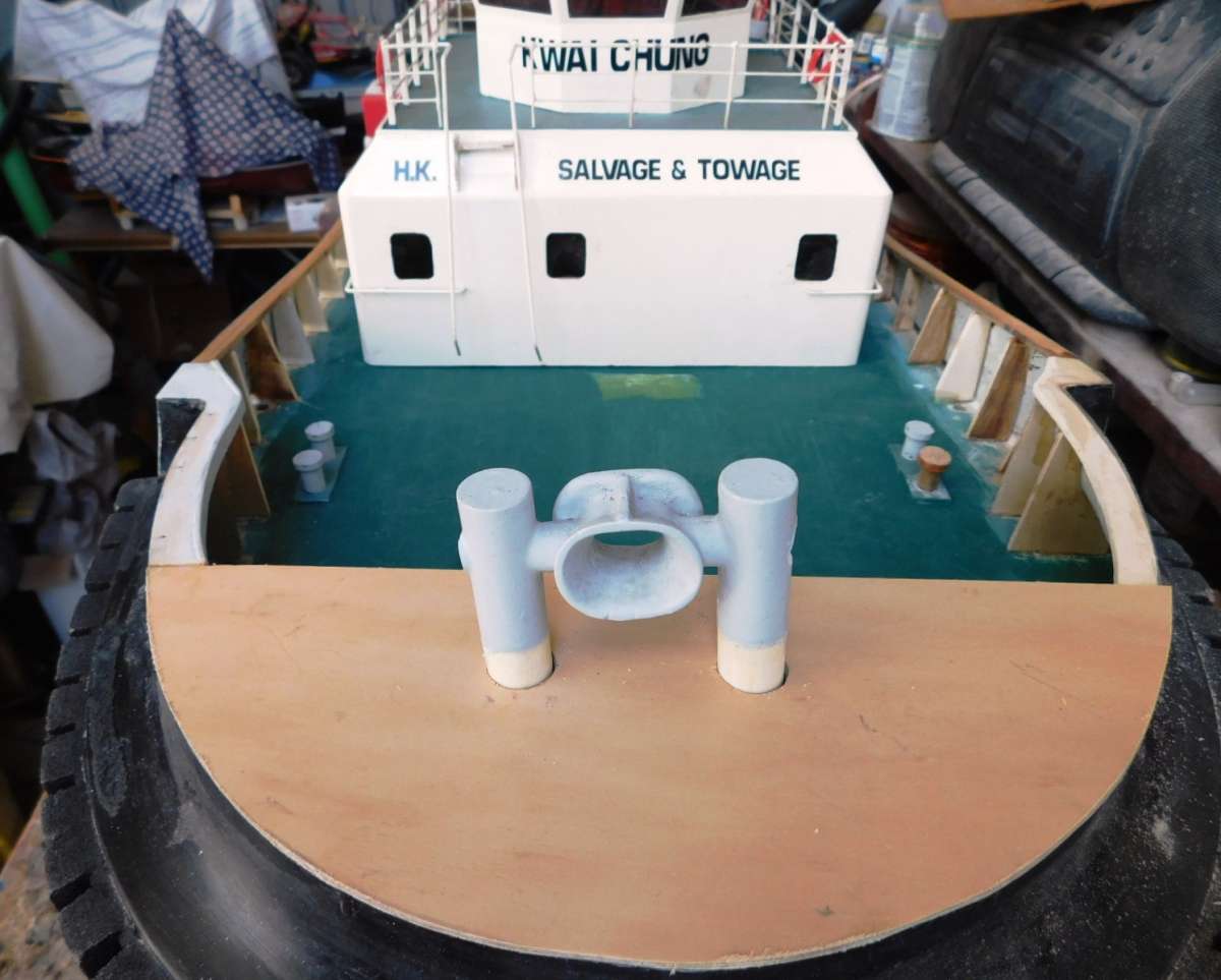

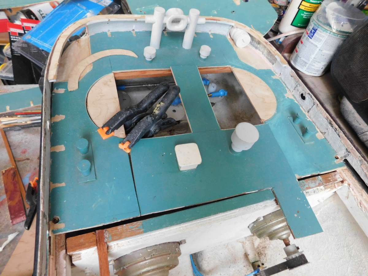

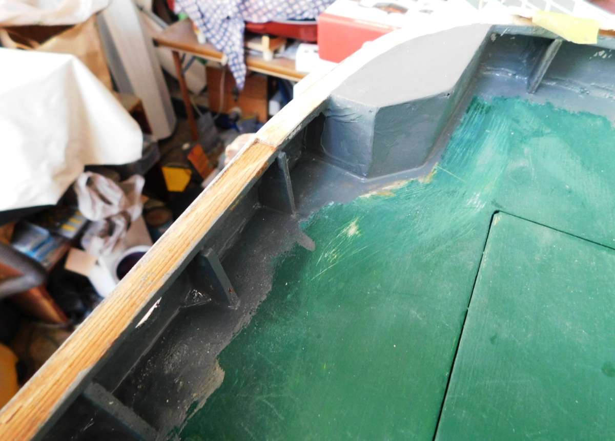

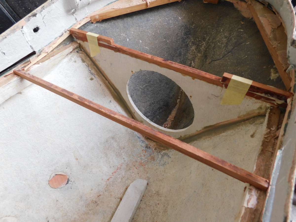

          Hi All

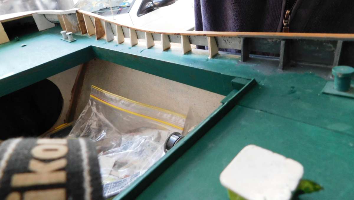

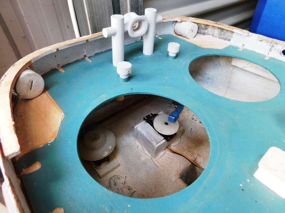

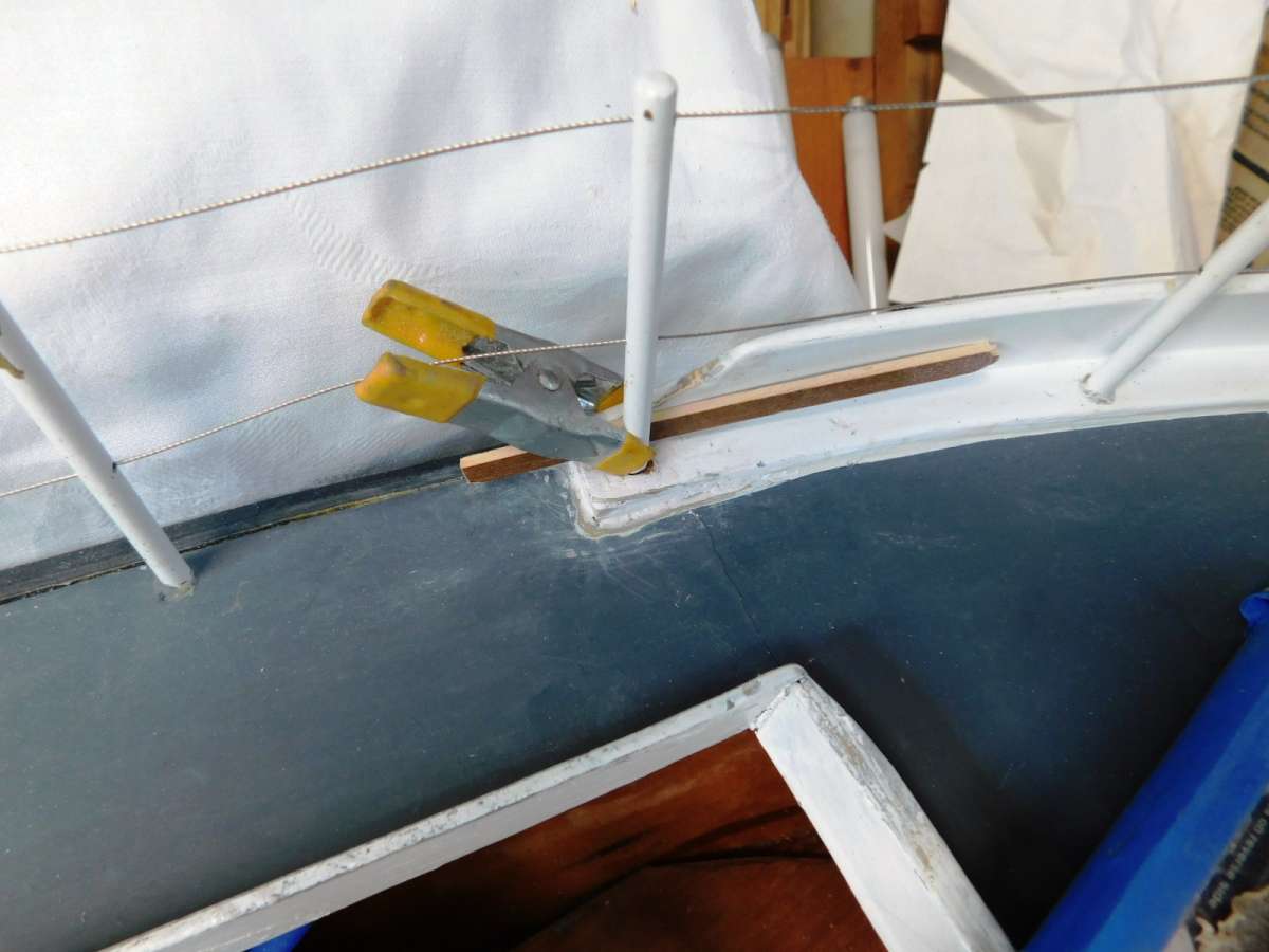

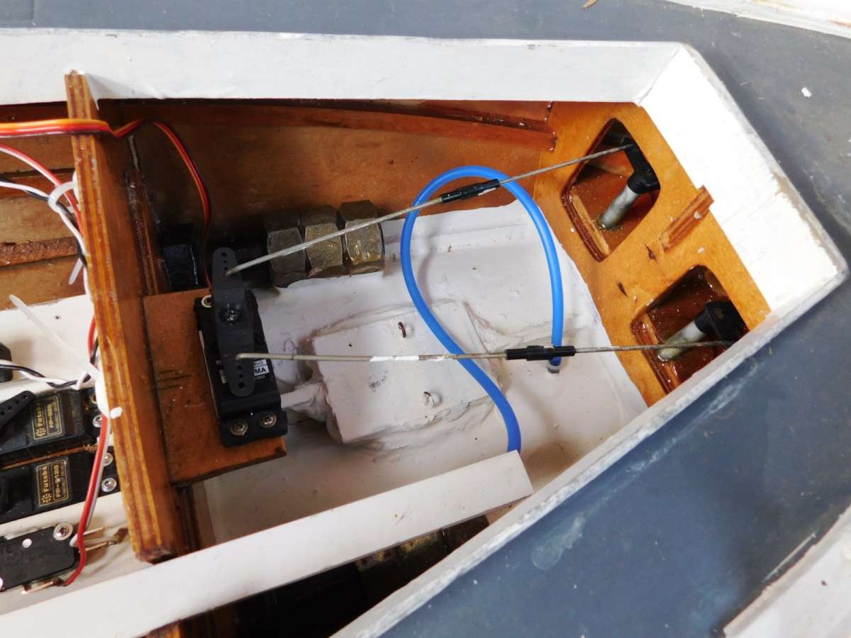

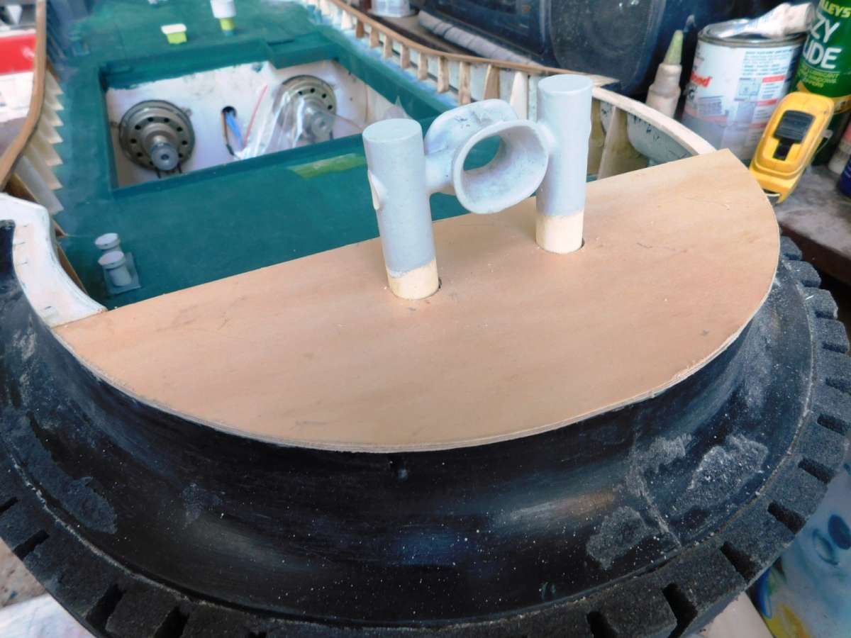

          So a bit of work on the stern deck for access to the rudders and servo.
          HarryKC 29KC 24KC 28

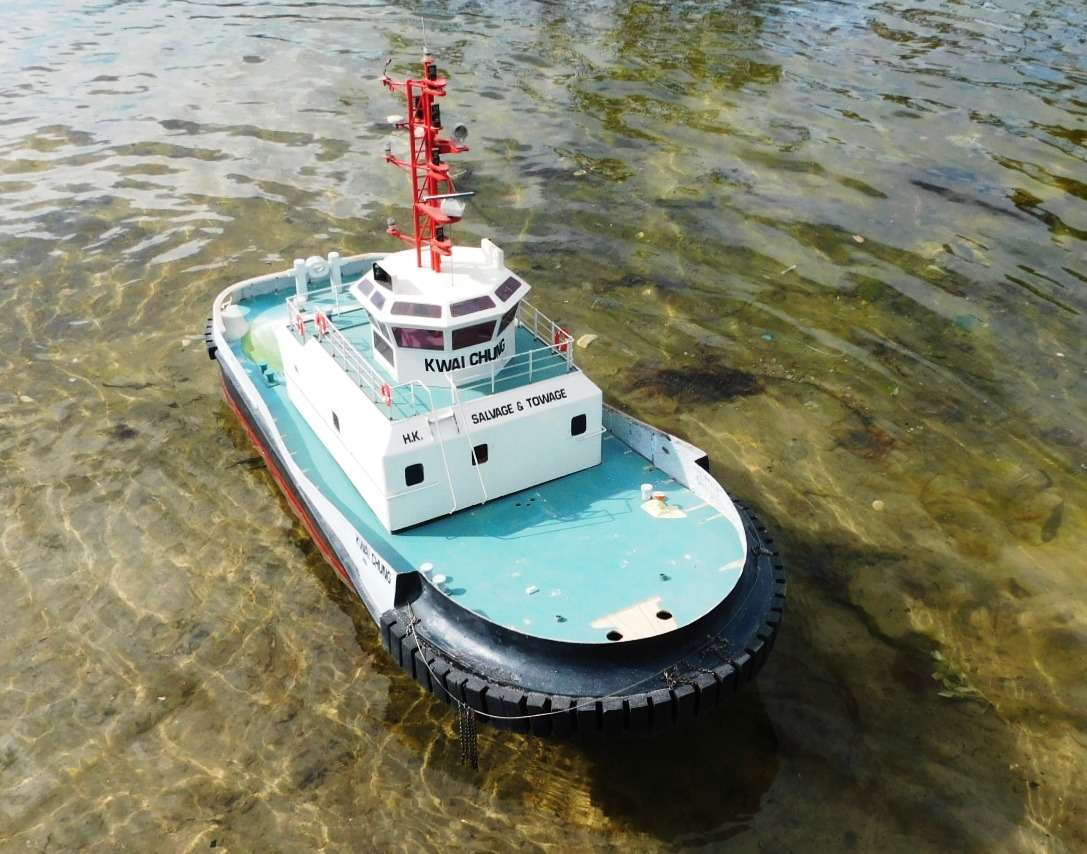

              #124617

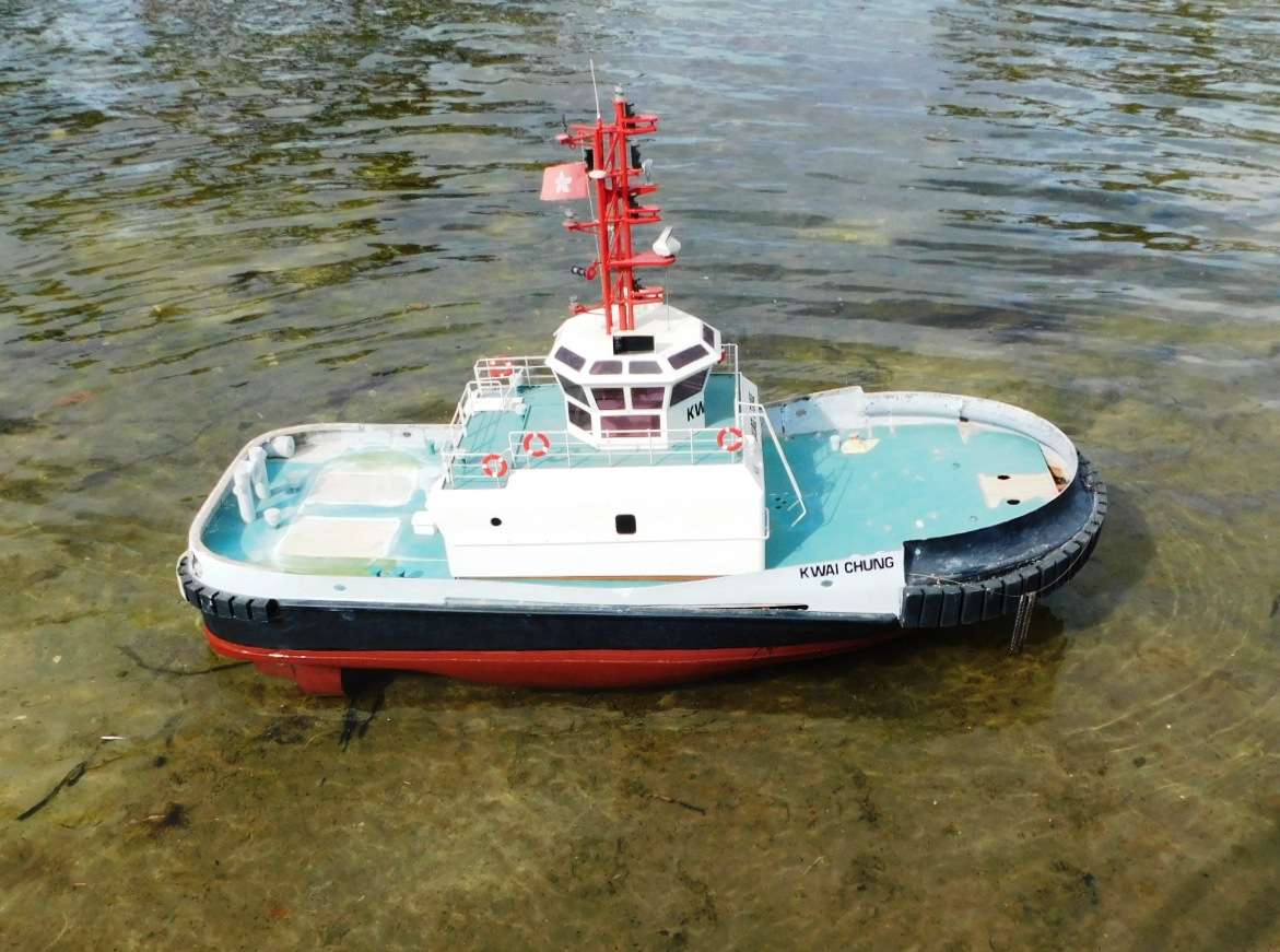

                Hi All

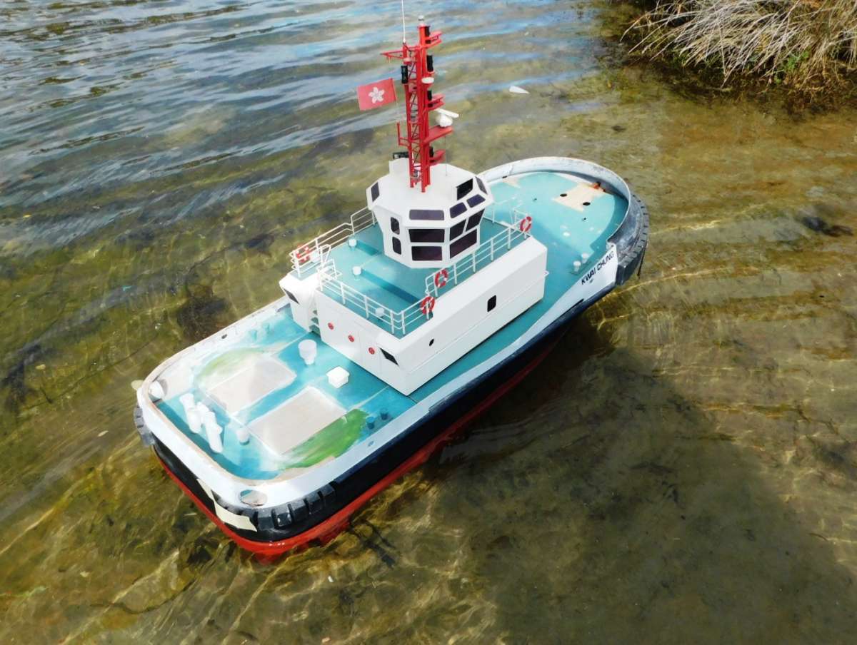

                the big bath test at the lauderdale canal !!!
                A truck load of lead and a very large 12 pound Sla battery to get the tug to the water line!!!
                Also added two 3S Lipo batteries for power !!!
                Well one drive totally failled, so only one motor .
                So it floats!!!
                HarryKC 27KC 25KC 26

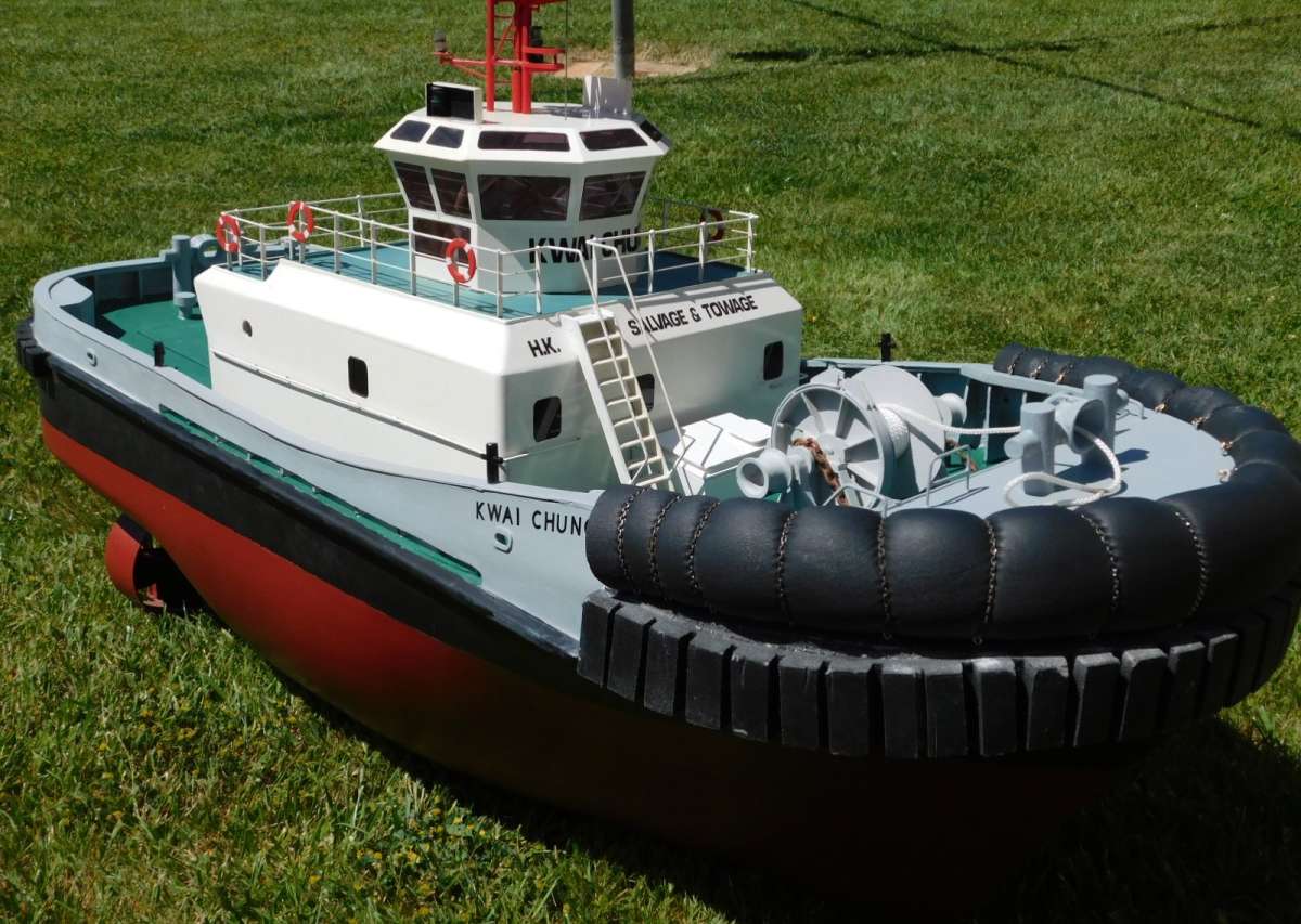

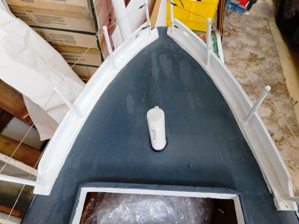

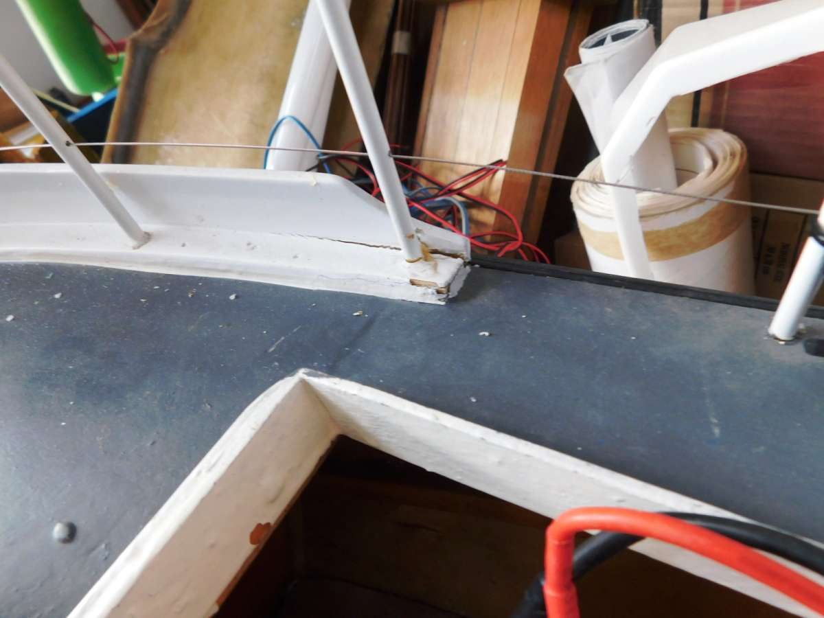

                #124635

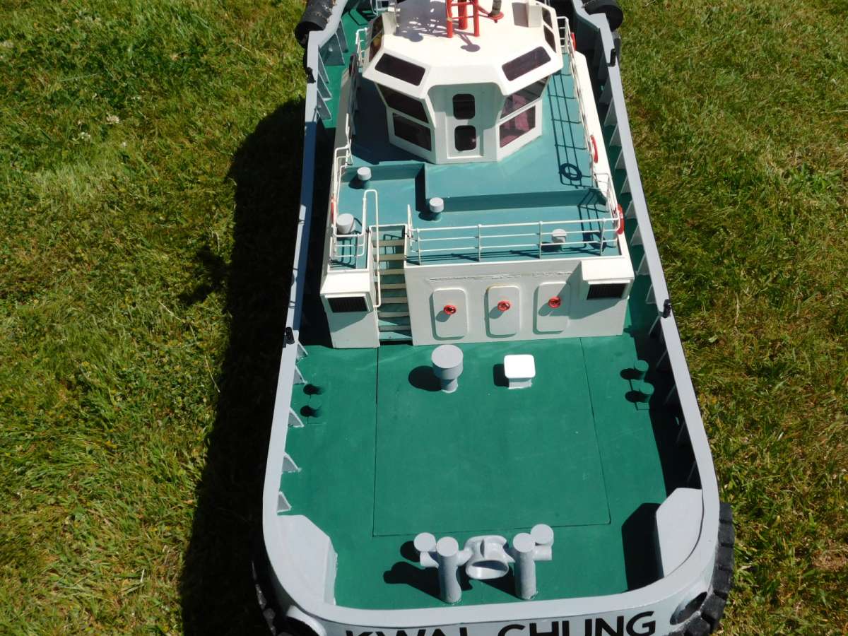

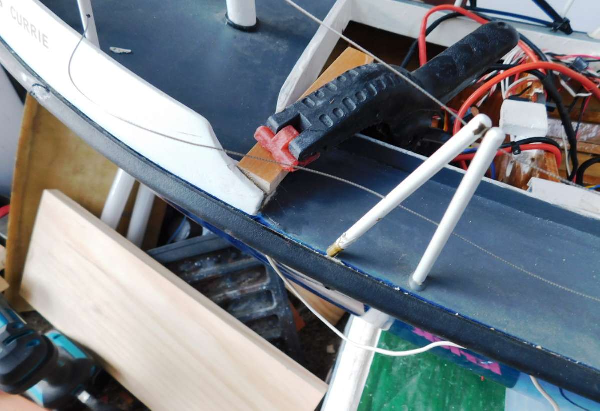

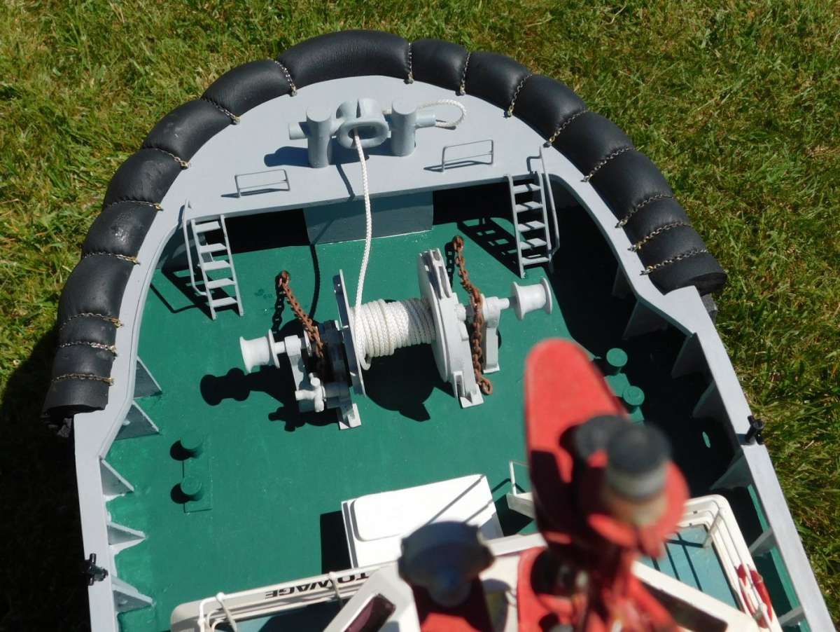

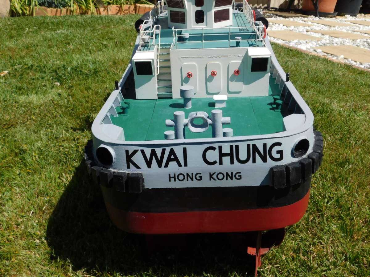

                  Hi All

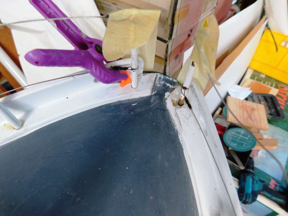

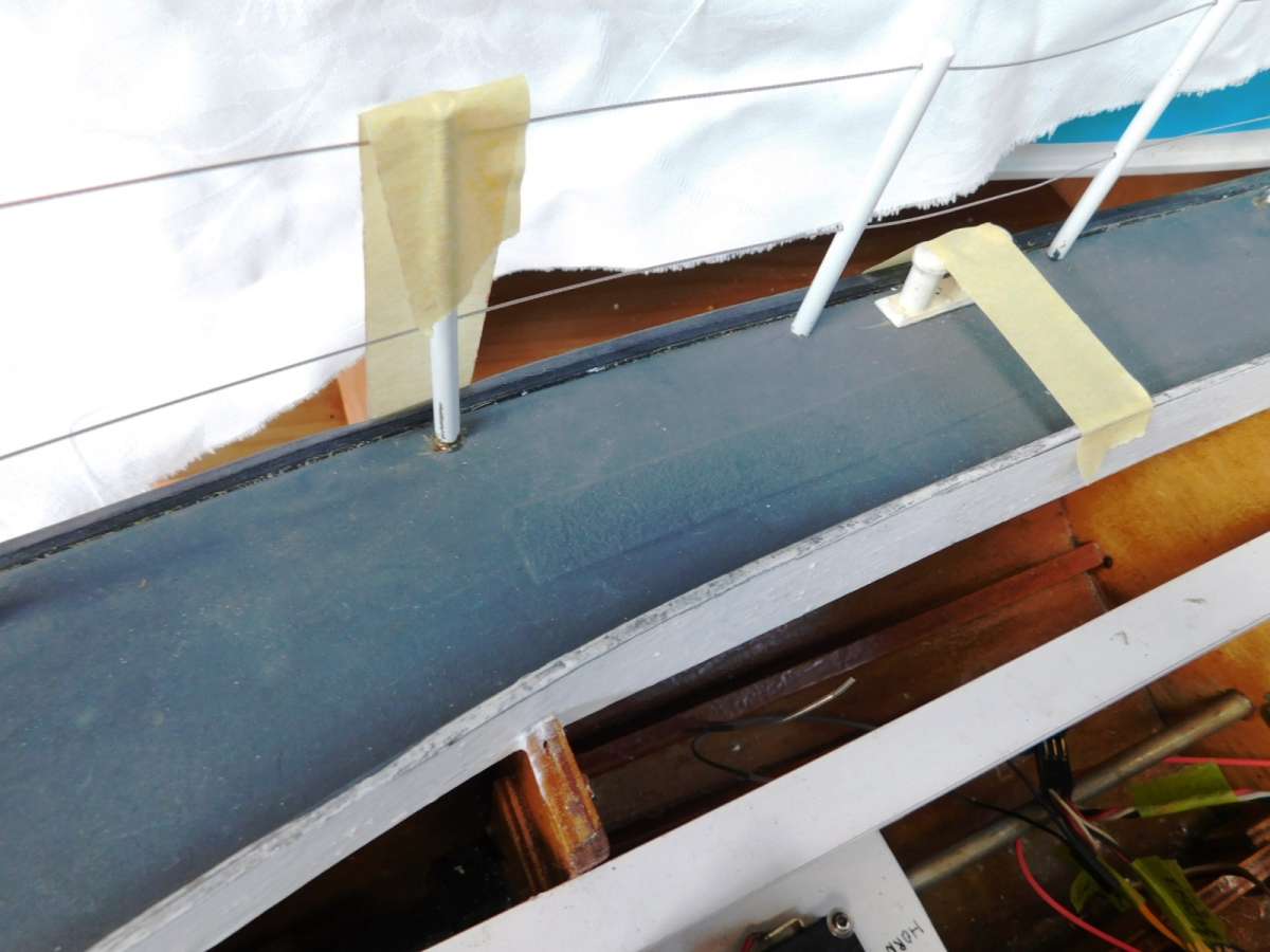

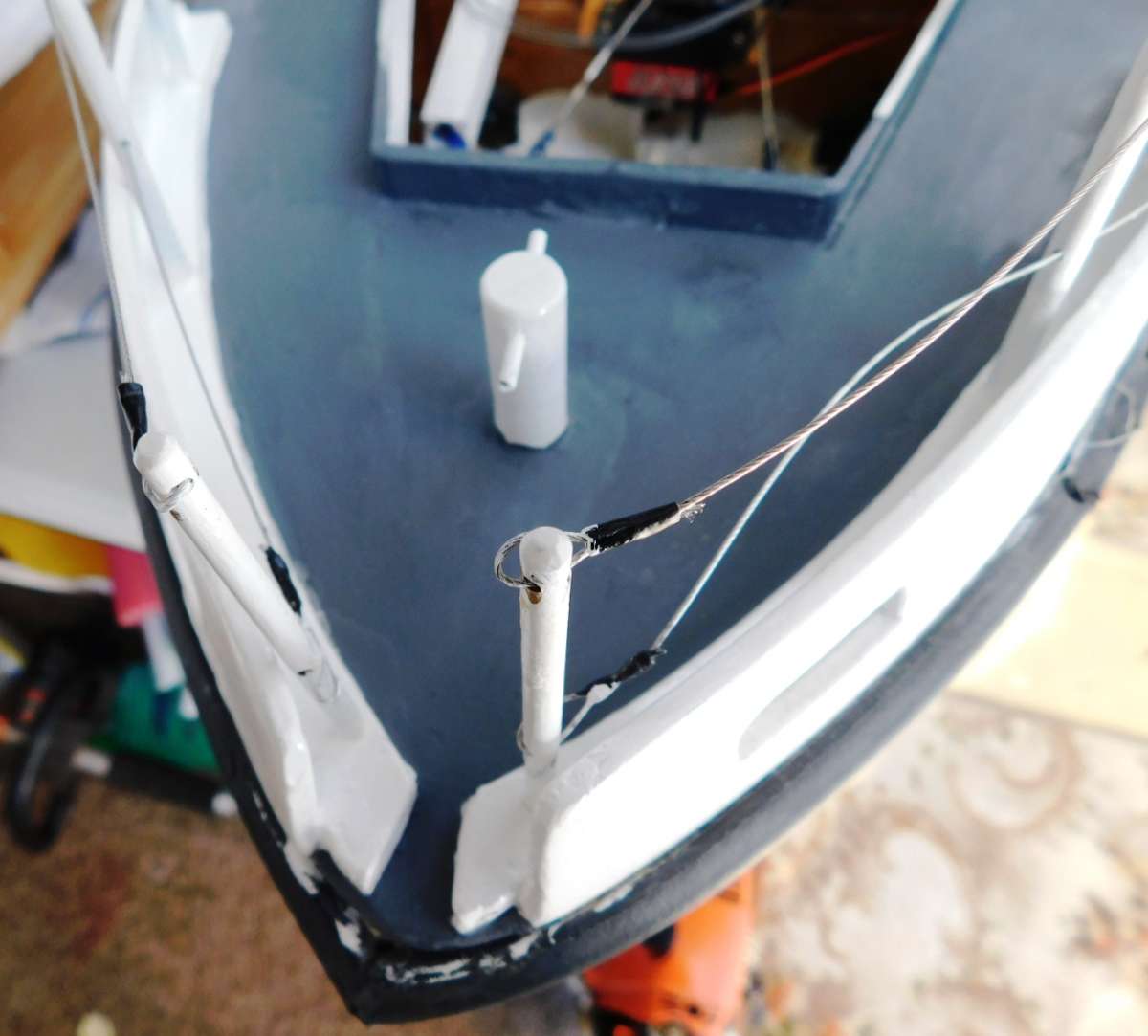

                  All bow section,railings and supports also added the pipe insulation to the bow.
                  New stainless screw eyelets from Aliexpress.
                  Installed two new drive belts and marine grade greased the shafts.
                  Getting new names for the tug on the sides and adding the missing name on the stern.DSCN4040DSCN4041DSCN4042DSCN4043DSCN4044DSCN4045DSCN4046DSCN4047DSCN4048DSCN4049DSCN4064DSCN4065

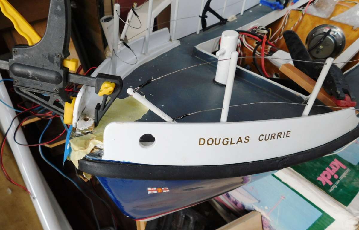

                  #124661

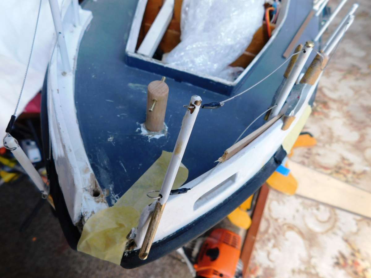

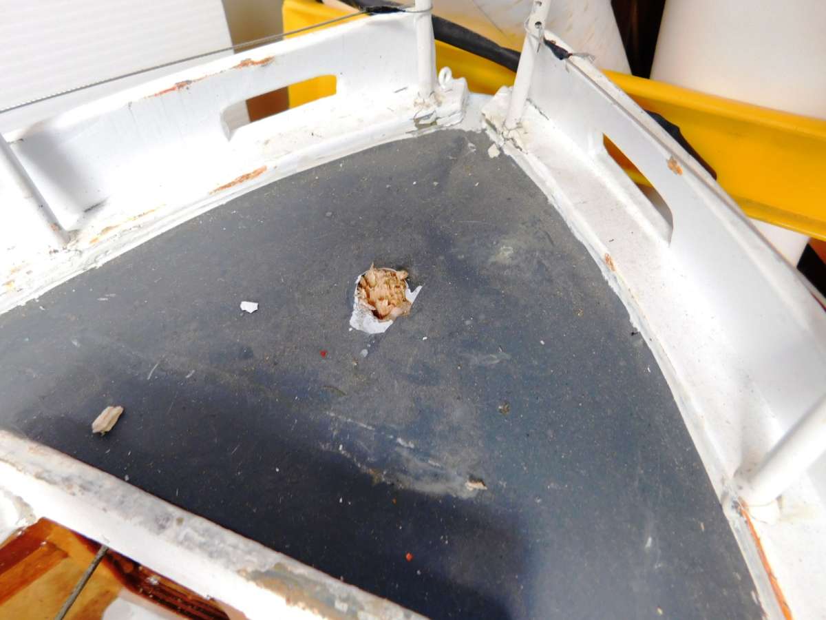

                    Hi All
                    Well that’s the finish of that one !!!!

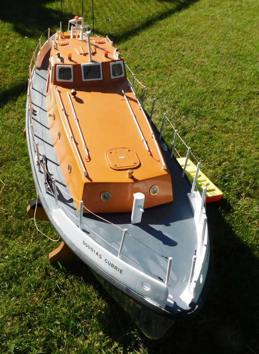

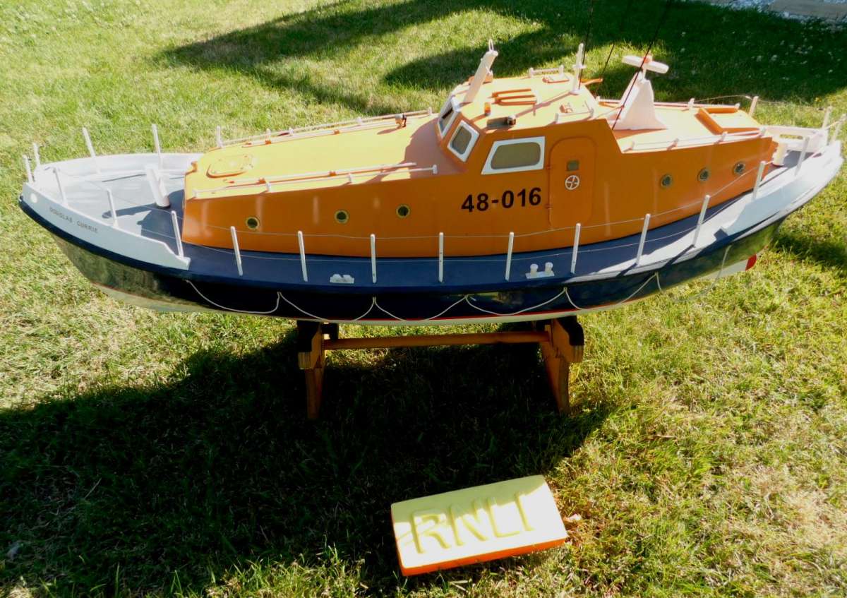

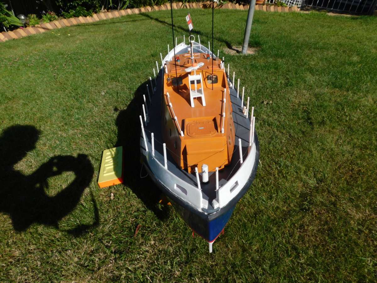

                    Next is a Solent Lifeboat 48 x 14 inches !!!
                    Just wiring with a sound system, railings, a bit of delamenting and broken stern post.
                    Also cut back the prop shafts which are to long by about 45mm and re-aligment of the motors.
                    HarryDSCN4082DSCN4088DSCN4083DSCN4084DSCN4085DSCN4086DSCN4087

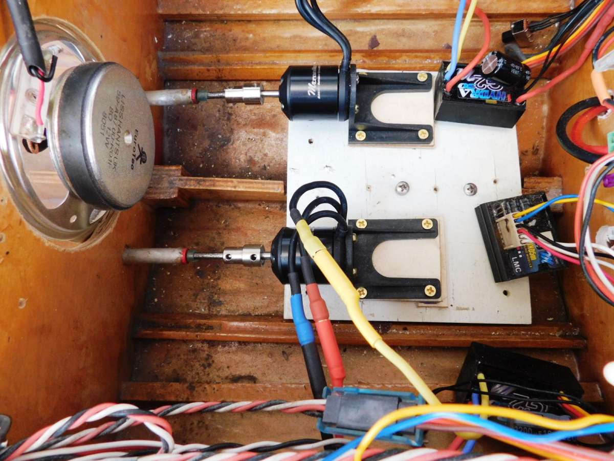

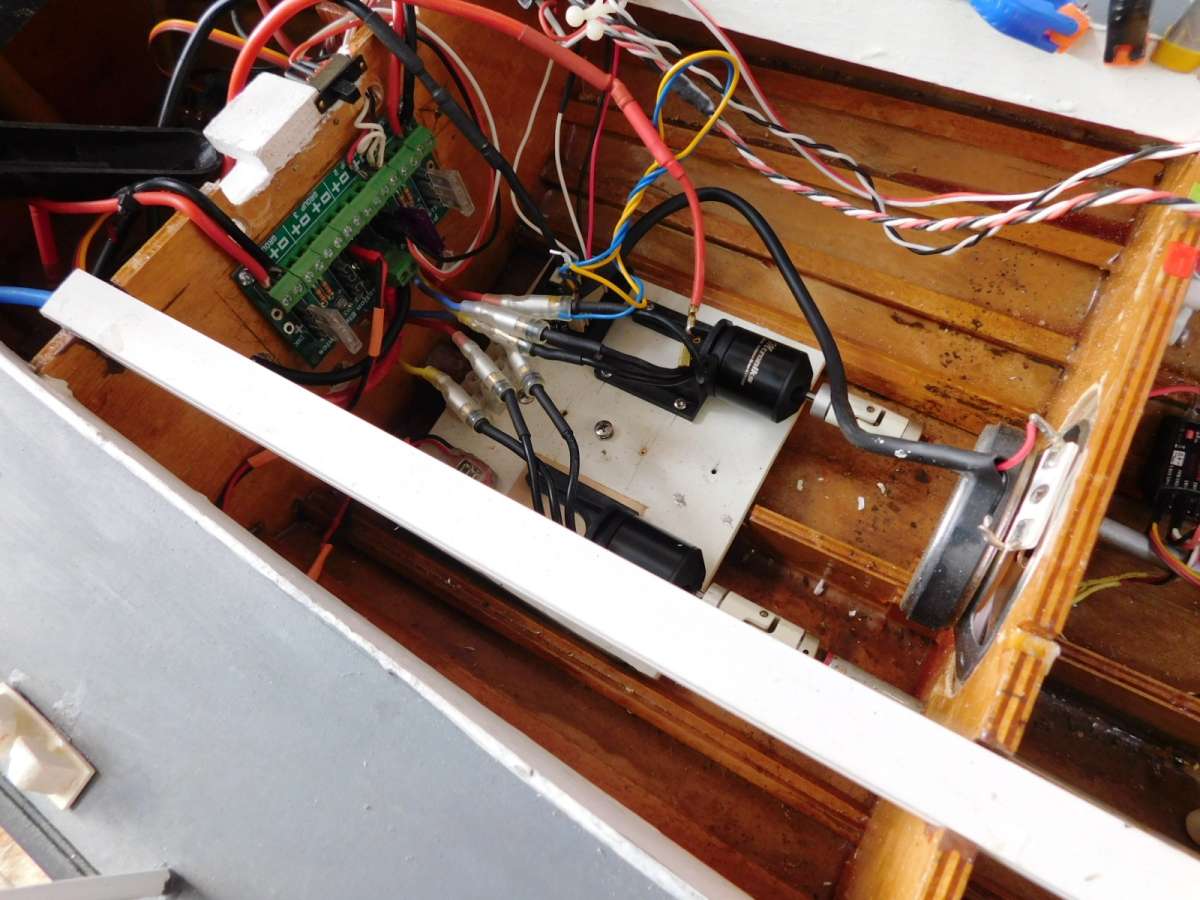

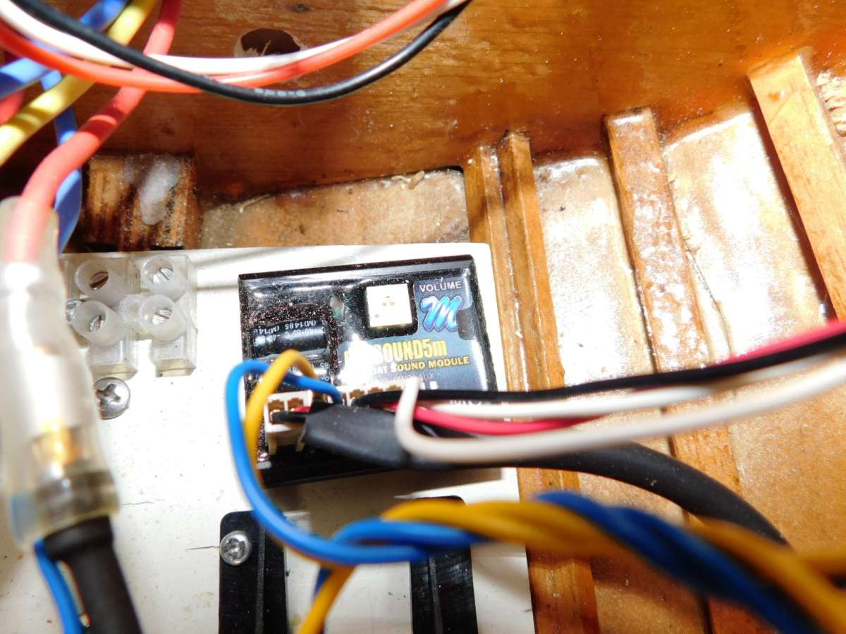

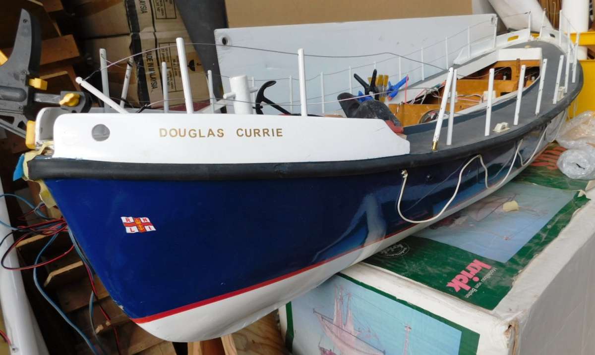

                    #124687

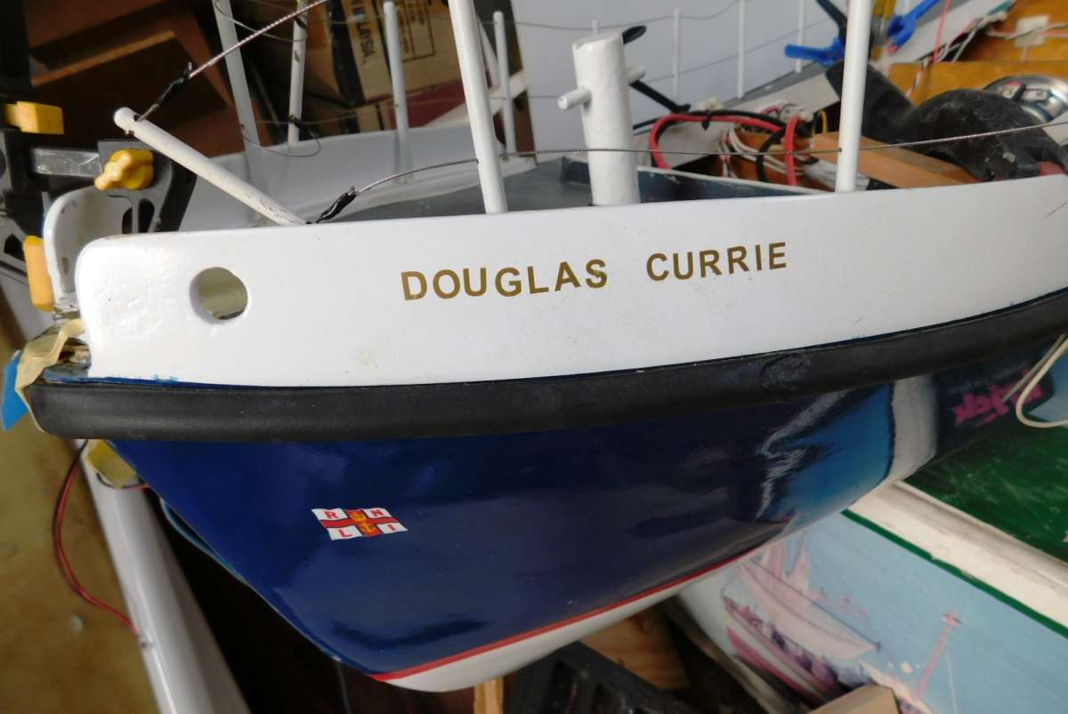

                      Hi All

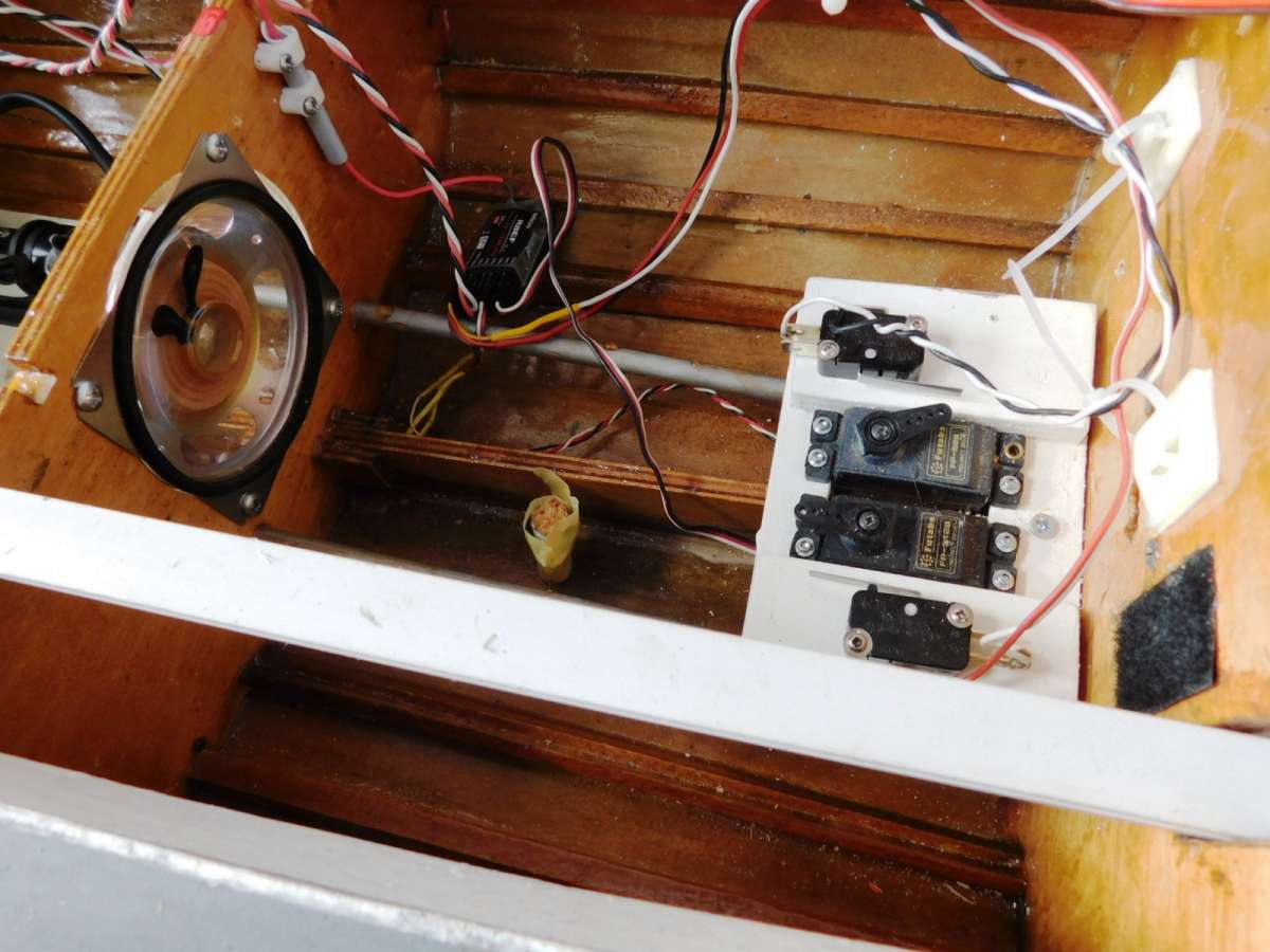

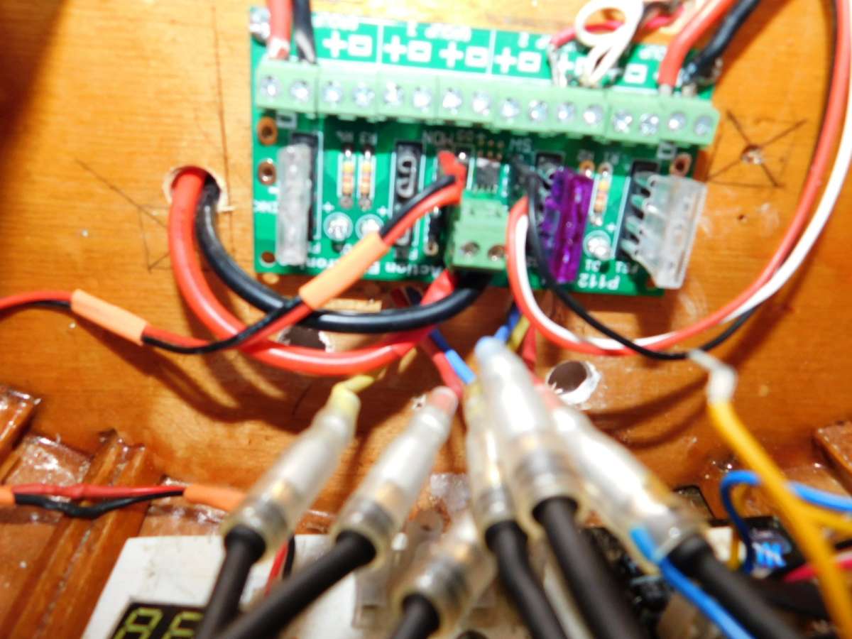

                      Started on the Lifeboat, it’s that bad !!!
                      Out with all the wiring including tagging what is what.
                      Port motor totally out of alignement.
                      Shafts out and trimmed the whole lot back 45mm, the props were far outside the tunnels.
                      I must say these little 28mm brushless (1100kv) on 3S Lipo batteries is going to be a interest test in the water.
                      HarryD1DSCN4159DSCN4166DSCN4160DSCN4161DSCN4162DSCN4163DSCN4164DSCN4165

                        #124694
                          Are you going for independent or simultaneous motor control?
                          #124696
                            Hi Richard
                            Just simultaneous motor control, just a Y Lead minus the red wire from the starboard ESC.
                            Hopefully the turning will be OK with the hole in the keel to direct the water on turning.
                            Harry
                            #124708
                              Hi All

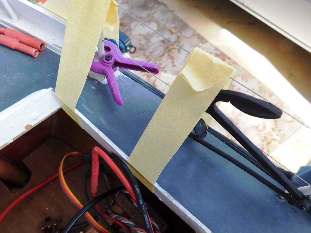

                              So it’s out with the tools, claps, tape and glue.
                              Also found just the right size dowel for the stern post.
                              HarryDSCN4177DSCN4181DSCN4178DSCN4179DSCN4180

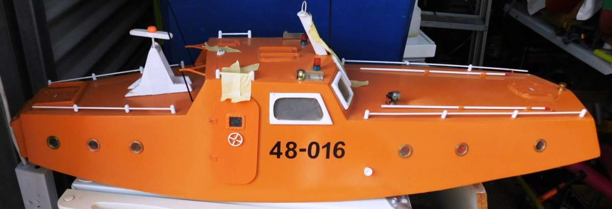

                              #124715
                                Hi All
                                With the stern and bow all finished and 40mm off the prop shafts, I decided to take another 5mm off.
                                Replaced some ends of the handle rails and reglued some back on.
                                The port motor is totally out off alignement, so thats next.
                                The New D rubber arrived, so thats going to be fun removing the old glue !!!!
                                Replaced the red lights on the wheelhouse, so both are working( only the LED and kept the outer case).
                                HarryDSCN4184DSCN4183DSCN4185DSCN4186DSCN4187

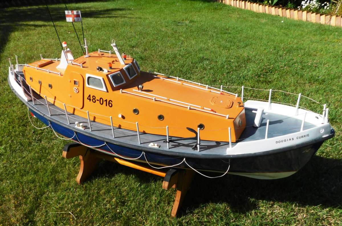

                                #124720
                                  Hi All
                                  Sorry a bit slow on posting updates !!!
                                  Well , I finally finished the lifeboat and did give it a run !!!
                                  Boy Oh boy these little brushless motors are  super powerful !!!
                                  At a third throttle to boat was up to speed and at full power the stern was down to near deck level.
                                  The bow was out of the water!!!
                                  In real size you would be skiing behind the boat !!!
                                  So another one finished onto a tug boat ???
                                  HarryDSCN4188DSCN4191DSCN4190DSCN4189
