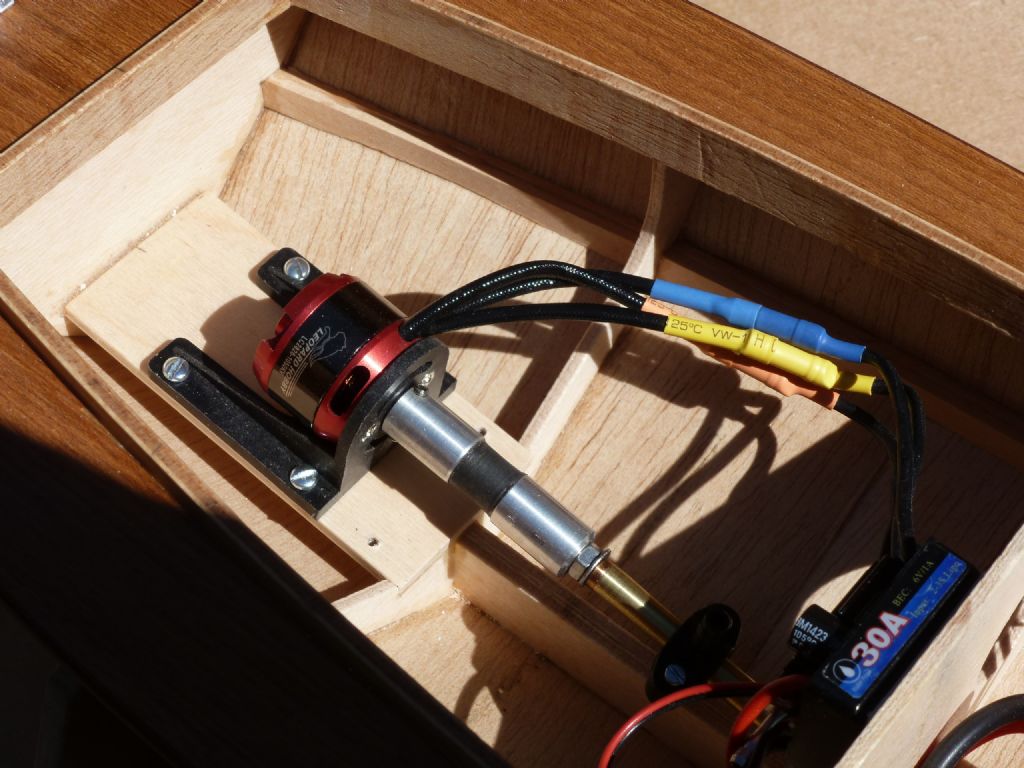

              I have a 28mm Leopard motor in one of my Hunstman 31 models, and the motor you have is similar although a bit larger. That being the case then you shoud buy a 540/600-size glass-nylon mount [it fits the 35mm Turnigy motors and they're pretty much identical to the Leopard one] and fit the motor as per the photo below. Remove the aircraft propellor-type fitting and use the plain end of the shaft to connect to the coupling. The coupling shown is not the type I favour now, which is the mini-flex one from SHG Marine Models. Expensive but the best.
              Huntsman 31 with Leopard motor

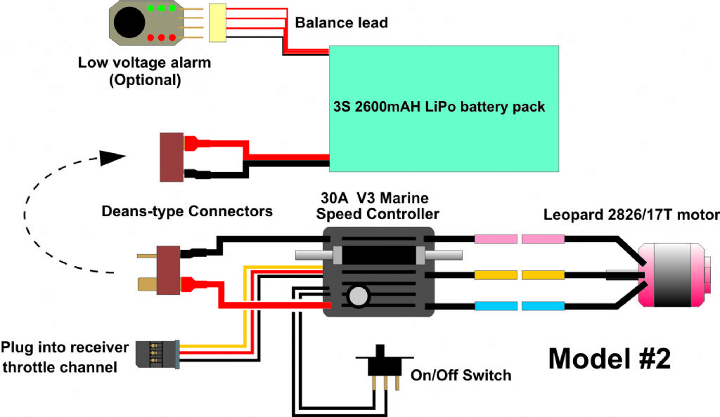

                Here is a wiring diagram for the motor, speed controller and battery pack. It shows a slightly different set of units to yours but the connections are identical. There is no need for a separate battery pack for the receiver, and the rudder servo simply plugs into the receiver where it's marked for model aircraft ailerons.

                    At the risk of repeating myself, you should remove the aircraft propellor spindle entirely by taking out the four black securing screws [it's not required]; mount the fixed end of the motor to the glass-nylon bracket – that's the end with the three wires – and use the plain 4mm shaft to fit into the marine coupling. The picture shows this. You will need to purchase three gold-plated bullet connectors to solder to the three wires of the speed controller and mate with those already fitted to the motor wires.

                      Thanks Dave. Just had a closer look at the motor. Able to remove the propellor spindle. All wires have colour coded bullet connections for the speed control.

                        As said by Ashley earlier, just connect up the three wires in any combination. If the model then goes backwards when it should go forwards then swap any two over. Not sure just why it works but it does!
