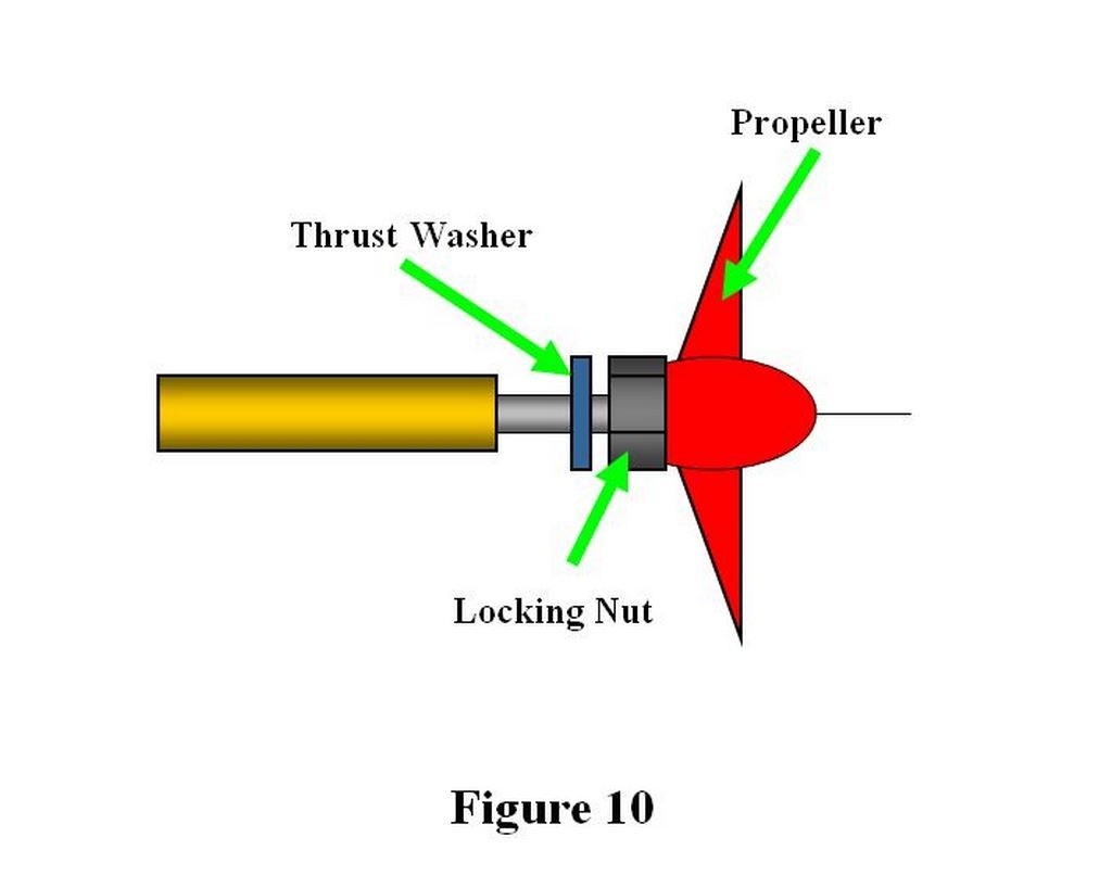

            Have a look at Glynn Guest's article here which should tell you all you want to know.
            In particular Fig 10 for the propeller end:
            Fig 10
            On the inboard end of the shaft a collar can be used to absorb aft thrust and prevent play in the shaft.

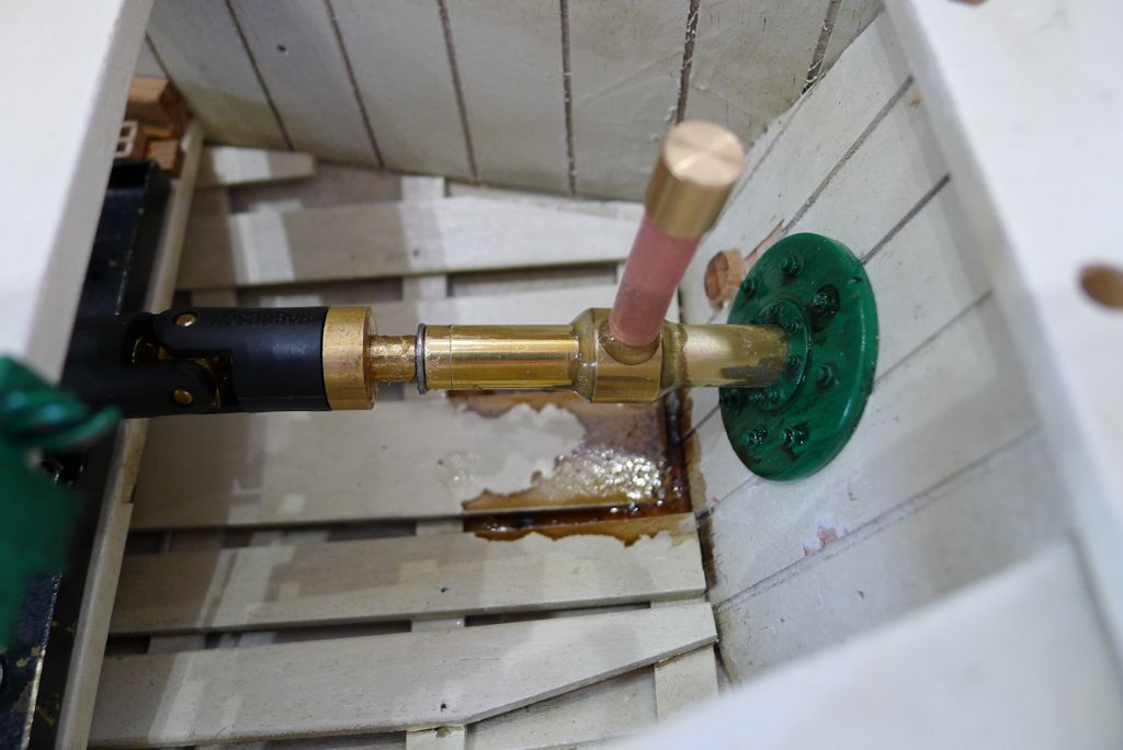

                  Dave, Also worth considering, as you can see in the diagram in Colin's post above there is a thrust washer to transmit the force from the prop into the end of the stern tube and hence to push the boat. I would also suggest, if you have the room, to fit one on the other end of the shaft for when the model is going astern. Dave Cooper's suggestion of assembling off the model before assembly is a spot on method of construction. Also worth remembering is that you want to assemble the propeller first, then slide the shaft up the tube with the two thrust washers before finally fitting the inboard coupling. It is then this coupling that determines the longitudinal play in the shaft. Consequently you want this play to be as small as possible, while still ensuring that there is a clearance and the shaft cannot bind. One way is to insert a piece of thin plasticard, say 0.5mm between the back of the coupling and the thrust washer while you hold everything together and tighten up the coupling grub screw. Sliding the plasticard out would then give you a 0.5mm clearance.
                  You will also have a couple of millimetres of play by repositioning the propeller as you do not necessarily need the shaft to be screwed right down into the hub as the Loctite and the lock nut are holding things in place for you at that end.
                  Also don't forget to consider fitting an oiler tube.  This makes lubricating the shaft very much easier and you can buy a type that glues on so are very easy to fit.
                  This is a fairly typical installation.  I have machined up a brass spacer for this one as the engine had to sit a little further forward so the spacer holds the astern thrust washer in place.  Note the glue around the oiler collar.
