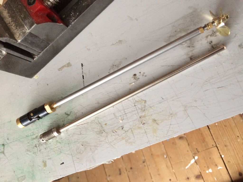

      img_0716.jpgHi Im new to building boats (normally aircraft?)
      Im building a Diva and I wanted to uprate the propshaft,propeller and joint.
      The one I have is around an 1" longer than the one supplied in the kit,Is it useable?
      Also what batteries do I need for a 400 motor?
      Many thanks.

          Terry. It rather depends on the room you have available if that’s not an obvious thing to say.
          if you have not yet fitted the motor mount and can shift it up a bit then no reason why you can’t use the shaft.
          Battery choice depends on the size of boat and the motor rated voltage. I have had no probs running Speed 400s on a 6 cell Nimh.

            If the long shaft won't fit, shortening is feasible and, with care, fairly easy. Lengthening is the difficult part.
            What 400 motor? They come in various voltage ratings which usually appear on the label. A 6 volt max motor will run very fast on a 7 cell battery, but not for long. An 8.4 volt one, on the other hand, will run reliably for a long long time.
