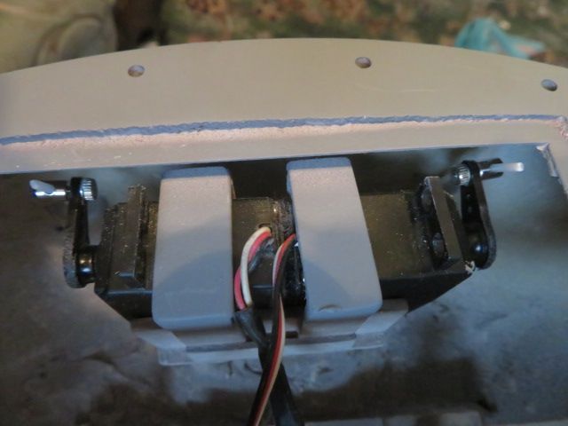

      is it possible to change the polarity of one servo so that it turns in the opposite direction when linked to a "Y" harness.
      reason i ask is i have two servos at the stern of my Tyne class lifeboat operating the two trim tabs that keep the boat level when sailing.
      the servos have only one direction of travel for the tabs and that is a 45 degree downwards movement to lower the tabs.
      the starboard one works fine, but the port servo, with exactly same directional movement of the axis, when turned around to port in the cradle, lifts the tab, this making it inoperable without major surgery to the cradle.
      last night i took the one that operated in the wrong direction and joined it to the one that works correctly and joined black to red and red to black……..but this stopped both from working through the receiver.
      the only way i can do it is by switching polarity of the one turning in wrong direction via my transmitter, but that means using two channels of the tx and rx, which i don't want to do………am confused enough as it is, lol.
      any help gratefully appreciated.

          Get a servo reverser? Easy option?…
          #92542
            Servo reverser:
            #92543
              Neil
              NEVER EVER try to change the rotation of a servo by swapping the red and black wires. Inside that gizmo is an amplifier and logic circuit which depends on the correct polarity for its operation. Get that wrong and you will kill it. Colin and Ashley have the answer for less than a fiver.

                  I have heard tell of servos that do have reversed logic, at a price. It is also possible to create one by taking the servo apart, reversing the motor connections AND transposing the two outer connections to the pot. The servo reverser is by far the simplest and cheapest option, and the most likely to work.

                      I had a similar situation on my Graupner Bernhard Gruben model. Two servos work together to lift and lower the stern gate for launching the small rescue boat. In this case the two servos were set up on either side of the hull , and with the servo arm on the right of the servo, when looking toward the bow. This meant that the servos operated together from one channel with a y lead.

                        You can reverse an analogue servo, but you will need a small soldering iron.
                        After taking the case to pieces:
                        1) swap over the two wires attached to the motor
                        2) locate the potentiometer usually connected to the output shaft. This will have 3 wires attached, swap over the two outer wires
                        Job done !
