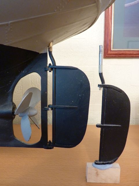

                  I built a Mountfleet Osprey some years ago, which I think, uses the same hull as the kit for the pilot boat Britannia. I had the same problems that you have. The original white metal propellor was of very poor quality and I replaced it with a 4 bladed brass propeller of 70 mm diameter. I initially used an MFA 6:1 geared motor, part no. MFA 919D, which had adequate power but the gearbox was very noisy even when packed with grease. I subsequently replaced the motor with a direct drive Graupner Speed 720BB Torque, part no 6372, which is much quieter and also has plenty of power in reserve. In both cases I used a 12 V lead acid gel cell battery.
                  I initially modified the white metal rudder and skeg as I could not understand how the supplied rudder could be fitted, since the axis of the upper pivot shaft did not line up with the lower bearing. However after modification the turning circle was poor so I made a new brass rudder with a 50% increase in chord but the same basic profile. This works fine and is much more robust than the white metal original.
                  Here is a picture of the two rudders side by side (almost).
                  Gareth

                    Gareth, thank you so much … that is exactly what I needed to know.
