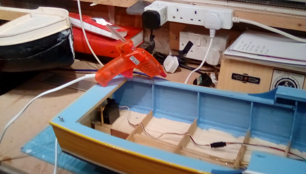

                  As we maybe boating soon I started installing the gear in the trip boat, the rudder servo extension lead runs under the the cockpit floor boards, I'm starting to use a hot glue gun for securing the lead in notches cut out of the frames, the glue works a treat and only £5 😄✔,

                  redpmg
                    @redpmg
                    Glad you went with the 4 window front Ray – it looks unique now a truly nice true scratch build. .
                    We are still banned from beaches etc – so no sailing other than in the bath – miss the 10m swimming pool in the old property – but not the time & cost of maintenance – ( pop pops did well in there too – but the chlorine was also slightly corrosive……..)

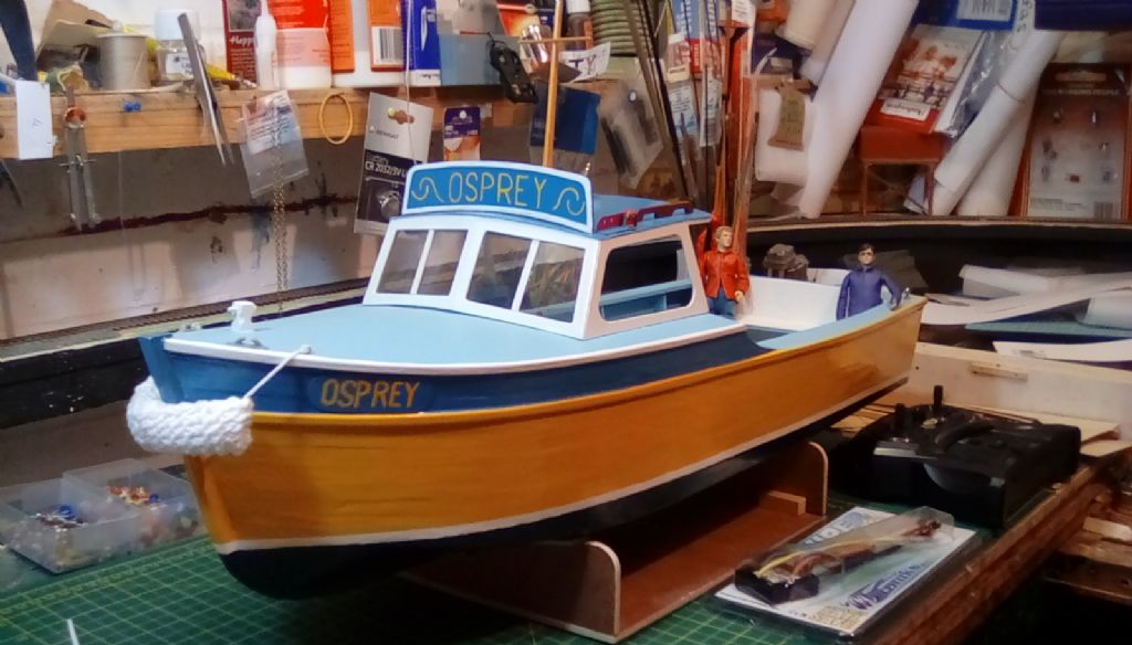

                                And thanks Chris for your kind comments about Osprey, here's an update,splashed out on a speed controller and started recruiting the crew which consists of Harry Potter & a Doctor Who chap, we are going to need more 😀👍

                                redpmg
                                  @redpmg
                                  Glad to see you feel the same way about "Plastic Bottles" Ray – cant stand the b things . Stuff was hailed as a miracle ever lasting – now its a big problem to get rid of – old GF boats are a real menace eco wise.
                                  What sort of ESC/Motor combo are you using in that great looking launch ? Imagine the real version would not plane – one on a trip to Polperro on was slow but very pleasant
                                  Always amazed at the speed of your builds however……….
                                  #91549
                                    Hi Peter,
                                    Yes GRP boats are currently putting chain saw sales through the roof 😮 the full-size boat owners are now giving away their craft to a good home to save marina & storage costs, I've been there and have the tee shirt 😀 happy with models these day.
                                    I'm rather wary of telling you the power train for Osprey 😮 because the technical crew on this forum will shoot me me down 😀 I have a box of 30 – 40 motors under the bench form my early brushed electric flight days, I pick one and in it goes, in this case a 600 size driving a 25mm 3 blade brass prop from the scrap box, nice new Mtronics 20A speed controller, running off the smaller size 7 cell battery pack up the front mainly because I want to keep the cockpit clear this will require lead ballast at the stern under the floor boards. Not aiming for a planing performance, but we will see 😀

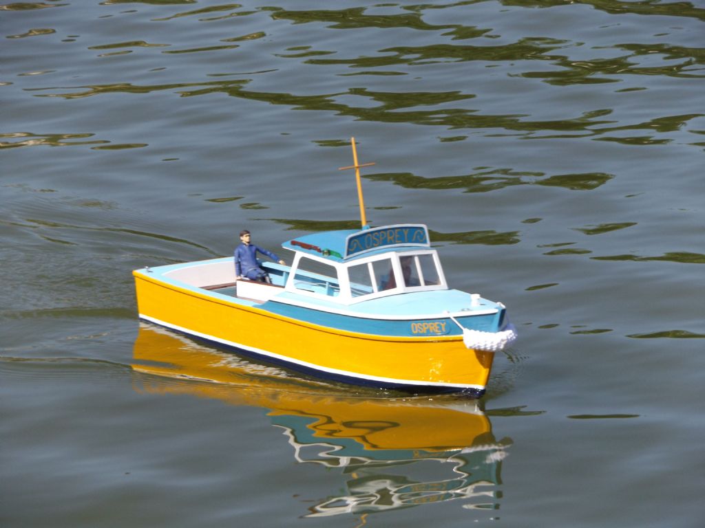

                                        osp 1 170721.jpgHi All,
                                        This is a blast from the past, my first lockdown build from last year, performed well under blue skies at the Chantry Club at Bluewater, many comments from my mates Peter & Phil about fishermen with rods and lines being required ! or a big Shark chasing her round the lake, have a look at the first post on this thread to see where the idea came from
                                        I ended up with a 6 cell pack under a central bench seat in the cockpit, no ballast required.
                                        Pleased with the end result .

                                          Looks great Ray.
                                          #96951
                                            Simple models are often the best. She looks perfect on the water Ray.
                                            #96952
                                              @timrowe83142
                                              You deserve to be pleased Ray. It's a cracking model that exudes character in spite of its simplicity. That's a hard act.
                                              Free plan or have I missed something already?
                                              Tim R
