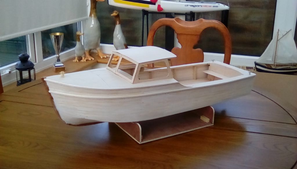

            img_20200423_182258.jpgEvening All,
            I love seeing my design plans being soldimg_20200423_182324.jpg on eBay 😀 photocopies of free MB plans, cheeky bu*gers !!
            Still I think Osprey now looks pretty much how I'd hoped and will wait for some West System epoxy to arrive before the final painting and fittings, what shall we build next I hear you groan 😕

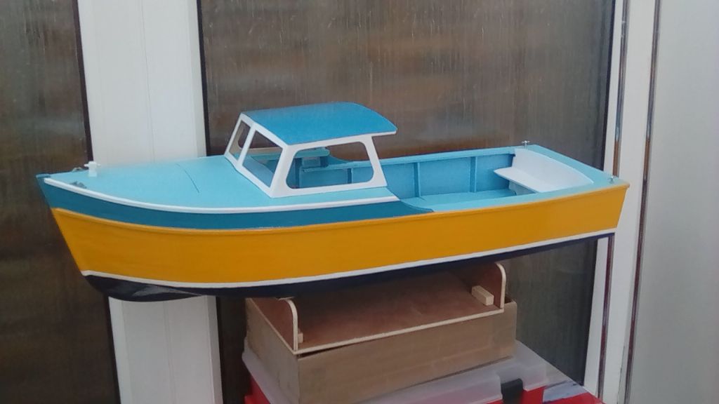

                            I have been busy painting Osprey for the last week and now she's starting to look like the jigsaw puzzle picture 😄
                            Finish = sanding sealer, high build filler (sprayed) , filler for the pin holes, 2 coats of Humbrol gloss.
                            The waterline masked with 1/4" Tamiya tape between the yellow & blue and painted with a long haired brush.
                            pretty happy with the result 😃 glazing the Windows next with old CD box plastic.

                            #87791
                              Nice Ray, very nice and resembling the puzzle really well.
                              Need a name board on top of the cabin?.

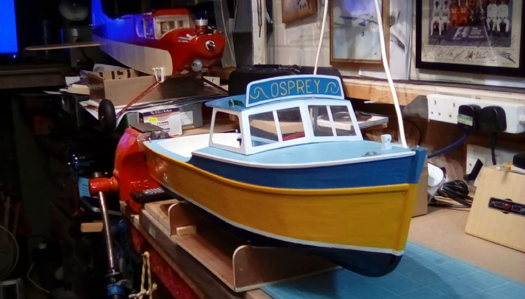

                                  Just the Osprey name board on the roof & bows + some fittings and think she's there 😄
                                  I'd better get Comanche finished next as we may be able to go boating soon 😎⚓⛵

                                  #87919
                                  Eddie Lancaster
                                    @eddielancaster
                                    Hi. Ray, a lovely smart boat, looks great.
