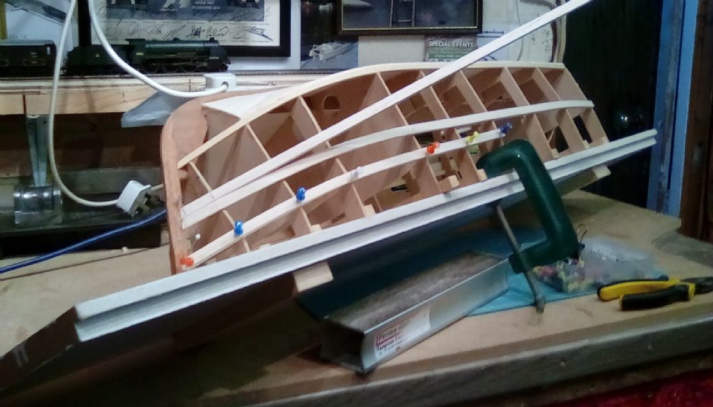

      These are interesting facts about the Fairey construction methods I expect there will be mini Autoclaves springing up all round the country now 😊 DM ??img_20200415_094721.jpg
      Not the universal building jig that Paul T was building, but a simple way of positioning the hull for better access for planking with G cramp, simple but effective ??

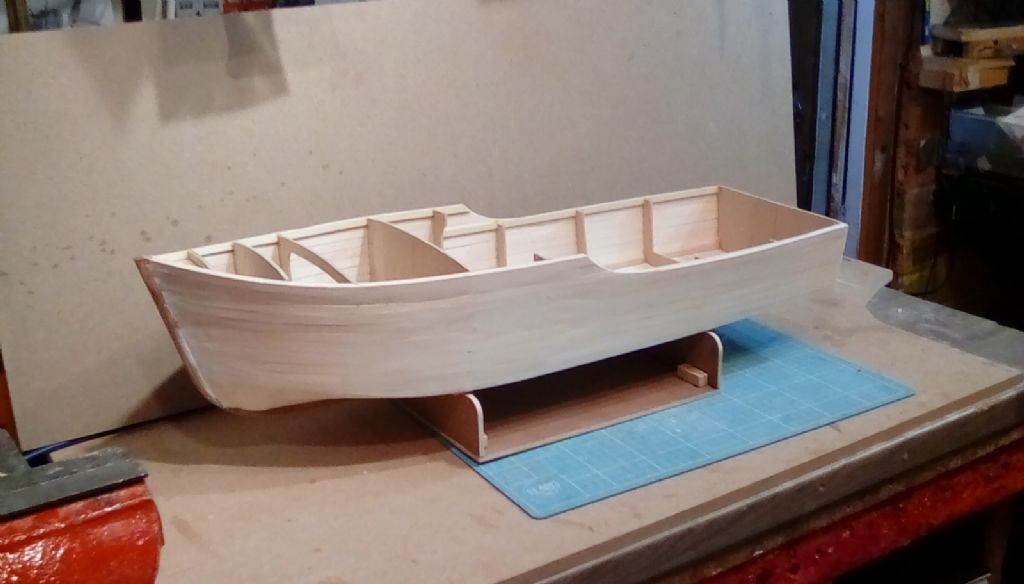

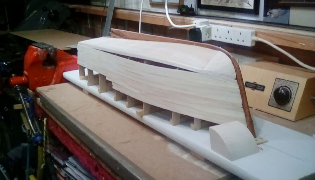

          The guys in my boat building workshop have been going for it as usual, and they tell me Mr P38 filled maybe required 😀
          Still a relief to see to see a boat shape emerging, soft balsa block for the bow infill needs some whittling yet 😃,

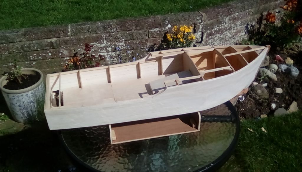

            img_20200417_095738.jpgHi All,
            Well Osprey has lift off 😀 quite pleased with the shape, more of a displacement hull than a go fast job, but 6-7 knots round the bay will be fine, now thinking about hiding the nicad packs under the side bench seats, always an issue with an open cockpit boat..

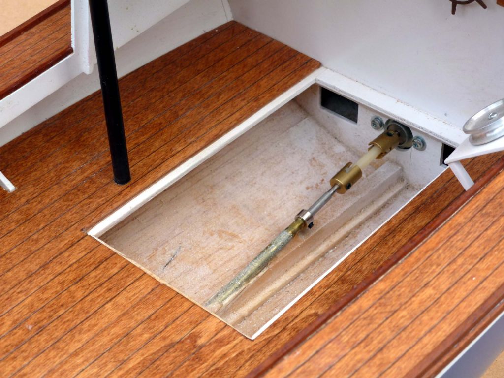

              Ray
              Would there not be a central engine housing where you could hide them? Failing that, perhaps under the cockpit floor like the Mid-West Boothbay Lobster Boat?

                      Yes I could put batteries under the cockpit floor, the rudder servo will go under the seat across the stern.

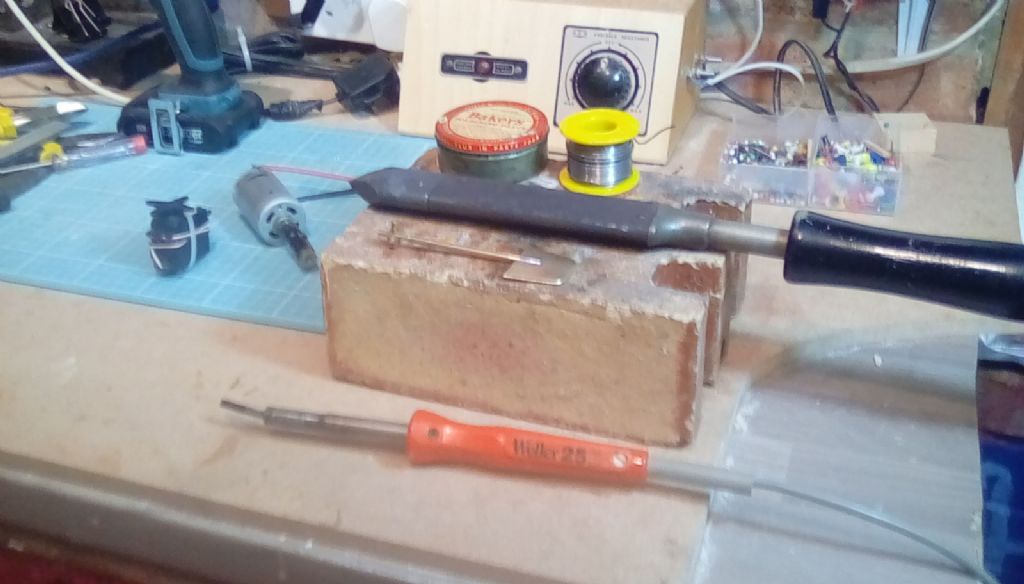

                            Before I get carried away with the deck & superstructure such as it is ! I have Knocked up a brass rudder & brought out my 240 watt soldering iron great for soft soldering slightly larger jobs before you need a blow torch 😀 I have a selection of low tech devices old as the hills but aren't we all 😄
                            I use an old fire brick to work on always useful, in my younger days we used a sheet of asbestos mat at school !!

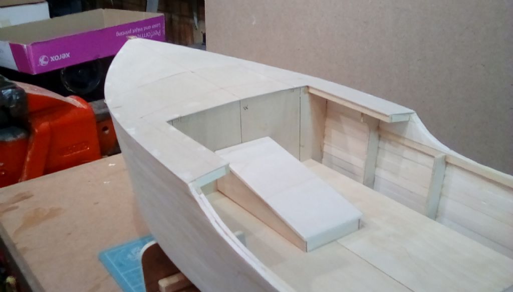

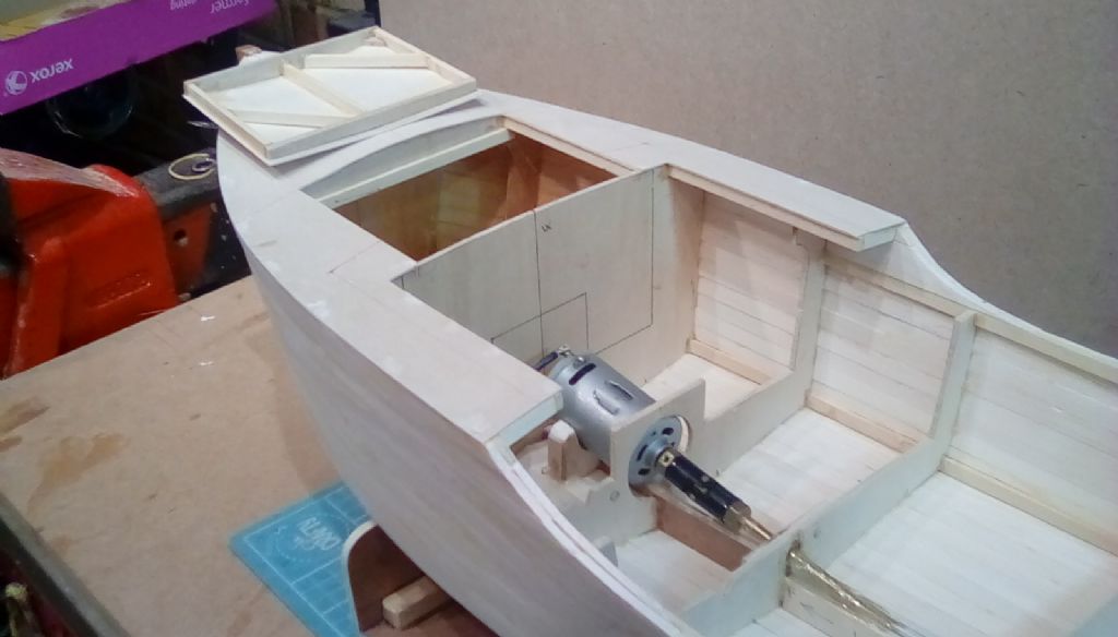

                                        A milestone reached with this one today, foredeck on with a removable hatch, there is a knack to building them in situ and you hope after the glue sets it is still removable !! Old brushed 600 motor installed for luck 😀 good old plodding power, I have a similar set up in my 30" Silver Mist it's one of my favourite boats on the water.
                                        Pictures to follow I forgot to put them in the album !!

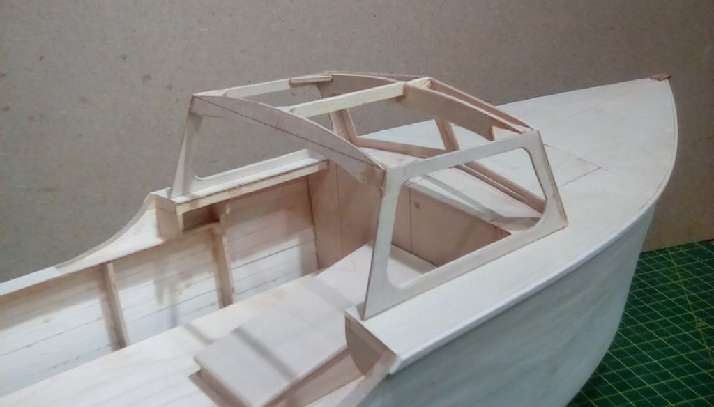

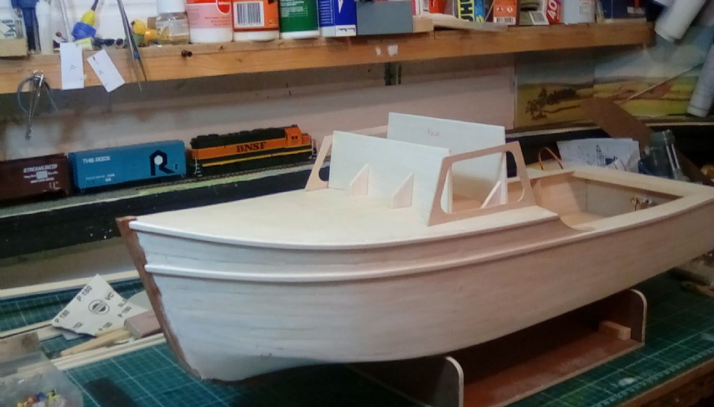

                                              Tonight made a start on the wheelhouse or should it be called a cuddy ? Hard graft cutting out the window openings in the sides of 1/16" ply, have arranged a sort of jig to set the sides at the right angle, I will be building the roof and front screens in situ to make sure it fits 😀
                                              USA night on the railway tonight !!

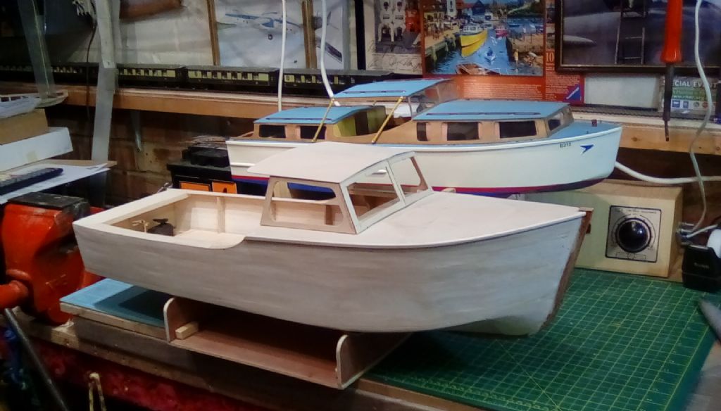

                                                    img_20200422_164648.jpgHi Mattias & Peter,
                                                    Yes I'm pleased with the progress i'm furloughed from work at the moment so plenty of time is available 😀
                                                    Having a tidy up and under the bench found my first published design Margoletta a freelance Norfolk Broads cabin cruiser, a free plan in Model Boats. June 2005, how time floats by, I must get her on the water this year when we are let out 😀I
