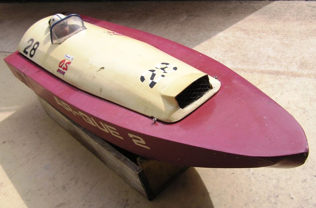

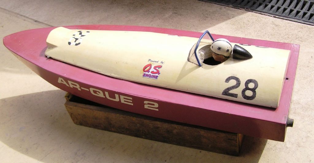

        p1010134.jpgp1010133.jpgHi Chaps

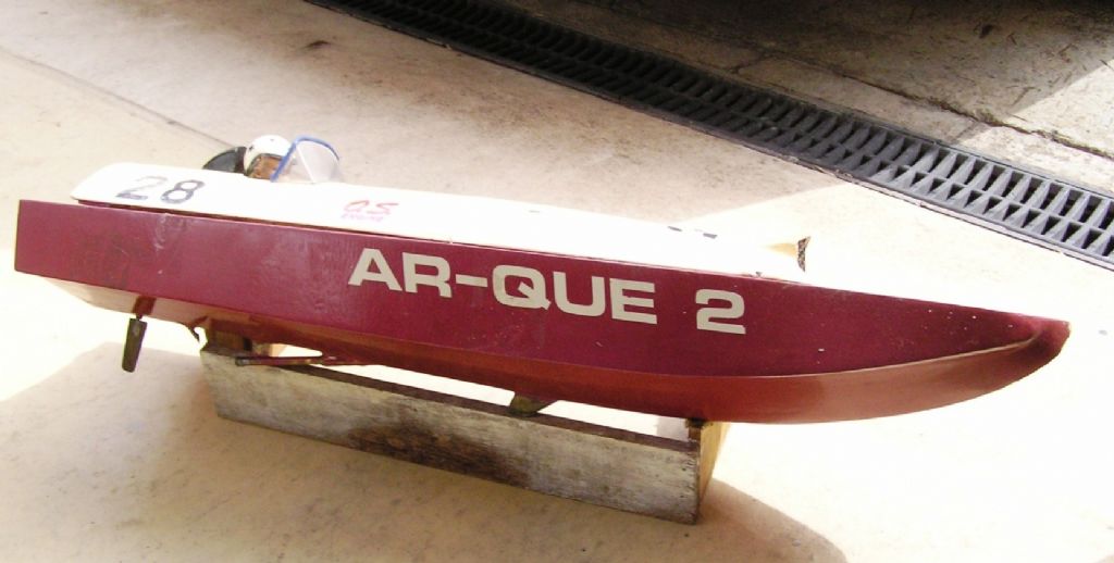

        Well another day another boat.
        Swap for other model boat stuff because I like the look of it!!!
        The top is very rough, so a new top.
        Add a bit more flare to the top as well.
        Checking out the spare parts bin to see what I can use.
        I will make a motor mount which takes 28 and 35mm motors.

          Hi Harry. I can see why you like it. The top is a bit retro and almost needs a fin on the back! (And removal of the water scoop at the front, seeing as you won’t need that feature with an electric motor)
          might look nice with a bit of veneer on the deck for that shiny wood look, and a few more exhaust pipes at the rear…

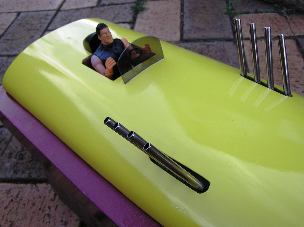

            Leaving the deck the same and adding a new yellow top.
            Eight exhaust pipes sticking up in the middle angle back a bit.

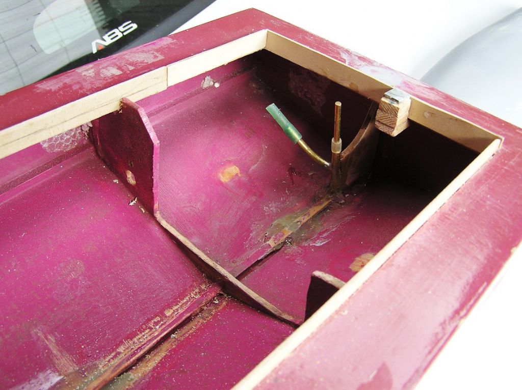

            Strip out the IC motor and pipe.
            Started stripping the motor mounts.
            The dremel is getting a workout.
            Only 4 motors in the bin.

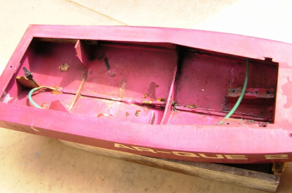

              Hi Lads
              Strip out the OS40 IC motor, tune pipe tank and starter belt.
              Weight 800 grams !!!!
              Weight of the 28mm brushless, ESC, Lipo battery only 400 grams.
              Next is the driveline, but the small turn fin drop out.
              I was going to remove it in any case.

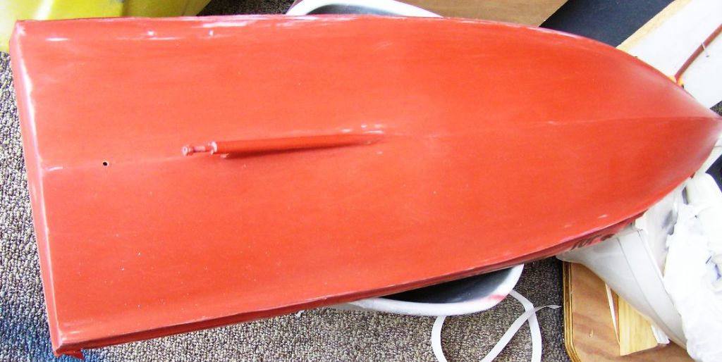

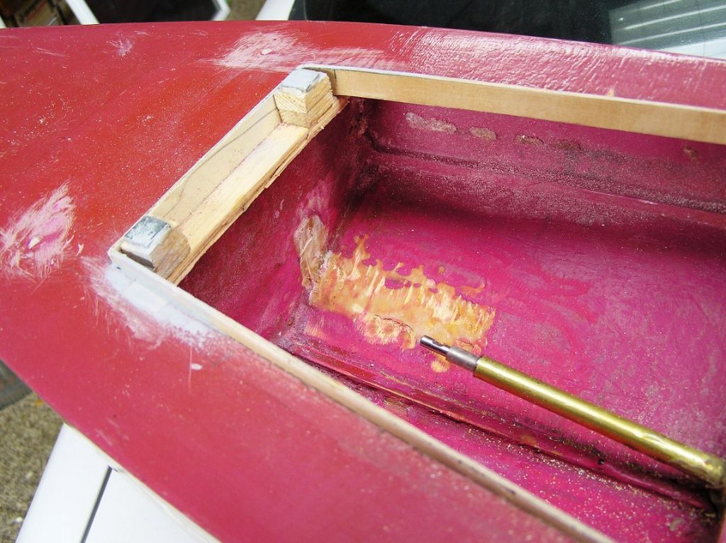

                Hi All
                Added new drive line and removed the old IC mounts.
                The bottom was in good kink with only a few repairs.
                Also removed the water pickup.

                    Hi Ashley
                    It's only 225mm wide with the chine rails built in.
                    I think it will be a dry running boat in choppy water.
                    Started on the new top and adding combings to the boat.

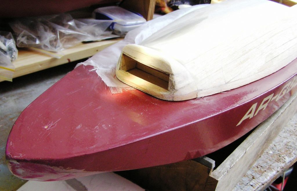

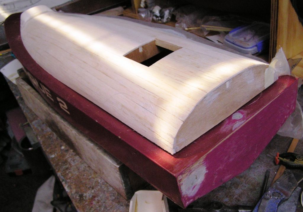

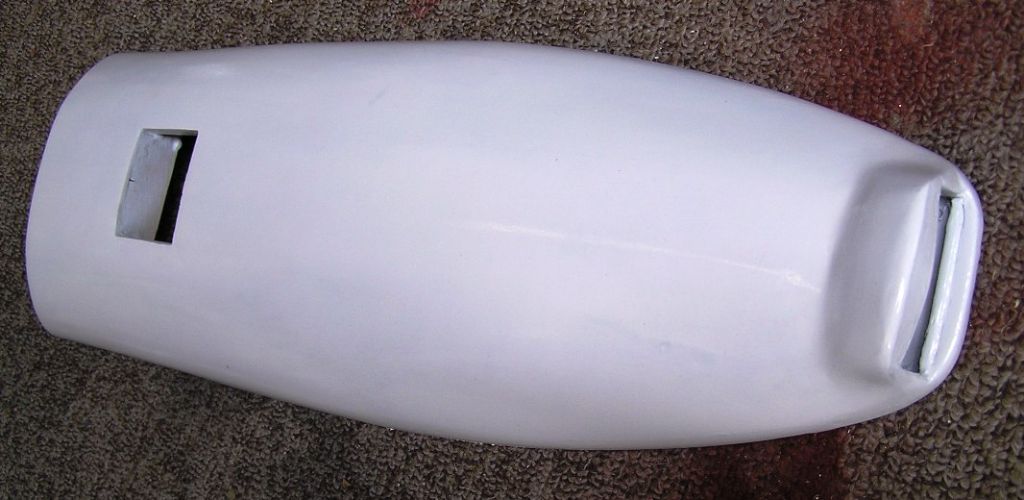

                      p1010139.jpgp1010138.jpgHi Lads
                      Working on the new top ready for filler/undercoat.

                        Harry. Keeping the open mouthed look I see for the top?
                        another success finding yet another DM driver!

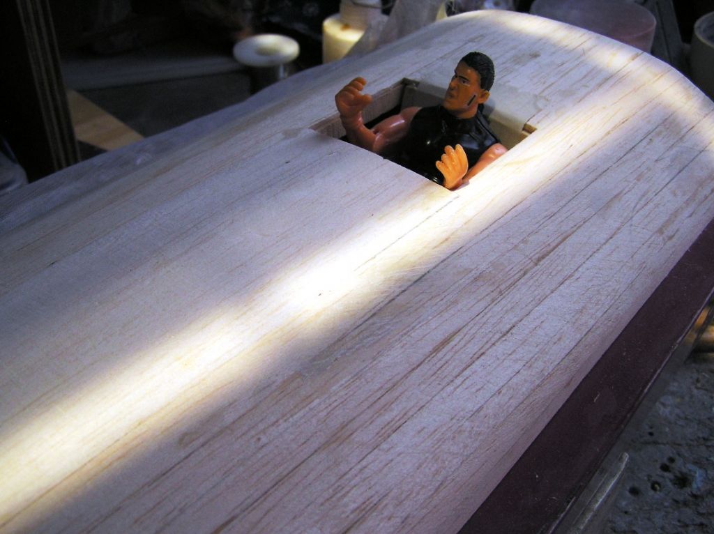

                              p1010145.jpgp1010144.jpgHi All
                              Added all the combings and my three double magnet setup to hold down the top.
                              White undercoated the top.
                              Going to change the windscreen, it does not look right.
                              Chopping up some pipes to make it sing !!!!
                              Harry

                                that looks better Harry. The top hatch is a bit small?.?
                                we have some teardrop clear acrylic ..decorations, I suppose they are…you put something inside to make a Christmas tree decoration (or woteva), but they make fabulous streamlined canopies, or scoops, when cut up a bit.

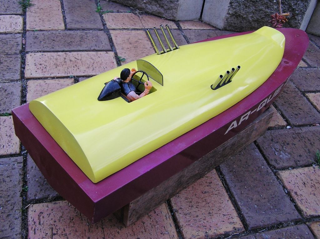

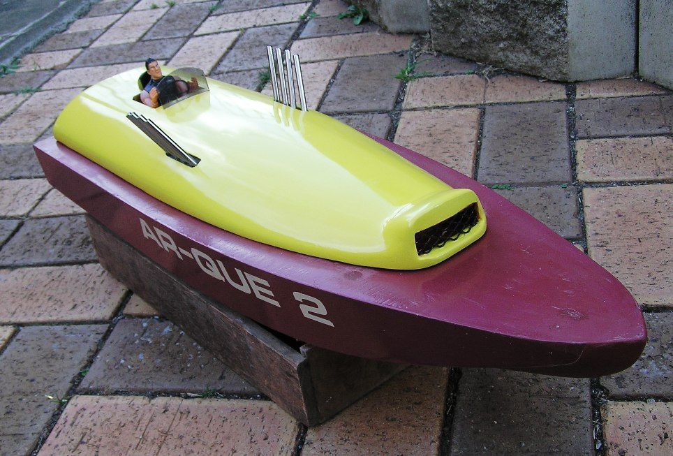

                                  p1010148.jpgp1010147.jpgHi All
                                  I finished the boat, tested running gear but having problems with the low speed on the motor.
                                  Check all the ESC settings, all OK.
                                  Battery fully charge.
                                  The same one I use in the Huntsman.
                                  Motor or ESC ????

                                      HI Ashley
                                      I am not planning to do up the deck and sides at is point.
                                      Test run the boat and the ESC died !!!!
                                      The boat run OK and very good on the turns.
                                      The motor was only going about 40% at the time.
                                      Change the ESC and replaced the motor with the 35mm 2400kv.
                                      Bench tested and sounds a lot better.
                                      DM handle the boat very smoothly and cool !!!
                                      Harry

                                              Hi All
                                              Ran the boat today is choppy water with the 2400kv 35mm motor on 60% throttle and a 3S 3700mah Lipo.
                                              Sat up on the plane and was fairly quick.
                                              The boat was totally dry inside.
                                              The chine/spray rail works great.
                                              I am afraid DM got his hair wet, but he did throw the boat around pretty good !!!
                                              Harry
