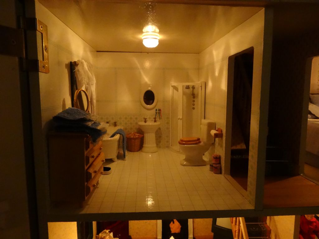

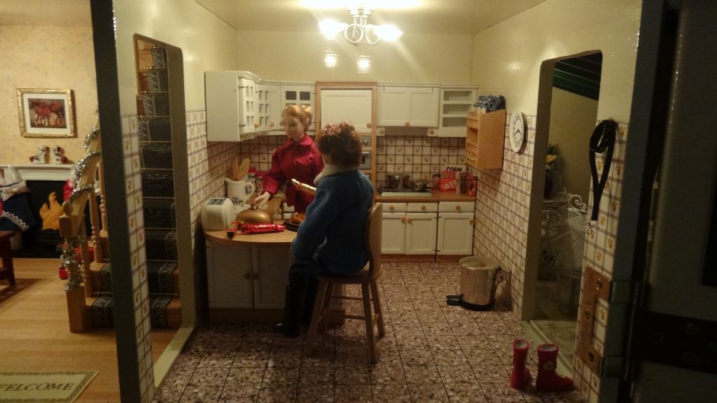

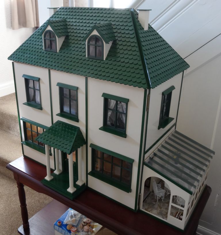

            1:12 scale dolls houses are lovely models to build, here are a couple of photographs of the last one I built, the Artesania Latina "Linda".

              love your dolls house, I currently have 2 that I built myself both in 1/12th.
