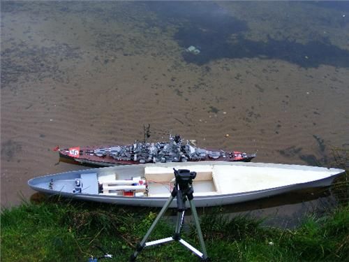

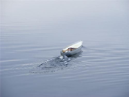

          Modelman
            @modelman
            http://www.modelboats.co.uk/wp-content/uploads/sites/5/images/member_albums/3926/home_aug_103.jpg
            http://www.modelboats.co.uk/wp-content/uploads/sites/5/images/member_albums/3926/home_aug_112_0.jpg
            hello again i used the electronize motors and a 6volt sla battery 36mm brass props from CMB and it works a treat, steers well no (mixer fitted ) also steers well without props turning,quite surprised actually. check this link and see for yourself did a flat out run and motors slightly warm? http://www.youtube.com/watch?v=hDcPCEI3ybA
            #15882
              Modelman. Love the video, as you say seems to go well enough, but it looks very light at the moment (obviously as its not finished) , did you try it ballasted down to full displacement or does the vid clip not give us a true estimation of the freebaord etc etc ?  I agree with the steering well when not under power, all my ships seem to turn on a sixpence when I stop the motors (the ones with several props and only one rudder, that is)  I have a theory thats its something to do with the propellers not turning….hhmmmmm  Ashley
              #15894
              Modelman
                @modelman
                hi ashley no it wasnt ballasted still needs bracing before i do that,i did notice a fair amount of flex when handling boat.i was just proving motor/prop combination before i go further.   pete
