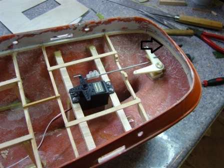

                Hi Charles
                Thank you for the link,
                I have been talking to Barry on and off for some time with regards to the lady “T”, my problem is the when I have tried to work out just were to fix the deck supports for the part of the deck that covers the rudder area. the part that I am talking about I have marked, the photo is of Barry’s Lady “T”
                Fred

                  Hi Fred,
                  Use a straight edge on the deck beams to project the location and level for the deck support strip round the inside of the stern, I’d use 1/4″x 1/4″ balsa or spruce strip cut half way through to take the bend and epoxy in place.
                  The deck shape I would establish with a card template to get the right shape before you cut the deck which I’d do in 2 halves  joined on the centre line, I hope that helps ?

                  Fred Ellis 1
                    @fredellis1
                    Morning Ray
                    Thank you for confirming my idea of using a profile led strip to achieve the deck line, as for the deck this is my second attempt to fit it, in the past fittings the deck has just been dry fitted, but has never looked right, that is why I am remaking a new deck subframe.
