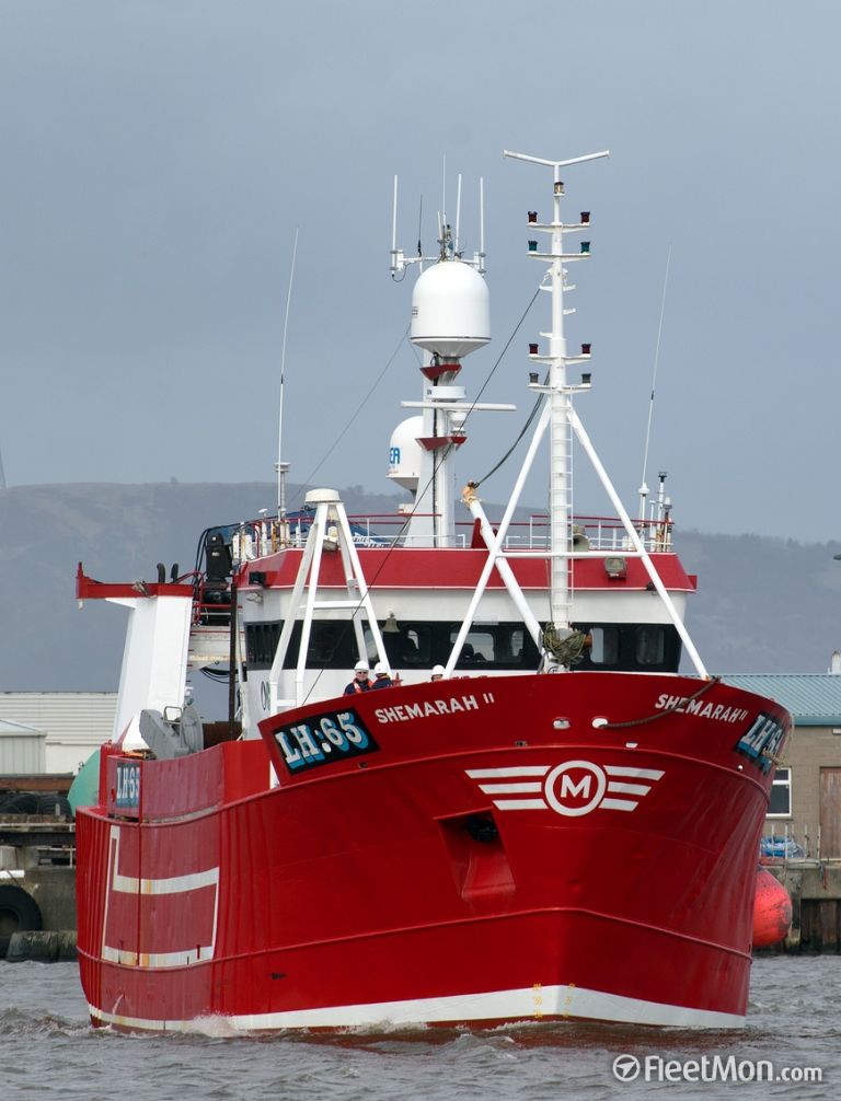

              I had the same problem when I was building my model of Shemarah. There were lots of photos of it on the net but none showed the colours of the lights very clearly. I eventually found a couple of pictures that seemed to give me a definitive guide. I guess Maggie M would be a contemporary of Shemarah so must follow the same rules. Shemarah has been judged in some fairly serious competitions and nobody has told me its wrong (yet)
              The picture below shows Shemarah head on and, as best I can judge the foremast/derrick lights are all 'all round' ones and starting from the top and working down are:-
              A single white light which must be obscured to some degree by the mast if it is an all round light
              A pair of red lights
              A pair of green lights
              A pair of white lights
              There is a single rear facing white light in the mast/ radar mount which is mounted on top of the wheel house and maybe compensates for the white one on the mast being obscured from behind..
              There was a better photo but at the moment I am unable to find it.

                  Gareth: Thanks, that is a great help, I still need to find out what the forward facing colour of those on the funnel are.
                  Mr Woods: Yes 'Maggie M' is a trawler, and as far as I know, catches 'fish', a fishing vessel?!!! As per the above photo I now believe that she would carry both red & green lights covering both eventualities and a masthead light.
