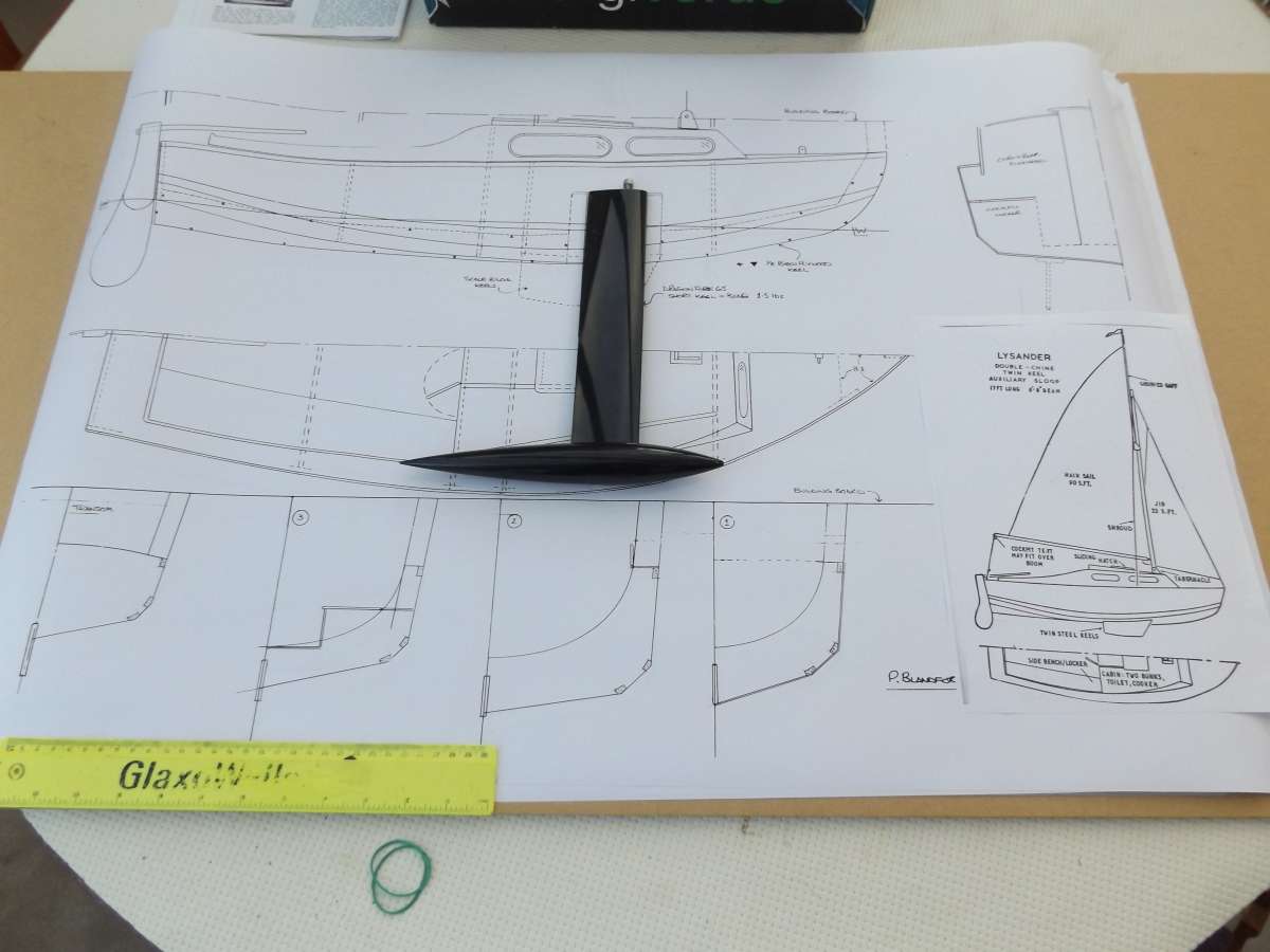

      With new found building momentum this is the next project, she is double chine this time a first for me, I have a set of full size plans my dad bought at the 1963 Boat Show 🙂 The idea of using a a stock Dragon Force short keel may encourage others who didn’t fancy casting a keel, so here goes !!
      Drawing to follow when I find it !!
      #122964
        Found it !!Lysander 1 241024

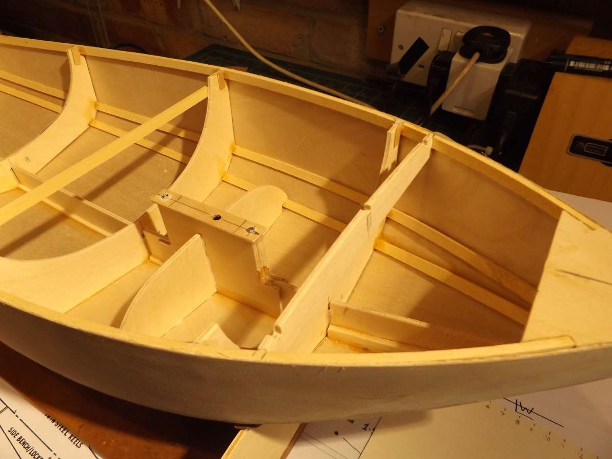

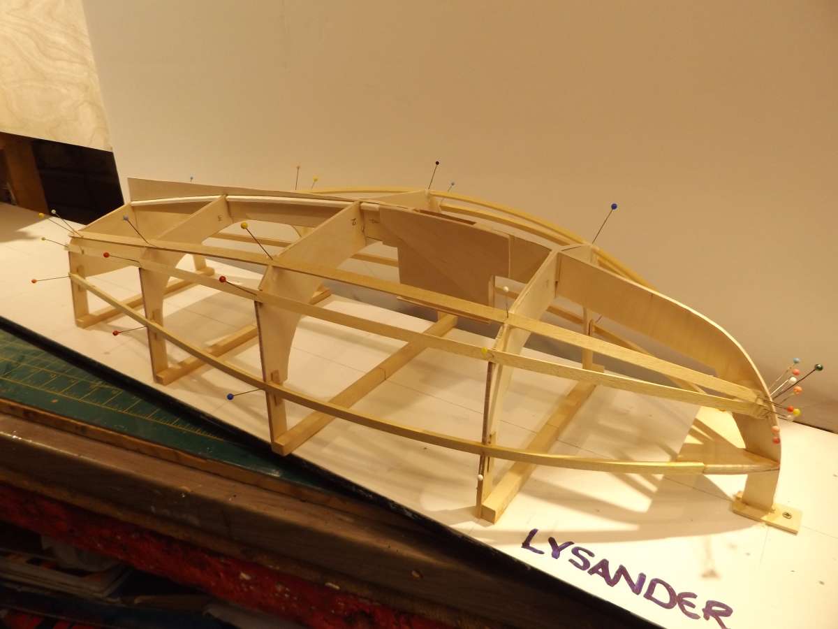

              I’m am strangely motivated with this build 🙂 a good day yesterday.
              The stringers and chine’s are just perfect flowing curve’s almost position themselves.
              I better order some sails from Frank at Nylet.
              Regards RayDSCF2730

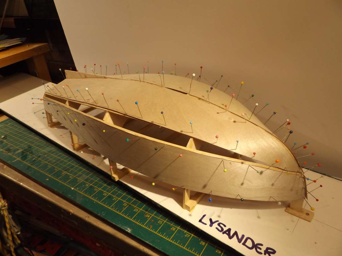

                  #123212
                    Hi All.

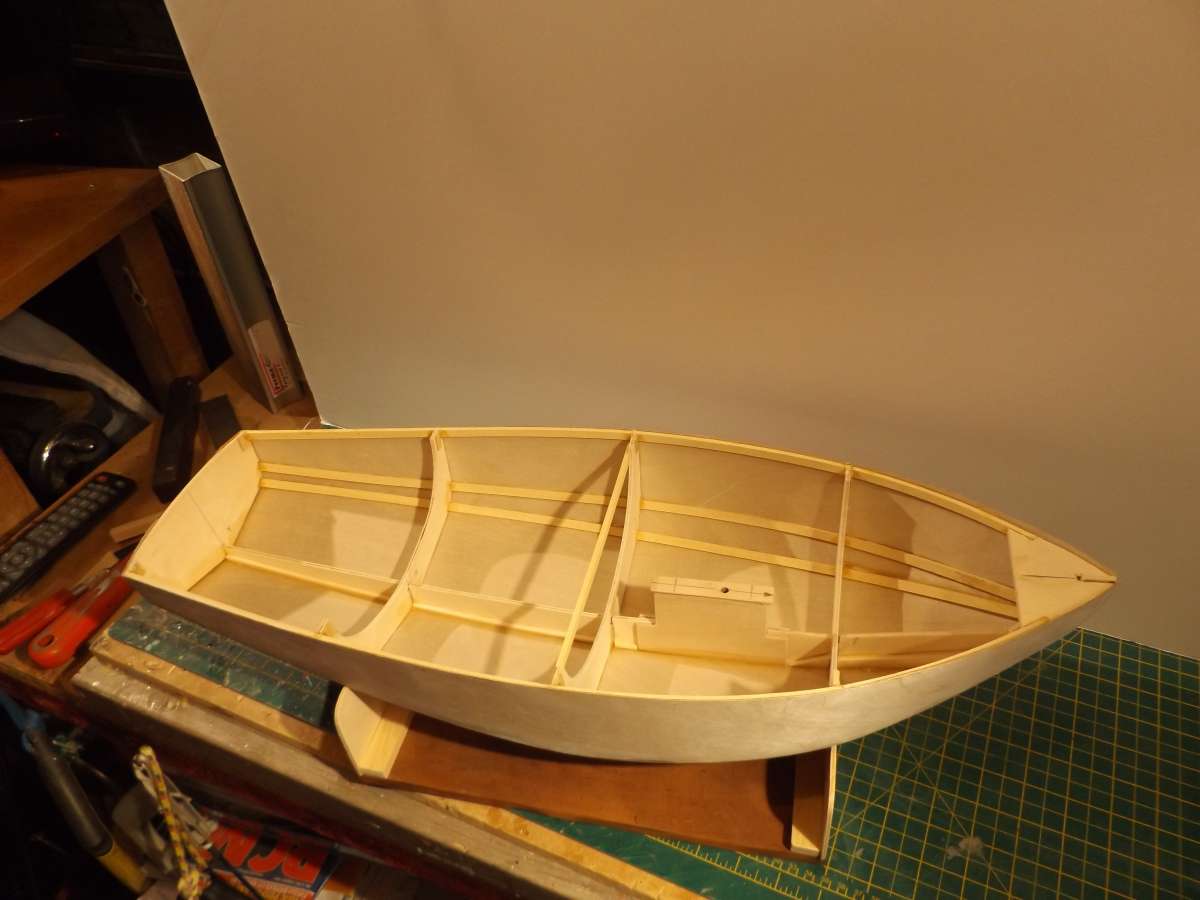

                    This is the tricky part !! but I think it will be alright on the night 🙂
                    Plenty of pins and 1/32″ ply my favourite part of the build .
                    Regards RayLysander 071124
                    #123236

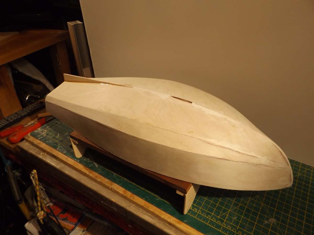

                      The double chine looks ok I think, yes Tim no blocks on this one 🙂 just following fullsize practice, all the skins were templated with tracing paper to get the shape, now off the board and on her stand, some supports to the keel box and the foredeck beam in place let the fun begin with the top works, new supply of mahogany sheet just arrived from Mantua models so here we go 🙂
                      Regards RayLysander hull inverted 091124Lysander on stand 091124Lysander kell box supports 091124

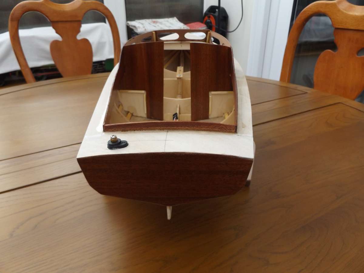

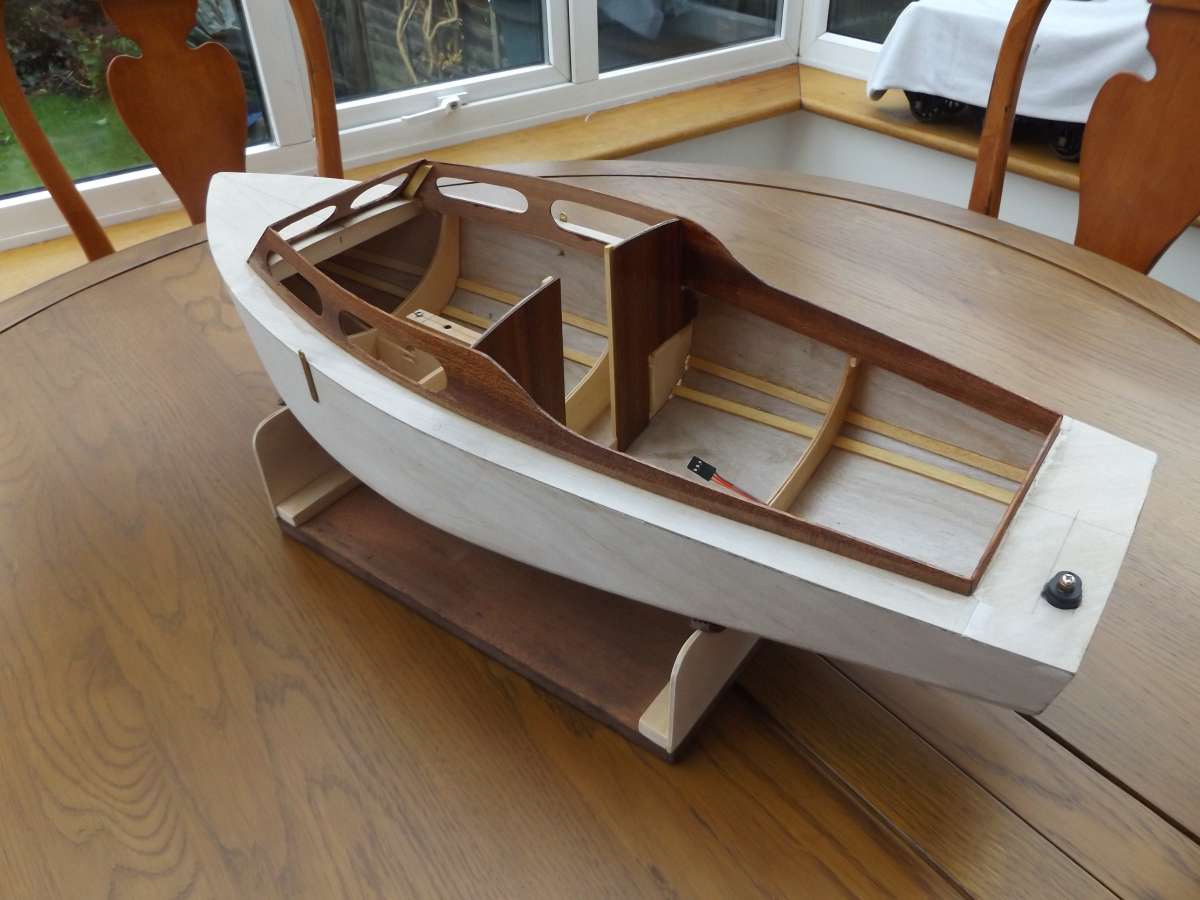

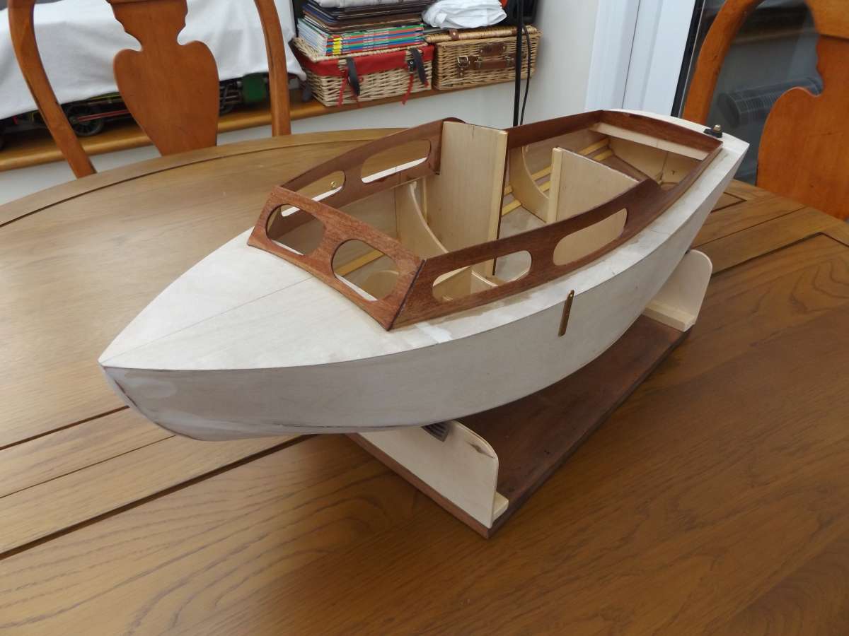

                            Each stage is making the this little one more attractive as a plan I think, I never get tired of the small home built designs of the 1960’s 🙂
                            Regards RayLysander port bow 191124Lysander port stern 191124
                            #123430
                              Spot on Ray, those little boats had so much character and love put into them and the wood construction gave them a ‘warmth’ and cosiness lacking in their GRP successors.

                                        Regards RayLysander transom 191124

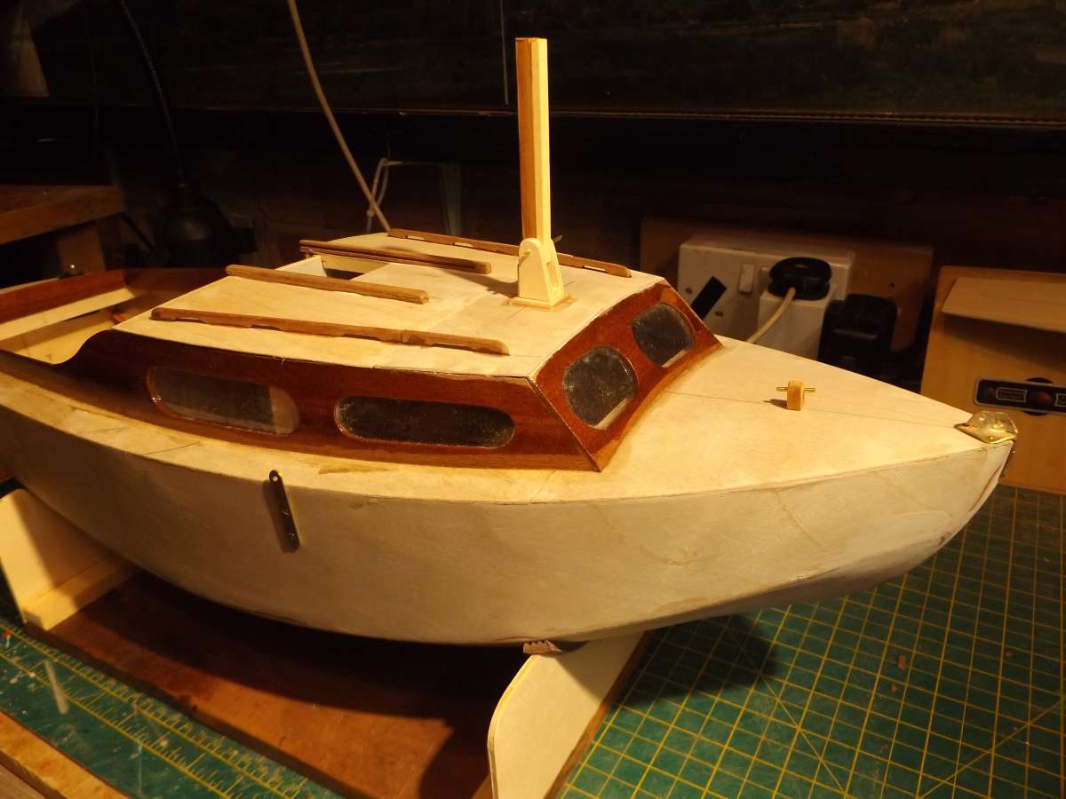

                                                      Lysander is storming ahead 🙂  Now Tim has kindly said he will make me a suit of sails , many thinks Tim
                                                      Now at the trimmings stage with plenty of mahogany brightwork to varnish 🙂
                                                      Regards RayLysander 241124
