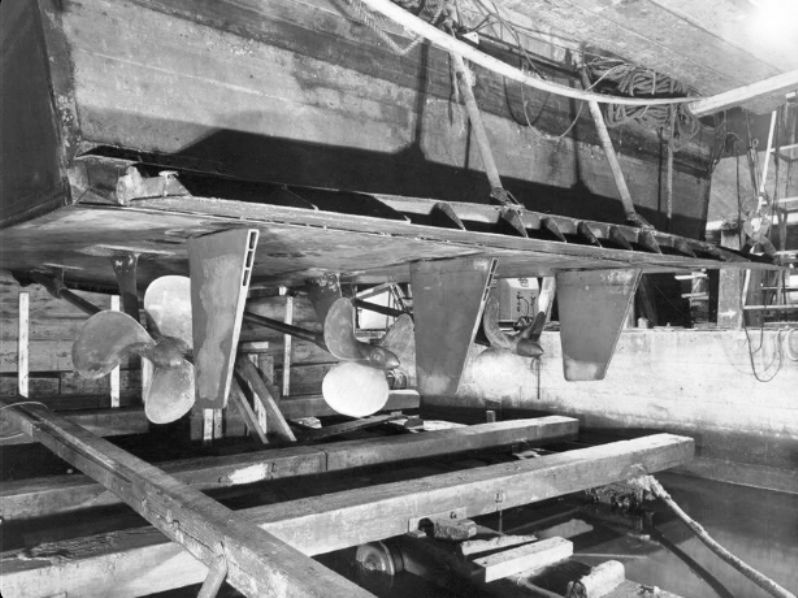

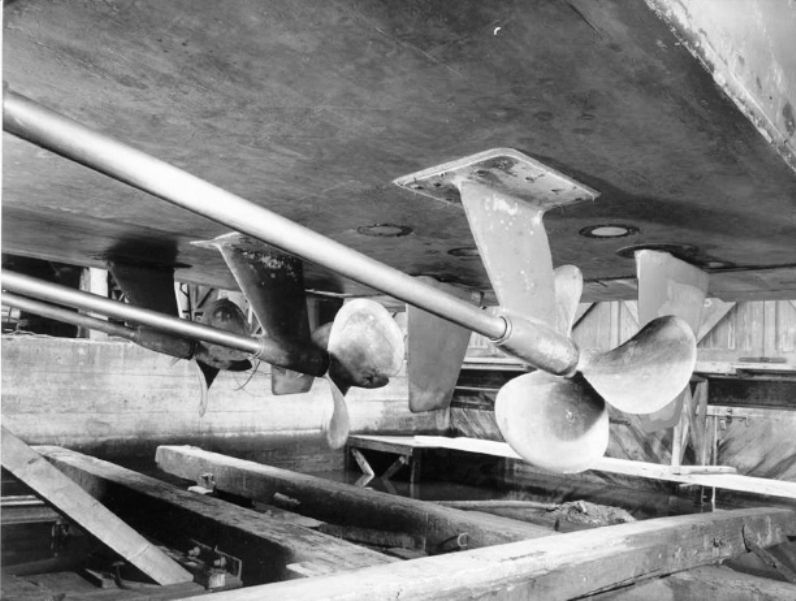

                      cc8.jpgHi JC
                      Two photos of the rudders on the real boats !!
                      I do have the plans and the booklet from the Precedent Perkasa which covers both sizes.
                      These are a copy from an unstarted kit which I sold a few months ago.cc7.jpg

                      JC Camillucci
                        @jccamillucci58697
                        Hi Harry
                        Thanks a lot for your info : I've allready got those pics . My purpose is retrieve the original ones included in the Precedent kit.
