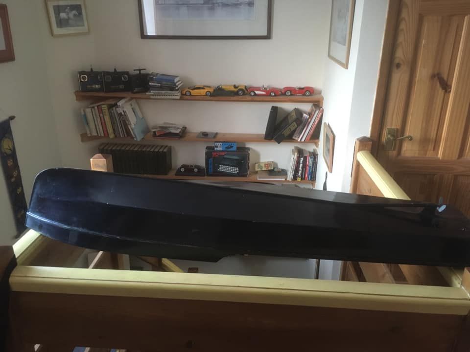

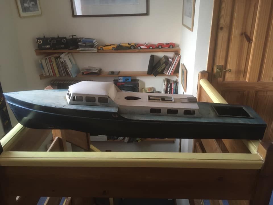

                  barbara2.jpgWell I have recovered the Boat from the back of Dad's garage.. and so have now got some photos.. it is of what I would describe as of traditional construction, that is made of wood, with a keel and formers with mostly planks on the side, it is over a metre long.. The prop shaft will not present any problems the Myford 7 in the corner will see to that! It did turn out to have a prop on it as well.
                  Radios are mostly Futaba, a LOT of M-Series stuff along with some later 35MHz challengers and Gold 7ch and a Feild Force 7barbara1.jpg. Disliked the newer 2.4 stuff so much (it seems the build quality on things like the sticks is now dreadful) that I converted one of my old M-6 TXs to 2.4 the multi model memory was not really something I was ever likely to use. I have more Glow plug motors than I would care to list! there is also a 'Taplin Twin' marine version in a aerokits crash tender (silimar size to this) originally a diesel it was converted to Glow Fuel with home made heads. But I would like to keep that where it is.. I have an assortment of '540' sized brushed motors. Ideally I would like this one to go brusheless having just replaced my OS FS40 in my Super Sixty with a 870KV turnigy motor.
                  The Hull appears to have a lot of weight in the bow, I am guessing my grandfather weighted it down to make it sit level?

                      Looking at the hull, it seems to be more of a 'planer' than displacement ? That being so, brushless with a good ESC and LiPo pack is probably the way to go. The experts on here will advise on motor size /Kv rating etc. as my experience is limited to small service craft with brushed motors and, electric gliders with brushless.
                      As you're into 'modding' radios, have you tried Hall-effect sticks – they are much smoother than the normal fare ?
                      On a final note – will it fit in the bath ? A floatation test should tell if any serious internal hull work is necessary before you fit it out with new equipment. Also, you can check out the trim fore-and-aft and any listing that may be present.
