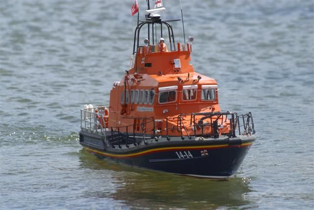

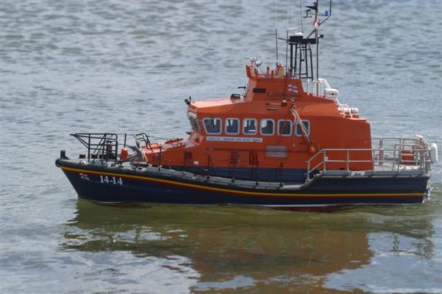

                I found the recommended motor/gearbox to be very conservative as the Trent couldn't go fast enough to get onto the plane, out of desperation I tried a pair of old Johnsons that were lying around and was very pleased with the outcome as they produced a perfect scale speed and exactly the correct bow wave without having to change the props that were supplied with the kit( which would have been a problem when it came to show time)
