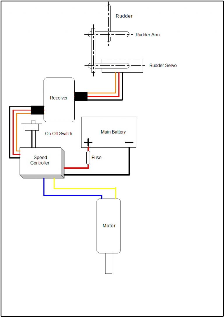

              #99417
                Hi Bryan, The ban is on all surface use so you cannot use a model aircraft radio set that uses 35mhz with either boats, tanks or cars at any time.
                Having said that you can get a very respectable 2.4ghz set for a very reasonable price nowadays with a receiver included so the only other bits you would need are a steering servo and a speed controller.
                As regards the basic set up, yes the speed controller will plug into the receiver port, usually channel 1 will be the throttle. You want a speed controller that is reversible, which of course all aircraft ones are not. The receiver can either be powered by a speed controller that has a battery elimination circuit so it also provides power to the receiver, or you can use a separate receiver battery supply. Either way it should be switched and you should have a suitable sized fuse on the main battery positive side.
                Steering servos simply plug into any other convenient proportional channel, usually the right hand stick left and right is used.
                This is a very basic layout diagram that you might find useful, using a speed controller with a battery elimination circuit, the elimination refers to the receiver battery:
