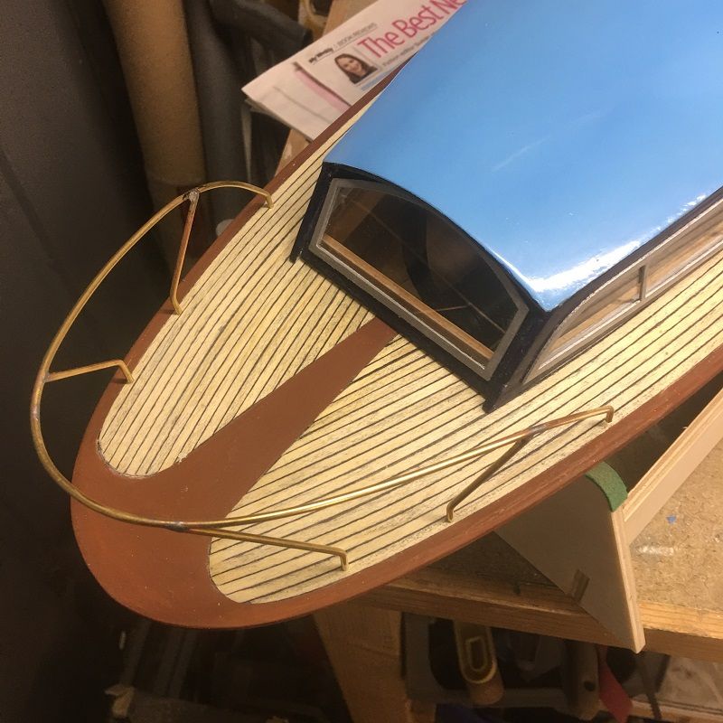

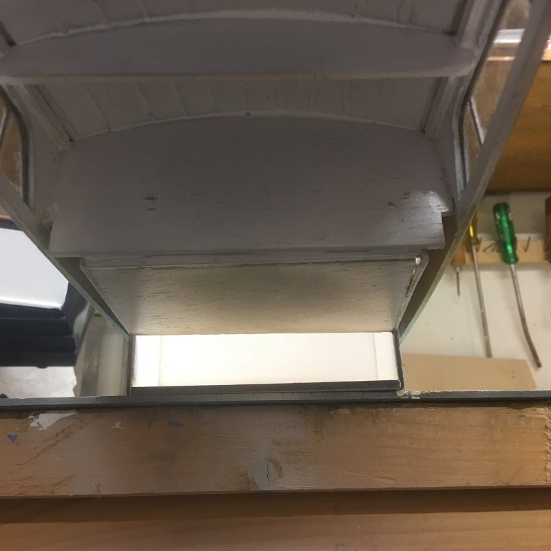

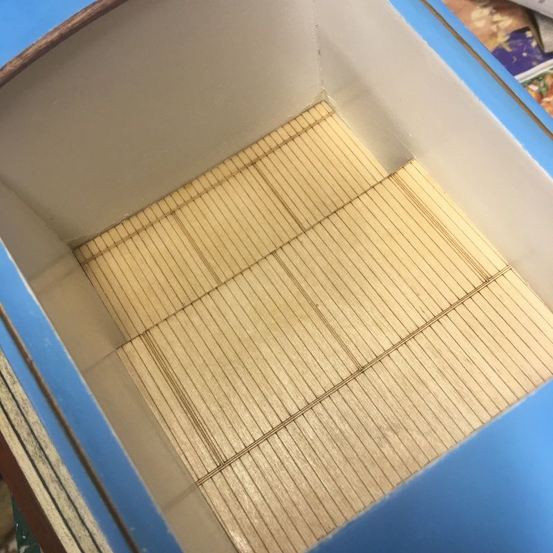

      A bit more progress I'm ready to fit the floors in the cockpit now, to help with this I left the riser out from the step down from the rear level, I can then slip the floor panel in after getting the fit just right, taking the paint thickness into account, I will then fit the riser.

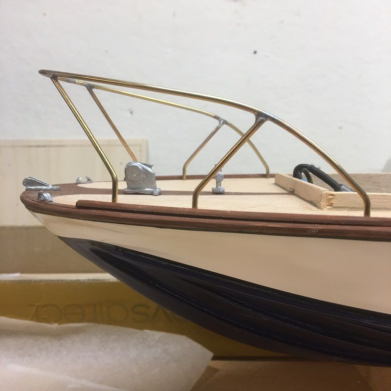

      I have also made the pulpit rails, i used comsol solder and it appears to be strong enough with a fillet allowed to form, when I get home I am going to make another one from stainless steel and silver solder it.
      just needs the holes drillingon Rogers boat.
      Regards.
