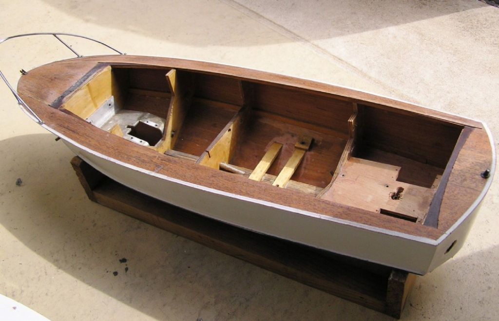

Hi Fellows

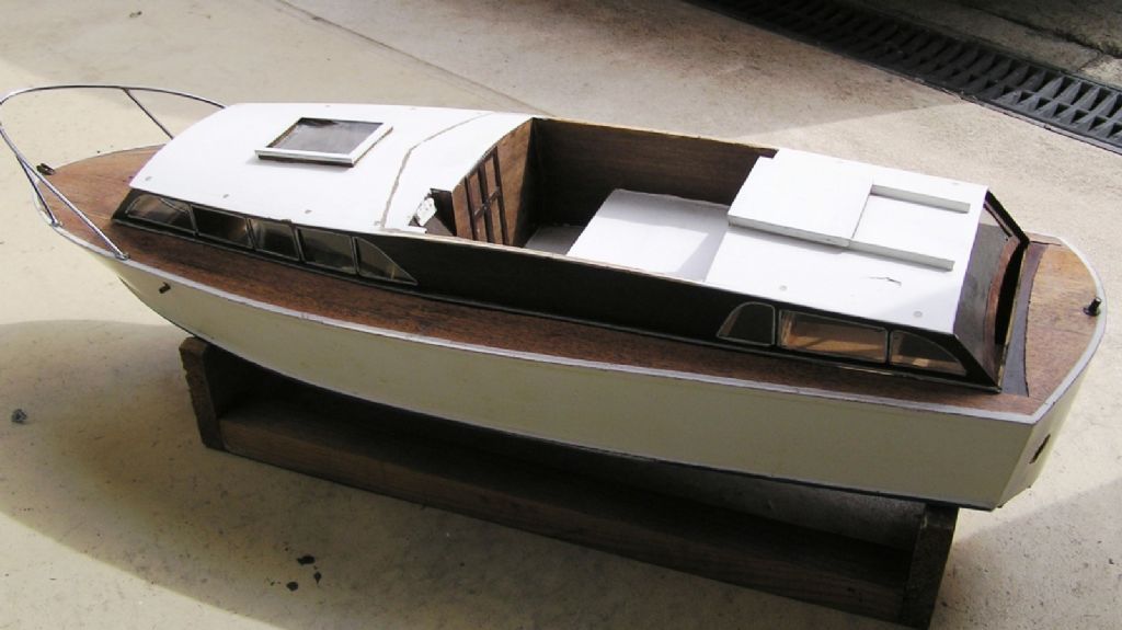

This one was too good and not used a lot.
Very clean on the inside.

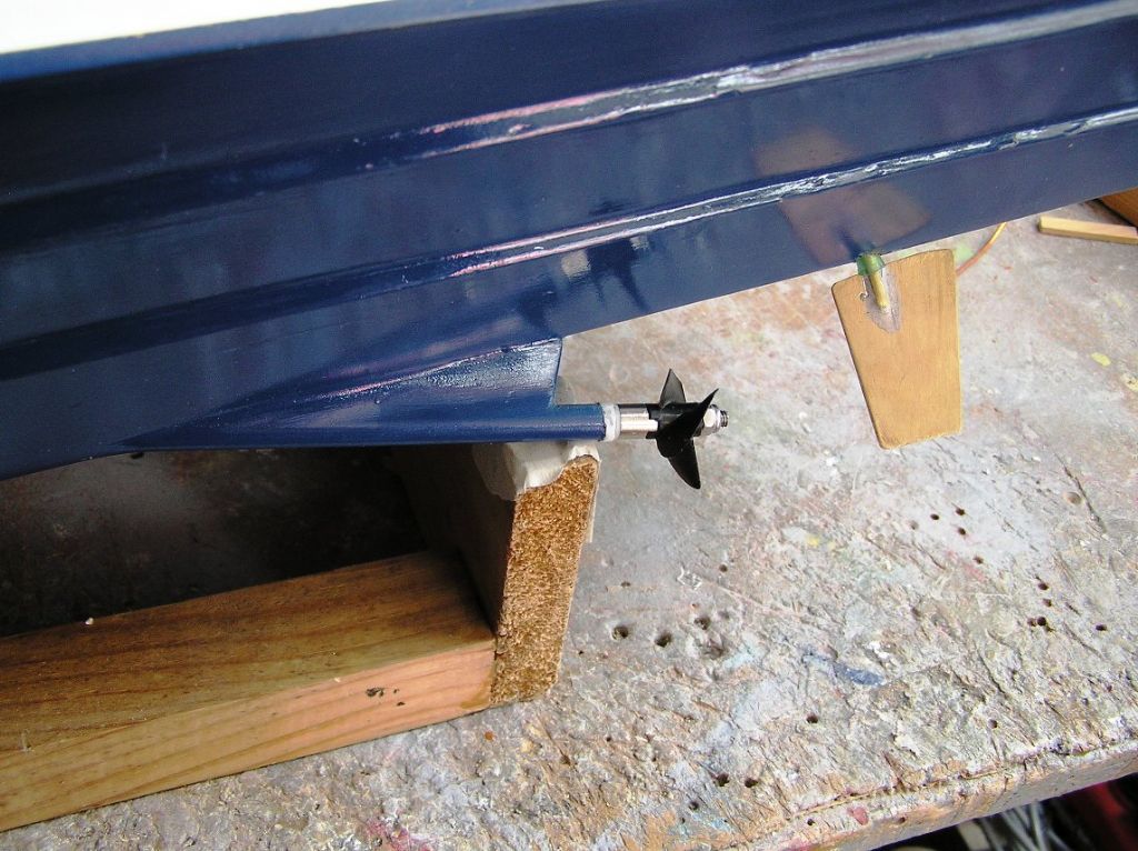

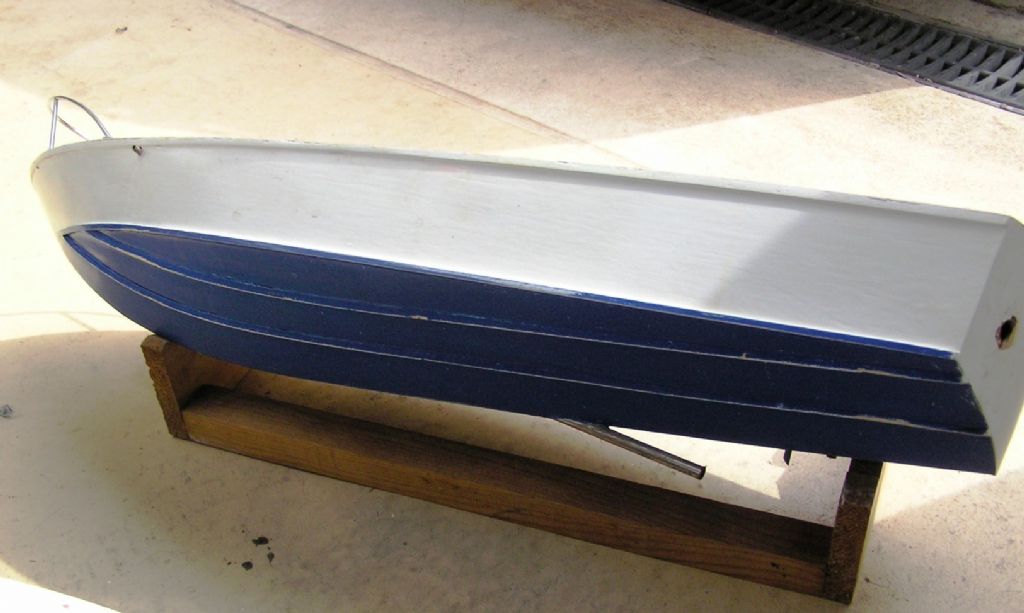

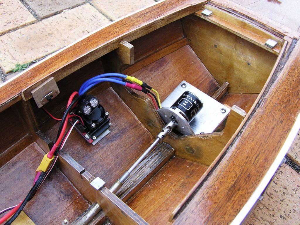

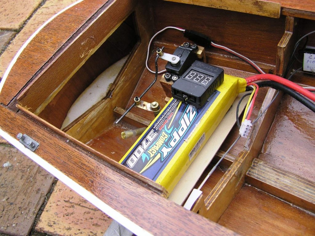

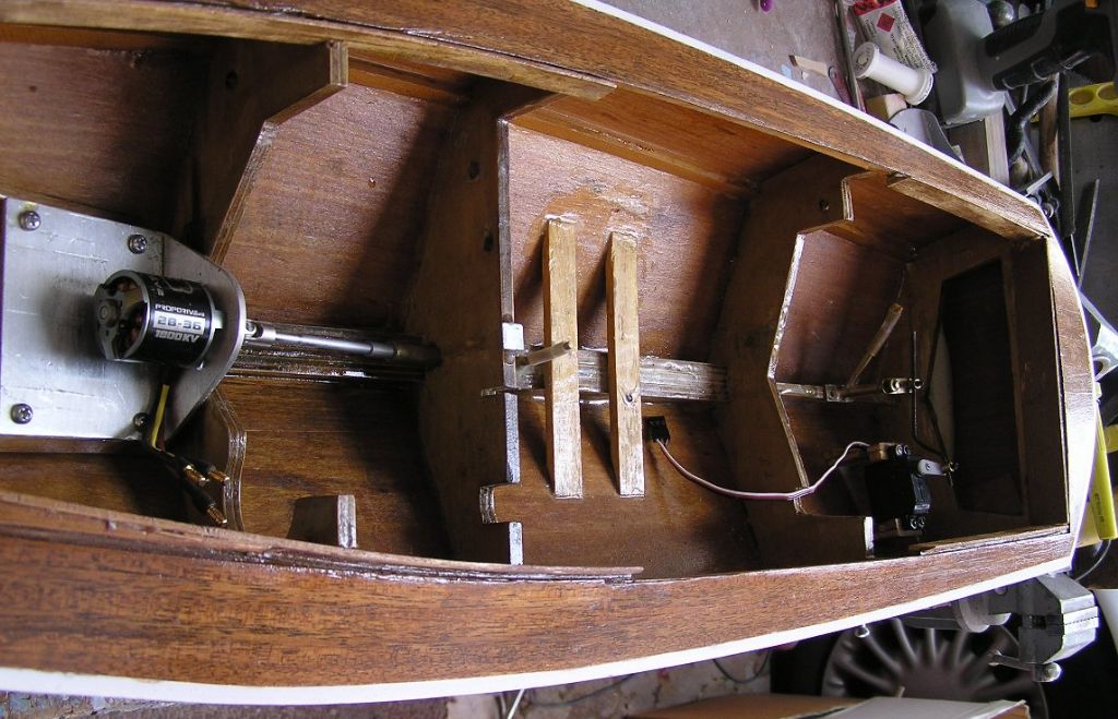

Did not have to remove prop tube because my bearings fitted !!!
Add a support under the tube on the underside.
The rudder tube was only screw in, so an easy fix for a rudder.
Fill in the water cooling inlet and outlet as well as the stern exhaust pipe.
Fill and sand the spray rails, also lightly sanded back the bottom.
Mask up ready to spray the bottom, tomorrow.
Made a new rudder.

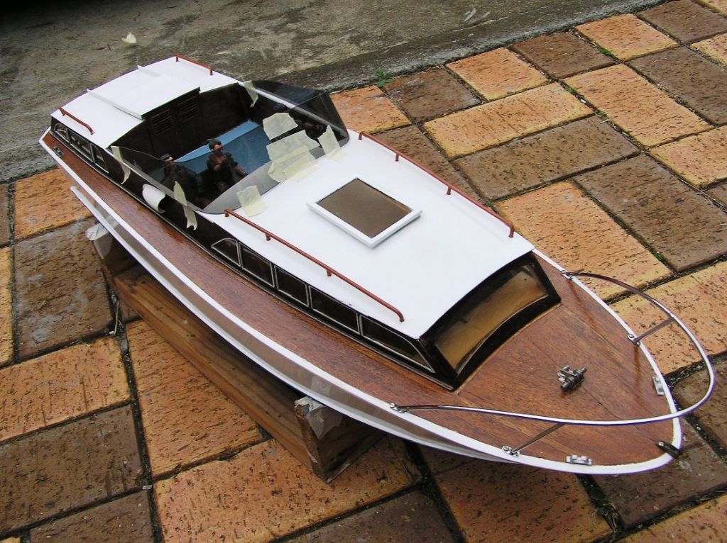

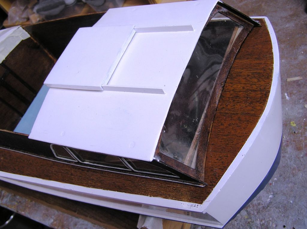

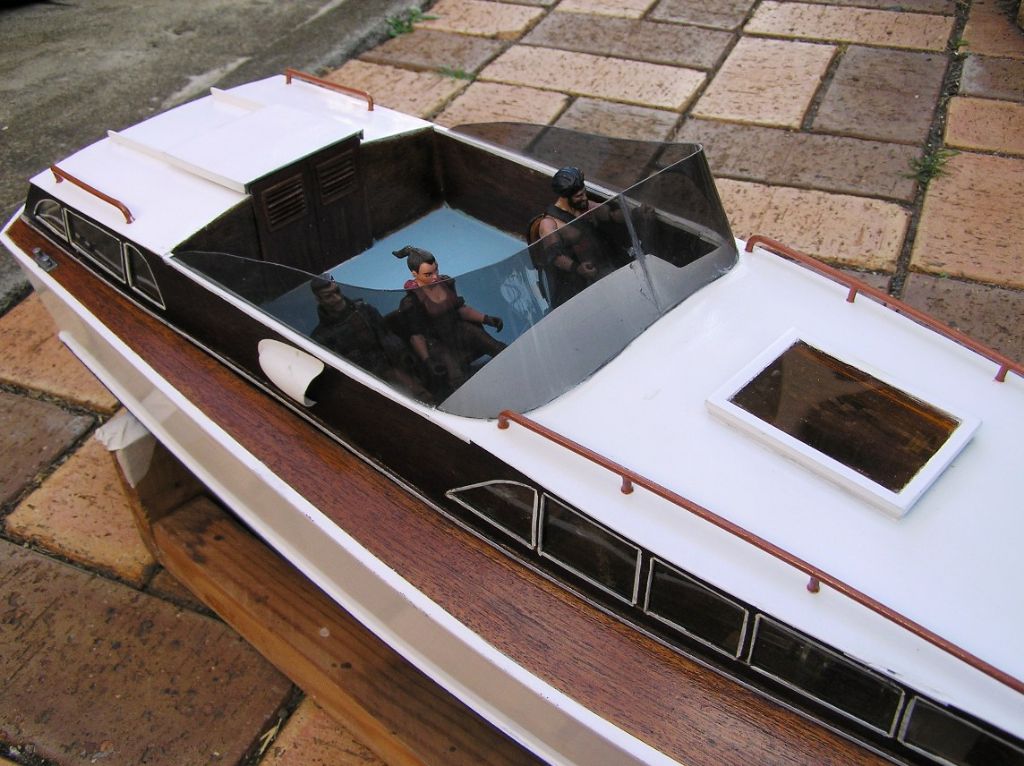

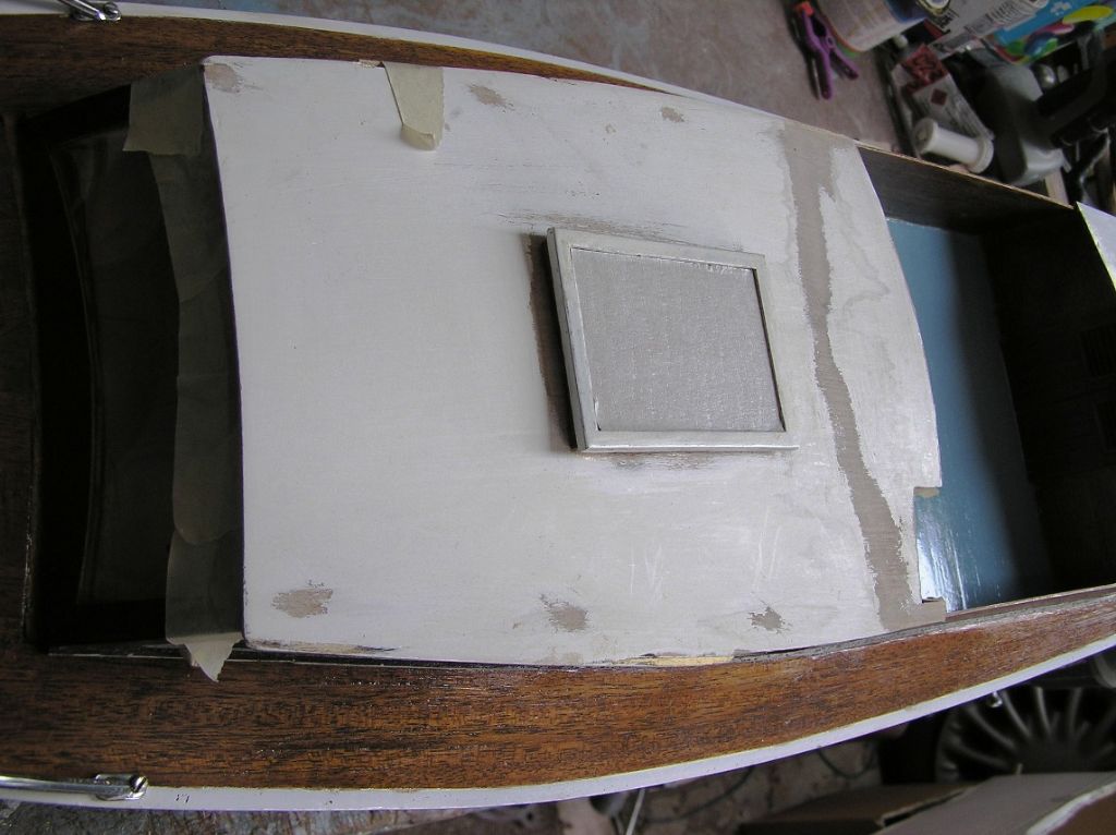

Onto the cabin which has both roofs with problems.
The stern one is only balsa, so I added more balsa under the damage area, glue and clamp it.
Fill and sand that tomorrow.

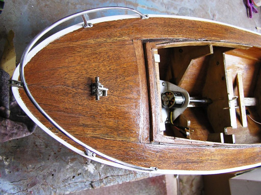

The forward one has missing edges and the hatch is a dog's breakfast (a mess).
Tomorrow is another day, so more work.
