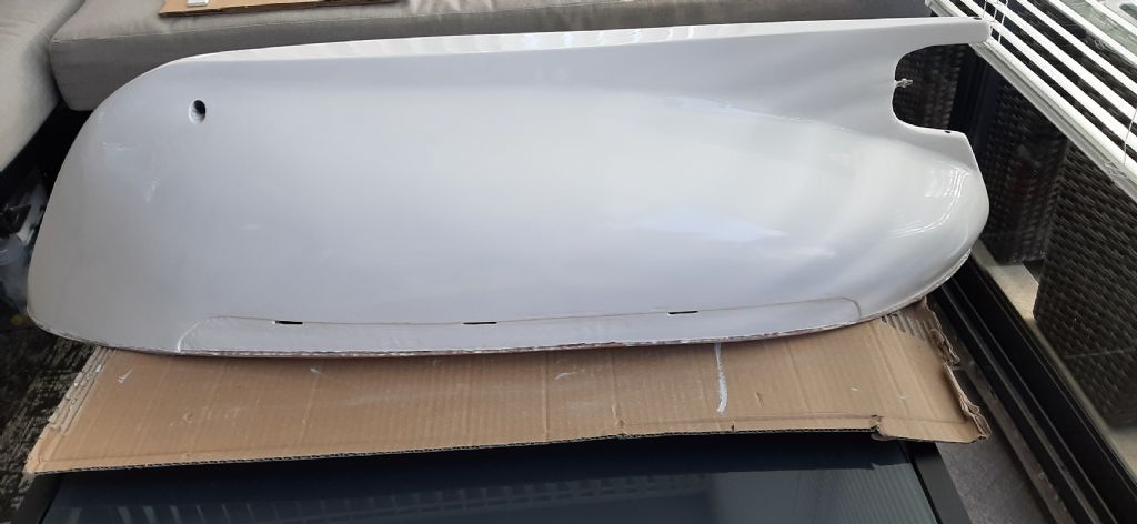

                                  A bit behind schedule as usual but the first coat of gloss white has at last been applied, Was out yesterday and bought three of the most expensive paintbrusshes ever! About £15 each. I think I will get a nice finish with these. The brush I used for undercoat last week was a cheap one and the surface looked like a ploughed field -of snow. Sanded off most of the undercoat each time (3) to try to get a smooth surface! I'm a slow learner, -or just too old to learn…. sorry.

                                    Edited By George Edward Connery on 11/07/2020 16:45:11

                                                Update 14th July: F34 hull received a second coat of gloss without sanding down the 1st coat -as per instructions on the tin. Today the hull was wet sanded with 240 and 400 grit. Looking better now. Not sure how much more elbow-grease will be deployed on the hull finish. Starting to get impatient -want to move on to some more fiddely stuff above the waterline. No new photo of sanded hull…looks the same as above!
                                                Many thanks to Eddie for the hull finishing info earlier. I have not wet sanded since repainting my 1967 Lotus Elan S3 Carnival Red in……1973crook.
                                                More gloss white next week, maybe the whole hull painted white with simply blue lines for W/L mark and boot top strip. Maybe I'll have blue 'antifouling' on the hull section below the W/L.
                                                Suggestions (polite varietyangel) accepted with thanks.
