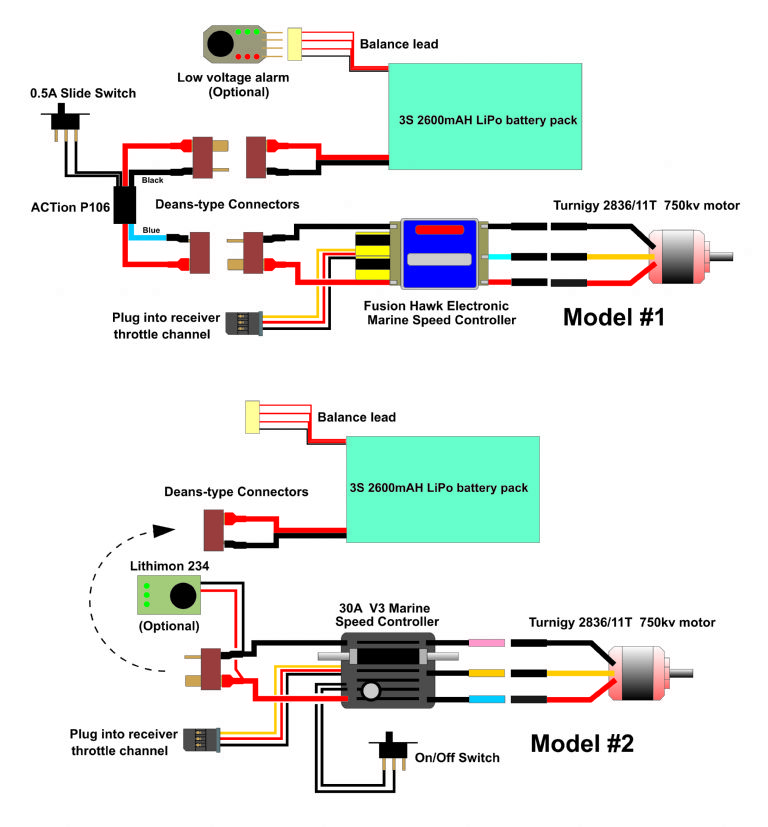

      Hi,iam new to modeling and in the process of building a sarik fairey huntress.Iam not having any problems with the woodwork side of things.I need a bit of advice on the electrics,which would be the best to get the boat on the plane.Tom

          Here are two alternatives, taken from the article. I've used both and they are fine. huntress wiring diagrams.jpg
          The Fusion ESC is the 30A version, obtainable from Cornwall Model Boats. The motor comes from Hobbyking and the Lithimon 234 monitor from Dawnmist Studios, while the other equipment is all from Component Shop. I fitted a 1.4" dia x 1.5" pitch 3-blade bronze prop from Protean Design.
