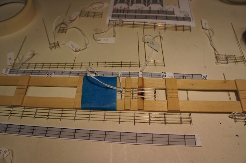

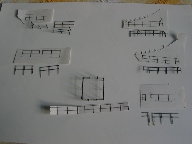

            I make 1/100 railings scratch for card models. I use 0.5mm brass rod, available from Squires in Bognor Regis. Check the catalogue, there are two different rods advertised – get the cheapest! I also use the brass wire from wine bottles – good excuse to buy it.
            I have made a former in wood and lay the lengths in this. The long rods are laid in a reccess cut in the wood using a fine saw. The whole is clamped over with a small block. The rails are eased out to length (gap required tween uprights) and an upright soft soldered in place. Ease out more, soft solder another upright etc. I then bend to shape with flat pliers, and finally cut when complete shape done.
            Claen up with file etc. Wash with iso propanol or equivalent to remove flux.
            The rail is inserted in deck into drilled holes and fixed using very small dab cyano. I paint them before fixing them.
            Ladders, ladders rails, handrails etc all made a very similar way.
            Kimosubby

                Thank you for your reply. I will follow the way you do railings as well, it sounds like another imaginative way to do them. It's great to have choices of ways to do something in this great hobby. Your pictures are very helpful for me to see how you do it. I will enclose pictures on this forum when i have started making my railings.
