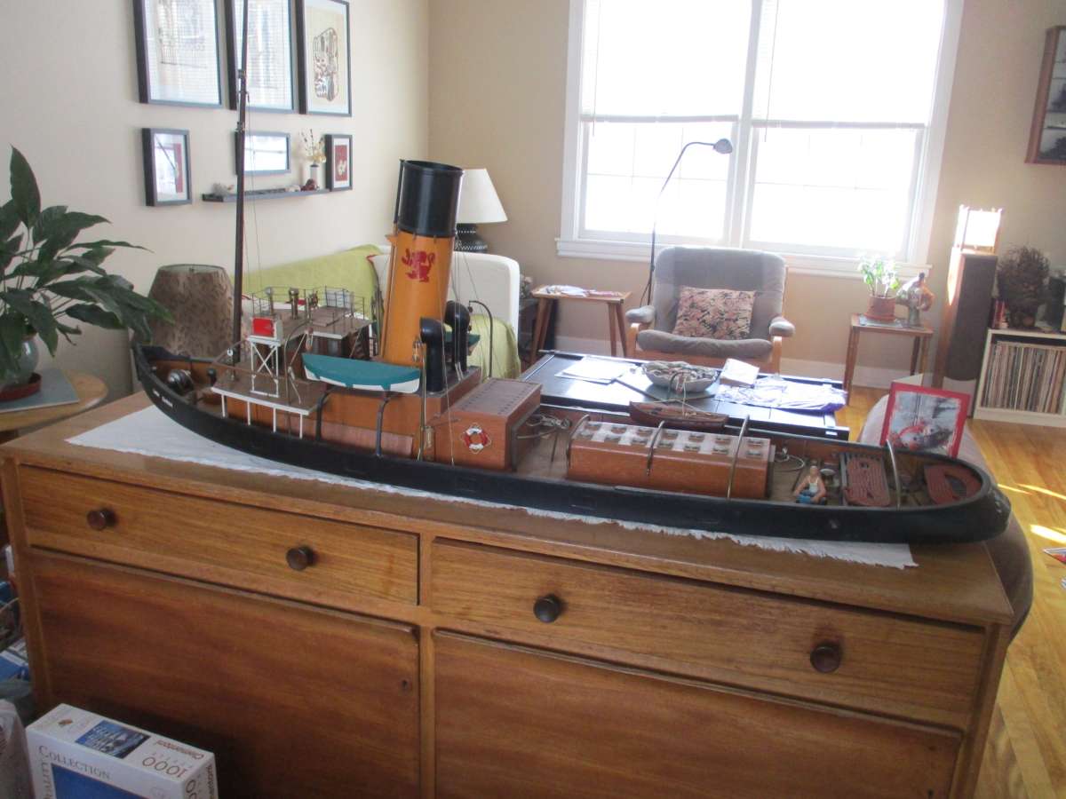

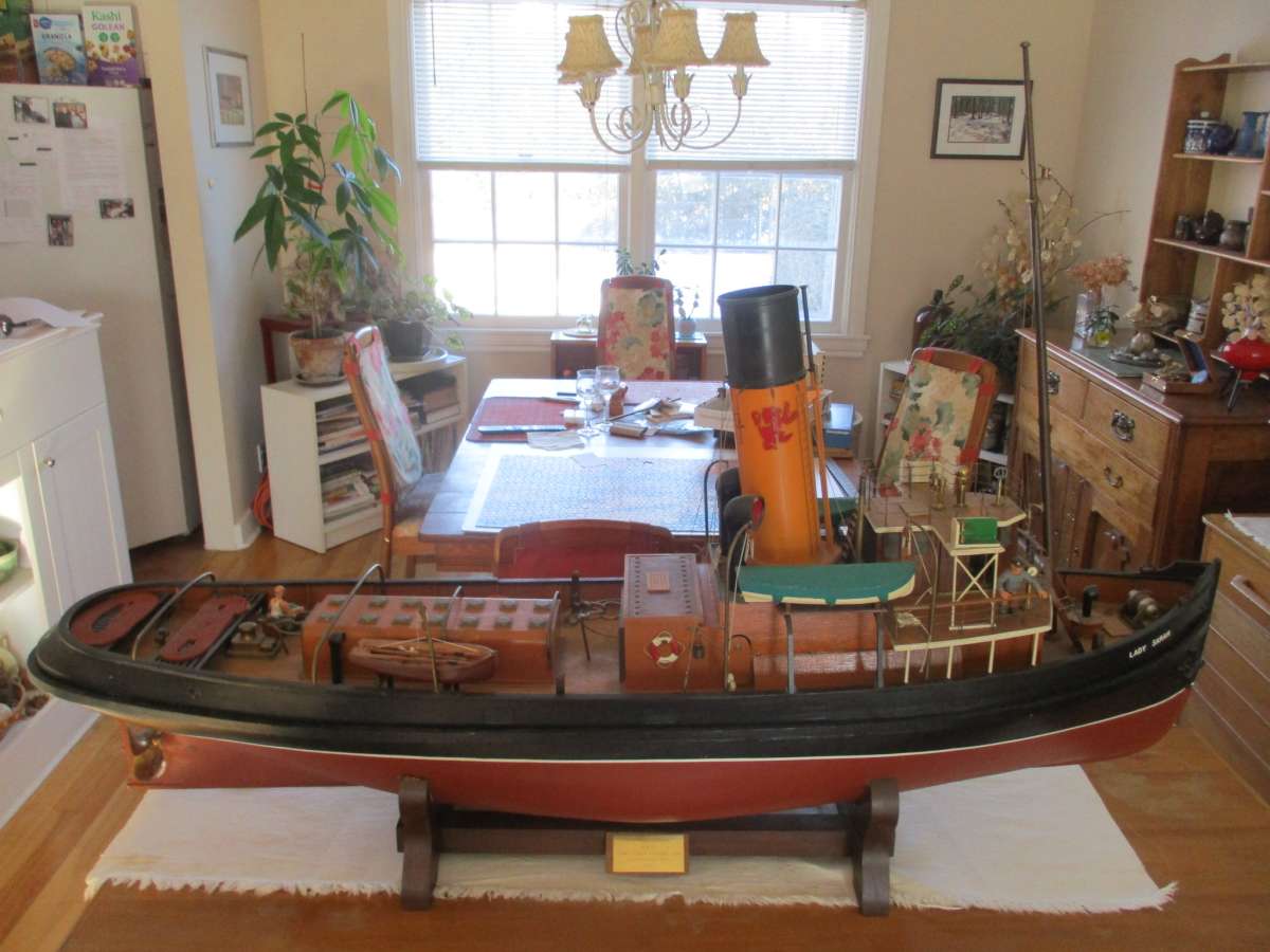

I’ve acquired a 52″ model tug (first image). The funnel sports Caledonian Steam Packet Company colours and the port of registry is Irvine, but this is just because one of the two builders was Scottish, and she is called the Lady Sarah, but this is only because the other builder had a daughter named Sarah. Many will immediately recognize the tug as the Joffre.
The builders obviously intended that the model be sailed. The tug came with a very nice double Stuart 10 and boiler installed on a test bed, and stringers sized to accept the engine were installed inside the hull. But that was basically it. For starters, the rudder was entirely cosmetic and as the stern was a solid block of wood, connecting the rudder to a servo was clearly left as a “future project”.

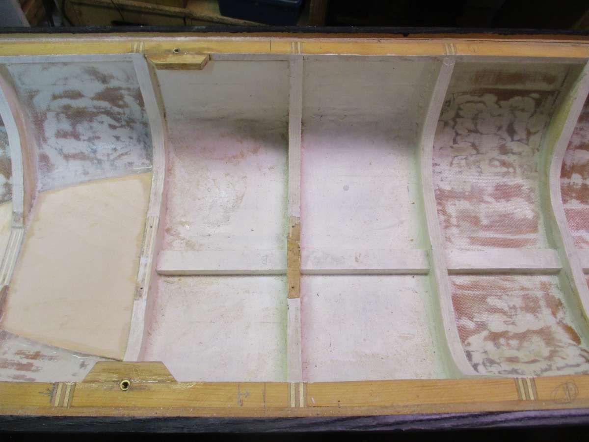

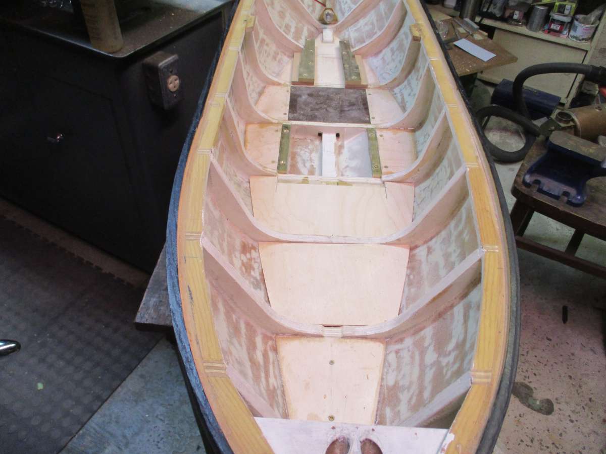

I’m now working on getting the boat in the water. Originally the (planked) hull was simply painted on the inside (central bays in the second photo). I’ve been working on lining the interior with fibreglass cloth impregnated with epoxy resin (right bay in the photo) and have also been filling in the bottom of each inter-rib bay (left bay in the photo).
The filling in is in part to give me a base on which to install things, but it’s also to avoid to have a lot of unconnected areas in which water can pool. I think the nature of the hull / superstructure joint is such that some water is bound to get in, and I want to have it collect in a single bilge where a pump can take care of it. The third picture shows where I’ve got to. The wood in a couple of the bays is not yet fastened down, but basically I’ve now a single contiguous “floor” with a bilge in the middle. The bilge covers two bays, but the aft portion of it is covered with a removable brass plate.

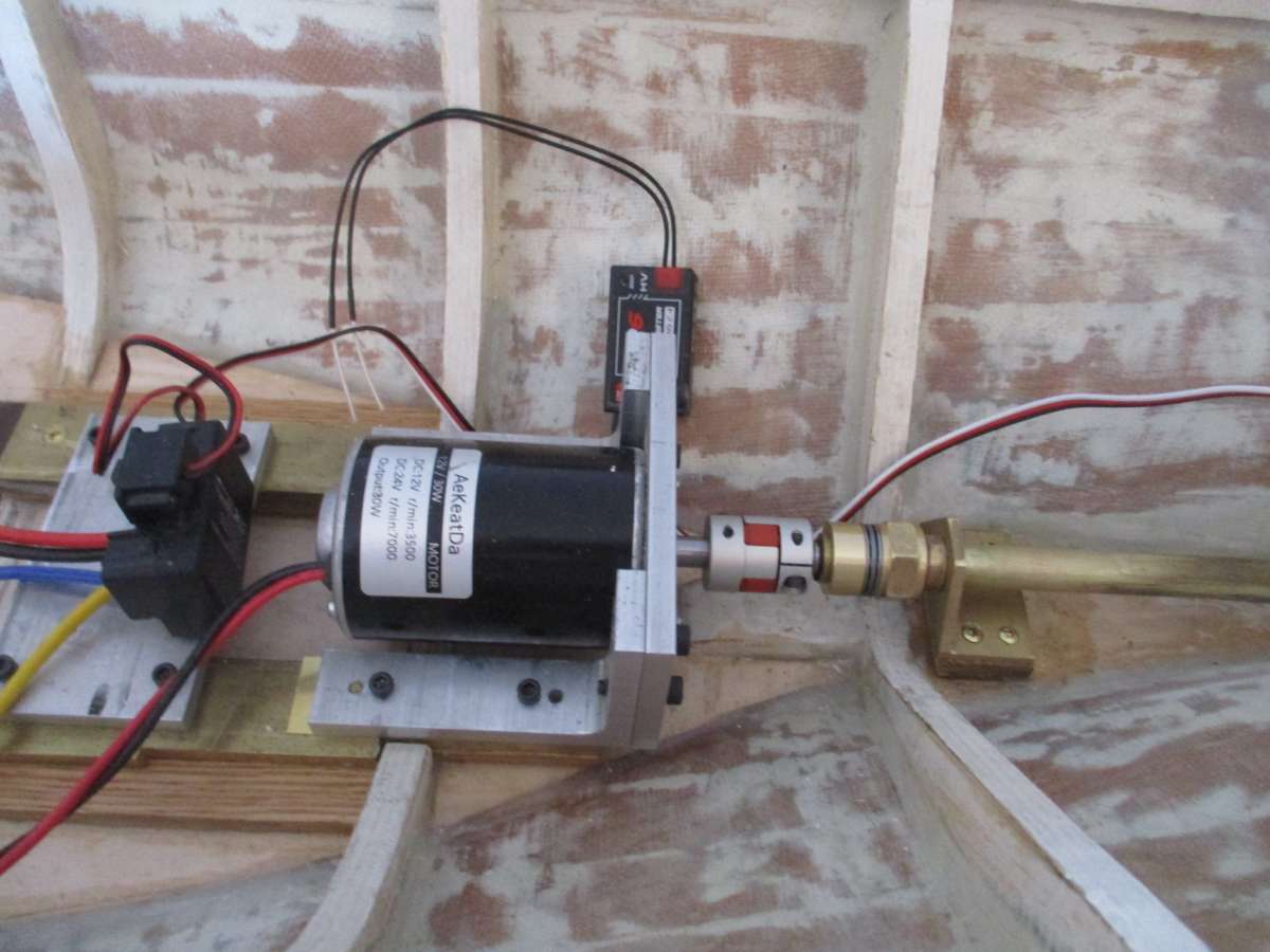

I’m going to start with an electric motor, but I hope to graduate eventually to the steam plant. Everything is being designed to accommodate both possibilities, and in particular I’ve mounted my electric motor in such a way that the bed to shaft distance is exactly the same as for the steam engine. The brass engine stringers visible towards the stern will therefore work for both engines. The next shot show the putative steam arrangement.
As a beginner, I’d like to know if I’m off track. And I’ve a specific question about ballast. As I’ve been filling in the bays, I’ve been placing a mixture of epoxy and scrap brass under the floor boards. My best estimate is that in order to float at the proper level, the model is going to have to weigh at least 70 lbs, and as it’s nowhere near that at the moment I reckoned that a modest amount of fixed ballast can’t hurt (though I certainly can see the advantages of mostly using removable ballast that is dropped in at the dock). Can anybody tell me what a 1:48 Caldercraft Joffre weighs when ready to sail? If I knew this number I could compute what my model needs to weigh in order to get in to float at the same waterline (just a matter of multiplying by the cube of the scale difference). Or, alternately, does anybody know what a Caldercraft Resolve weighs when appropriated ballasted? I’d expect my model to be very close as it’s about the same length and we’re dealing with two tugs.
I need a better feel for weight as I’m not sure whether I should cram as much weight as possible in the two bays that are not yet finished or whether I should fill them largely or entirely with wood.
Thanks in advance for any replies – John

It is a big model – larger than I would have chosen if starting from scratch. The model’s length and beam imply slightly different scales, but both are close to 1:26. I’m guessing that the scale was selected so that the double Stuart 10 would fit.
Taking the length, beam, and draft of the model and multiplying by the density of water gives a displacement of 108 lbs. The actual displacement has to be less than this because, boxy as the hull may be, it isn’t a a rectangular box, especially towards the stern. So perhaps something around 75% of 108 lbs = 80 lbs.
Working from a displacement of 1000 (presumably long?) tons for the full sized Joffre gives a much higher figure. 1000 x 2240 / (26^3) = 127 lbs. If one assumes that 80 lbs for the model is correct, the full size displacement must have been just 630 or so tons.
Probably the correct figures lie somewhere between these two extremes.

Bathtub testing is definitely part of the plan, especially with regards to getting the trim right.
But the immediate question is simply whether I can afford to add more permanent ballast in the course of fleshing out the interior. As per Richard’s comments, bits of brass epoxied in place under the floorboards are not something that can easily be removed!
Richard’s 5.82kg weight for his Joffre is exactly what I’ve been looking for. Adjusting for the scale difference, my model should come in at around 5.82 kg x (48/26)^3 = 36.6 kg = 80.6 lbs. Which is very credible indeed as it fits very nicely with my estimate.
But I definitely don’t want my model to sit on the low side. The picture below shows the superstructure. It sits on the hull rather like a lid sits on a saucepan. This arrangement makes the interior of the hull very accessible, but also gives a very long joint that cannot easily be sealed, and the effective freeboard midships doesn’t amount to very much.
So I’d like my tug to float as high as possible within reason. On the rectangular box principle, getting the waterline 1/2″ higher than where it is on Richard’s Joffre means reducing the total weight by about 10 lbs. So I’m looking at a total weight budget of about 70 lbs.
The superstructure weighs 9.2 lbs and this isn’t going to change. With the entire steam plant and various ancillaries (e.g. propane tank, burner, water pump, etc.) aboard, and with the boiler filled to operating level, the hull weighs 31 lbs. Allowing for another 10 lbs or so of necessary fittings (receiver, batteries, bilge pump, etc.), these means that I’ve still about 20 lbs to go and can therefore bury at least a bit more ballast where it’s most effective from a stability point of view. As both of the remaining bays are towards the bow, however, I will do a bathtub test to ensure that the tug isn’t in danger of becoming bow heavy.
Thanks very much for the input – John
There is one little issue with bathtub testing. It’s close, but the model is unfortunately a bit too long to fit in our bathtub.
I’m getting a lesson in why larger models are perhaps not such a good idea. Any future projects are definitely going to be smaller!
– John
Yes I had that problem, ended up with a cheap paddling pool in the garden! I agree larger models look good on the pond but do pose practical problems.

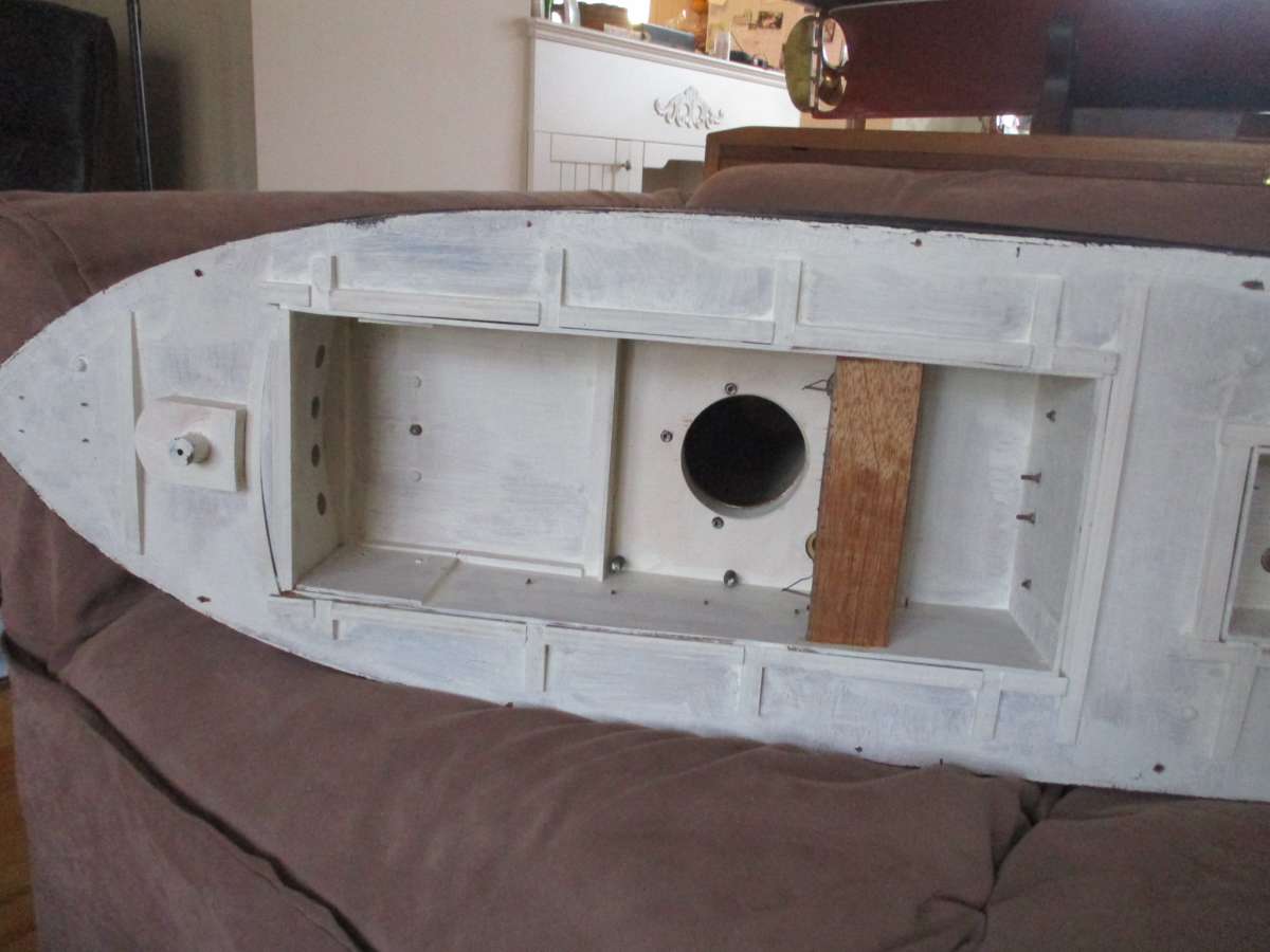

Nobody seems to have mentioned how un sea worthy your tug is !! with the low freeboard of a tug anyway and the join of deck and hull being only an inch above the water, As she is going to be 60 lbs + boat the watertightness is vital otherwise you will have a very heavy submarine ?? with that boiler and double 10 on board.
The answer will be to prise the superstructure of the deck and make suitable access hatches to the steam plant and glue the deck and bulwarks to the hull, this will give you a much better chance of staying afloat 🙂
My 39″ Cullamix tug took 25 lbs of old iron castings, with an all up weight of 35 lbs.
Launching and recovery is also something to consider ?
I rather doubt if detaching the superstructure is going to be a practical solution given the amount of work and risk of damage but the boat is certainly going to be vulnerable to taking on water. Just raising the waterline a bit won’t be enough as a tug model moving through the water will create waves which will reach up to deck level along the hull.
There are a couple of ways you can mitigate things to some extent. It might be possible to establish a silicone gasket along the joint which, if not totally watertight, would significantly reduce the inevitable inflow. I think Ashley did this with one of his recent models.
Secondly, you could use some of that ballast weight to fit a miniature automatic bilge pump and a 12v gel cell battery. The outflow can be led through the side of the hull where it will be easily noticed.
I do find it difficult to understand how the original builder could have made such a serious design error which throws into serious doubt the viability of the boat as a working model. Maybe that is why it was never finished or run? It wouldn’t have worked without a rudder either and the design has made fitting one almost impossible as on this sort of full size tug the rudder post would emerge on deck under the grating at the stern where it would be attached to a quadrant tiller. Chains from this would be led along the inside of the bulwarks and up into the wheelhouse. On a model it is sometimes possible to have a pushrod along the deck to a servo under the engine room skylight. But if you try to do this then you won’t be able to get the deck off without dismantling it all, not practical with a steam powered model at the pondside.

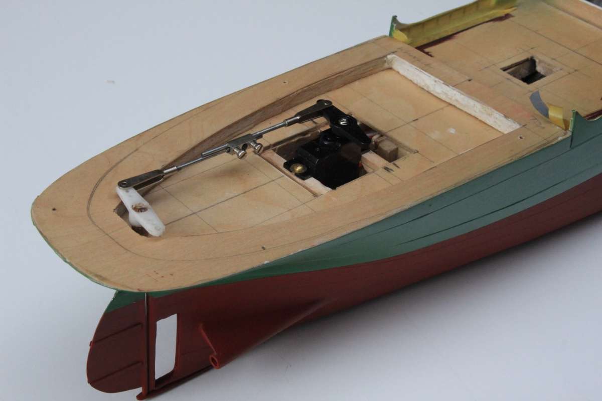

Your photos do not show the stern with the top off but the only possibility to fit a rudder in the circumstances would be to excavate the solid wood underneath the deck sufficiently to install a rudder tube with a tiller which can be connected to a servo placed further forward in the hull. This would be similar to what I am doing on my current liner model – see photo.
Having looked the the photos in more detail I’m not a all sure that you can turn this into a working model even if it was the original intention of the builder.
I completely agree that the arrangement isn’t very seaworthy. The effective freeboard is only about 1-3/4″, and the fact that the superstructure fits inside the hull rather than sitting over it means that any water that gets into the joint area is going to drain into the boat rather than back into the pond. It is indeed not hard to imagine that the reason the builders didn’t complete their project is that at some point they were told that the whole arrangement wasn’t practical.
But at this point major surgery isn’t very practical either. So the choice is between simply leaving the model on a shelf and making the best of the way things are. Given how heavy the tug has to be, there simply isn’t enough free interior volume to guarantee positive buoyancy by installing foam and/or air bags. I have thought that perhaps some of the ballast could be in the form of water tanks that would be blown empty by CO2 cartridges in the event of the hull flooding. This plus filling every nook and cranny with foam might just do the trick, but it would obviously be a major exercise.
In practical terms I think that I’m looking at i) doing what I can with the joint and ii) installing a bilge pump. Ideally the joint would involve a massive O-ring, and if I were starting from scratch I think that this would be an eminently practical proposition. But this approach requires well fitting surfaces and a groove in one of them, and at this point I don’t think that either of these requirements is achievable. In practice I think that my best option is to clean up both surfaces, coat the superstructure with wax, and then assemble the hull and superstructure with the joint area covered with epoxy. This should at least ensure a good fit and (hopefully) prevent more than a modest amount of water getting in. On the bilge pump front, I’m looking at https://www.amazon.ca/gp/product/B09XH1GYYQ. I reckon (hope) that some attention to the joint should keep the inflow of water below 1.3 litres a minute, especially if I limit myself to calm days and avoid having an unrealistically large bow wave.

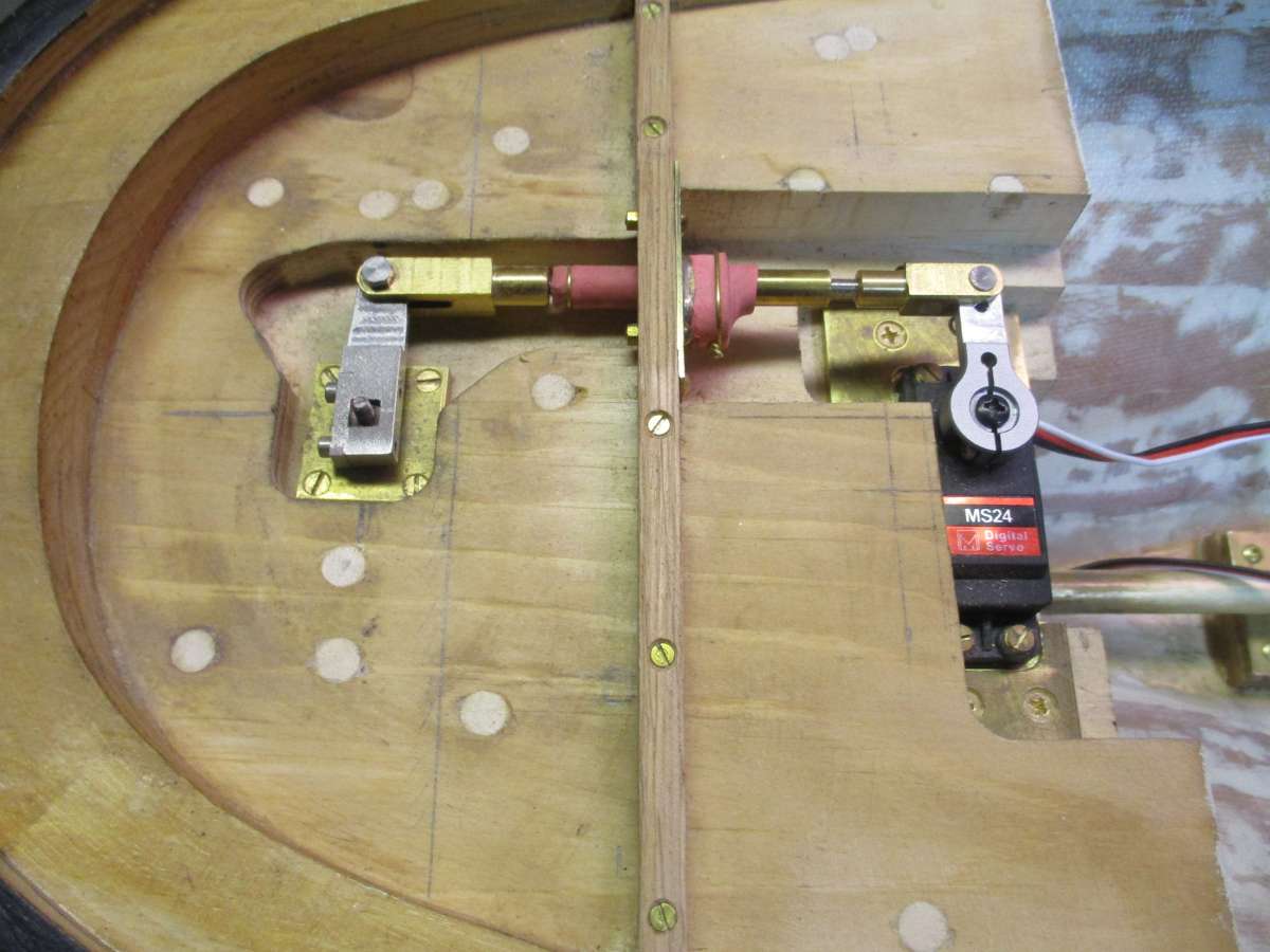

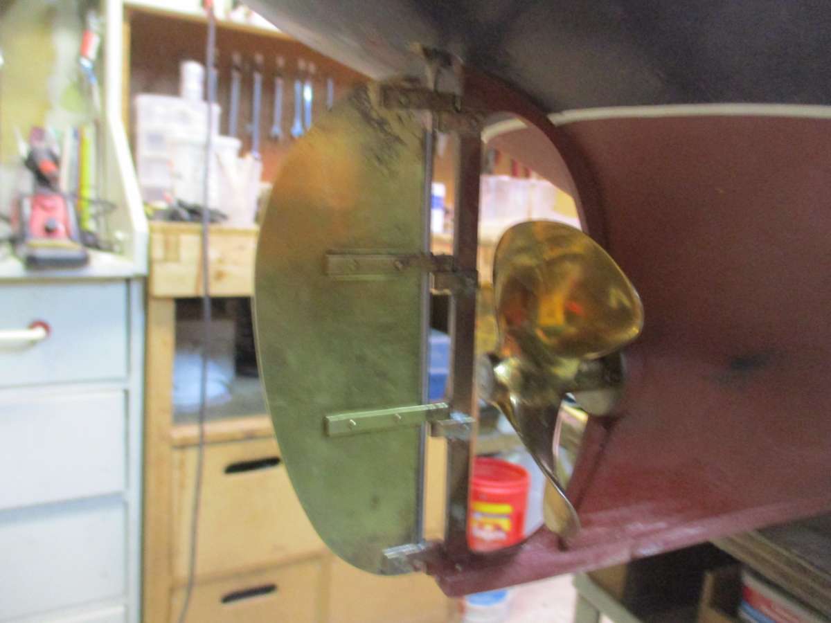

At least the rudder issue has been dealt with. I’ve routed out areas of what was a solid wood stern and have installed a rudder linkage and servo. There’s an O-ring seal below the brass plate around the top of the rudder post, and I like to think that it would prevent any water getting in even if it were below the waterline. But to be safe I’ve installed a rolling seal on the linkage as well. It would do the trick even if the rudder post was totally unsealed and the area around it was effectively on the outside of the hull.
And I’ve made a totally new rudder with much more substantial gudgeons and pintles. Unfortunately I made it before reading that model rudders typically need to to larger than scale to provide reasonable turning circles (a real shame as I could easily have added a bit of area without significantly affecting the cosmetics). Time will tell. If performance is indeed unsatisfactory I can make a bolt on rudder extension, and in extremis I can simply make a somewhat larger rudder. I take some comfort in a remark to the effect that the need for larger rudders applies less to tugs than other vessels, and in the fact that the area of my rudder does meet the criteria suggested by another writer.
– John
Very glad to see you have fixed the rudder issue, a neat solution and exactly what I had in mind.. You may find that the size is OK as it is directly behind the prop. Some people who have rudder problems have made ‘slip on’ extensions which can be removed when the boat is out of the water. If made with transparent plastic they are pretty much invisible when the model is afloat too.

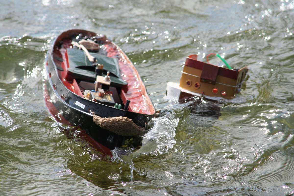

I just want to put a couple of probably more controversial thoughts out there. First up I built a steam model over a twenty year period, see Model Boat Magazine Boiler Room articles in Editions Nov and Dec ’24 and Jan ’25, and had to come to the conclusion that it simply wasn’t seaworthy enough to risk it on the water. She sits at the correct waterline, which is too low for a scale model, and contains a huge amount of expensive plant. Not to mention the time, effort and love that has gone into its creation. Consequently I am simply not prepared to take the risk and she now sits in a glass cabinet. I saw it as a failure for some time, as did a number of friends who said I should give it “just one outing”, but I knew it was a risk I didn’t want to take. To get the weight down would be a major disassembly and rebuild, which I am also not prepared to take on. Now however I don’t see it quite so much as a failure, more of a big part of my own learning curve as a modeller. I enjoy seeing it in the glass case and it will now outlast me, god knows where. The only point being, it is an option to decide not to sail the model.

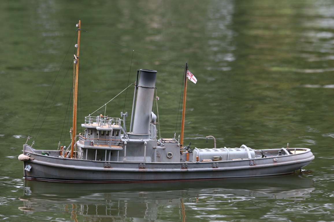

Having said that I also have a Model Slipway Envoy Class tug. She sits very low aft and has a more normal arrangement of a sealed deck edge and access hatches over coamings. Even with a very low aft freeboard I get very little water on deck as a result of only using it in appropriate conditions, i.e. flat calm day and take it out when the lifeboats go on the water!
The final thought I can offer is the fact that I’ve only ever had one model sink on me. Yes, it was my Caldercraft Joffre. Luckily I retrieved it, refurbished it, repainted it and still use it but it is a reminder that it can happen. I did read somewhere that she was conscripted into navy service at one point so I went for a RN colour scheme.

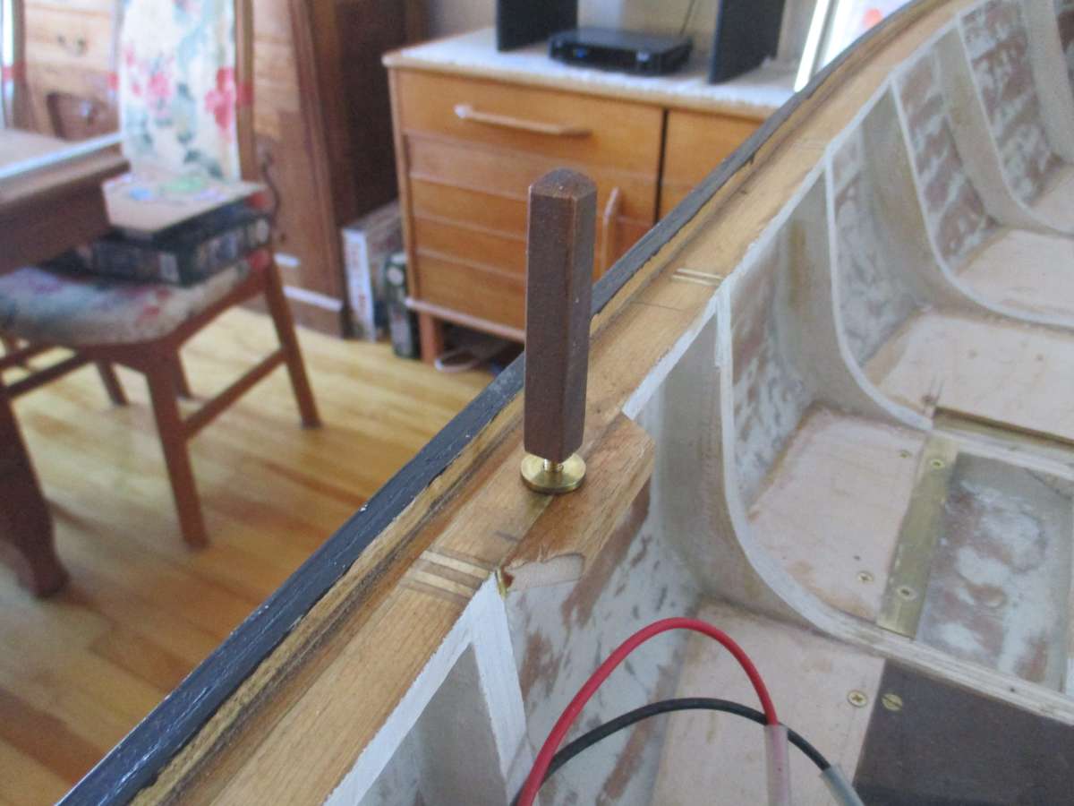

Extra question, what keeps the top secured to the hull so that it doesn’t get knocked off?
First on all, an extra answer to the extra question. The top portion is secured to the hull by two screw in snubbing posts. The picture shows one of these in situ but without the top portion.

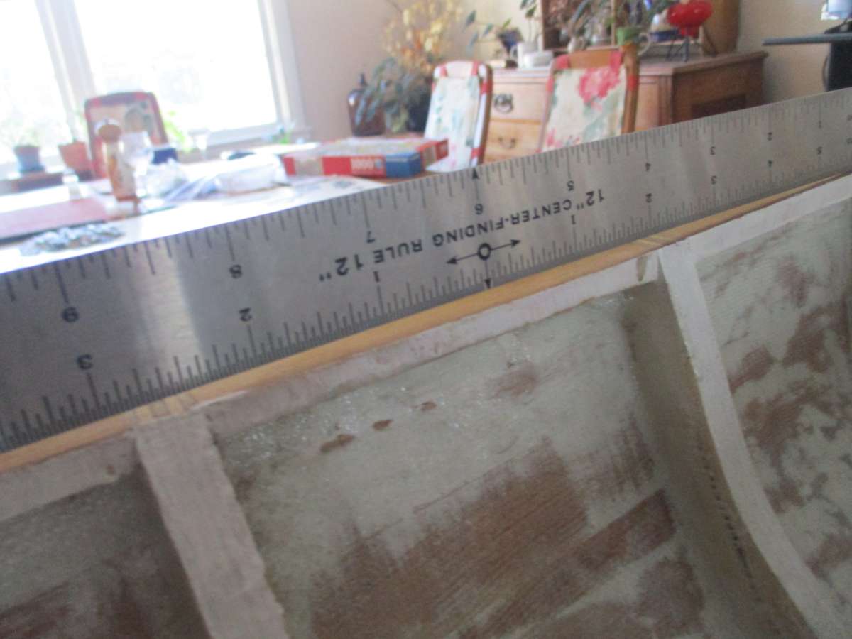

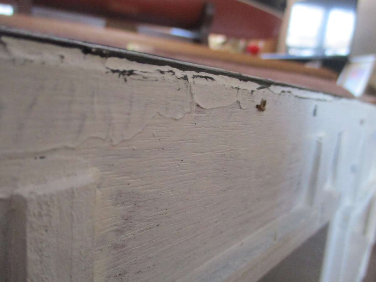

I’ve absolutely no faith in the precision of the hull/superstructure joint as it currently exists. Rather I’m pretty sure that while the hull and superstructure have to touch each other in places, there are also areas where they are some distance from each other. The picture below, for example, shows an area where there is a significant dip in the hull. Some of this is due to the sheer at this point, and in principle the top portion could have a perfectly matching bulge, but I’m sure that the reality is that I’m simply not dealing with a very precise piece of work.
The next pictures show the underside of the superstructure. It’s clear that I’m dealing with a rather rough and ready piece of work rather anything close to a precise watertight fit. In the second shot the bottom of a davit can even be seen protruding into the critical area, and there are other such protrusions elsewhere. Filing these flush is an obvious first step. The fact that the bottom of the funnel is open is a sign that it was indeed intended to use the steam plant, and the ventilators are also functional. But the boiler room crosswalk (visible if one opens the doors at either end of it) is a bit strange in that it pretty well precludes installing the boiler. The boiler does fit below it, but however things are arranged the crosswalk is bound to foul either the safety valve or the steam turret. Probably things weren’t completely thought through.
In this case I think that an O ring is a non-starter because there would be areas where the ring was over compressed and spots where it wasn’t compressed at all. I can see, however, that an O ring might work very well given a hull constructed using the bread and butter method. One would simply stop at some point, use a router to put a suitable groove in the top layer, and then screw the next layer in place before proceeding with additional layers (making sure, of course, that the screw heads remained accessible!). At the end of the day installing O ring material in the groove would in principle result in a perfectly watertight seal between the lower and upper parts of the hull.

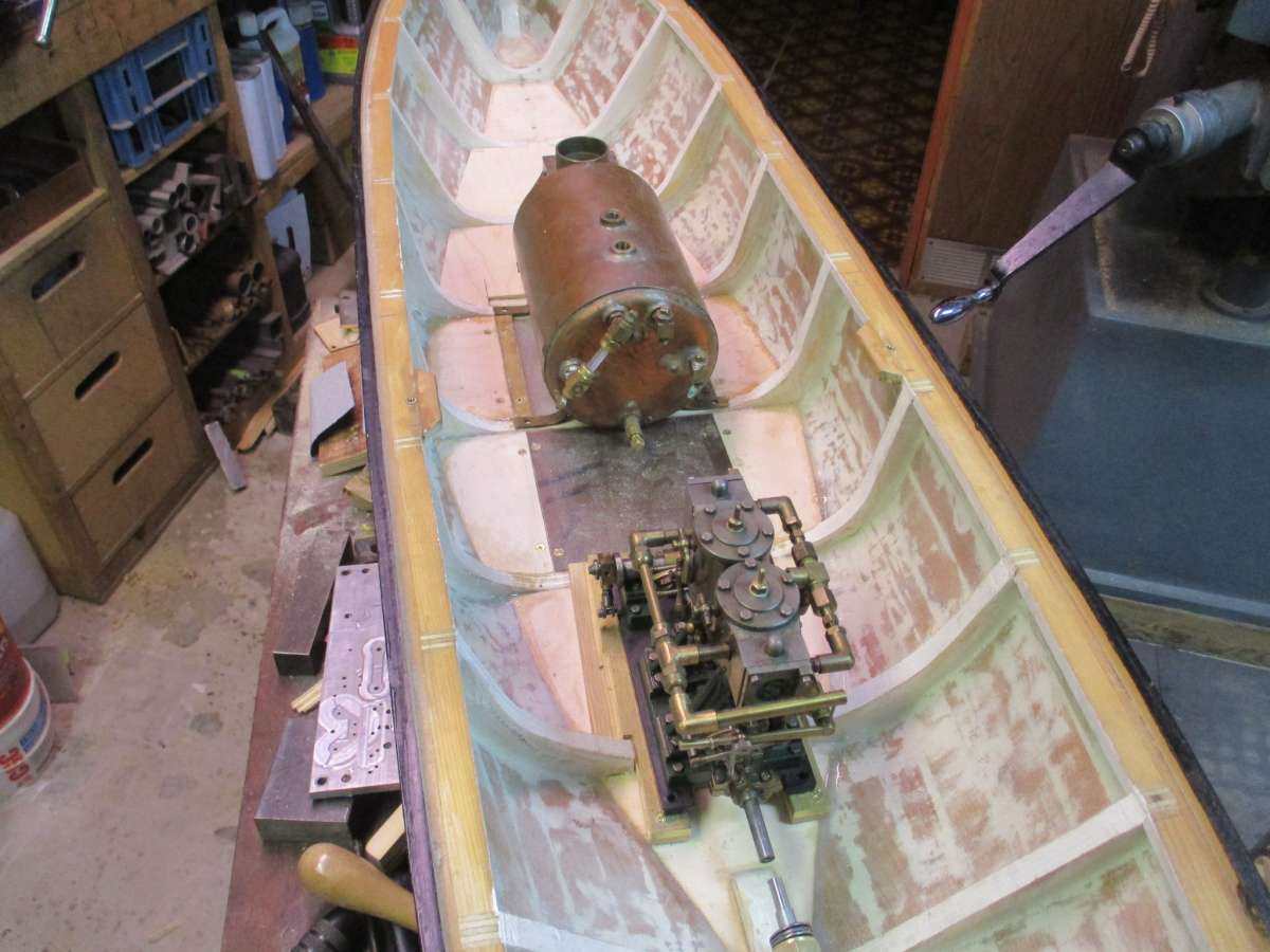

Has the boiler got a return flue in it ? its not a standard centre flue boiler !
I’m in a similar situation having aquired a steam plant but I’m going to make a new boat around it 🙂
Having tried both I am nowadays firmly of the opinion that steam plants are infinitely easier to build, maintain and operate in an open hull. Plus you get to see it all operating!
When I first acquired the tug I did a bit of research on steam plants in RC models, and one of the first things I read was that boats with steam engines are almost invariably open launches, and that enclosed steam plants are both unusual and “difficult”. And I’ve absolutely no trouble in understanding why this is so.
Unfortunately I think that an open launch would have to be at least 6′ long for the plant I’ve got to look right. Unlike tugs, launches are normally not given over largely to the boiler and engine. Some space for passengers is a key part of the concept.
The boiler is a simplified Scotch boiler (one with just two largish tubes). In my case I think that it makes sense to have the burner (and hence the exhaust) at the front end. This doesn’t fit very well with the location of the funnel, and a cranked uptake is going to be required.
If both the superstructure and the engine casing were made removable, it might just be possible to arrange the steam plant so that everything that needs to be got at on an everyday basis was accessible via these two openings. But things would be very tight indeed, and coming up with a satisfactory arrangement (e.g. one that makes it easy to both light the burner and see the boiler sight glass) might in fact be impossible. And one would still need the current joint (though is could be filled with a non-hardening sealant and kept screwed together most of the time) as otherwise maintenance would be well nigh impossible. In view of all this, my current feeling is that simply making the existing joint into a practical proposition (together with good bilge pump!) is probably the best option.
