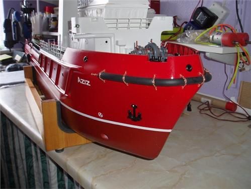

                Thanks for the info,Robert will keep it in mind in case I have the same problem.No pictures of the boat yet ??
                Here is mine to date,needs wheelhouse finishing .
                Ducky
                http://www.modelboats.co.uk/wp-content/uploads/sites/5/images/member_albums/2674/bow_bumper.JPG
                #16720
                  Nice looking model, you have there Duckie!
                  How about painting below the waterline…….a different colour?………………….like dark green or red oxide?
                  Eh??…………………Bob the casual observer
                  #16721
                  Ducky
                    @ducky
                    It is Red oxide, must be the cheap camera or the angle it’s taken at, there again it could be your spec’s they are doing a good deal at Specsavers at the moment Bob.
