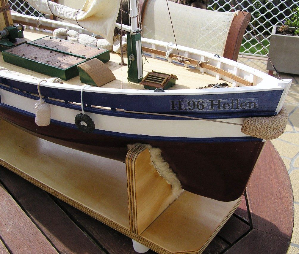

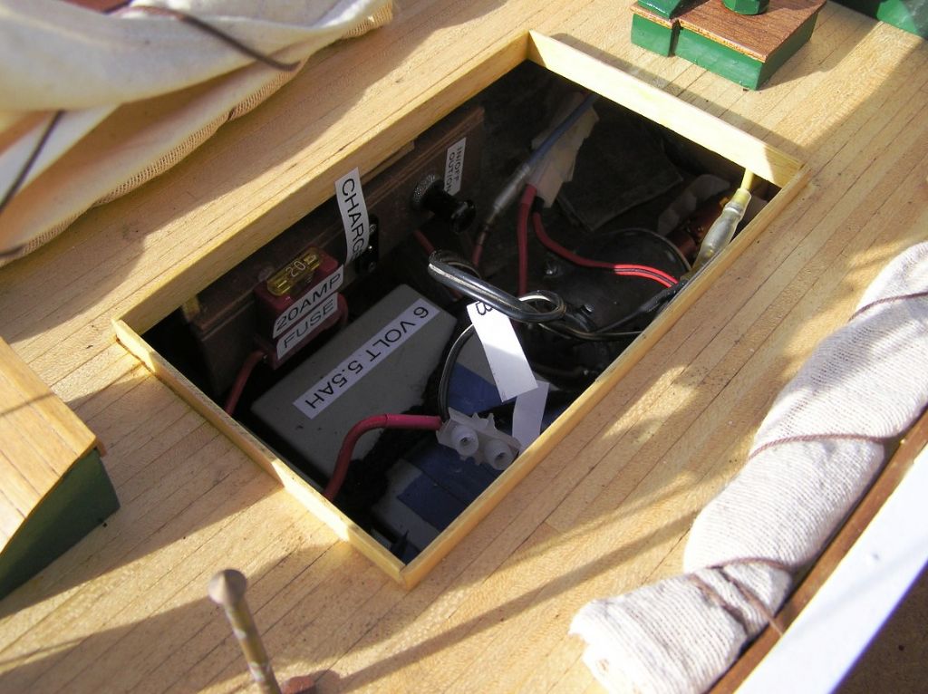

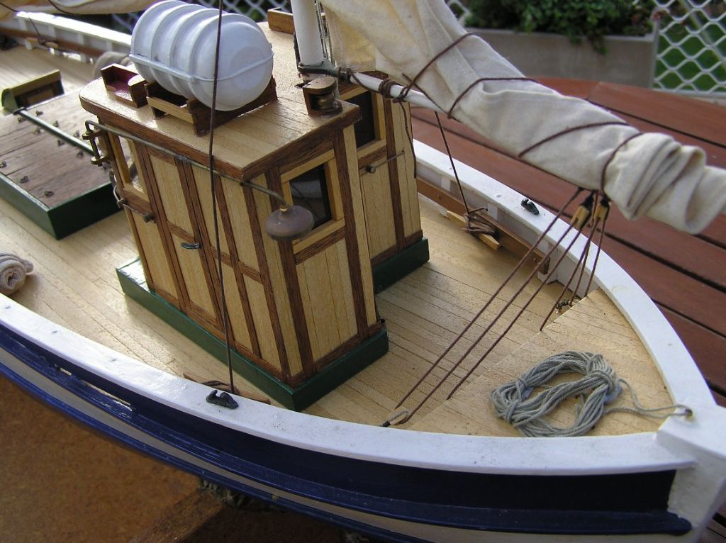

          hellen 08.jpghellen 07.jpghellen 06.jpghellen 04.jpghellen 03.jpghellen 02.jpgHi All
          #77018

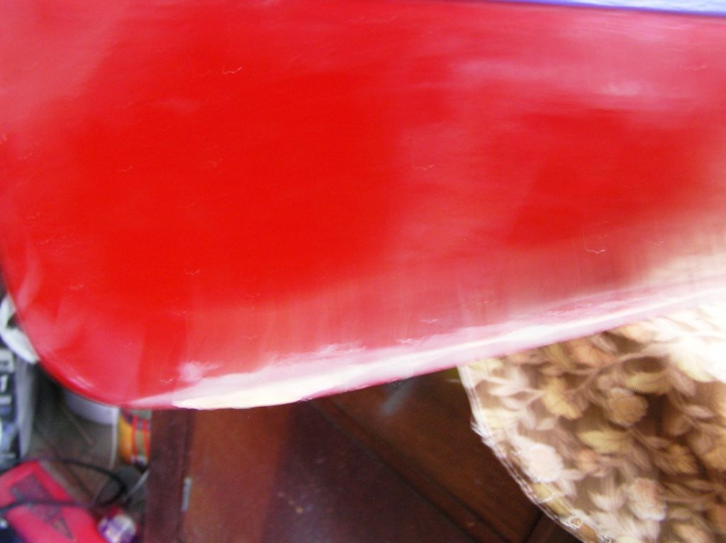

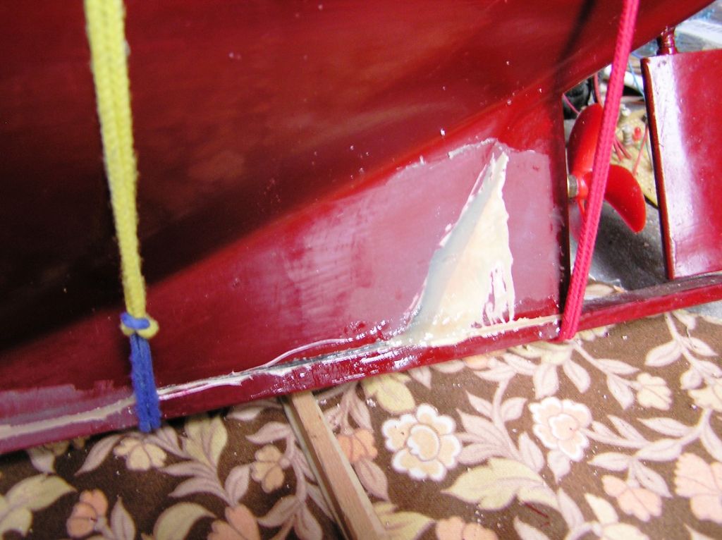

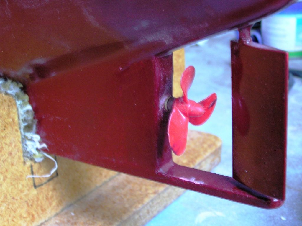

            hellen 10.jpgHi All
            The crack paint on the keel I found the wooden bits had came away from the ABS hull.
            Reglue and stripped out the old filler.
            All sanded back and off the hobby shop for some paint(of course I did not have that colour in the paint draw).

              Harry. That's a nice little boat. Those plastic 3 blade props are OK, but have no reverse power due to the fine pitch. Oddly enough I have found in the past that they can be quite satisfactory with even quite quick motors.
              I presume you will brass this one up for the look and having some reverse?

                I had a 50mm brass prop given to me today as the plastic one is 55mm.
                I will test the props to see what is the best.
                The brush motor is a direct drive 555 and the original prop would get the motor too hot.
                Both the plastic and brass ones have about half the blade area so it may help the motor run cooler.

                  Hi All
                  Well all the filling is sanded down and one side has been painted in the repair area with Revell NO.38.
                  The colour was a match but in matt .
                  The wheelhouse was only sitting in position, so I am add two 10mm magnets forward and aft down to metal strips.

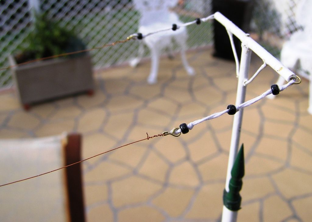

                  As you may have seen in the pics the wireless aerials are missing, so I am working on this as well.

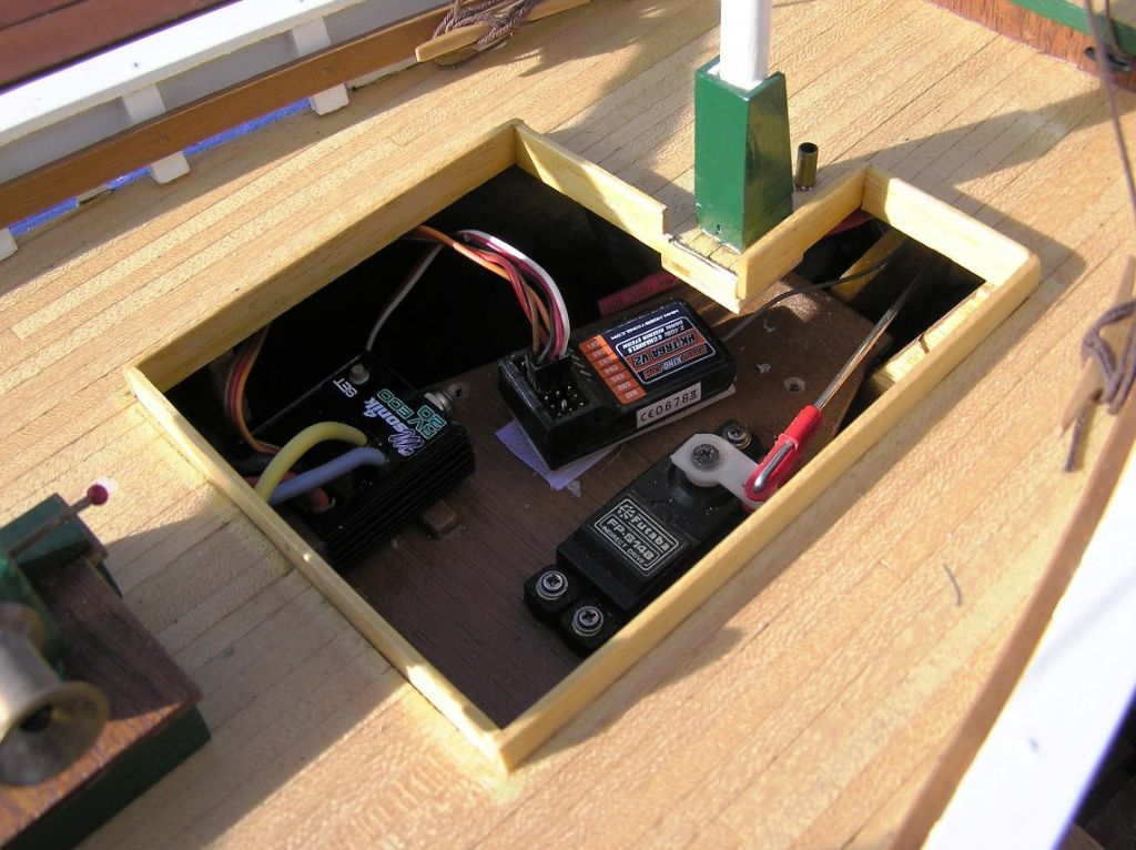

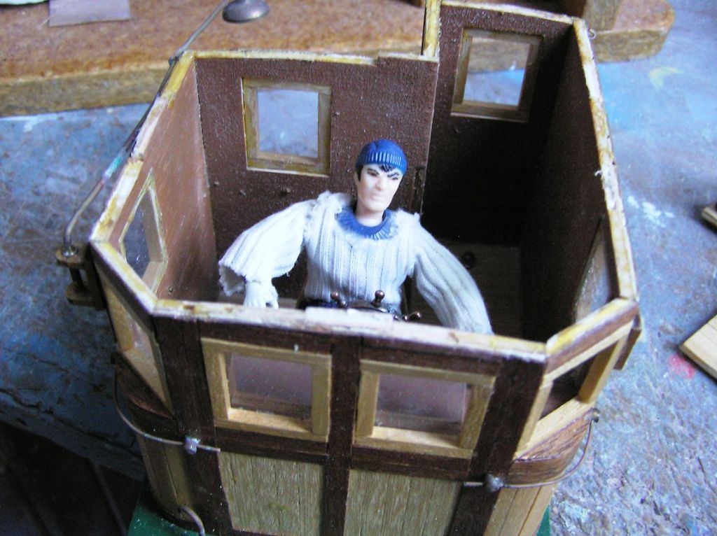

                    Hi All
                    Magnets setup to hold down the wheelhouse.
                    Cut out part of the wheelhouse floor to install a captain and seat.
                    Will install a couple of LED up lights so you can see the captain inside.
                    Waiting for the glue to set on my aerial bits and install them.
                    Using black beads with copper wire for the aerial sections.
                    Have to workout how to fix the leads to the wheelhouse so they can be disconnected easily .

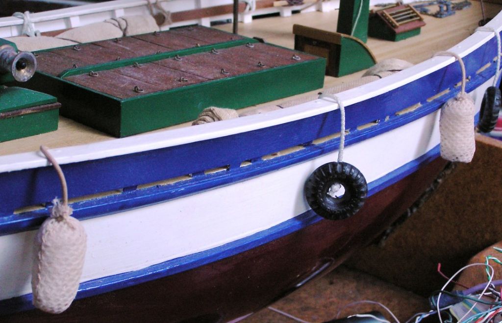

                      Installed my home made fenders and four tyres( from a swap meet at the weekend).
                      Some of the rigging was a bit too loose, so another job done.

                        no roof.jpgrepaired hull.jpgfenders 2.jpgHi All
                        Still no roof, but, all new Perspex windows and added fenders.
                        Found I miss a small area on the hull with paint.
                        Harry

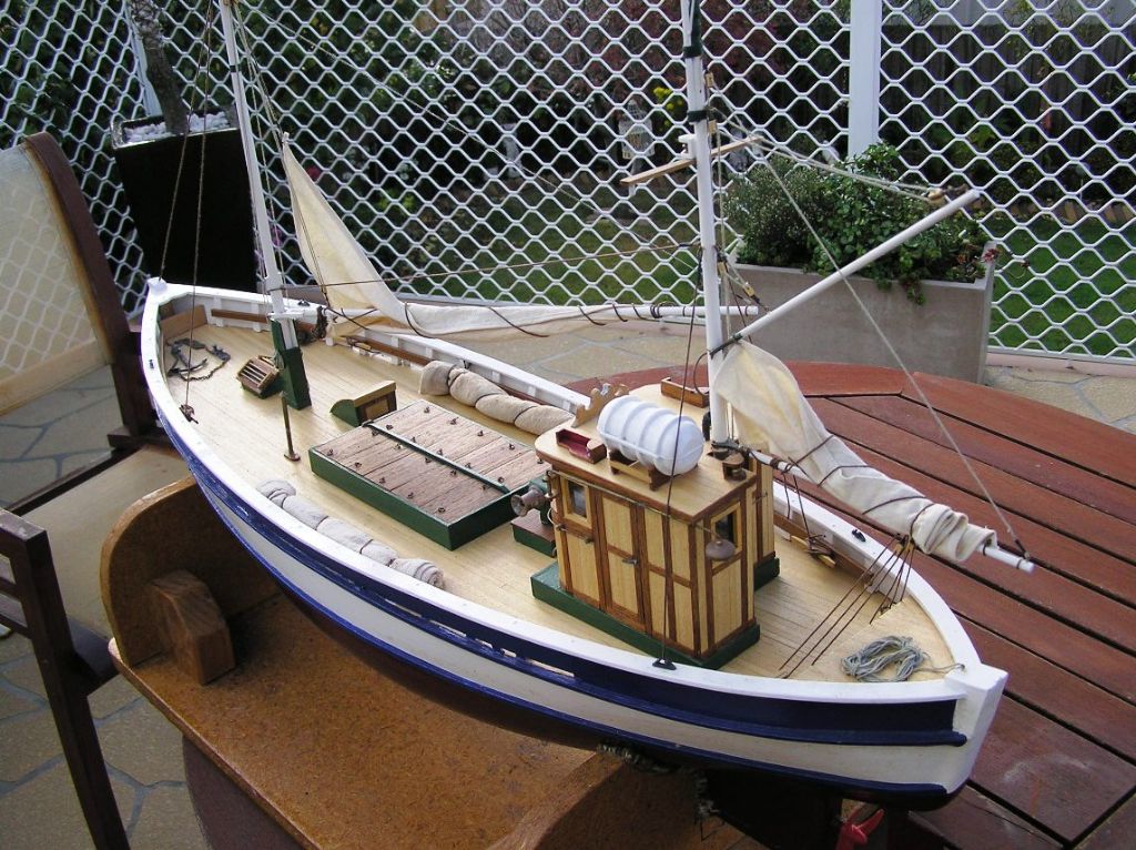

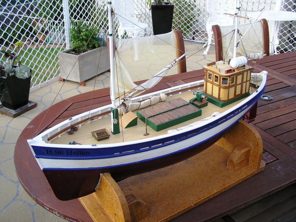

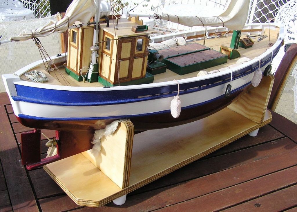

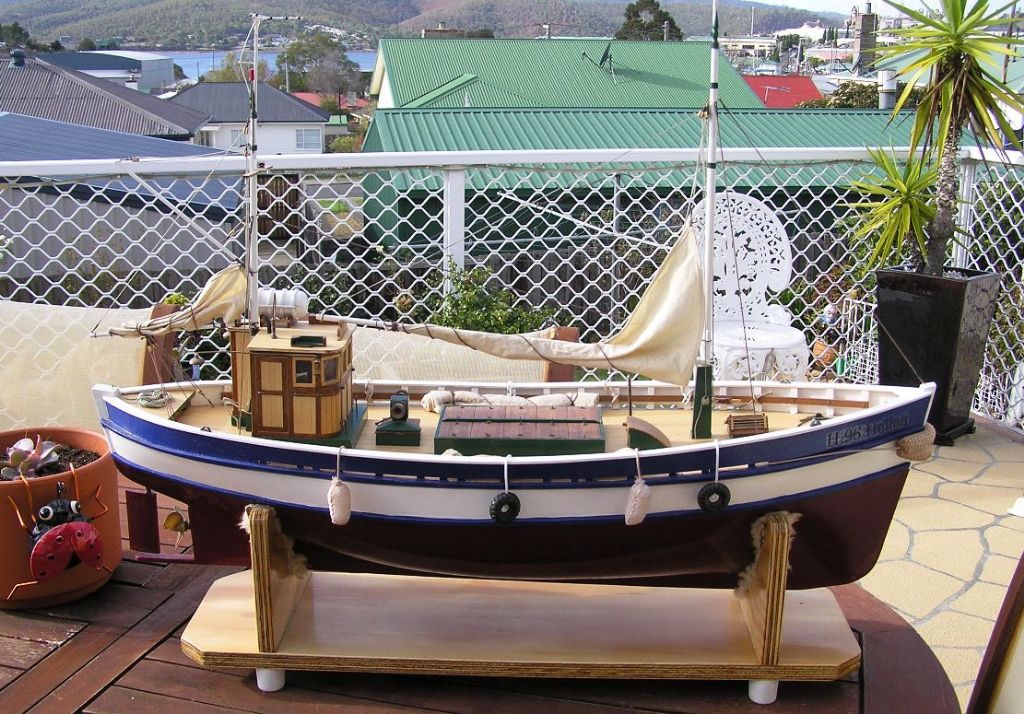

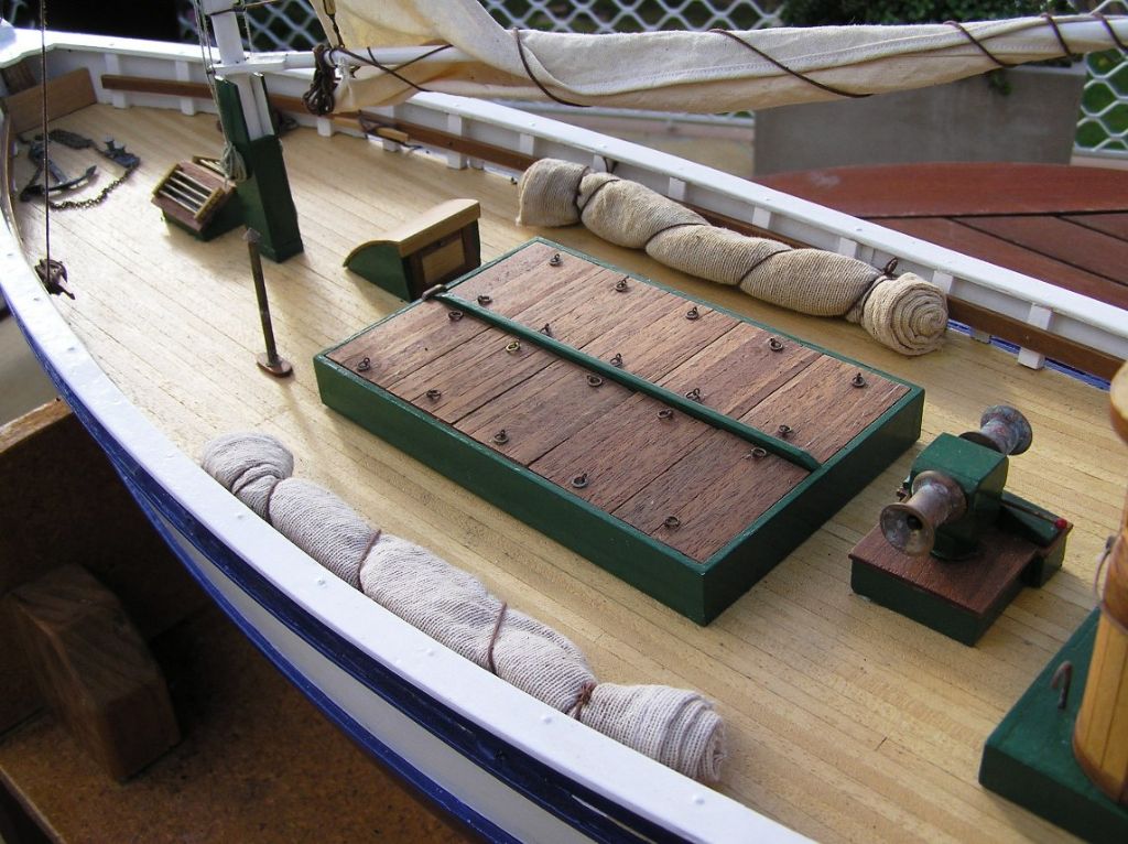

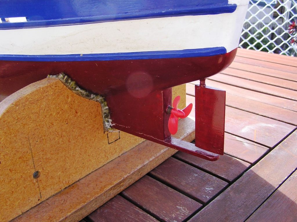

                                  #77292
                                    mast top.jpgview side.jpgview from stern.jpgHi All
                                    Edge strip installed after these pics.
                                    #77493
                                      Hi All
                                      The boat had a sail on Saturday running on 12 volts with the de-pitch brass prop.
                                      The new Hobbyking ESC work great, very happy with this one !!!
                                      The boat turn very well, but, will have to drop back to 6 volts.
                                      1/8 throttle at scale speed and 1/3 throttle starting to drop at the stern and getting up a good bow wave !!!
                                      At full throttle the top of the stern post is below the water at the back !!!!!
                                      Slowly back off the throttle to get back to scale speed.
                                      Oh and reverse, stops in it's own length!!!!
                                      Will drop down to one battery and add the replacement weight in lead.
                                      This will give me more room near the motor for the ESC and switch.
                                      Harry

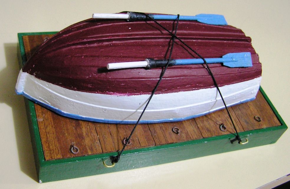

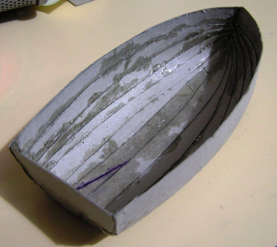

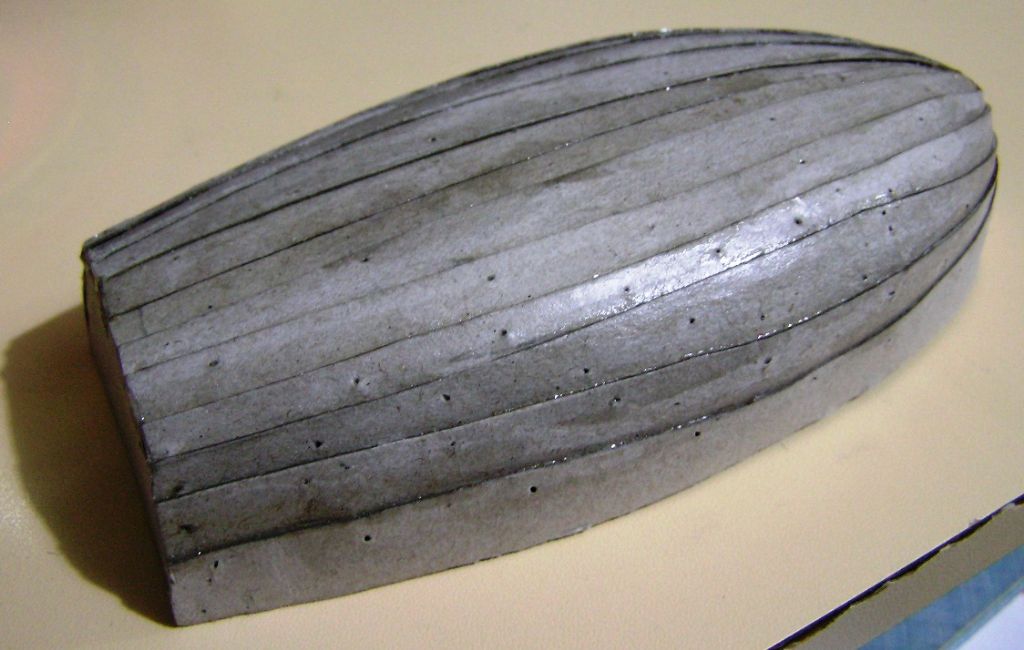

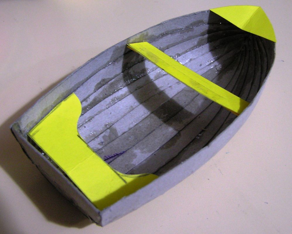

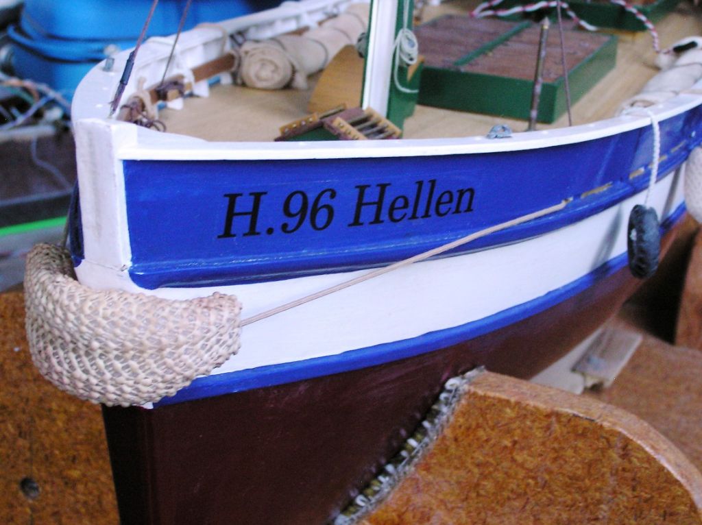

                                            rowboat 3.jpgrowboat 2.jpgrowboat 1.jpgHi All
                                            As it's winter in Tassie, it's cold and dam it rained all weekend !!!
                                            I made a wooden plug for a little row boat for the Hellen.
                                            This is my first cardboard boat !!!!
                                            Size 6" x 3" to sit on the hatch of the boat.
                                            At present it looks like a voodoo boat with all the pin holes, but, a bit of filler and paint will hide it !!!
                                            I hope !!!
                                            OH, buy the way the Hobbywing brush ESC WP1060 (60 Amp) set on NIMH for my Gel cell twin 6volt (setup for 12 Volts) work great .
                                            No silly beep, beep setup only links.
                                            Removed one 6 volt battery to run on 6 volts and that's what the plan was to test on 6volts at the weekend.

                                              Hi All
                                              No testing the boat at the weekend, wind !!
                                              The dingy has had a coat of resin and is in paint with only a trim colour to finish it.
                                              Made a set of oars, bamboo sticks, a small bit of fuel tube and black heat shrink.
                                              Small bits of veneer for the blades.
                                              These are in paint as well.
                                              Started on the second dingy, but, that's secret squirrel stuff.

                                                The new dingy looks the part on the hatch.
