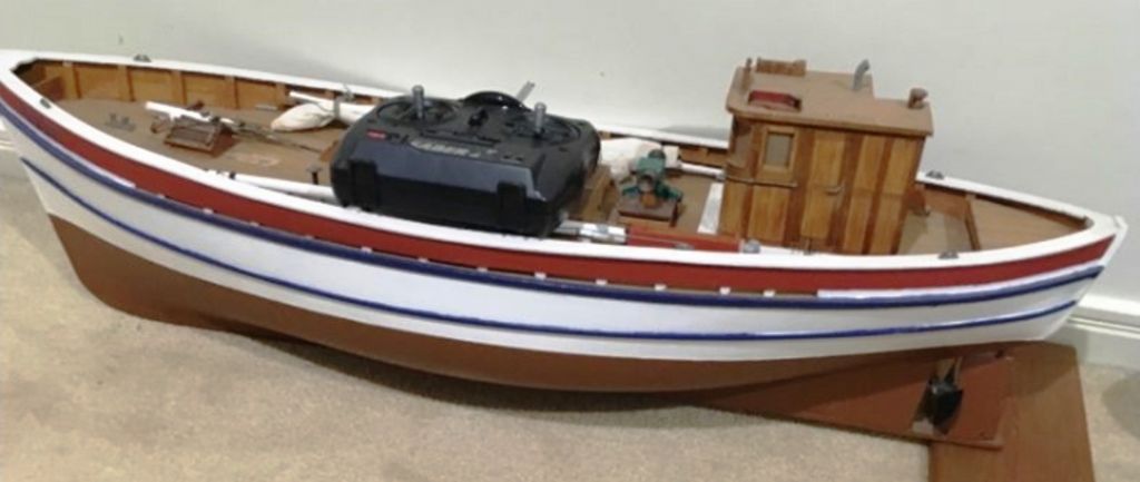

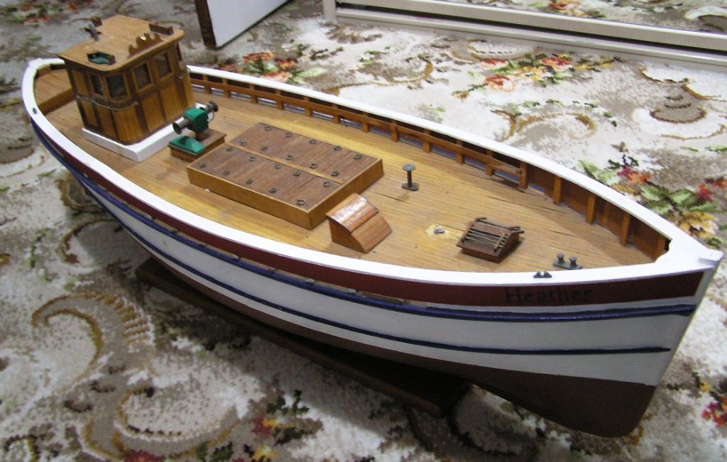

      kathleen5.jpgkathleen4.jpgkathleen3.jpgkathleen2.jpgHi All
      Well at it again, another cheap one from Gumtree(AKA EBAY).
      $160au with postage !!!
      This is my third one this year !!!
      Sold the first one to a club member (unstarted kit).
      Second a swap for my Sea Commander with required a full paint job and fittings.
      The second Hellen was in to good of condition to say no !!!!
      So this is number three as per the pics posted !!!!
      I did not required the radio or the ballast , but, I got a spare new prop.kathleen1.jpg

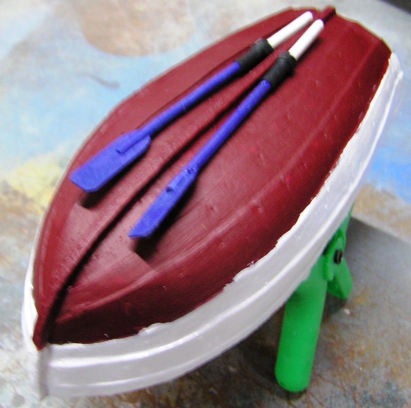

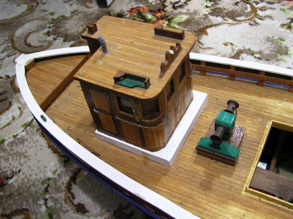

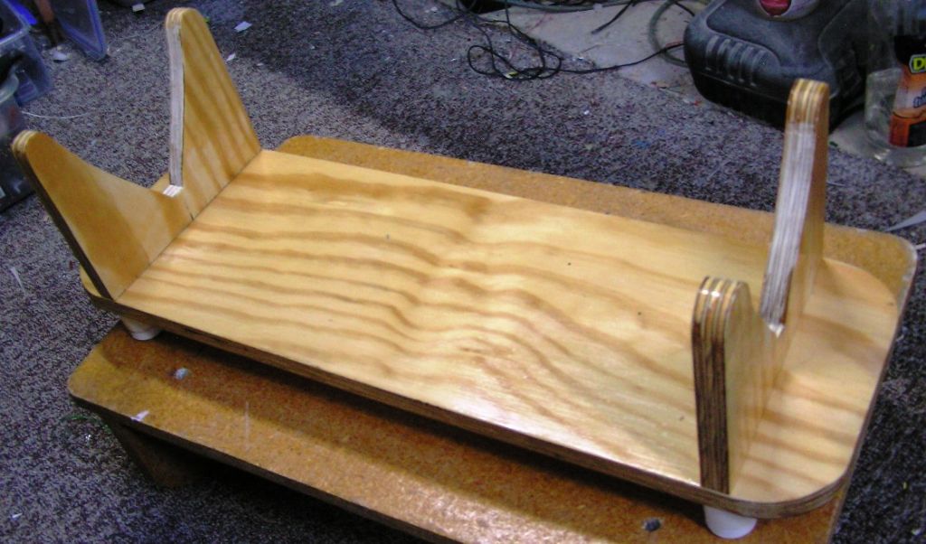

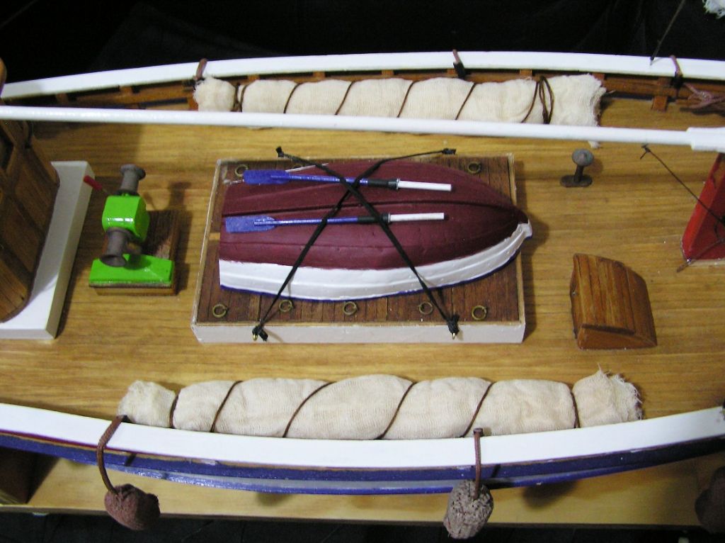

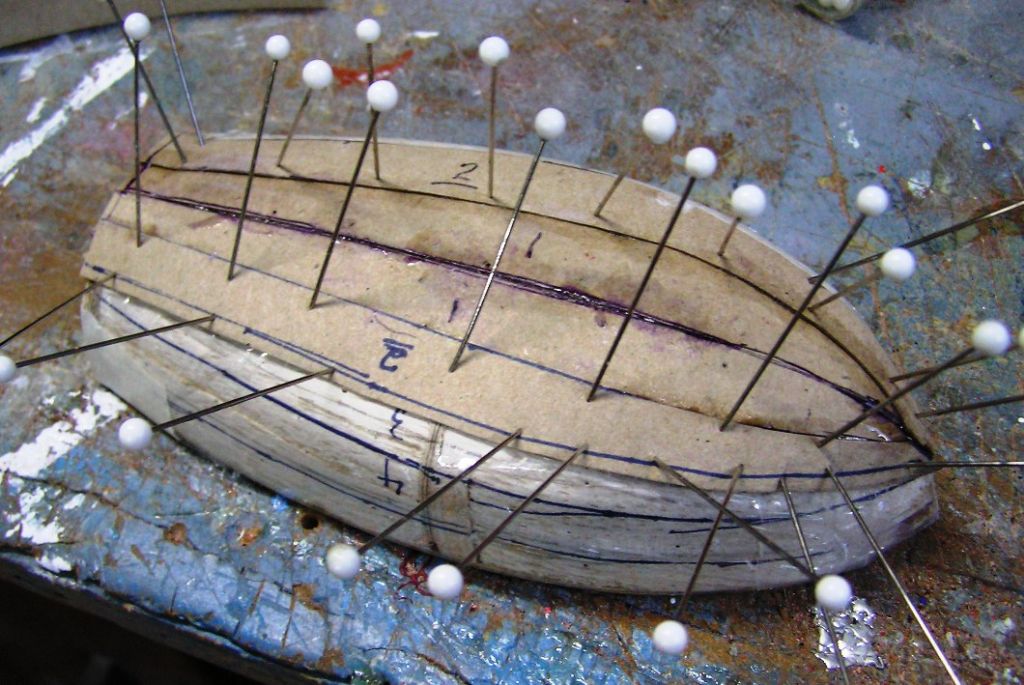

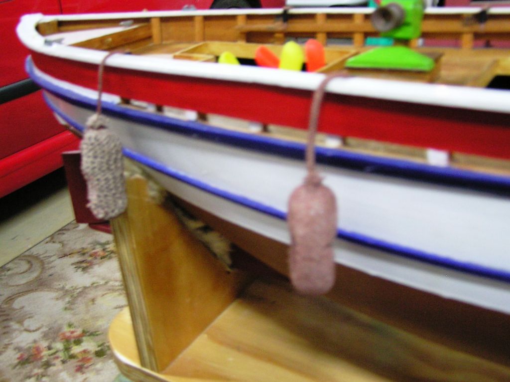

          stand 1.jpgfenders 2.jpgfenders 1.jpgdingy 3.jpgdingy 2.jpgHi All
          So waiting for the boat to arrive, I started making a new stand, dingy with oars and a set of fenders.dingy 1.jpg
          #78082

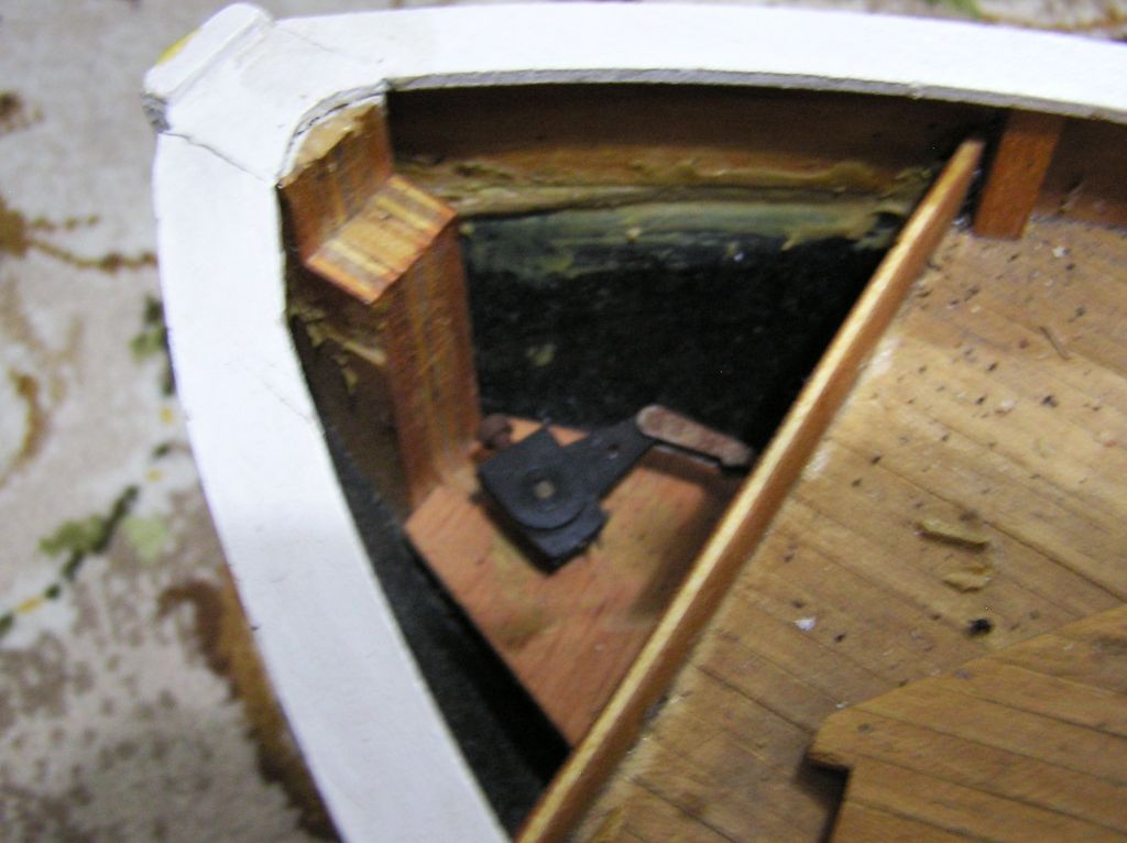

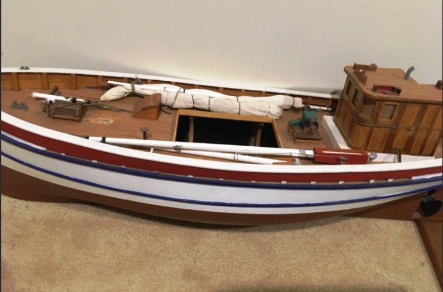

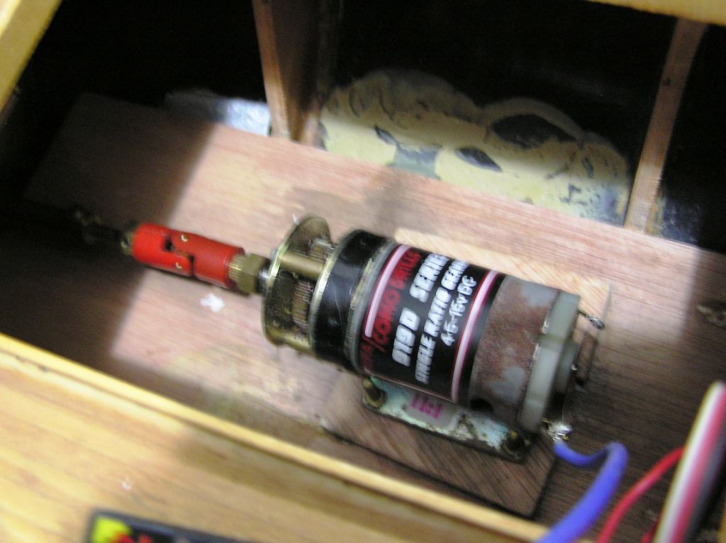

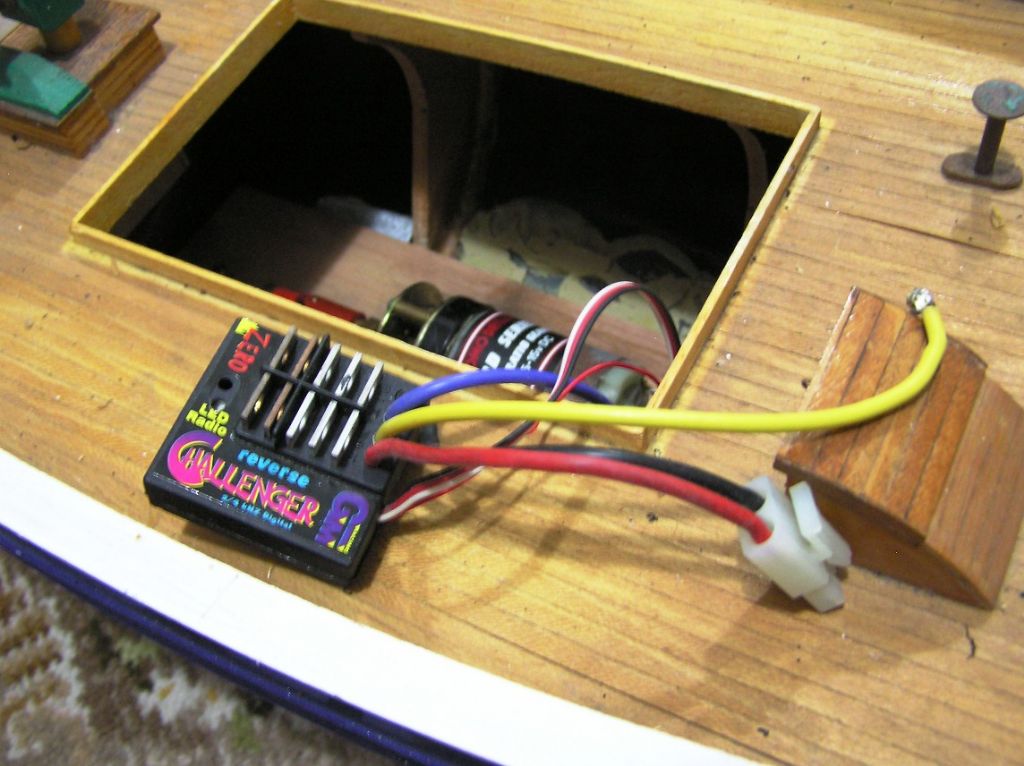

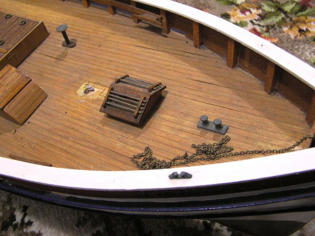

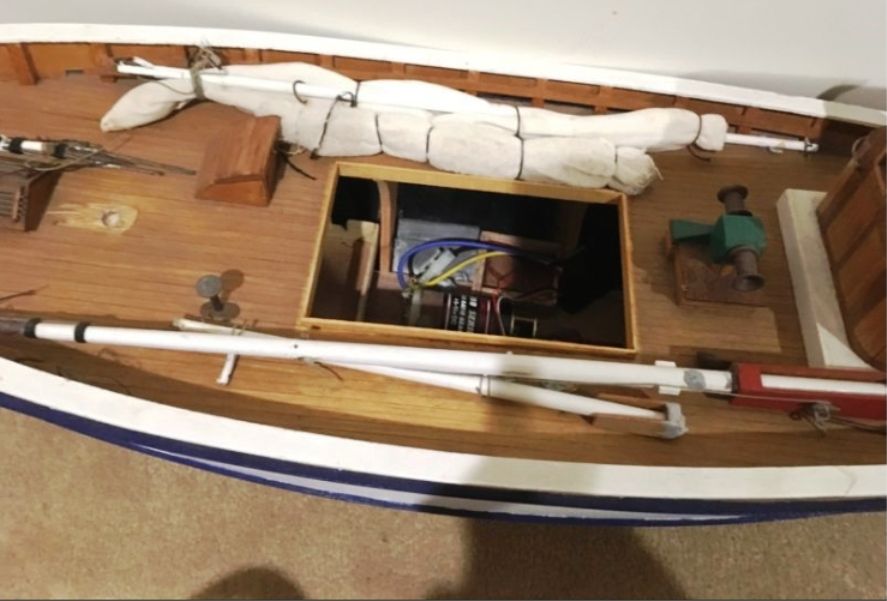

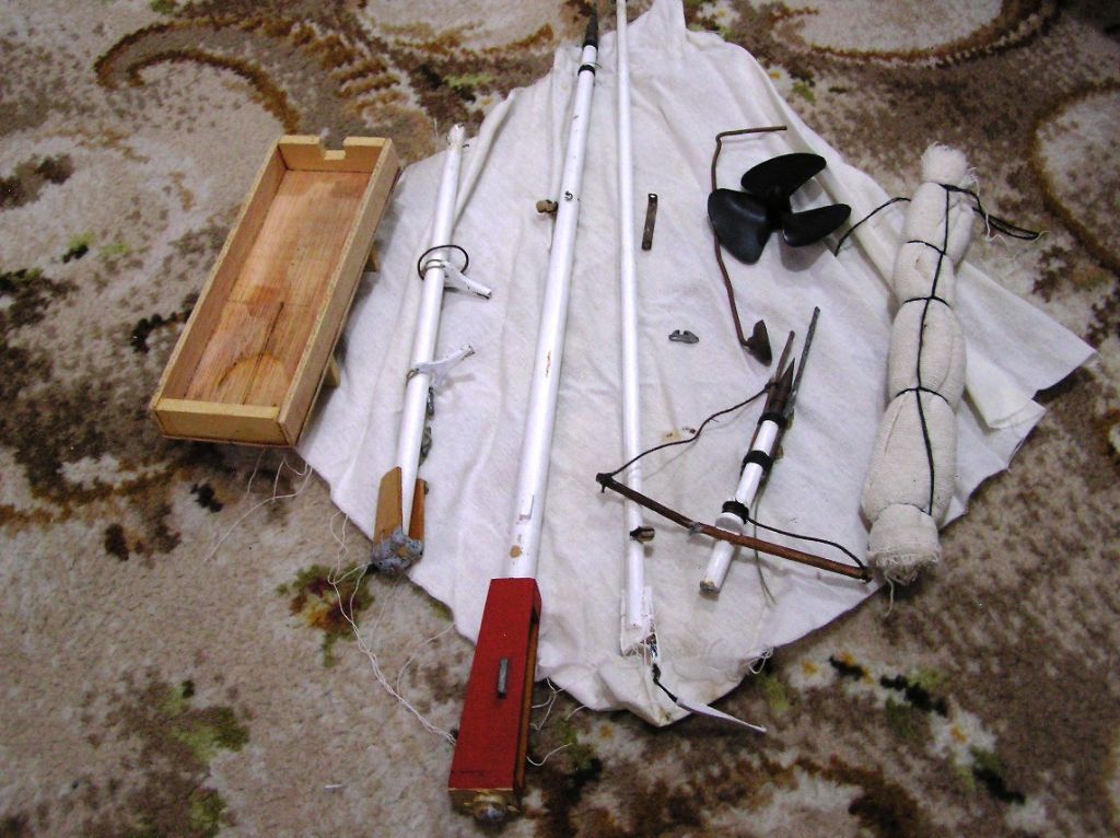

            motor and gearbox.jpgloose bits.jpgunstarted 9.jpgunstarted 8.jpgunstarted 6.jpgunstarted 5.jpgunstarted 4.jpgunstarted 3.jpgunstarted 2.jpgunstarted 11.jpgunstarted 10.jpgHi All
            The boat arrived, so I photo it unstarted.

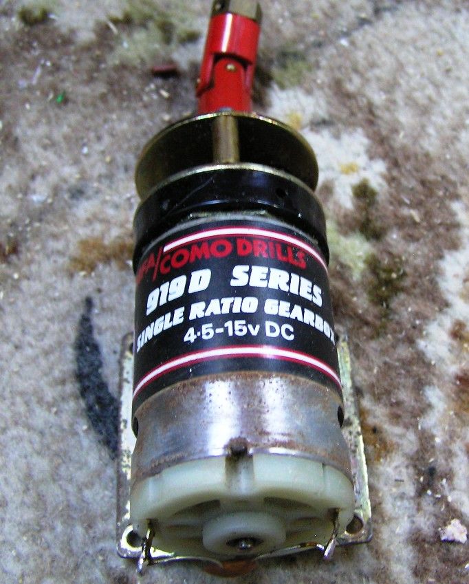

            Broken aft mast, motor and gearbox OK, but the gearbox screw stripped in the plastic adaptor plate.
            On a closer look the uni joint and output shaft are out of wank!!!
            The deck planks are lifting in places.

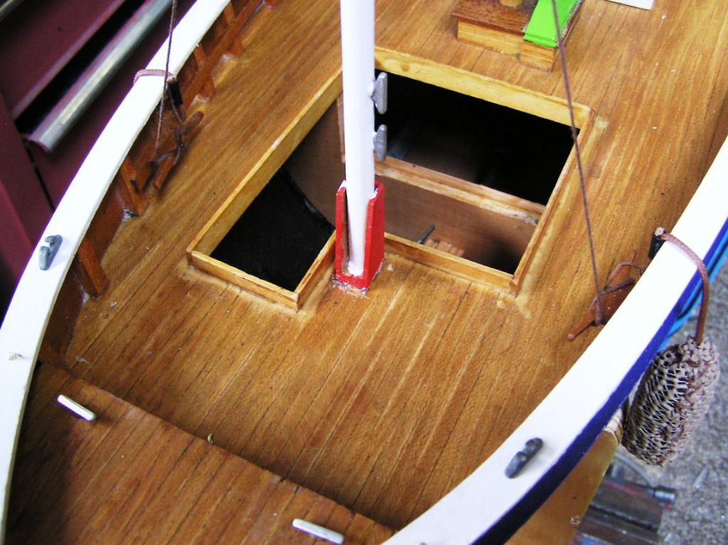

            Repairs at the base of the mast with was seen it the posted pics.
            Bin the old ESC as I could not find any info on the internet about it.

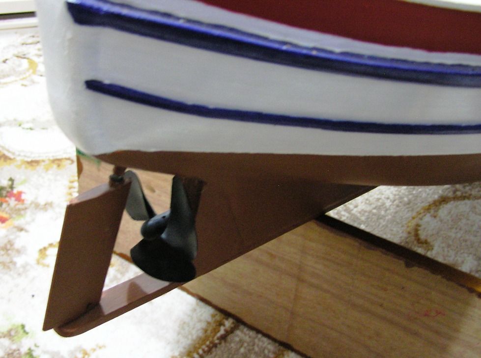

            Removed the prop and shaft which was dry as a bone!!!

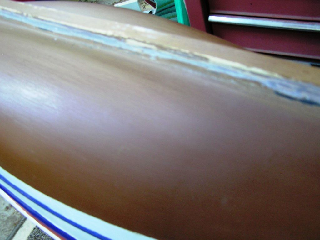

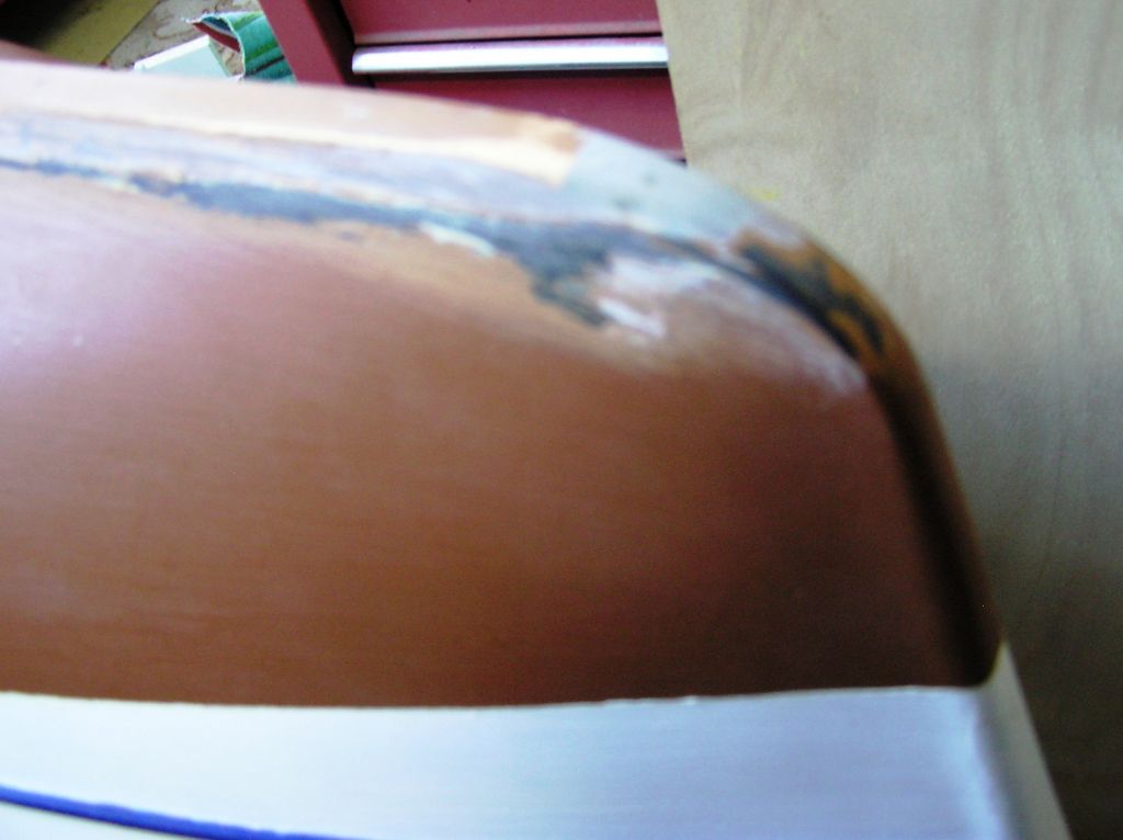

            Start on repairing the keel.

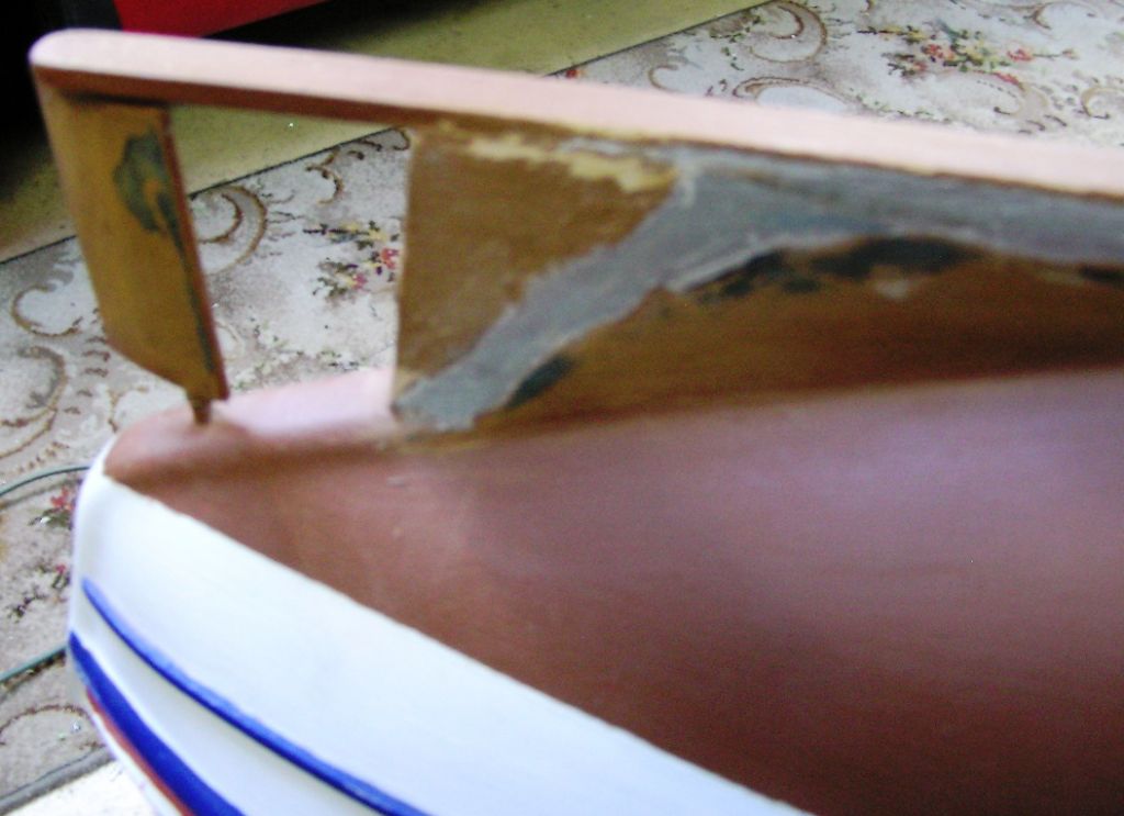

            #78085

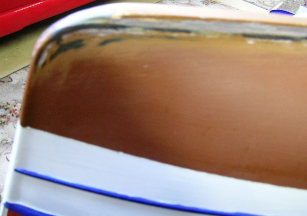

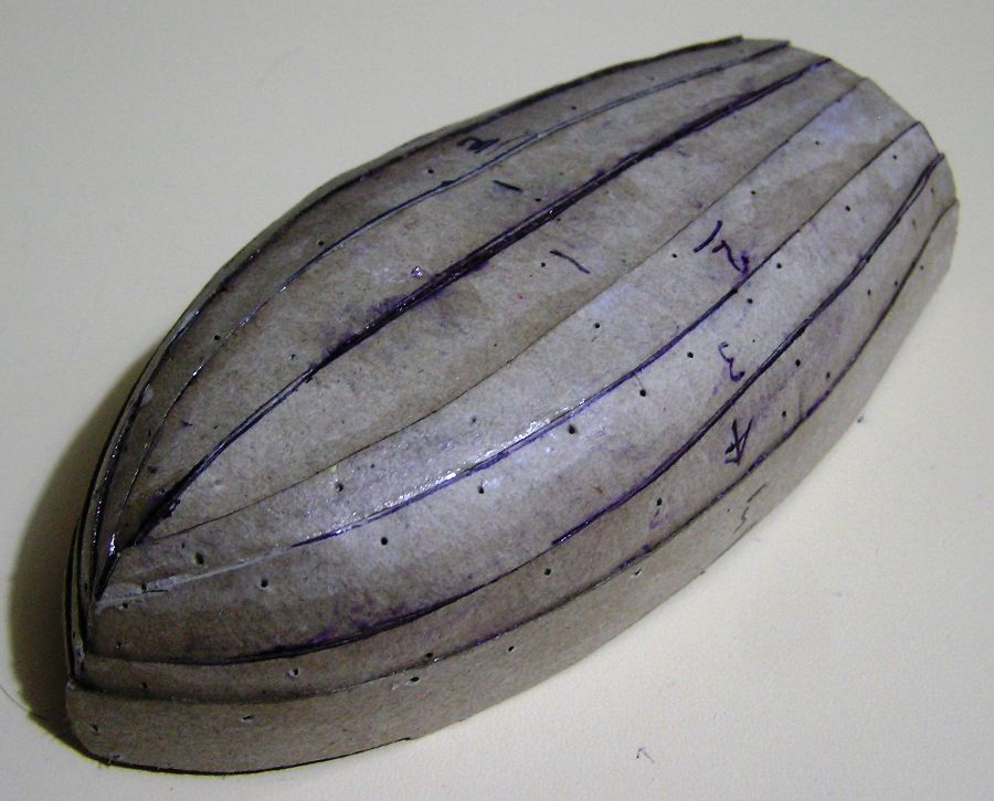

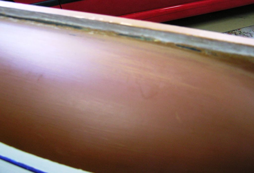

              keel repairs 6.jpgkeel repairs 5.jpgkeel repairs 3.jpgkeel repairs 2.jpgHi All
              It's the end of the day with the keel sanded, filled and sanded again !!!
              Ready for paint tomorrow, but, no Matt 70 !!!
              Well I will use up the last of the Revell paint from the other Hellen.
              Cheers and Beers

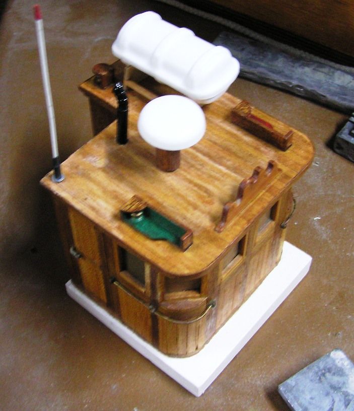

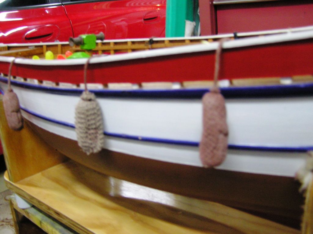

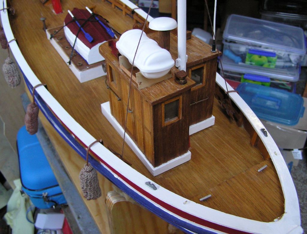

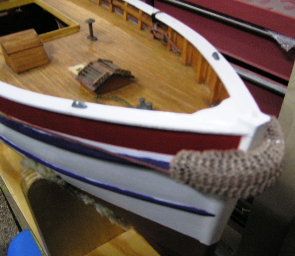

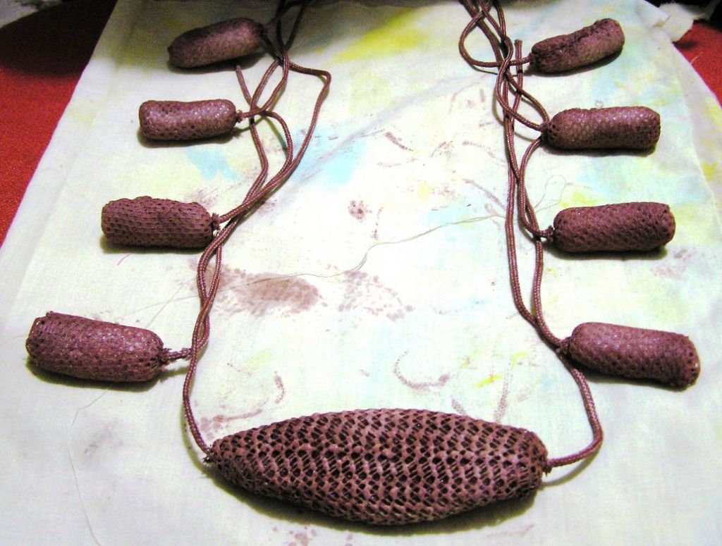

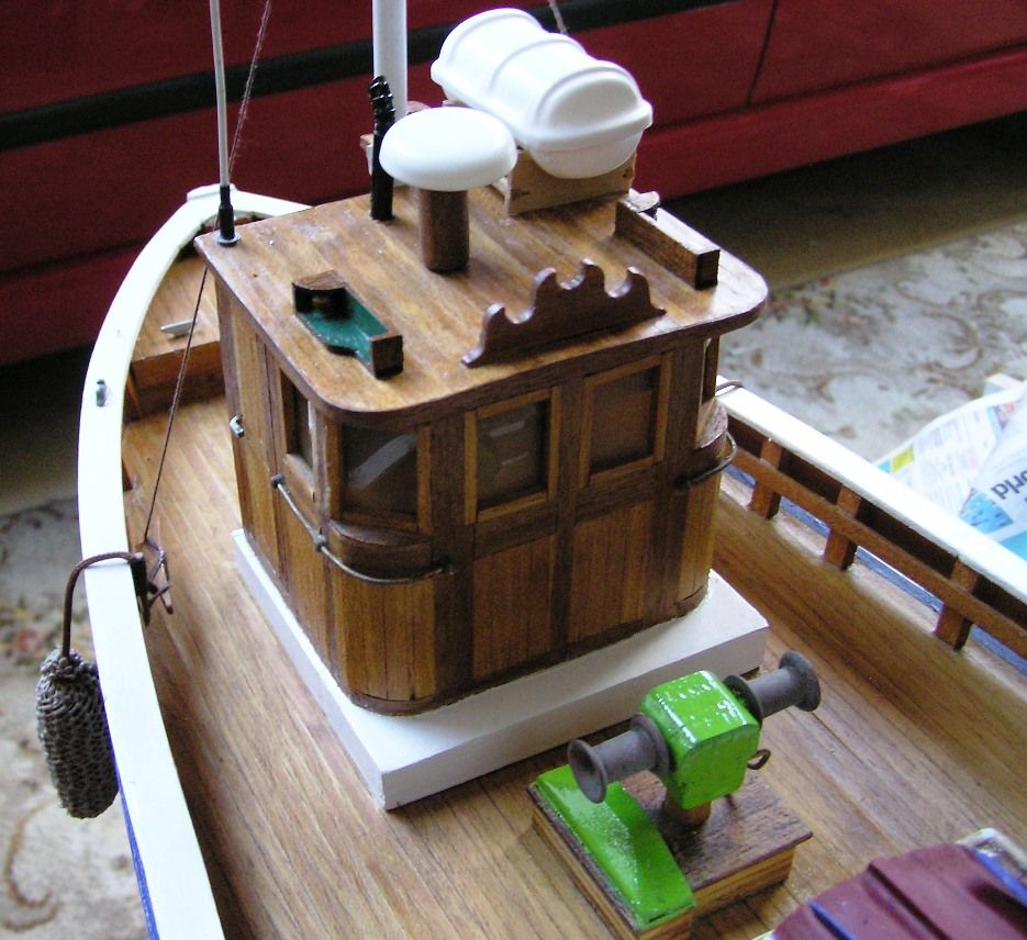

                  winch 1.jpgwheelhouse 1.jpgside view 2.jpgside view 1.jpgmotor with cover.jpgHi All
                  Repaired the gearbox to motor screw holes( fill them with epoxy glue and redrilled with a small pilot drill).
                  The uni joint brass connector was to big a hole size so I ordered a new one, but, I did add shrink tube and heated it up to sleeve it.
                  Looks a lot better than before!!!!

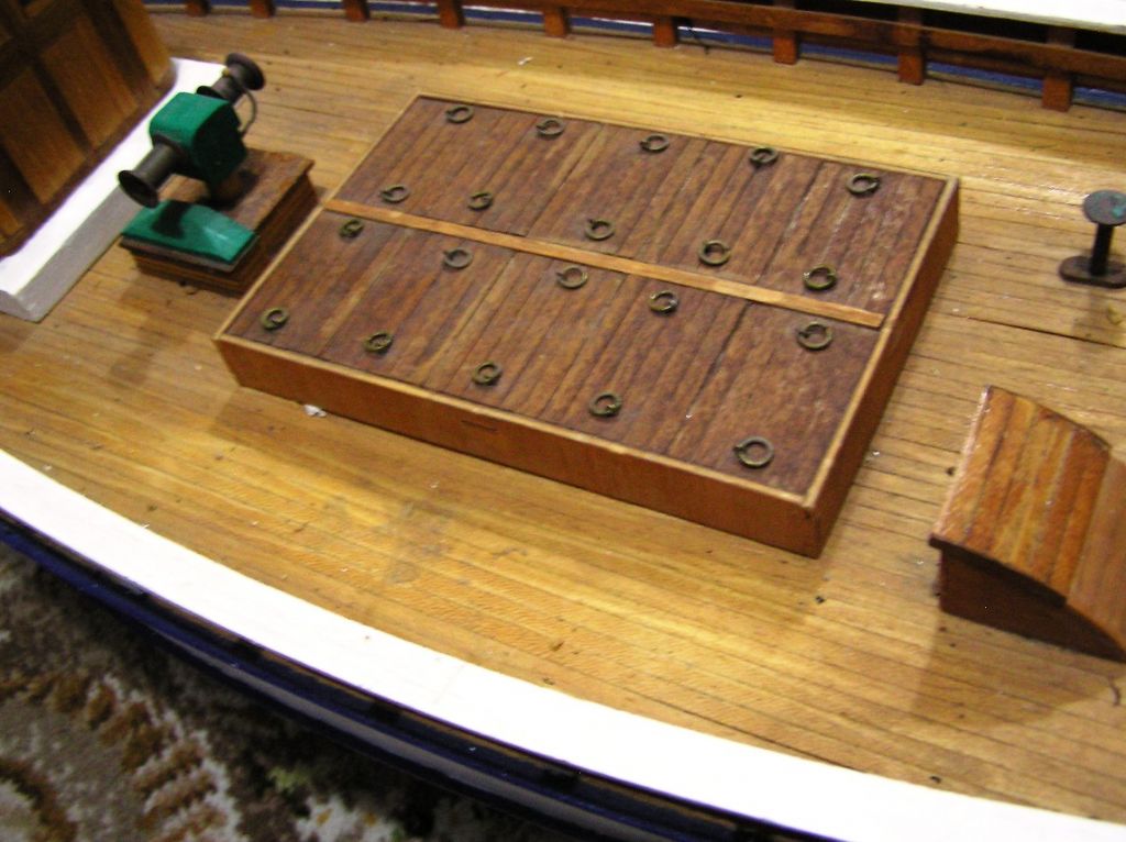

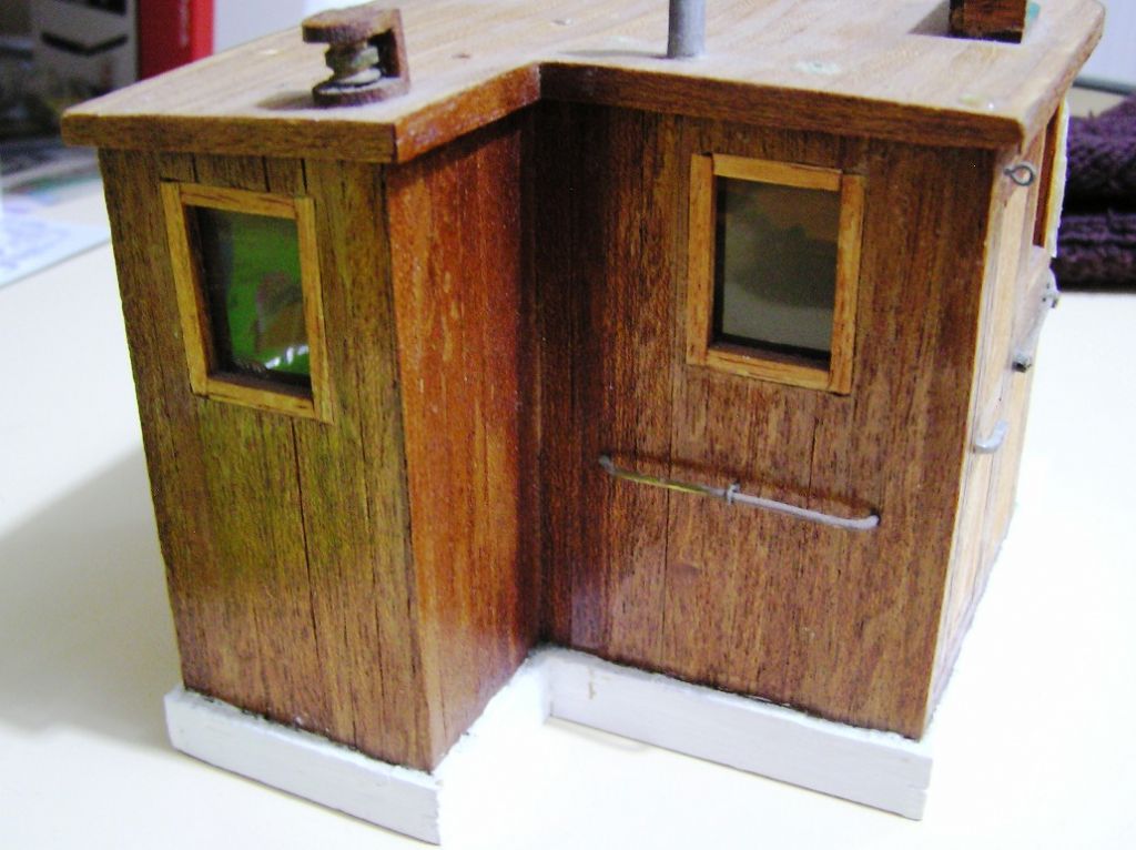

                  My mate made me a life canister and radar dome so I added these to the wheelhouse.
                  Also added a bit of height to the exhaust outlet to make it different from the other boat.
                  The aerial is a rivet base with a brass rod covered with white heat shrink.
                  The base black heat shrink and the top of the aerial red heat shrink.

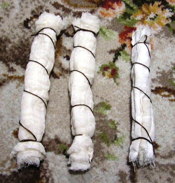

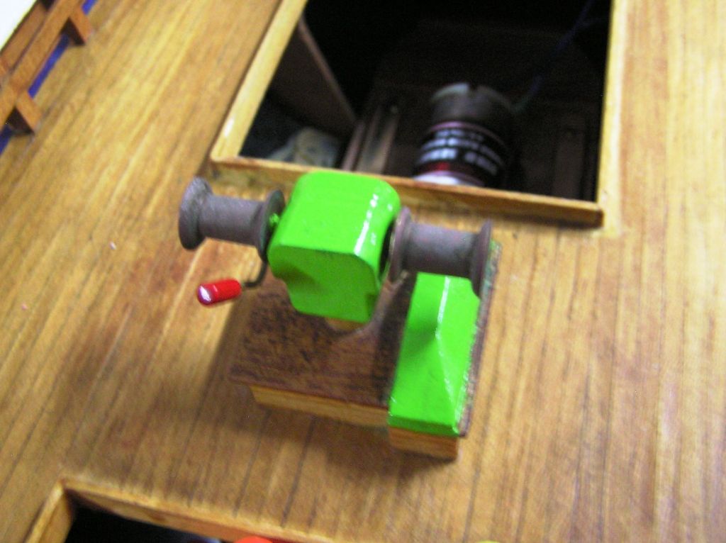

                  Change the green on the winch and added to fenders.

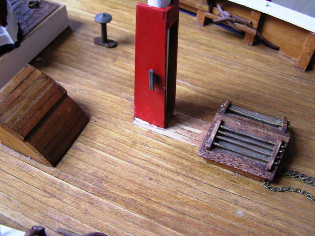

                  Repaired around the mast bases.
                  The weather is cold in Tassie, only about 14, but, we are getting a week or so of rain and high winds !!
                  Also more snow.
                  Cheers

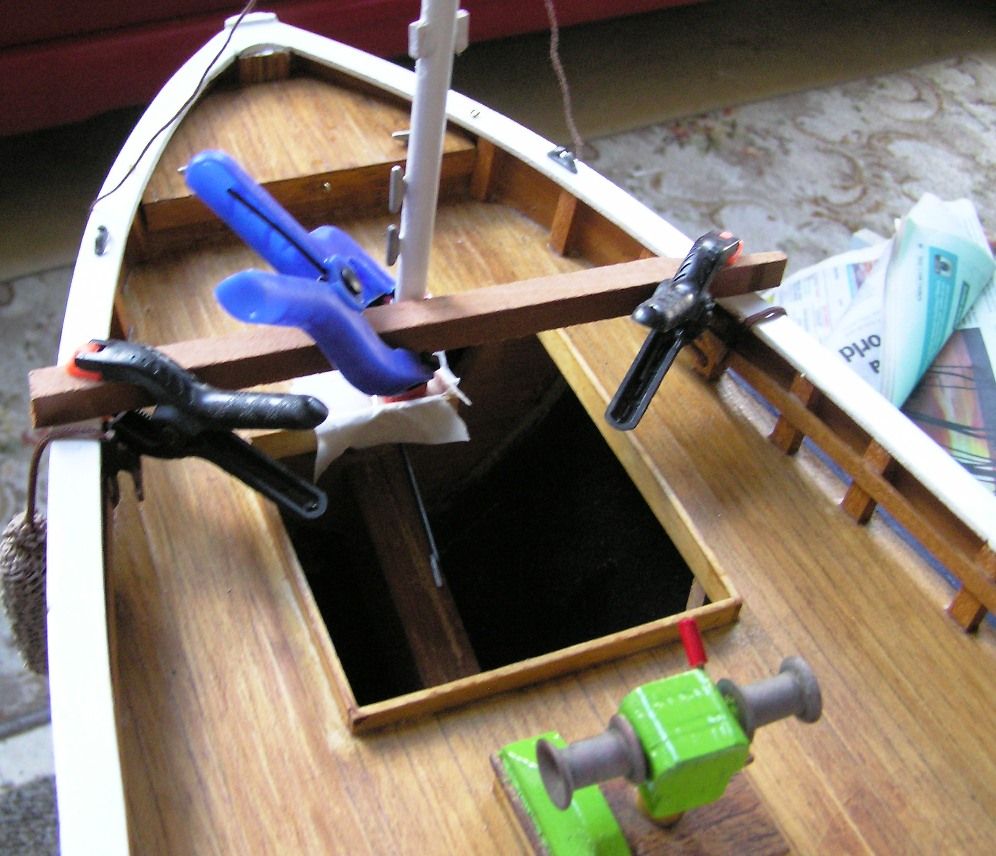

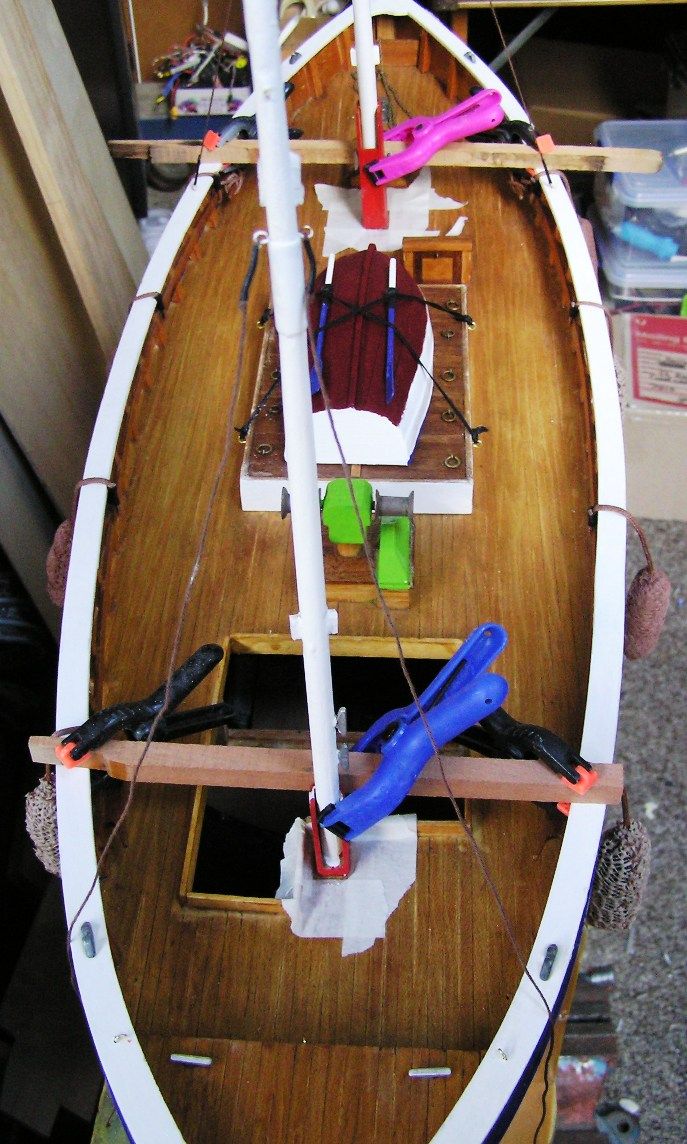

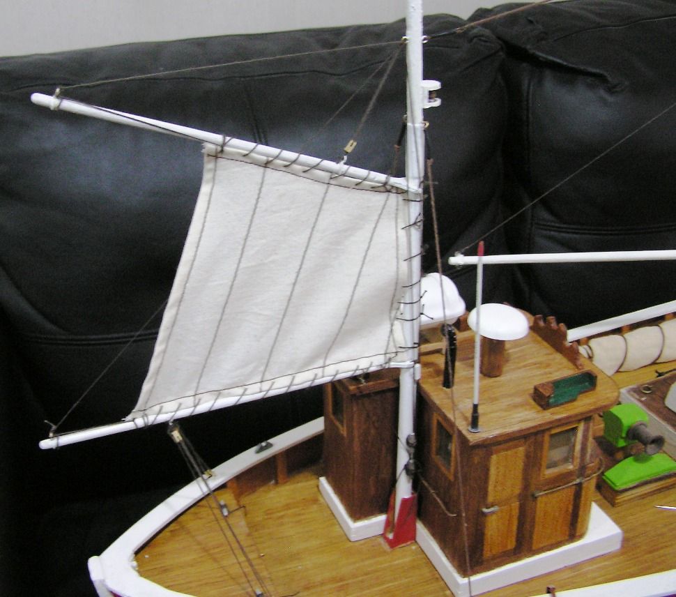

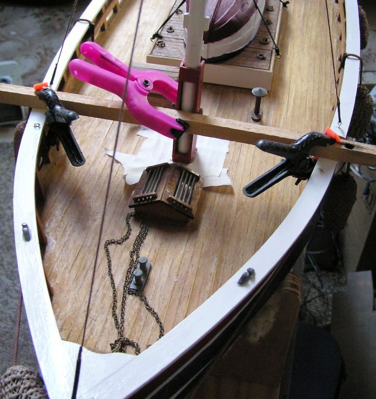

                    forward mast 1.jpgstern view 1.jpgHi All
                    Installed the masts today.
                    #78118
                      wheelhouse 2.jpgstern view 2.jpgforward mast 2.jpgHi All
                      Mast in and started rig today.

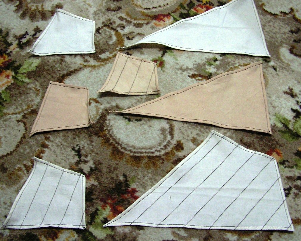

                      It's be nice to the wife day as I will ask her to make some sails for the boat.
                      I have work out the sizes and allow for double rolled edges for strength.

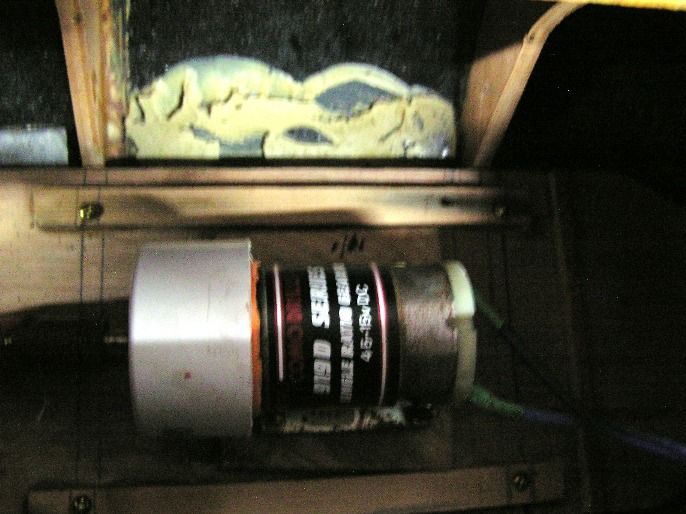

                        sails.jpgone old net and two new.jpgHi All

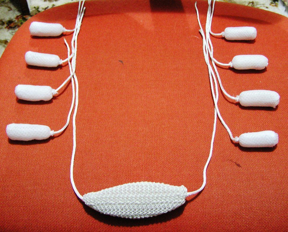

                        Whilst my lovely wife was making the sails, I made and install the new nets.
                        Also drop in the Como motor and radio.
                        Ran up the motor in the boat and found the output shaft require replacement, I drop in a backup motor.
                        A 55 turn rock crawler motor which runs a bit faster, but, I can drop back with the end stops in the transmitter.
                        A lot quieter then the geared setup.

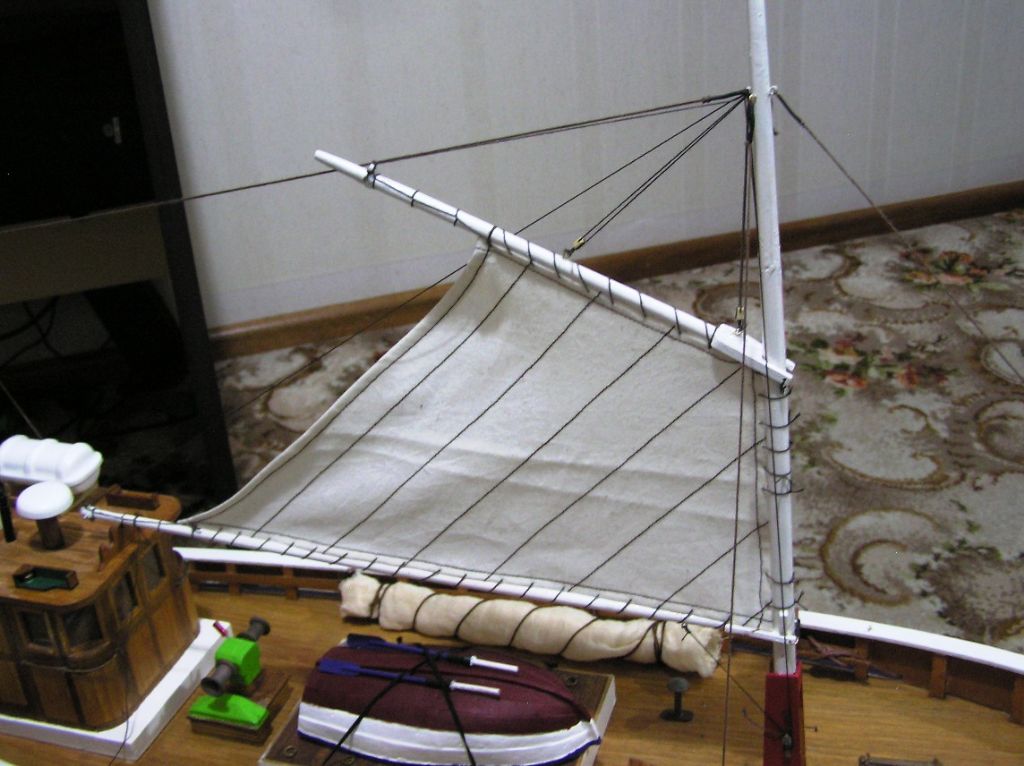

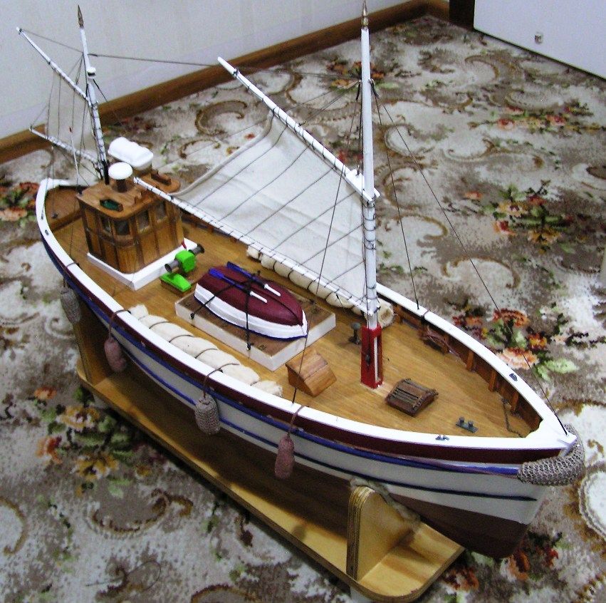

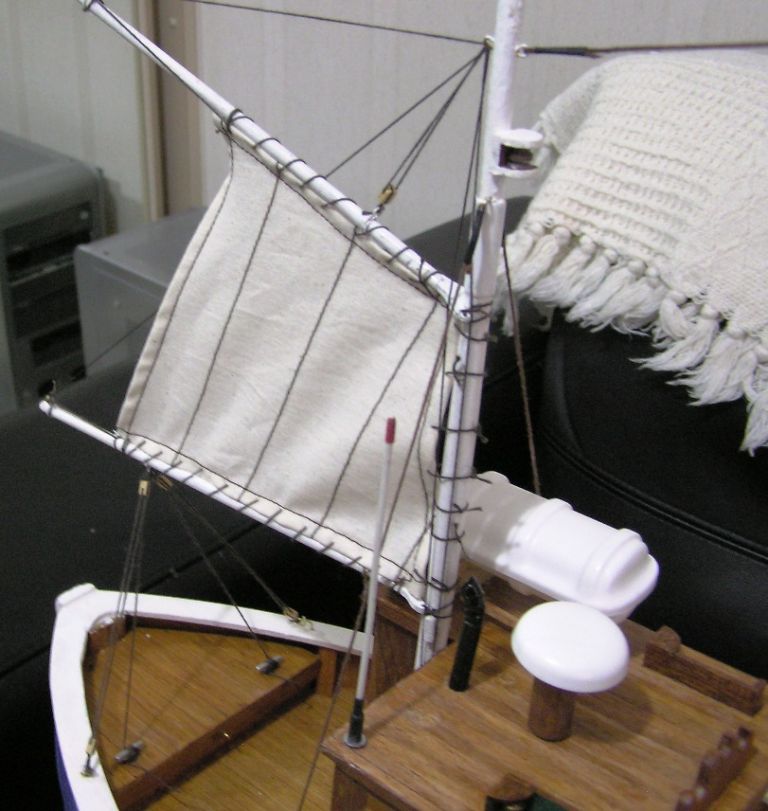

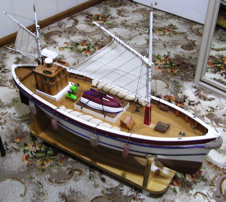

                          full rig 2.jpgfull rig 1.jpgforward sail.jpgaft sail 2.jpgHi All
                          The boat is ready for it first dip in the wet stuff !!!
                          Still a few things I am not happy in it's looks.
                          The top booms are to long and the aft sail is to small.
                          The geared motor has a noise in it which its the bottom bushing, so I drop in a 55 turn rock crawler 540 motor.
                          Very quiet, but, a bit high on the rpms.
                          OK, but from the first dip !!!
                          The boat ran spot on, but with a little to much weight in the stern.
                          Crank it up to full speed and have trim the throttle to 80% for the next run.
                          Back in the shed tomorrow for a few changes!!!

                            Well done Harry, another very presentable fishing boat!!
                            Those geared motors are a bit noisy anyway because of all the gears, however the bushes should not be noisy.
                            How about raising the top gaff and making a larger main sail??

                              I have shorten both gaff booms which looks a lot better.
                              Also shorten the forward boom a little because it was to close to the radar .

                                The side fenders were flying about under sail, so I made a new set with a small lead weight in the bottom of them.
                                They sit better on the boat already.

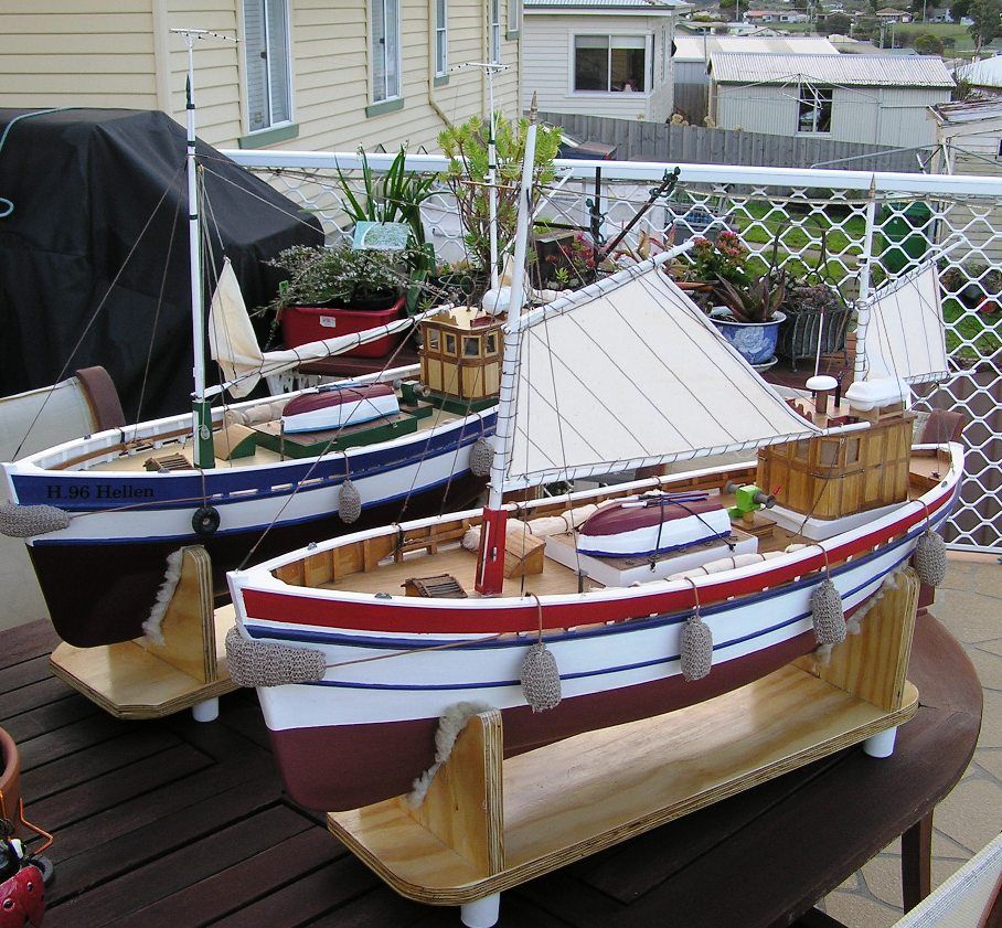

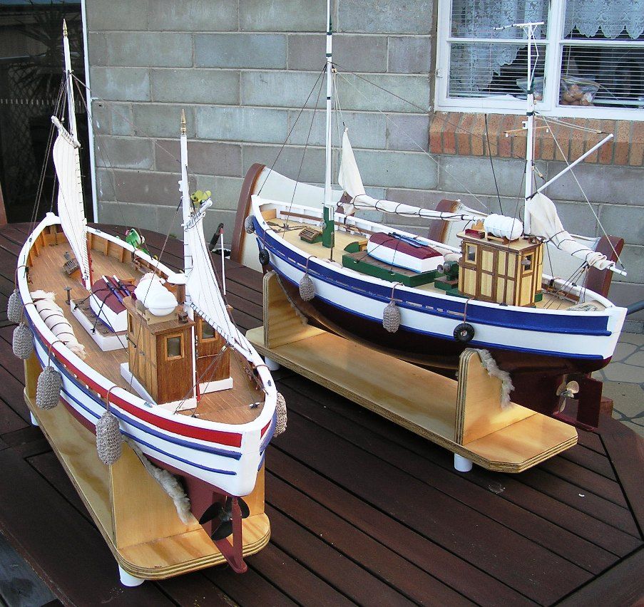

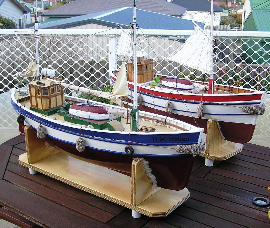

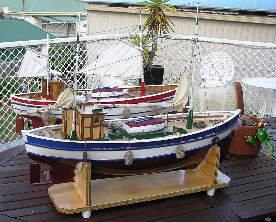

                                  hellen 2 and 3 view 1.jpghellen 2 and 3 view 2.jpghellen 2 and 3 view 3.jpgHi All
                                  A bit of sunshine today, so I photo the two boats together on the back deck.hellen 2 and 3 view 4.jpg
                                  #78224
                                    Harry. They look very nice together, especially on their varnished wooden stands and having a net (ish) background.
                                    I must say though the fore sail looks a bit small to me??? I like the folded sail on the blue one.
                                    #78228
                                      Hi Ashley
                                      The blue boat was built as per the plan and pics from the original kit.
                                      Yes I think it's to short and is why I gaff rig the other boat.
                                      A copy of the box and de-constructing's is in my album .

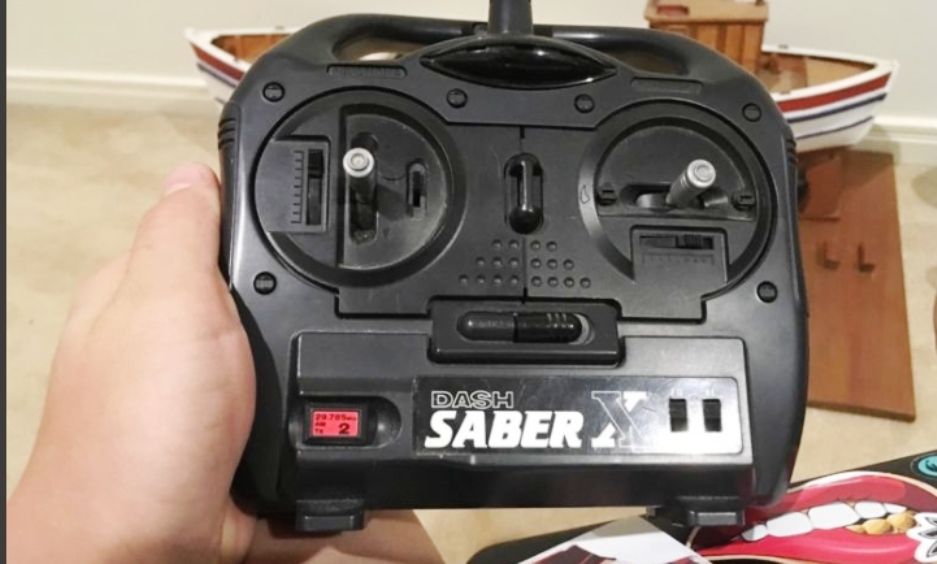

                                      Finally work out the throttle limiting on the Turnigy/Flysky IA6.

                                          The Flysky and Turnigy are the same !!!
                                          After setting the throttle limits( read the instructions) to 40% on both boats for forward and reverse.
                                          The test today on a nice 16 degree day, both boats ran well.
                                          The Hellen with the brass prop stops better in reverse.
                                          A simple change to up the reverse on the other Hellen with the original plastic prop (read the instructions) to 50%
                                          will fix the problem.
                                          Getting the hang of these new radios is a lot easier with the help of you tube, forum sites and club members.
                                          All else fails, read the instructions !!!!!!!!!!!!!!!!!!!!!

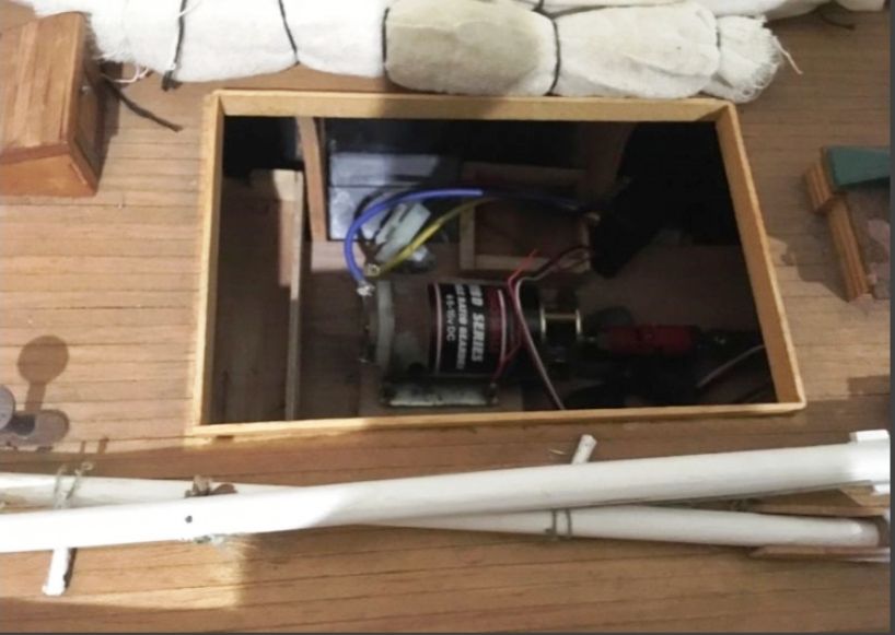

                                            #81759
                                              Hi All
                                              The boat has been sailing well until yesterday when the battery alarm went off !!!
                                              Returning to shore the boat look a bit low in the water.
                                              On lifting it up it was far heavier than 14 pounds.
                                              A lot of water inside and water streaming out the prop shaft.
                                              Well that's what it look like !!!!
                                              Removed a good gallon of water.
                                              Spray the ESC, motor and battery with CRC.
                                              All tested OK !!!!

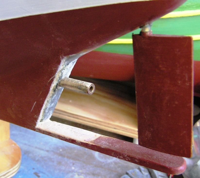

                                              On removing the prop, motor and shaft.
                                              No water in the silicon tap grease in the tube!!!
                                              On checking around the prop tube all the plywood was wet and had open up.
                                              Removed this and found a small hole under the tube which the more I removed turn into a 4mm hole right into the hull !!!
                                              Filled the hole and clean up all the old glue.
                                              Reglue under the prop tube.
                                              Started remaking a new plywood section.
                                              htthttps://www.youtube.com/watch?v=i4zAorzHG90&feature=youtu.beps:
                                              //www.youtube.com/watch?v=Zhmg6kyk2go&feature=youtu.be
                                              Added two video links from yesterdays meeting.

                                                Well chaps the old girl is out of dry dock with a new plywood section fibreglass resin coated and painted in ye old Matt 37.
                                                Changed the original plastic prop to a brass five blade to test out the prop on the 55 Turn rock crawler motor.
                                                The 55 and 60 Turn motor handle 60mm 3 blade props, so I though give the 5 blade a go.
