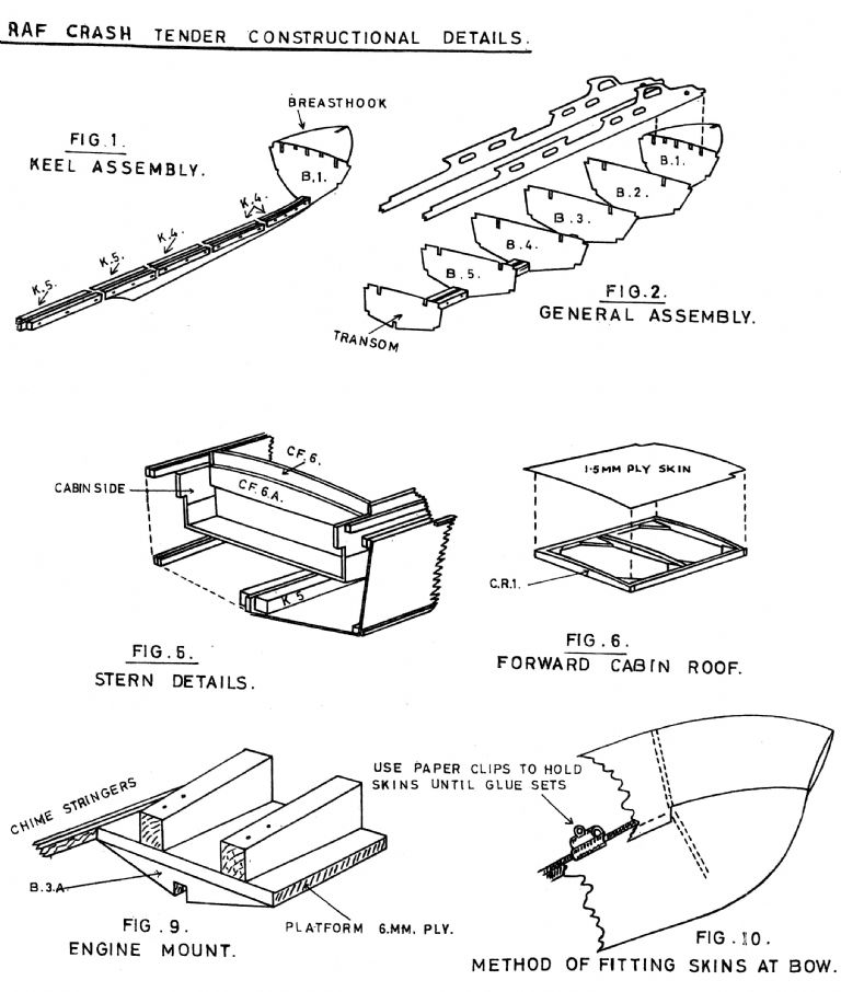

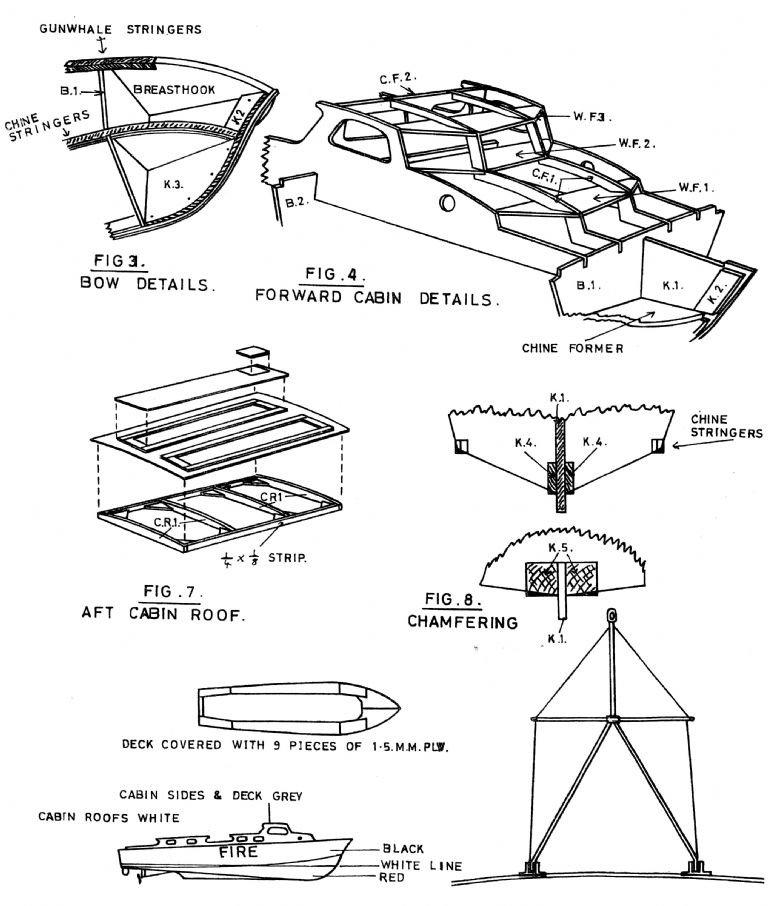

      i have some old model boat kits , one of which is an original Aerokits crash tender circa 1968 ,there is about 10% of the kit missing ,i have the plan and build instructions ,but im missing the assembly diagrams sheet and the templates sheet. is there anybody on here that may have these please

            I bought one of these this morning – the plan and build instructions are present, but haven't shifted enough wood out of the way to see if there is anything more printed material. In my experience, older models like this didn't include parts templates as everything ws ready cut, nor did they have assembly diagrams. I will check mine later and let you know if there is anything else in the box.

              I've checked through my kit, there are only the plan and and the instruction leaflet. The assembly diagrams are mentioned in large print on the plan, but are not present in my kit. Looks like we are in the same boat with our boats!

                diagrams a4a.jpgHdiagrams a4b.jpgHere are the missing…………

                  Can be downloaded from crash tender album………..

                    Can you supply a link to that please. I collected an Aerokits 46" Crash Tender kit yesterday.

                      Go to albums – click on latest postings – find the drawings – click on them – click on my user name highlighted in blue – click on pictures in my profile – select the pictures & down load – also see my PM sent to you for alternatives
