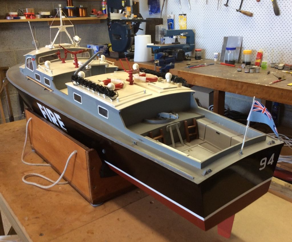

      HI Guys
      I bought one of these for a good price.
      It very well built, minus motor, radio, servo and battery.
      Full set of new decals with a number of these installed.
      The catch poles each side of the wheelhouse require replacing(no problem).
      The bearings in the drive line are shot, so a mate is making a set and resizing to 4mm shaft with dog drive setup.
      Require good close up pictures of the anchor, mast and the foam tubes and fittings please.

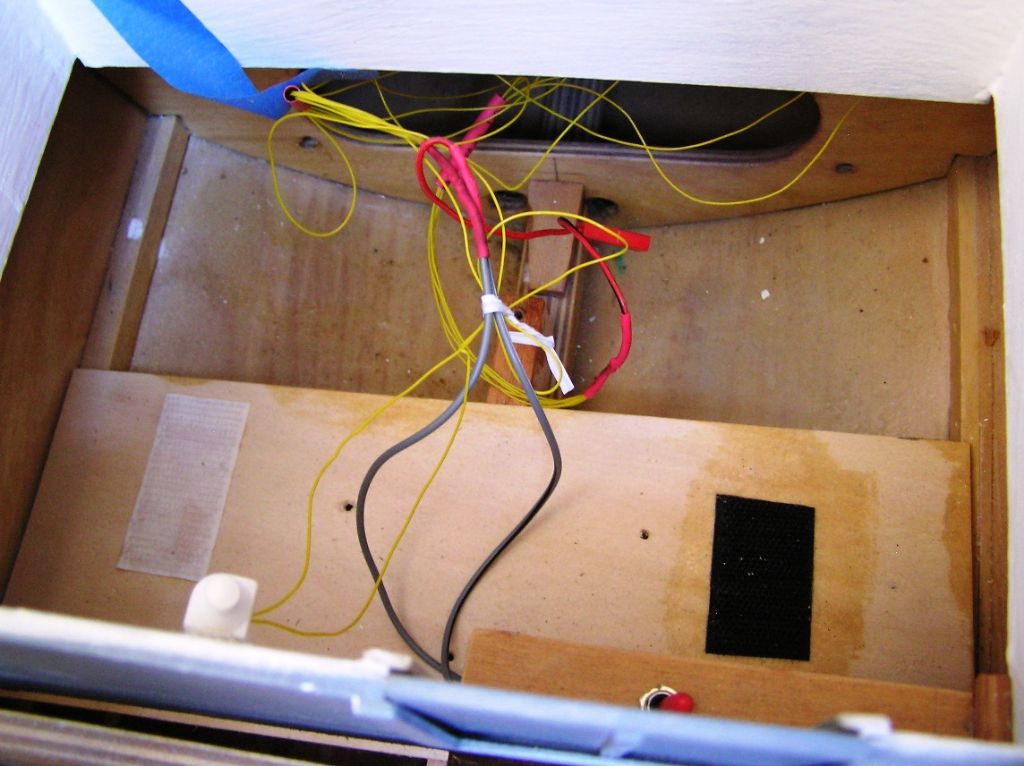

      The wiring in the closed up wheelhouse section is another problem, it is a mess and some of the lights do not work.
      Looks like a removal of the roof and fix the mast up.
      Hope one of you help me out, please.

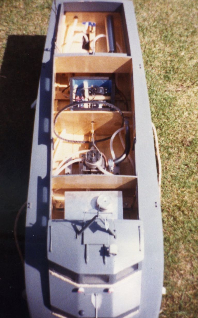

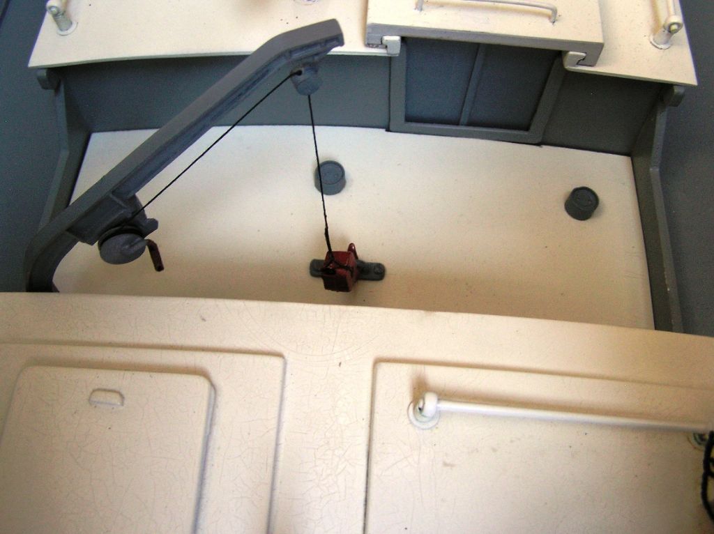

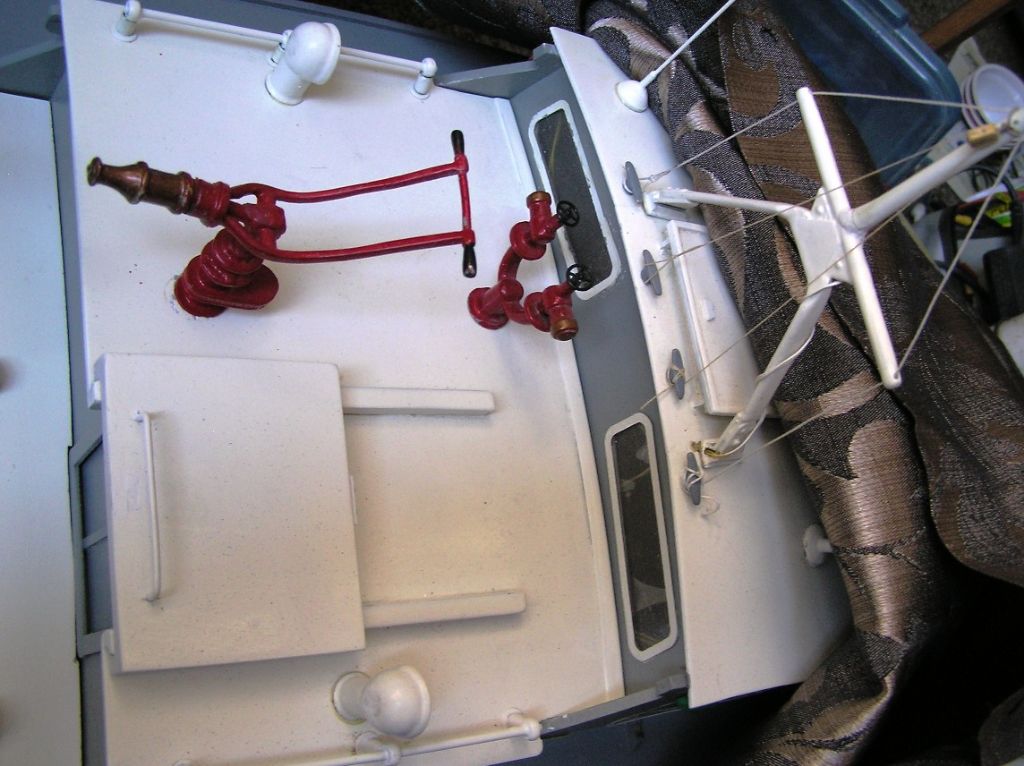

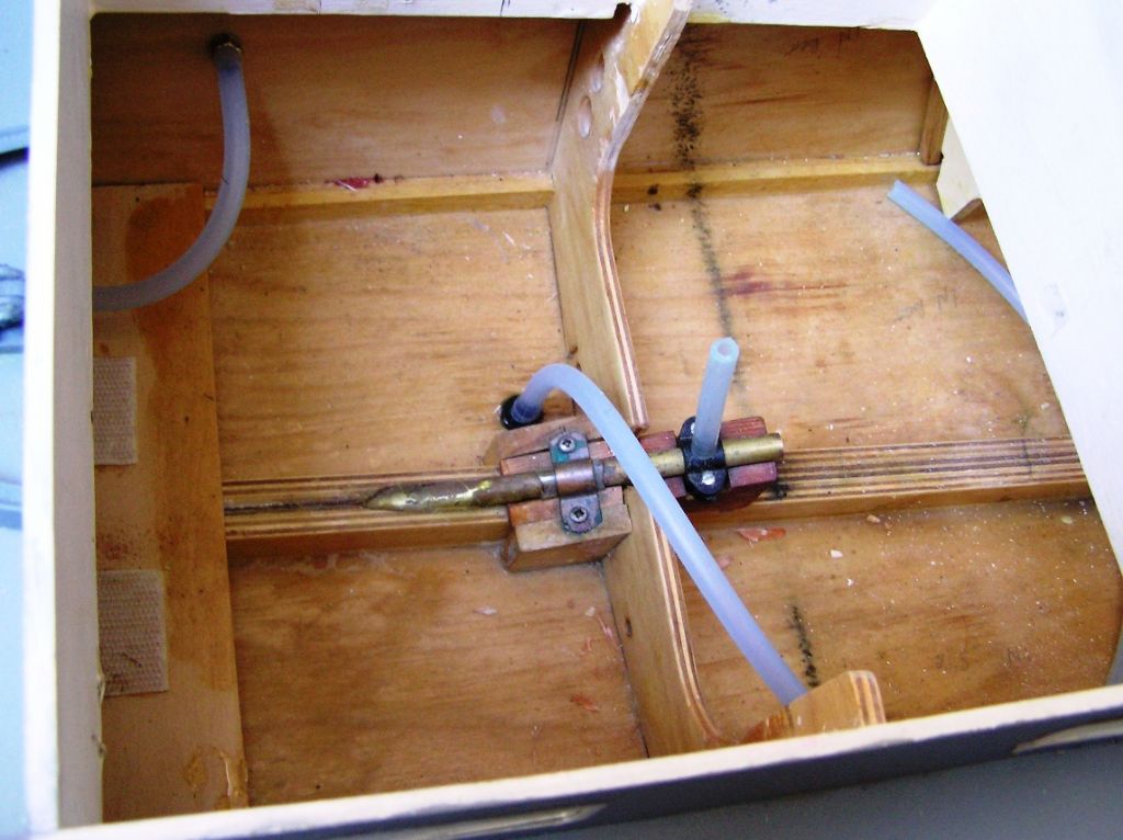

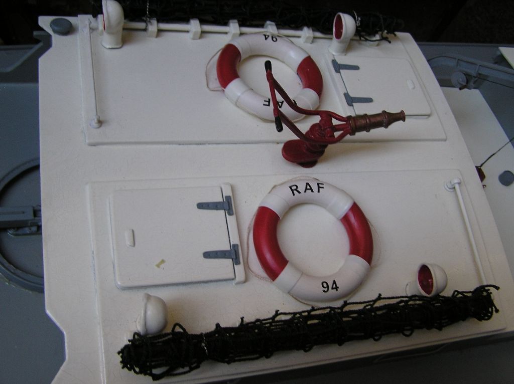

          stern view 2.jpgside view 2.jpgrear water gun.jpgforward water gun.jpgforward battery bay.jpgengine bay.jpgcrane.jpgHi Guys

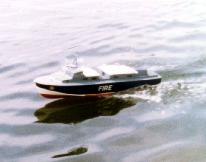

              Nice model Harry, which brings back memories. My model gave good performance and was powered by an OS60 glow motor. It wasn't as well detailed as yours. Glow powered boats always took a 'hammering'.
              When the councils started to frown on i.c power, I did attempt an electric conversion, but at the time there was no brushless and lipo. I was never happy with the performance and sold the model at auction.

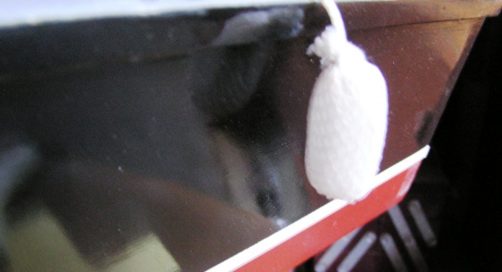

                Hi Ray
                The aft cabin paint is all crack and the top of the mast is very sitting in place by the wires.
                The rear foam hoses are missing, but, I found a bit of black 240 volt power extension cable look the right size.
                Hope someone posts some nice close up pictures for me.
                The original one's are only white metal I was told and not very good!!!
                The anchor looks to be about 50 to 60mm, I may make my own.

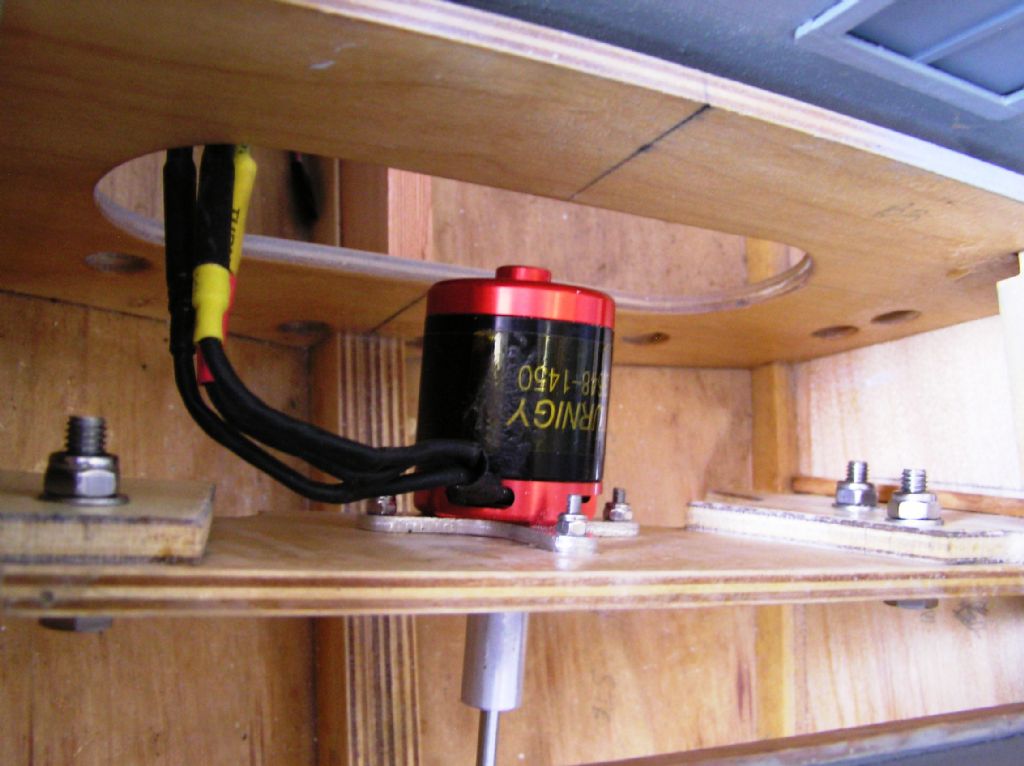

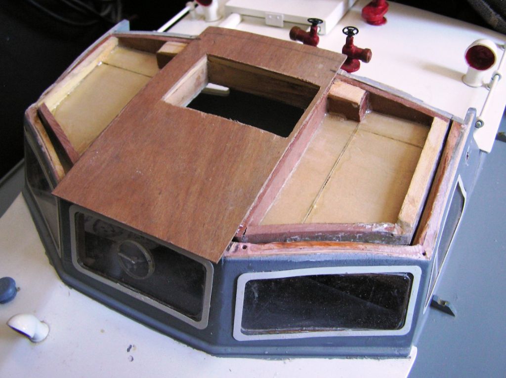

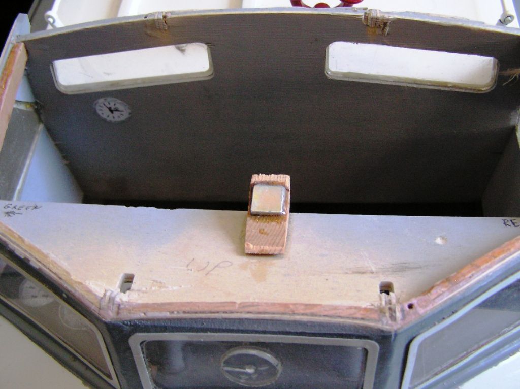

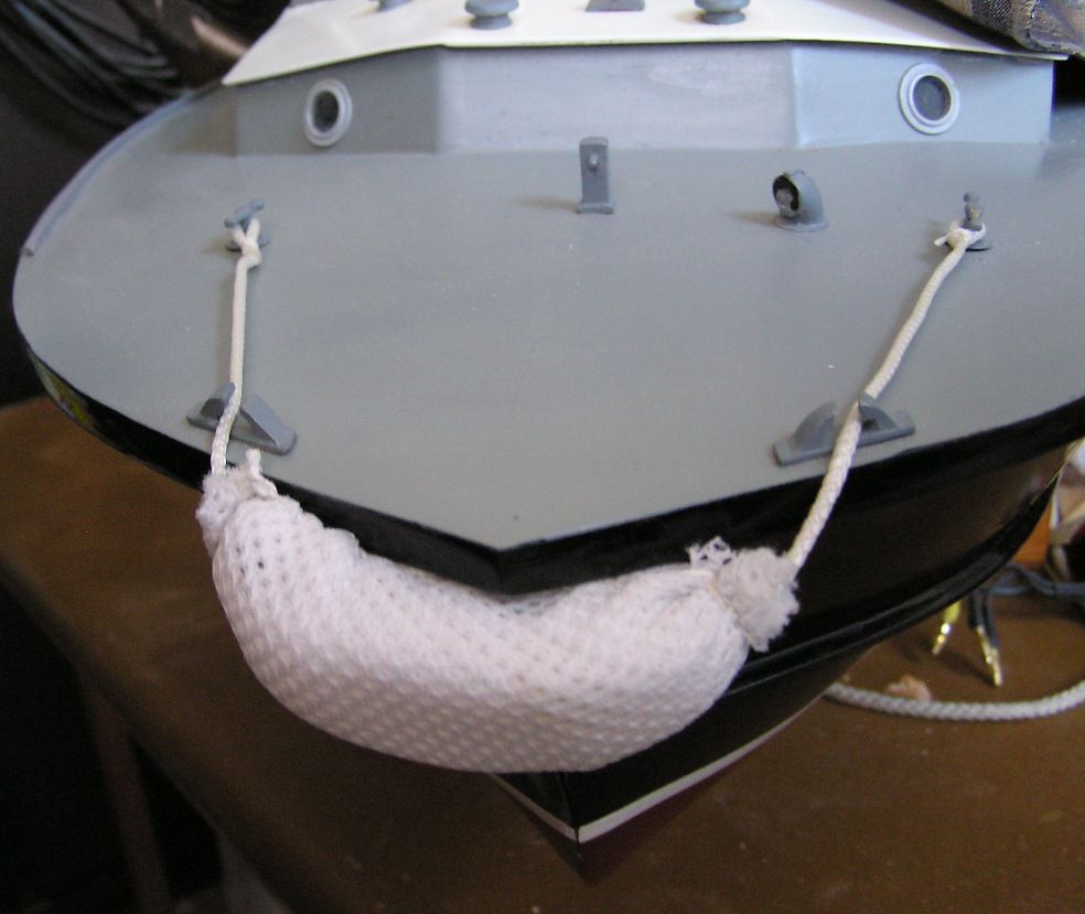

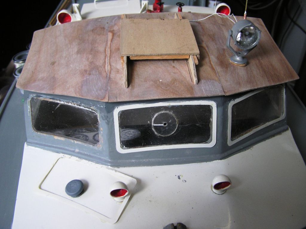

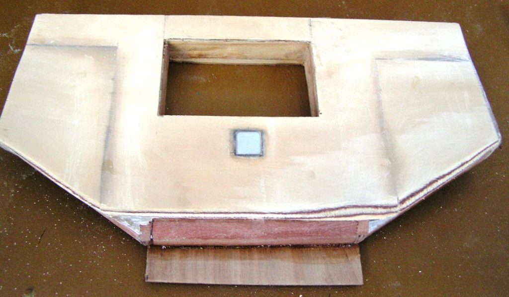

                                    side fender.jpgbow fender.jpgmiddle wheelhouse roof panel.jpgother magnet wheelhouse.jpginner wheelhouse roof with magnet.jpgHi All
                                    A bit of work on the boat.
                                    New 4mm driveline with bearing installed with a 3648-1450kv 35mm motor.
                                    Solid alloy coupling.
                                    Started on the wheelhouse roof and made a big mistake!!
                                    I made the hatch 10mm to wide, so I am filling the hole.
                                    Added 10mm magnets to hold down the roof, I only removed it to fix the old non working lights.new turnigy 3648-1450kv motor.jpg

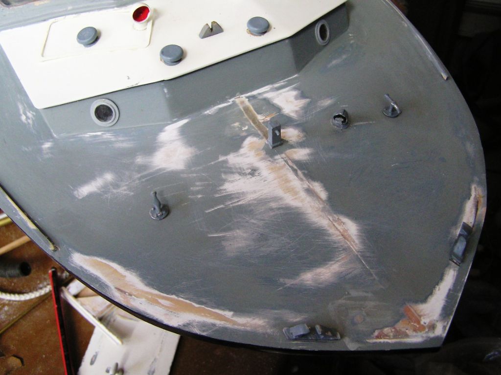

                                    #71595

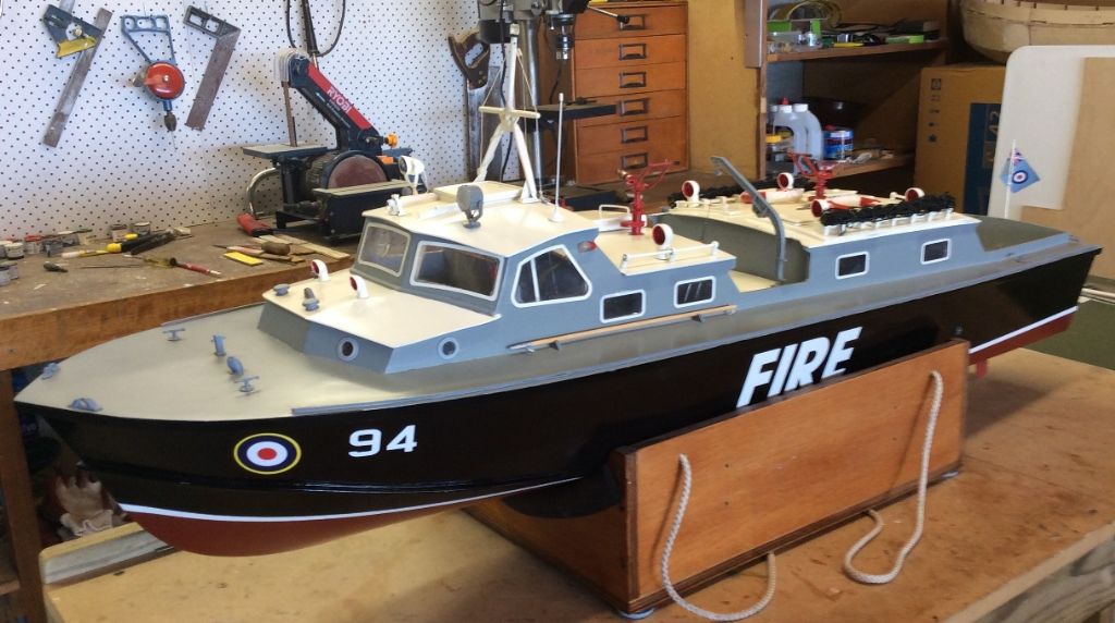

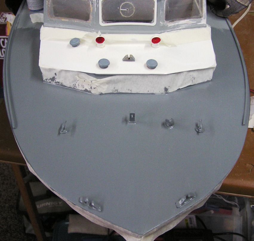

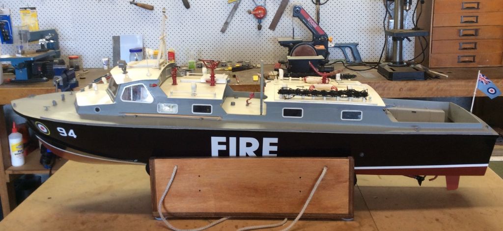

                                      repaint forward deck.jpgrepair forward deck.jpgHi All
                                      A bit more on the boat as the summer is over and a number of other projects on the go.
