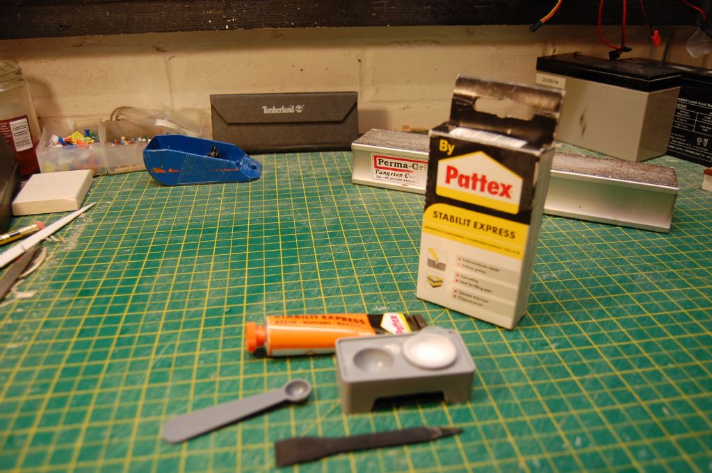

                Stablit Express is still available made by Pattex, and is sold in ALDI or LIDL occasionally, a 2 part resin and white powder as the photo, It also comes with dire warnings was always good for plastic to aluminium joints on helicopter kits etc
                As David says UHU have a glue for most things
