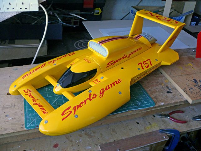

            I picked up a lovely bargain at the Bury Show last Sunday
            A pretty speedboat going for a song!
            Didn`t realise it was one of those fixed frequency jobbies…….Looks very nice though
            How will I go on at the pond?……………..Bob

                  Pretty eh?……………Pity about the radio gear
