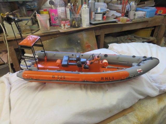

      i have built a couple of these in the past from virgin kits, and have also restored and rescued a couple of badly damaged ones that would have probably gone to the tip, some years ago before they became rare and collctable.
      first coupe of pictures show one i rescued and restored.

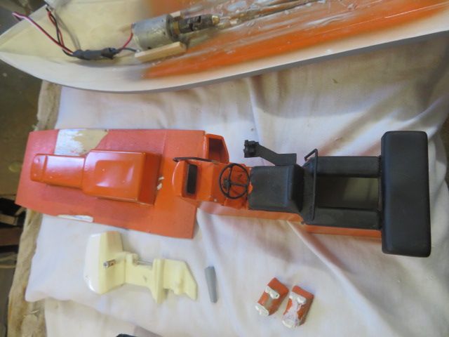

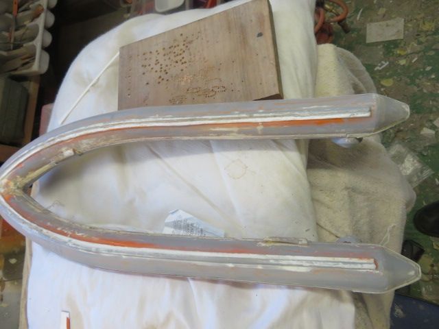

      the following ones are from a fully built one that i swapped for a set of mouldings for a modern Tamar kit on friday in Windermere.
      it had been well made by the young gentleman, but because of lockdown, he couldn't get hold of any plastic weld glues and had to use cyano acrylate………and this becomes hard and brittle after a while. In the end the seams of the sponsons were opening up, and so i decided to strip it down to basic componants, use plastic weld glue, and rebuild it as the first ever Atlantic 21, the RNLI B-1

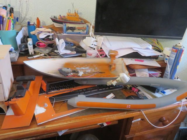

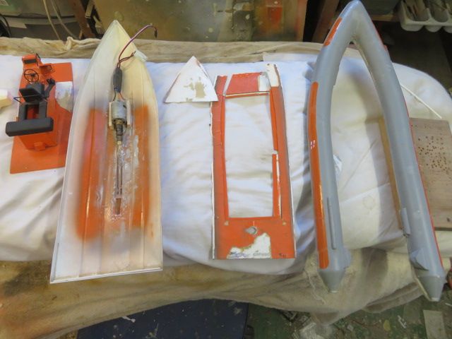

      And so last night and the previous day i stripped it down.
      and the one i picked up on Friday.

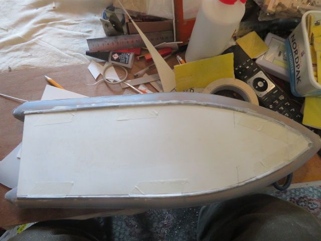

      and then i made a new sub deck of 1mm plastic card so that the new wooden deck as on the original boat contained.
      and finally, this is the boat, slightly different to the production line, that i shall model.

                    changing back to the Atlantic 21, and fitting the deck.
                    i took the old deck and used it as a template for a new plasticard deck. I then used this new deck to mark out one from 1.2mm mahogany.
                    these two decks were to be glued together and so rang my mate Dave Stavros Jones to ask if Evostik contact adhesiv would be ok, and although the consensus was yes, but then Dave suggested 2 sided tape, and i agreed, so tried it.
                    Unfortunately, the tape wouldn't stick to the ply, and so i reverted back to Evostik which did.
                    Once glued together i marked out the access hatch and before fitting to the sponsons i cut through the mahogany layer and partly through the plasticard deck to make it easy once glued in place.
                    the final job tonight was to glue the deck into the sponsons, using plastic weld glue, it glue plastic to plastic, which was left to set before reinforcing the joints on the underside with 10mm wide strips of plasticard, bonding the deck and the sponsons even more.
                    the whole structure has now been left to set firmly.

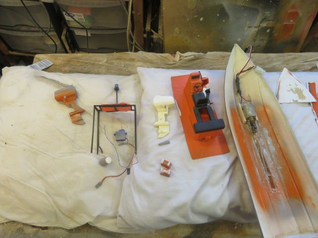

                        This afternoon after taking the masking tape off the boat to check that the hull and sponsons ha glued properly, giving the boat some rigidity I made the main seating, which is different to that fitted to the production 21's.
                        Rather than the helmsman sitting in front of the two other crewmen [sat side by side behind] on the prototype and first prototype/production boat, all three crewmen sat in tandem, behind the helmsman, and so I had to make a new centre pod.
                        I also made the transome that on which hangs the top bracket for the outboards.

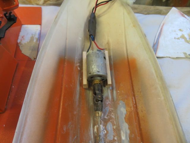

                        The outboards will act as rudders, and so like on my other 21, it will be steared from inside the hull by mini servo. But this time instead of aeroplane snakes fitted to my other 21 i am going to use nylon string using fishermans swivel clips to turn the outboards.
                        Hence hiding then to run through the white plastic "tunnel into the seating pod and to the servo inside the hull.
                        Finally I rescued the helmsmans seat from Andrew Cowling's boat but damaged it removing from the original pod and so have pannelled it with 0.25mm plasticard. Once trimmed off and sanded I am going to make a mould for it so I can cast it in resin for this and my unbuilt 21 kit.

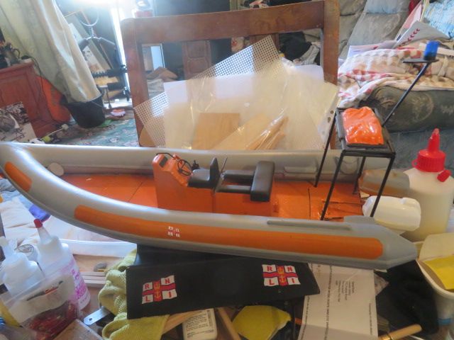

                                        started spraying my Atlantic 21 last night with filler primer from halfords.
                                        had rubbed down the existing paint to almost bare with various decreasing grit courseness, and then applied the rattle can…….
                                        heating was on in the garage, but when i went back about an hour later, found the paint had crinkled and orange peeled…..BUMMER!!!!
                                        So rubbed it down last night and then a thin layer of Dolphin glase filler.
                                        This was left until just after lunch this afternoon, before sanding it down with 200 grade paper.
                                        Finally i resprayed it this afternoon in 4 seperate very thin coats, of just a whisper of paint each time.
                                        this time, no problems.
                                        #99768
                                          first light coats of Volkswagan Brilliant Orange colour have gone on to the hull bottom and seat pod for the Atlantic 21.
                                          it needs a couple of more coats to deepen the sheen, but in the meantime once the bottom has gone off in an hour or so, i will spray the sponson tops with orange so that they will be the "flash" down the sides to put on the R.N.L.I. and B-1,
                                          then all parts orange will be masked off with low tack tape whilst the rest of the boat is sprayed with grey primer to give the matt finish of rubber sponsons…..
                                          might take a couple of days between coats and curing to achieve this, but a patient man i have become due to Dave Stavros Jones nagging me and giving me tuition………………
