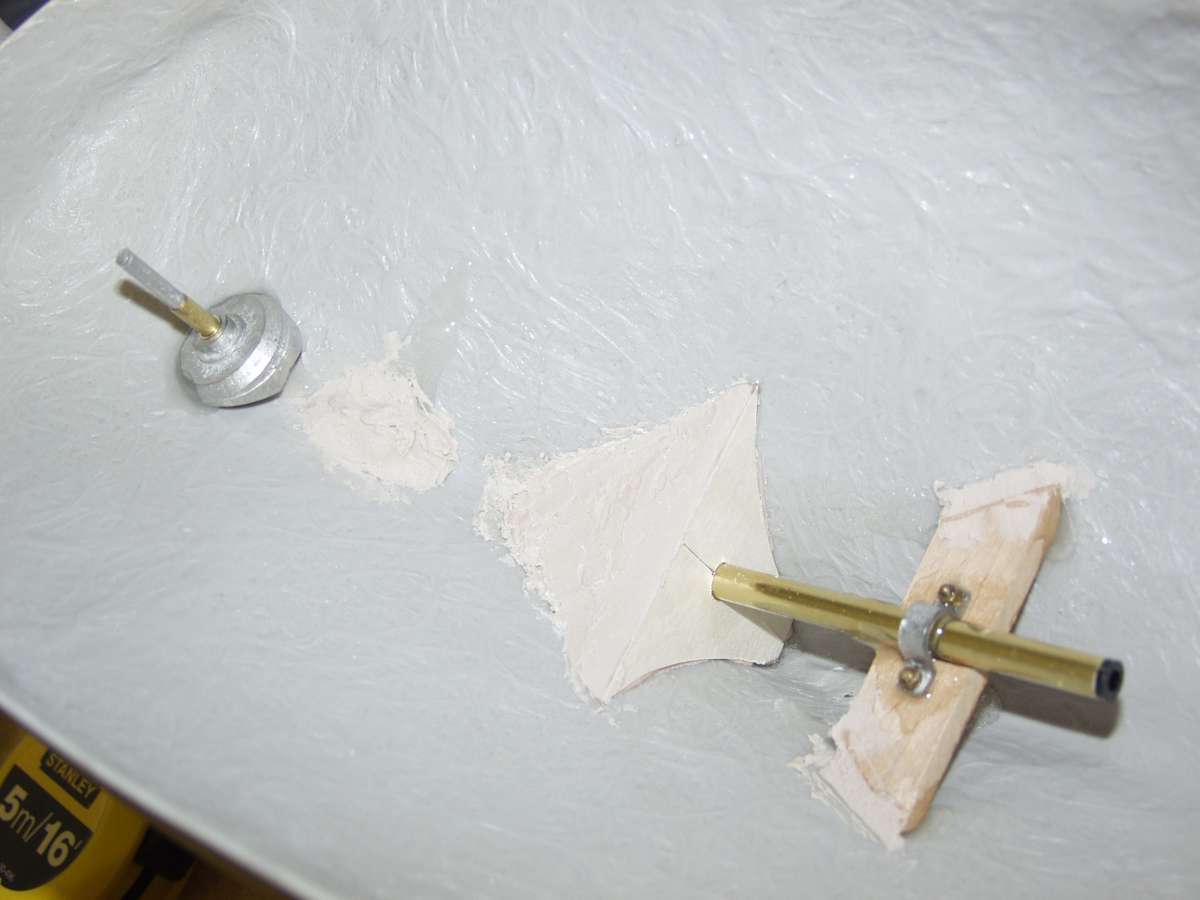

                                        Prop shaft inboard ends can be lower than the water line however you must be aware then of the need to ensure the shaft is better sealed.  Bushes need to be a good fit on the shaft, sealed ball bearings are better, and thrust arrangements need to have the minimum clearance.  If I had to have an inboard end lower than the water line I would use sealed ball bearings rather than bushes, but that’s just me being over cautious. When I built the Ben Ain this was my first attempt:
                                        fc05vr1jshdykh4yrdbqu25vyrvrlg3y
                                        g1nuiyuk5ytuks0doumiyoqm8qqer65z
                                        But I didn’t like it after tests in the bath so I ripped it all out again and fitted a sealed ball bearing shaft arrangement.
