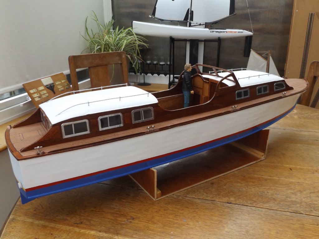

              Good old Humbrol enamel white topsides, blue below the waterline, masked with Tamiya tape and the boot topping put in red by hand with a long haired brush, makes her look quite smart, cockpit joinery seats etc and the deck fittings to go, cheated and bought fairleads from Rob at the Chatham Dockyard Model Shop

                A real good looking boat, Ray, I like the colour scheme, and the guy stood in the cockpit gives a good idea of the scale.
                Like me you must be running short of space, I can see two other boats in the background, and is that a trophy board behind it?

                #80878
                  Thanks Eddie,
                  She's turning out ok, one of my better efforts 😇 yes a genuine AMBO John Nicholls Memorial trophy award for my little 30" barge Gertrude concours d' elegance from last year's September finals at Mote park Maidstone previous winners are the great & good of barge building.

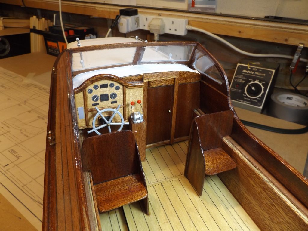

                        Lots of fittings to produce to finish her now so my strategy is work from the bow to the stern, it's working so far 😀

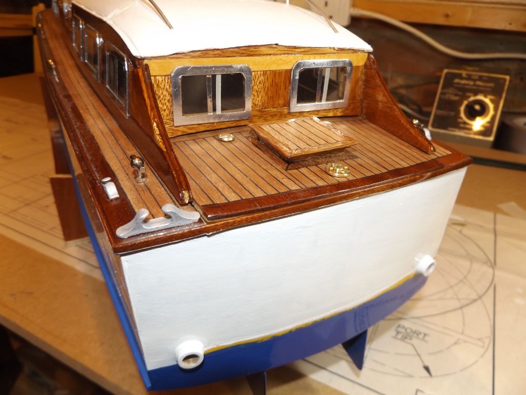

                          wmsternfeb19.jpgHi All
                          The end is in sight (stern) anyway 😀 and the cockpit now needs cushions to complete, happy days I can get on with the cruising cat 🐱 one blue foam build I've been looking forward too.

                          #81288
                            @timrowe83142
                            Hi Ray
                            Love those dinky Morse controls.
                            How are you going to do the cushions. On my Elliot Bay Steamer I threw away the red baise. It had lost its stick anyway and instead I used Solartex ironed onto some soft balsa cushions. Had a nice fine fabric texture and was quick.

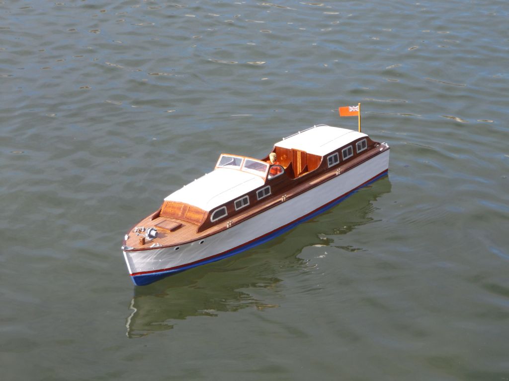

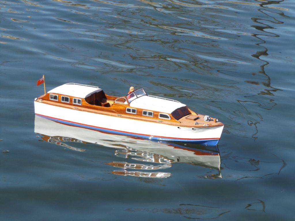

                                wm1.1.jpgHi All,
                                Just a final note on HMS Fervent AKA now White Marlin, she has been tested twice now, and good to report the twin 480's are ample power for a scale planing performance 😊

                                  @timrowe83142
                                  Hi Ray
                                  You found it then!!
                                  Looking great on the water. Is that Bluewater or ordinary green stuff? laugh

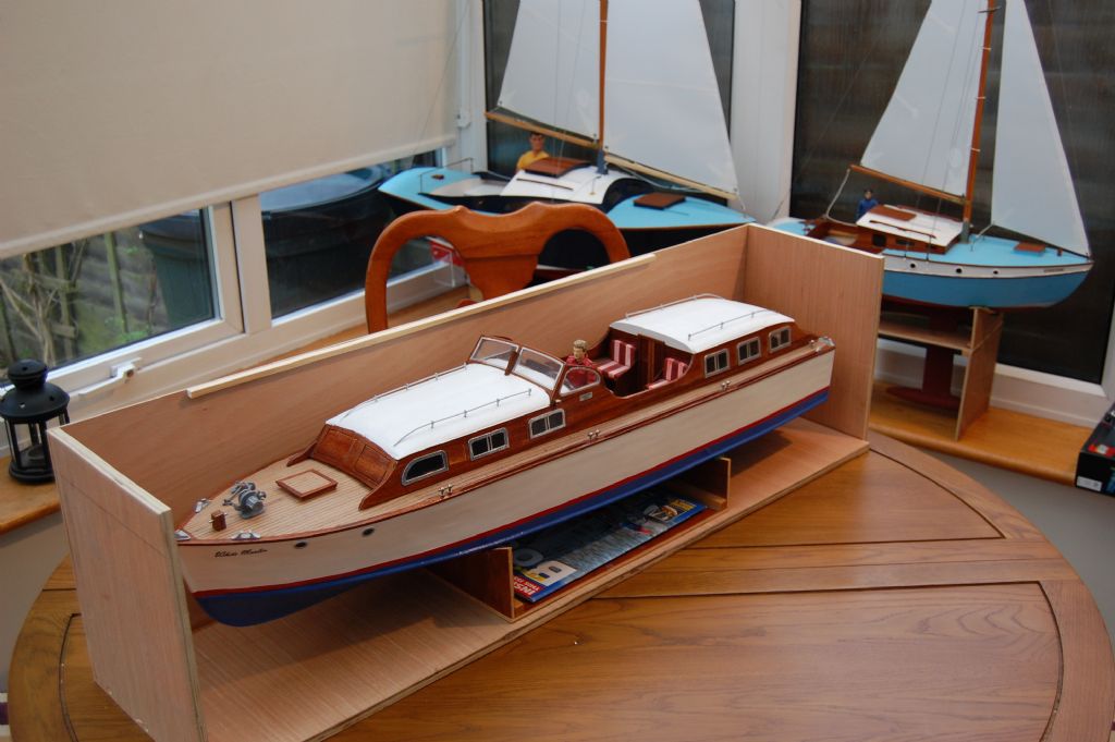

                                                      I thought it would be good to let my model of White Marlin meet the real boat and her owner, and as the Dunkirk Little Ships Association are having a gathering over the coming Coronation weekend at St Catherine's Dock London so It's a great opportunity, It will be an interesting train and underground journey with her in a box
                                                      Before anybody asks she is 37" long X 8" Beam and was a free plan in the December 2019. I know of at least 6 having been built.
