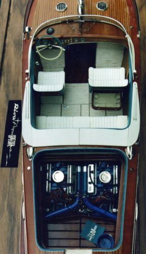

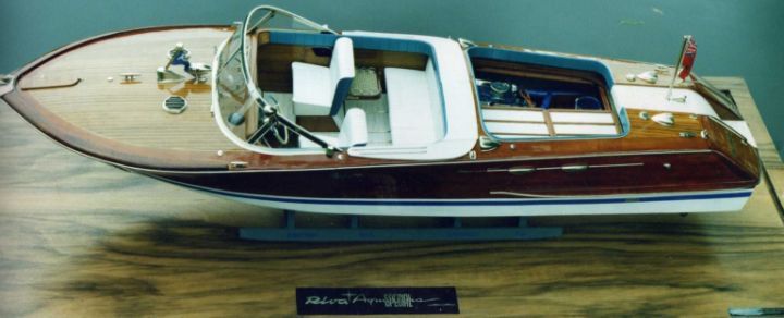

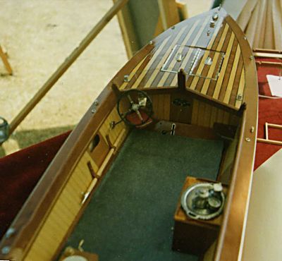

            2 Rivas and a Thames Slipper launch. All chrome fittings are brass or white metal from my brass masters and then polished and bright nickel plated.
            I still think the photos are a faff!

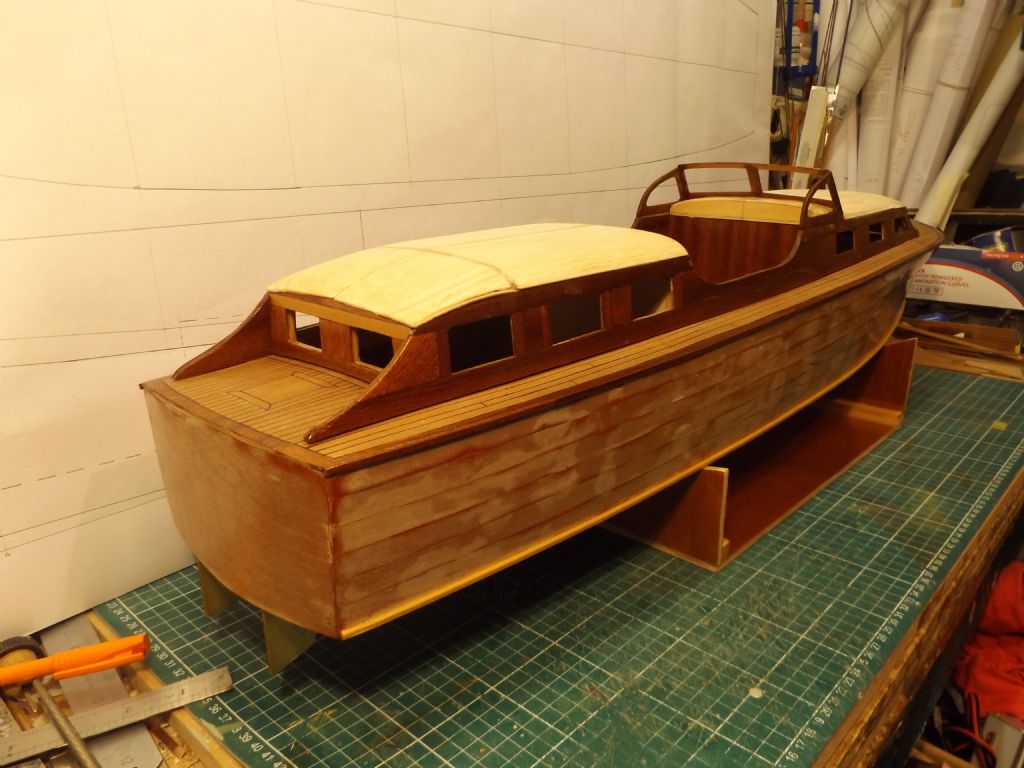

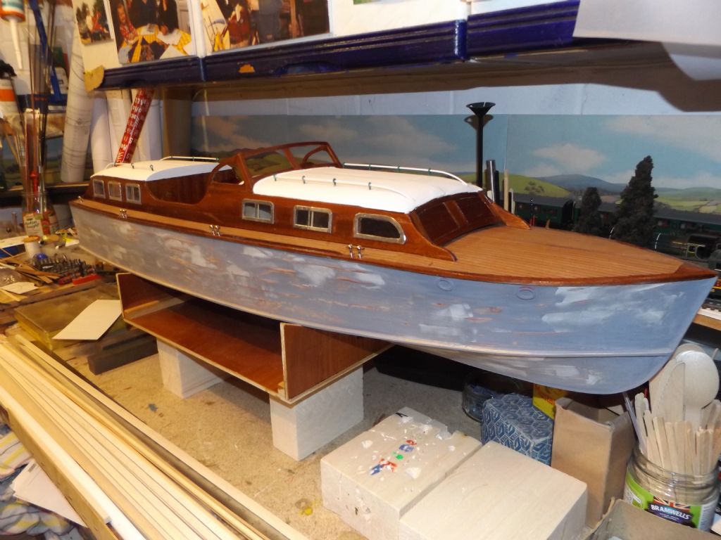

                        wm40.jpgHi All,
                        Well the superstructure is substantially complete and almost fits the deck in places coated the hull with West epoxy and has made her look dark & moody, but should blow over the topsides with grey primer this weekend, then it all down to the cockpit details and deck fittings. She looks long and fast but seems surprisingly heavy time will tell.
                        The bad news is I started building an RC glider in the week I must be regressing?
                        First draft drawing of the 1/24th Giralda  Thames Sailing Barge on the board behind
                        Edited By Ray Wood 2 on 16/11/2018 13:32:23

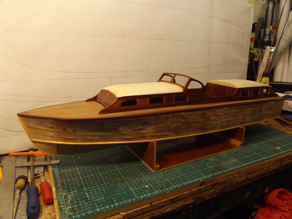

                              wmbow201118.jpgHi Chris,
                              She is wolf in sheep's clothing, original good for 20 knots

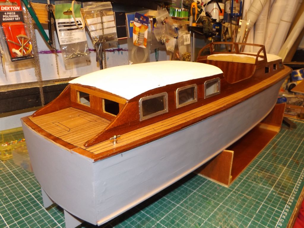

                                          Some progress, I have sprayed the hull with grey primer to show up all the bad joints etc so P38 filler applied and rubbed down, twin exhausts turned from brass on the lathe, the chrome foil covered cardboard window frames look ok and they didn't cost anything just 5 hours to makewm dec 18.jpg. masking again next and white basecoat on the topsides before I mask the waterline and paint with Humbrol enamel (the large tins are becoming hard to get hold of I find ) looking forward to deck fittings and cockpit details the light strip across the back of the cabin is walnut but was too light, but too lazy to change it.

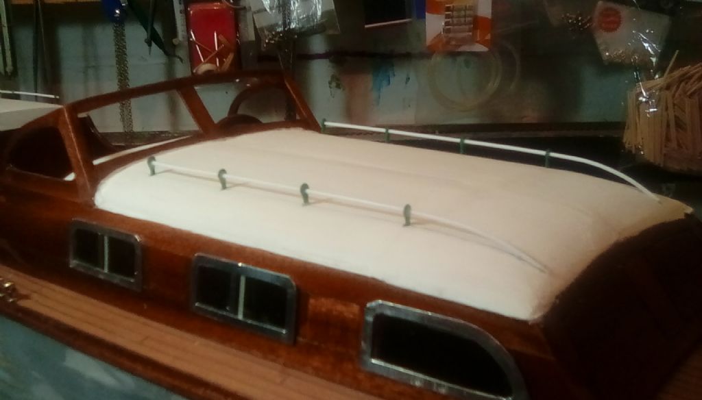

                                                  Happy New year all,
                                                  Rather a break through with the cabin roof grab rails 😊 Starbucks coffee shops are very thoughtfully using green plastic stirring sticks, which when cross drilled 1/16" and trimmed to length look ok with plastic for threaded through, you may have to invest in coffee at £ 2.60 a cup but we'll worth while 😃

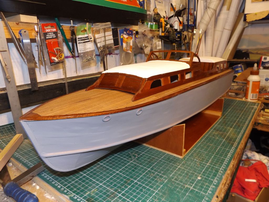

                                                    We are almost ready for the paint shop (AKA the shed) just realized only 2 months before the lake @ Bluewater re -opens, so I'd better get cracking 😁
