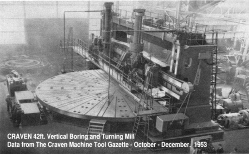

                                              #56879
                                                Hello Captain Bob
                                                In my professional life I had to have a working knowledge of machining equipment and how they work so that I could correctly specify steel components for building.
                                                This is a boring mill.
                                                Kevin needn't worry as this is all in good fun, Bob tries his best to catch me out but always runs aground when his arguments run out of steam.
                                                Edited By Paul T on 30/03/2015 13:53:20
                                                #56882
                                                  a battle of wits from time to time and the score at the moment is 40 all………
                                                  Would that be half each then, Paul? Here is another boring mill……
                                                  (Tee hee).
                                                  #56884
                                                    Ah yes Flat Foot mill
                                                    (Tee Hee, Tee Hee)
                                                    The score is 40+ for me and -40 for Bob
                                                    #56885
                                                      Well done, Paul………This is the size I was referring to………The year I started work!
                                                      It was designed by a German chap……Herr Zadow
                                                      It went to Canada and had a tight build schedule……….Needed to be built before the St Lawrence river froze over!
                                                      My pal Geoff R worked in the same Drawing Office, with 90 draffies!
                                                      Awerome
