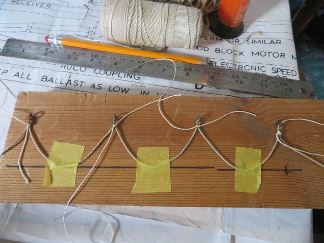

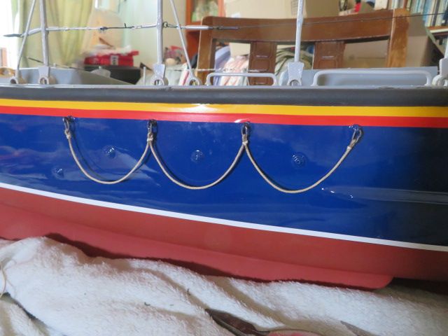

          Apart from the hull grab ropes allong both sides of the boats hull I finished the boat just after lunch this afternoon, completing the deck safety rails without further drama or catastrophe.
          However I will take photos of her in her finished state in a little while, once the grab ropes are finished and added.

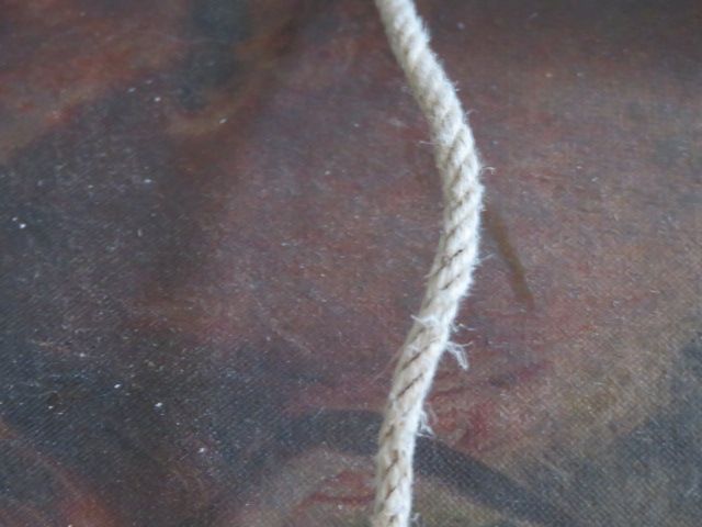

          However, I want to say somethng about the grab ropes and how I fit them so that I don't end up with them twisting, as so many that I have seen in the past tend to do.
          Its a simple thing to avoid.
          If you look at string and rope it is almost always wound in a certain direction…….Anti clockwise, or from left to right with the strands of the wire /rope turning in th rope walk in the holder, in a clockwise direction…….
          And if you were to through some light rope/string in an upward direction it will almost always fall in a heap but most deffinately coiling anti clockwise.
          I KNOW THIS from my youth and when I started working during University days holidays for a company called COSALT, [originally known as the Great Grimsby Coal, Salt, and Tanning Company] on Dock Street, Fleetwood.
          They supplied the town's fishing trawlers with everything from egg timers to hundreds of fathoms of steel ropes for the trawl winches and nets.
          As the wires and ropes were wound in one of the outer buildings and then crimped for eyelets and attatching secondary ropes I used to watch them during lunchtimes, watching the guys check each rope fanatically for flaws as they were spun. A snapping steel rope could and had been known to take a mans arm, head or even body from legs under the srtain of hauling tons of fish or getting snarled up on the sea bed……and I learned a lot from those guys who made the trawl wires and found it incredibly interesting to listen to these old timers who's life was spent in that industry.And it was then that they told me just how to load, 20, 40 or even up to 100 fathoms of wire onto a ship standing by the dock side easily and quickly.
          Tied into coils like an inert slinky spring, and normally with the smaller coils of 20 or 40 fathoms [always measured in fathoms] we would park 10 feet or so from the dock side and cut the rope from the bundle and then lift a couple of coils from the top of the coil and we would flip it onto the dock side, and each coil would just follow like a big slinky spring…..repeating the process then from dock side to trawler………..and there it would remain on the deck until wound correctly on to the trawl winch, with no tristing or snarling by the feed runners once the trawler had put to sea.
          I was given one day the job of taking two "wires/bridles" down to a dock side Icelandic trawler due for sailing later that night. And thje process went perfectly as described as the "slinky spring" had been flipped twice….so as to be able to be wound correctly………we were told NEVER to turn the warp from lorry to trawler deck in one go as the warp would be "twisted" and put unders strain when being wound onto the winch…..
          AND I TELL THIS STORY because it is exactly the same when winding string onto a model……….
          START frm the right of the boat and work left, and you won't get any twisting in your ropes, i.e. port side….fit from the stern to bow, and from starboard side……..from bow to stern.
          Follow this tip and you wont get twists in our grab line coils.
          And so I made a jig to get all my loops the same length, taped the apex of the loop to a wooden board to the correct depth, and with the anchoring points corresponding with those on the boat tied to loops i had glued into the wooden board……and a dab of superglue in the tie at the loop to hold, until set……..

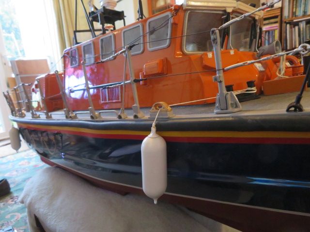

          #97717

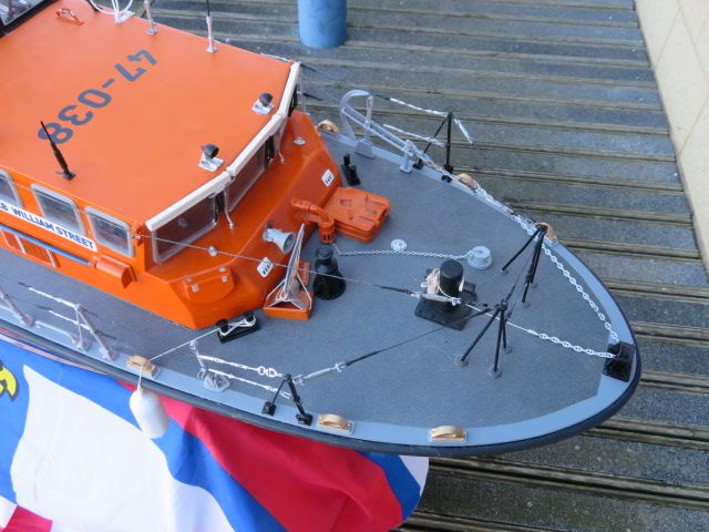

            and now, even those have now been fitted port and starboard .
            #97720
              They look so much more realistic when they sit nice and flat against the hull and hang perfectly evenly.

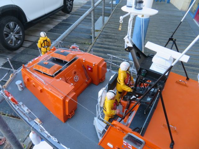

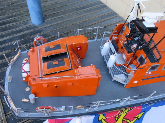

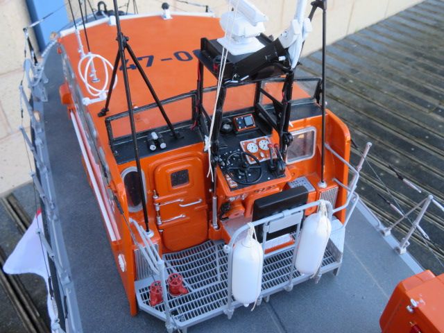

                    #97830
                      Mike Davies has produced and posted all my decals for the model Tyne, and they look superb as usual and should be with me tomorrow or monday.

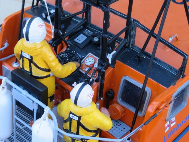

                      This is excellent as within the last few minutes I have finished adding all the detailed fittings that were small items that probably wouldn't have been missed by anyone but myself, but I would have known. The Flying Bridge binnoculas, the 4 protective buffers,EPIRBS for the two liferingsand the lifelines from aft cabin to front pulpit stanchions.
                      The only thing I haven't fitted, which will be if I ever get it in the water are 6 x 12v LED's for the cabin deck lights and the cabin top spot lites.
                      Not included in the set from Dave are the bow and stern depth markers but this caused no problems as I just dug out my black and white BECC stick on lettering, AND letter by letter and line by line I fabricated these in accordance with photos of 47-038.
                      I am going to publish a full set of the photos of the boat, once they have been put onto the boat [as I still have to find the RNLI house flags for the hull and cabin, but I'll just put one photo on tonight.
                      Safe to say every thing has now been fitted,permanently even the rear flying bridge grating to the cabin so it can be lifted off as one piece, and this was attached in different glues [2 part epoxy and superglue in different areas] and I am quite satisfied with the old girl.
                      Pitty it wasn't finished a year ago is all I can say! BUT hopefully I'll have some fun with it on Windermere, and I can clear my workshop ready for bulding my Liverpool class lifeboat that David Metcalf sent me just before Christmas 2020.
                      Hopefully I will be able to get on with that beauty uninterupted and have ready as a back up boat for the Tyne next June for the Windermere charity sail.
                      Roll on 2022!!!

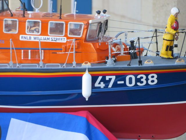

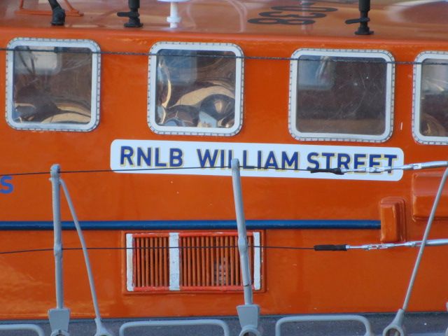

                            I received my lettering for my Tyne from Mike Davies this morning so shall put it all on this evening,
                            and then hopefully if the weather is good tomorrow am going to take it for a photo shoot to a special place in my heart.
                            #97879
                              so no longer is she a nameless or numberless virgin………..she has a personna
                              #97883

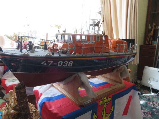

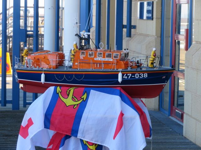

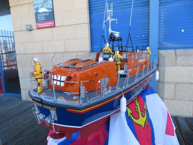

                                Another chapter over! Was worth waiting an extra year for.
                                Its always nice to see your labours come to fruition and finish a model of an historic lifeboat, and one you have sailed on and steered in both daylight and the dark by lit buoys.

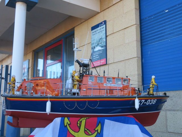

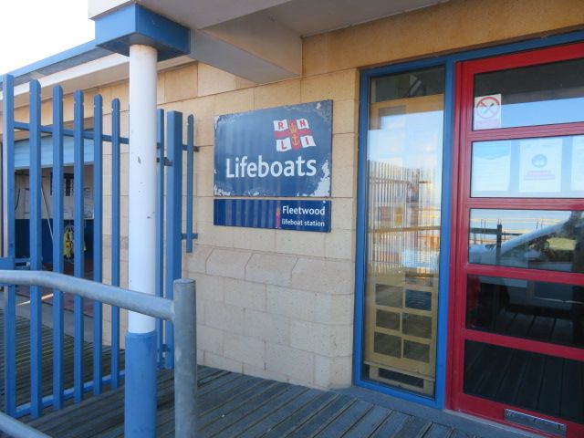

                                She returned to her ancestral home this morning, Fleetwood RNLI Lifeboat station, where she as the real boat spent all of her working life, the first 8 years of her life at Fleetwood under the "custodianship" of her first coxs'n, my friend Iain Fairclough to have her pictures taken as a finished model.
                                It's a model I always wanted to build, and am truly glad I have done so!
                                I just hope she shows her capabilities on Windermere next summer.
                                I hope you like the photos of her.
                                My next build will be the Liverpool class lifeboat, a full kit which is sold by Metcalf Models, and one I designed for him 17 years ago.
