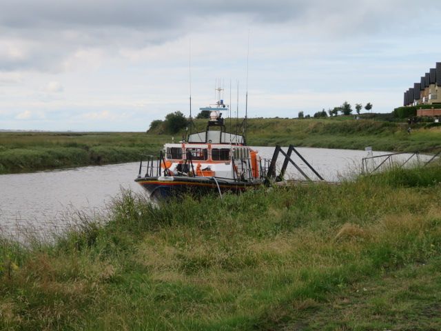

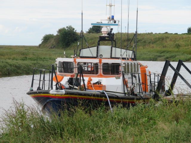

                      i went down to find the boat which was for over two years on hard standing at Glasson Dock, near Lancaster.
                      i needed a last few detail shots of the top side of the boat, and so took the trip down to Lytham Creke this morning, and got them after finding the boat tied up behind an industrial estate.
                      now its just onwards and upwards towards finishing her as a model.

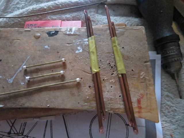

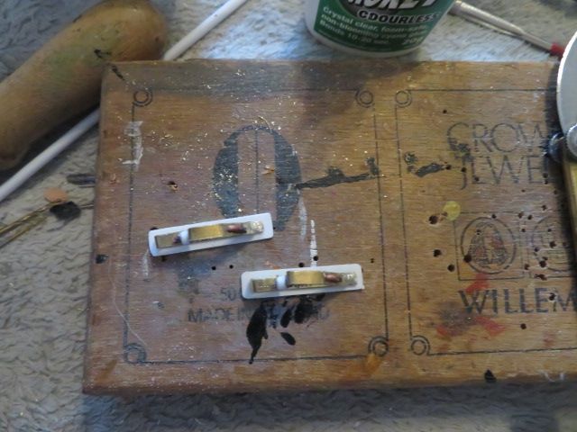

                        all parts shown are either made from brass wire and plasticard, or wire and brass sheet which either needed to be silver soldered together or "bolted" to other parts that are attached to silver soldered parts.
                        all will become clearer after i have got my soldering torch out tomorrow morning.
                        #97578

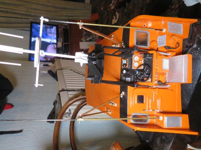

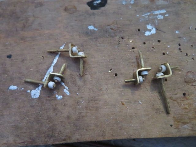

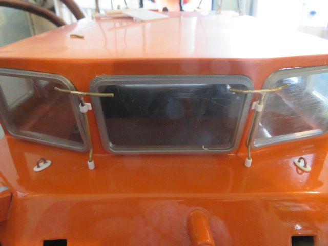

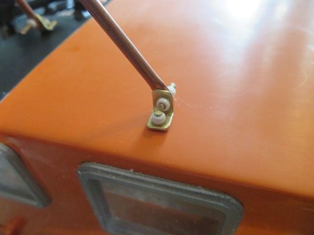

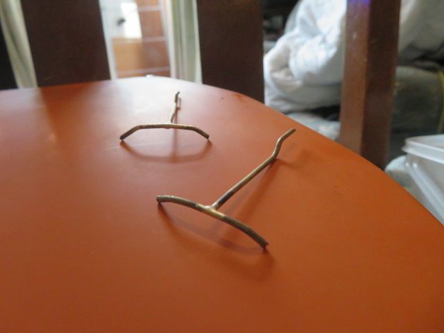

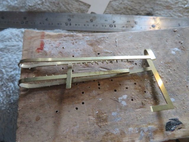

                          So!, yesterday I showed little bits and pieces made from parts of brass and plasticard tubing.
                          Well, the brass wire and plasticard tubing……dummy brass nuts/bolts.
                          The odd shaped brass sheet made into an obscure shape on the cabin top…….the resting brackets for the folding side screens. These have to be finished by drilling and fittng a small rod imitaing a screw tensioner.
                          The bent bits of wire….front wind screen washer pipes!
                          "L" shaped brackets, …..anchoring points for the legs of the main whip areals [made from carbon fibre broken fishing rod sips]
                          The copper tubing with flattened ends the main whip areal stays with the small brass rectangles and tubes as guides for the whip areals.
                          In all there were [not including the carbon fibre areals or the two bases I still have to make for the areals] 19 individual parts to make up EACH areal support!……who says we don't spend time on our boats, lol

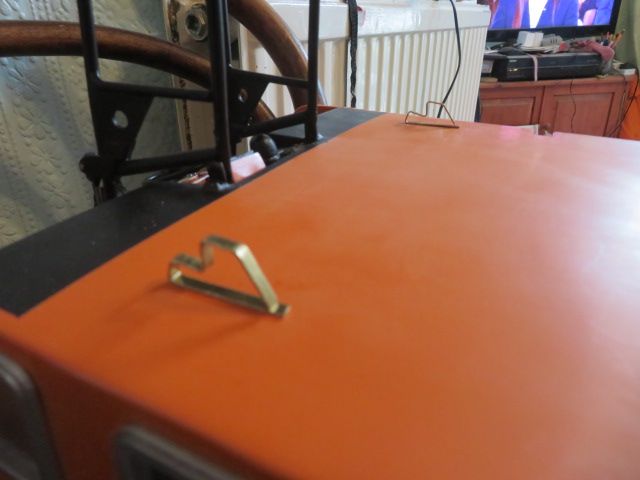

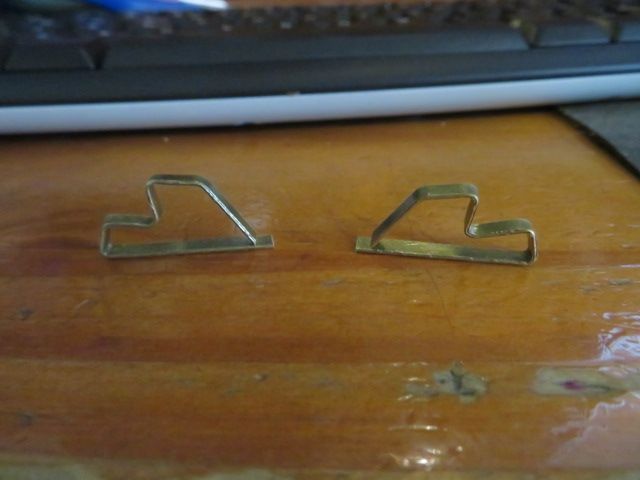

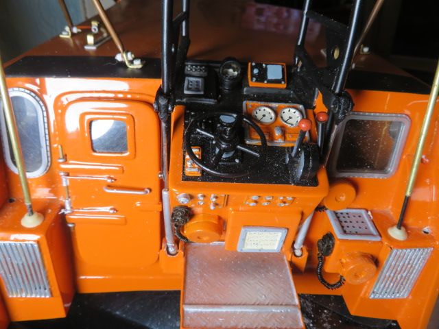

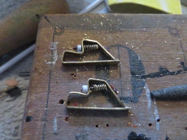

                            Bases on, and spring tensioners fitter with springs inserted…..those are the screen rests done.
                            a little bit more to paint
                            #97582

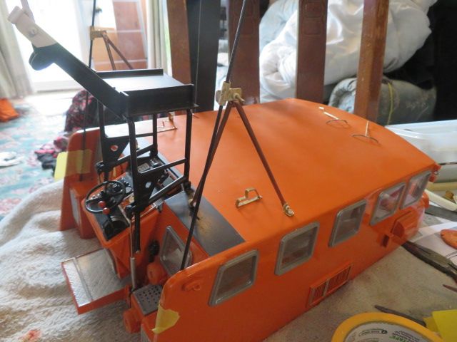

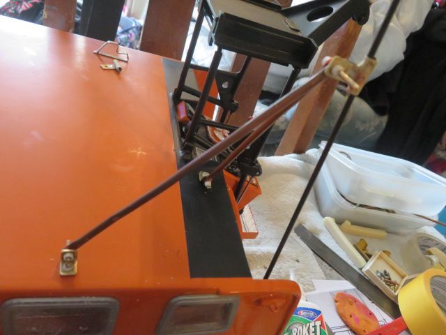

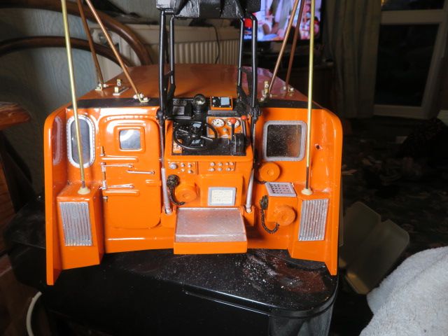

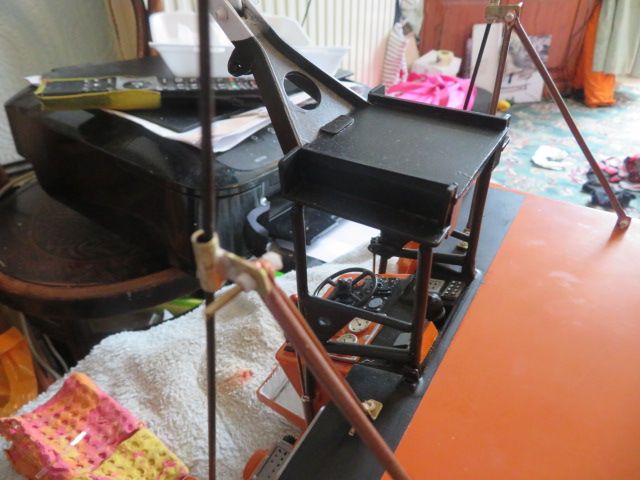

                              The main whip areals tp fit into the support frames I made and put together where then fabricated from carbon fibre fishing rod ends plus brass tubing, and two bases that I modified from a couple of fittings I had handy.
                              I glued each areal into the tube bracket to set its height in pisition, and once set will paint them the black bases and white top halves.
                              and that's it for tonight…….a slurp of ozzie red beckons

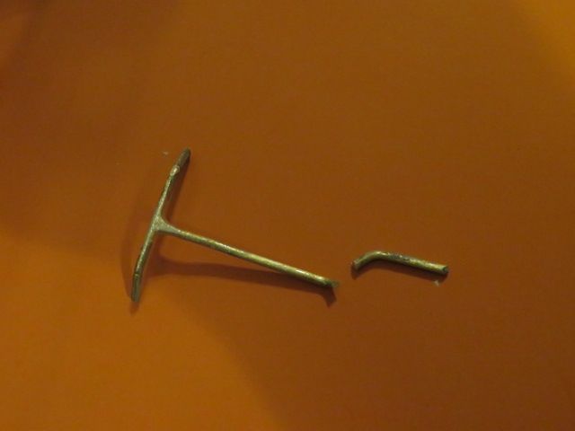

                                    sometimes its 2 steps forward, and 1 back, but in my case, 1 step forward and 2 back when fabricating fittings.
                                    last night was just such a case…….i had soldered up the windscreen washer pipes and was doing some minor adjustments to the height of them with some pliers when the end of one [the last one to be adjusted] broke off……couldn't be bothered to go out again into the workshop as it was 11.30pm by that time!.
                                    And so this lunchtime, i went out, swetted off the broken down piece and soldered on a new piece of brass wire.
                                    Now both adjusted and fitted with plastic tube brackets, they are ready for painting.

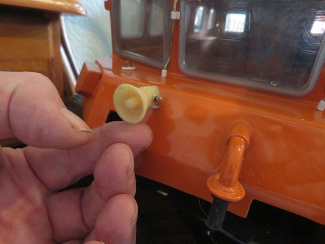

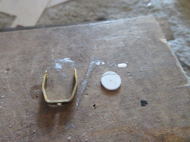

                                      I had to make the suport bracket for the front loud hailer, which attaches to the front of the cabin.
                                      the bracket was drilled abd formed to a U shape, plastic base cut from 1mm plasticard, and all held together using 1mm framing pins.
                                      another painting job, but looking the part.

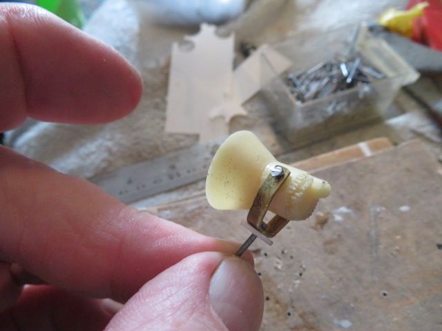

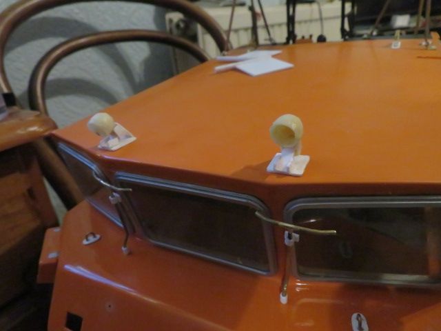

                                        and on the point of everyday household things, its great what you can do with the cut off end to a sharpy pen…..
                                        so here are two cabin top lamps i made from such a pen that i moulded in rubber.
                                        the rest is made from plasticard.
                                        the plasticard on the lamps need cleaning up and sanded smooth once the plastiweld has set……probably in an hour or so.

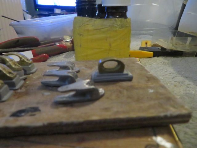

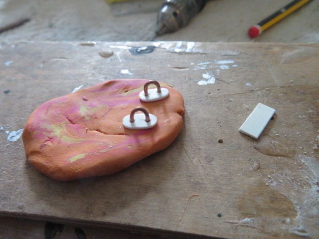

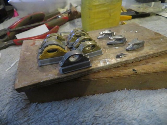

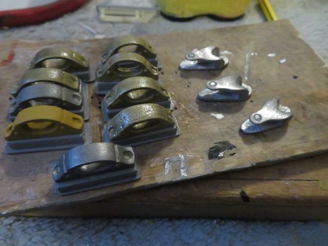

                                          And last, but by no means least, for tonight I readied the spring lock fairleads, the two stern open fairleads plus the stern Gobeye fairlead for painting brass colour.
                                          some of the possible "rivet counters" might say i gave got it wrong by fitting 8 spring lock fairleads to the RNLB William Street, but she was actually unique within the fleet of Tyne lifeboats, and this was down to Fleetwood's coxs'n who oversaw the building of her at FBM Marine, Cowes at every stage of her build.
                                          most Tynes only had 6 spring lock fairleads spaced around her deck for mooring as most were either slip launched or tied up in a safe harbour. However the Fleetwood boat was tied up in a pen, built on the river Wyre and subjected to one of the fastest flowing rivers in the country, at 7 knotts on a flood or ebb tide, and Ian wanted two extra fairleads plus the stern gobeye to make a nine point mooring set up to make sure she was fast and tight on her rise and fall mooring platform…….
                                          And that is why she has 8 fairleads rather than all the rest which had only 6……the extra on the photos is a spair for if i drop and cant find one, lol.
                                          experience tells me to ready extra.
