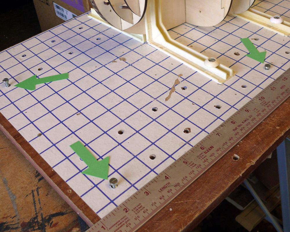

                                This Eureka Moment will only be appreciated by modellers with some engineering background!………So don`t be too disappointed with the idea if yer not!
                                The building board has been supporting the Bandsaw for the last ten years or so!……Needless to say, it sags a bit in the middle!
                                Not good news for an essential dead flat board!
                                Then came one of my finest Moments!
                                See the screws with the arrows?………Yep…….They go right through the building board………So what?
                                SO WHAT!……….They are now LEVELLING SCREWS!……..The engineers answer to precision!
                                The board is now DEAD FLAT!……….Like it?………..I sure do Bob

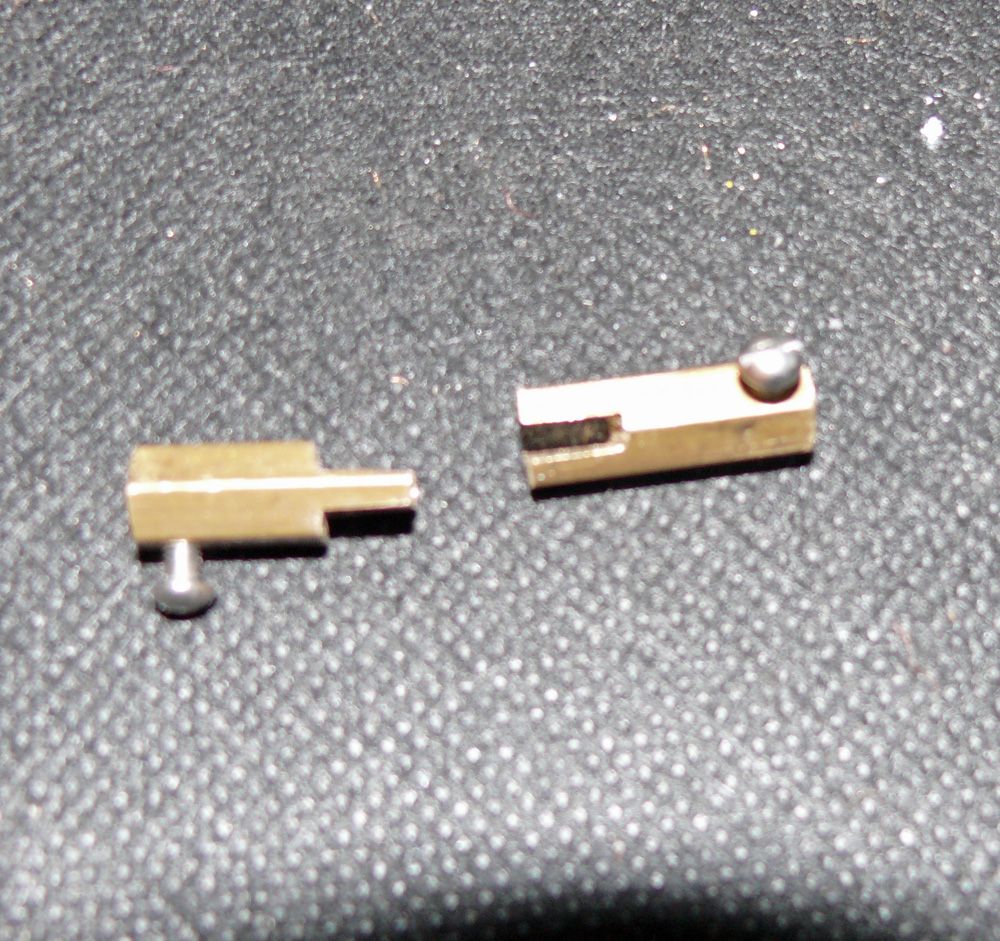

                                                  This is not really a Eureka Moment, but a club member needed a flexible coupling right away!
                                                  There are no local model shops in the area now and mail order was too slow
                                                  So I made him one……Bob

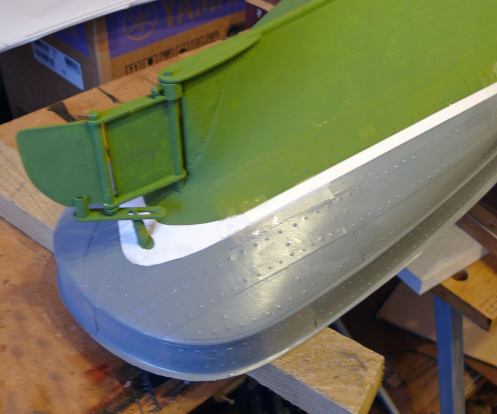

                                                      Applying waterlines is very important on a model boat….when it comes to the discerning eye!
                                                      Using the plastic sticky stuff is ok but it has it`s limitations, ie……The same width from fore to aft
                                                      The stern end is the problem!…….It normally requires "Flaring"
                                                      So I`ve come up with a reasonable solution……..Use paper! ……and with a few coats of clear varnish………Bob`s yer Uncle?
                                                      Here`s my first mock up on Glasgow…..
                                                      Any good?………Well, it`s good enough for me!
