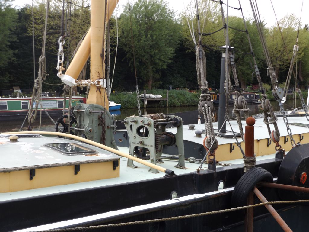

      As my last this is the arrangement on Defiance

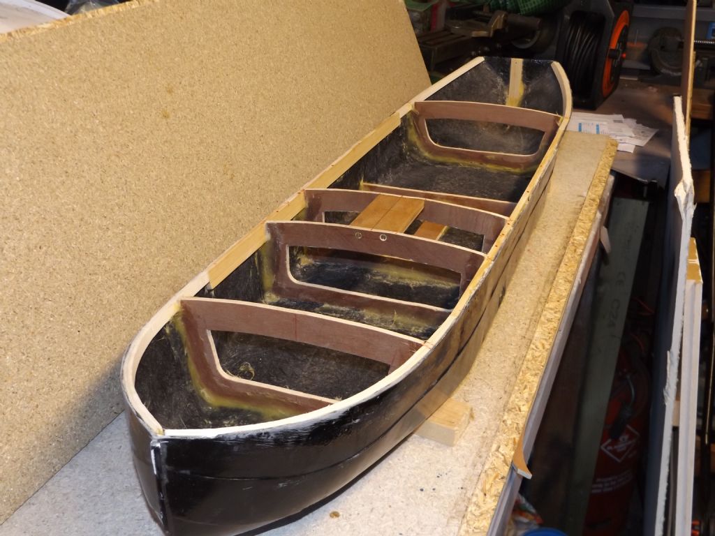

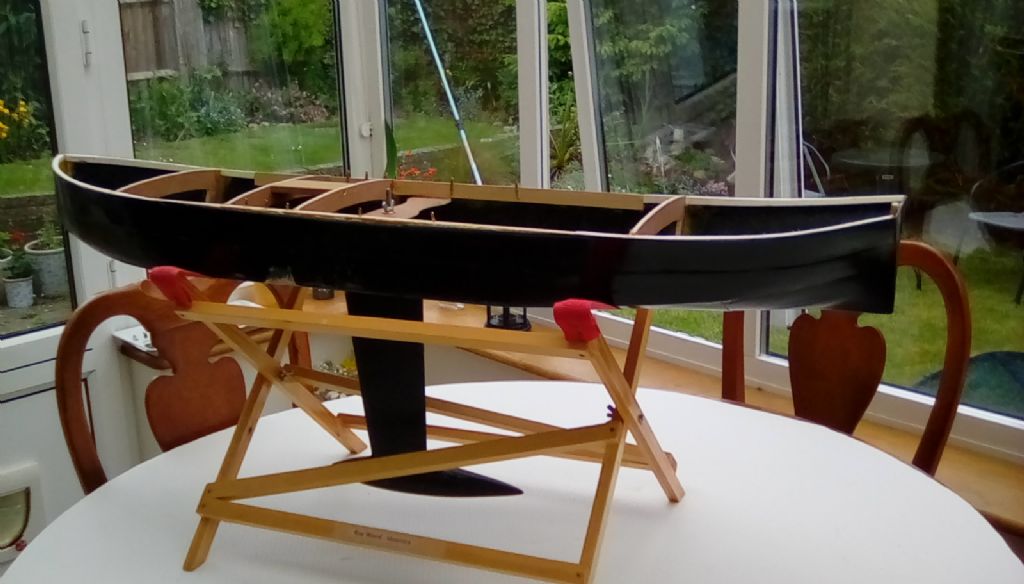

                Well I thought using a moulded hull made by somebody else (thanks Dave Watts) would be cheating but I think it probably takes just as long as building one from scratch !! still here we are with todays progress update.
                Now we have all the bulkheads bonded in place now, so onto the shroud attachment points and the tube for attaching the false keel, we have one gentleman in AMBO from Cornwall who sails with working steel lee boards & no keel, but the barge won't beat to windward very well, but as a purist is doing it properly
                I see on the AMBO facebook page, Dave is working on a 1/24th scale Giralda 42" grp hull, which will be a flyer if it's as good as my 30"version of Giralda, moulding by Peter Fisher from Selsey.

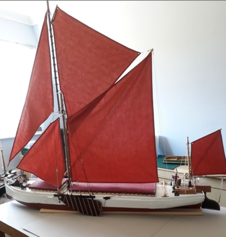

                      #87480
                      Dave Sansom
                        @davesansom26019
                        #87481
                        Dave Sansom
                          @davesansom26019
                          This is Peggy named after my Mum
                          Based on Veronica

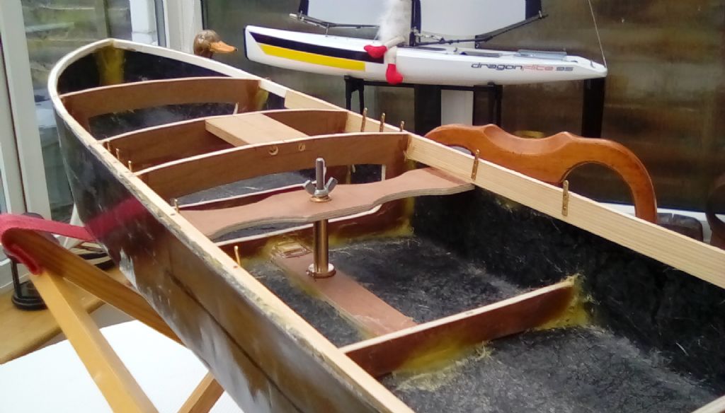

                                img_20200503_123456.jpgHi Guys
                                I'm the little fella on the right, who thought it was shorts weather 😀
                                Chantry/Bluwater is one of my home waters, but the wind down in an o!d quarry has been known to come from all directions !!!
                                Well the keel bolt tube has been turned from brass with Shoulder to sit on the ply strip and the top held by a ply cross member and a washer soldered on top, has a lot of folk use this as a handle to lift the whole barge so it needs to be sturdy, we have borrowed Veronica's stand and fitted the spare keel I have courtesy of Peter Simmonds 👍
                                Good comparison old & new sailing with my Dragon Flite in the background.
                                Dave,
                                BTW Peggy looks great, I hope she isn't too fast !!!😮⛵

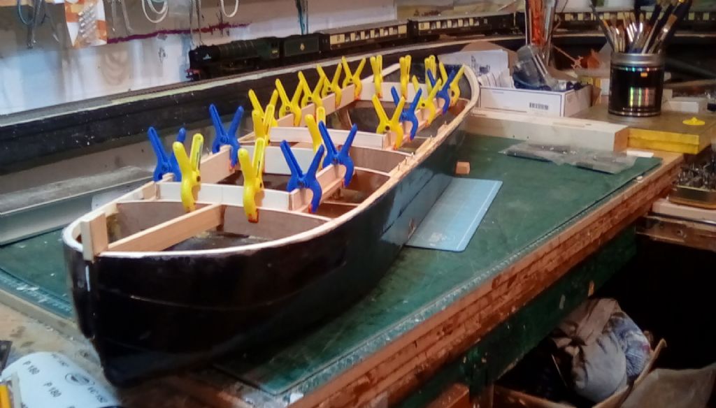

                                      Some progress today with the main and fore hatch frameworks, ready for the deck now 😀
                                      My lovely wife has mentioned decorating 😯 I knew it was to good to last !! Where is the paint 😈

                                        You needed to let the glue dry, free up some of the clamps.
                                        Keep at it.
                                        Tell the good lady B&Q are not open yet LOL 🇬🇧
                                        #87576
                                          I have all my clamps on a hardboard strip pinned to a shelf, so I know where they are. I seem to have hundreds, but whenever I get into the clamping situation, there never seems to be enough!!
                                          Yes, I should buy some more. Its amazing how many you can need looking at that snap.

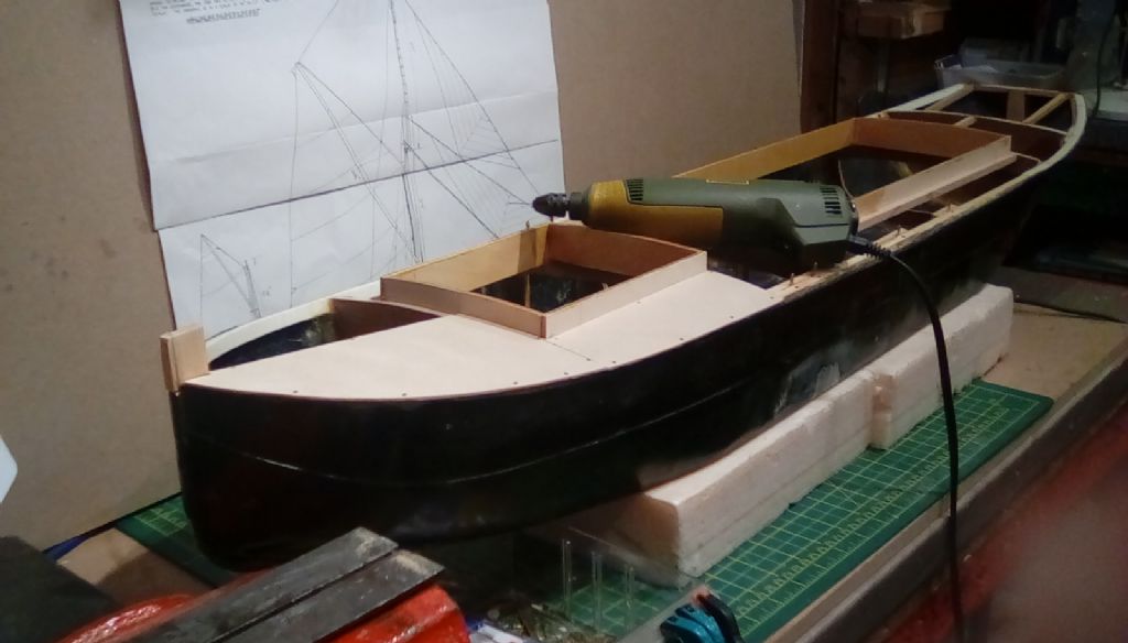

                                                      Portlight is starting to come to life now with the hatch coamings in place and decking started with glue & brass pins, pre-drillng with my Proxxon drill.
                                                      Have a good VE day celebration, we have a Spitfire over Maidstone early this afternoon 😎
