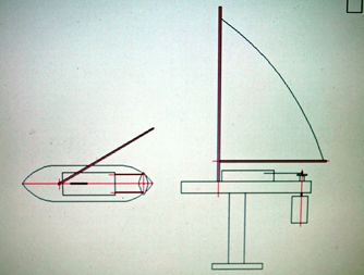

            If you want a simple yacht….why not something new like a ………….PLANK YACHT?
            Have a look at at the "Free flooding" forum and give it some thought?
            I`ll start you off……..Hull 12" long using 1" timber……….keel blade 1 1/2" wide by 1/8" thick by about 8" deep with a piece of lead at the bottom….easy peasy
            Fasten a lidded plastic box on top…with the RC gear inside……..wires out for the rudder.
            Make a simple sail and mast and the job`s a good `un?
            Hope you like the idea?……..I do!
            Cheers…………………….Plankman
            #14283
              I`ve just posted a sketch illustrating my idea……Can anybody post it in this thread?
              Thanks……Bob

                  #14286
                    Hi Bob
                    One easy way
                    Just click on your gallery image, copy and paste into position
                    http://www.modelboats.co.uk/wp-content/uploads/sites/5/images/member_albums/2459/PLANK.jpg
                    #14289
                      Thanks Paul…………………Now why didn`t I think of that?
                      Any interest in the idea?
