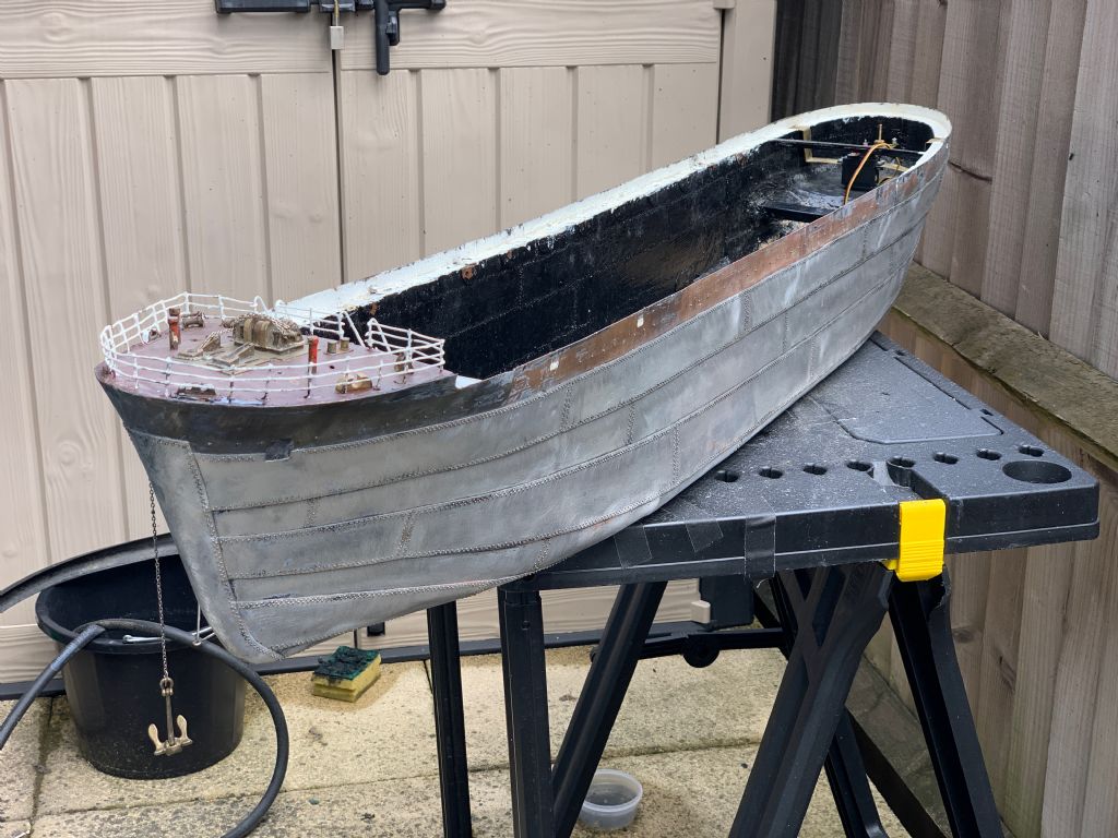

      So I've managed to strip down my metal hulled beast…
      I have also attached a universal joint to the drive shaft and on closer inspection the shaft is dry.
      I have cleaned it and am wondering what oil / grease to use on it?
      All advice gratefully received.
      Michael

          Michael. That’s so cool! What a fantastic hull. I would spray it with red-oxide, then spray the top black..add a boot topping line and leave it at that. The thinnes of the spray should let you see all that detail but provide adequate protection bearing in mind how much time the hull will be actually in the water.

                It seems I have a 4mm rod inside a casing which is well and truly fixed into the hull. The rod is approx 140mm.
                I'll go with a little bit of vaseline and some oil between.
                As to the waterline, I and trying to find out how you calculate the waterline? The motor is definitely below the waterline, but I'm trying to work out where to draw the line for the red paint to go on the hull…???
                Any help gratefully accepted.

                  As for determining the waterline, I think I would start by weighing everything you are planning to put inside the hull – motors, batteries, radio etc.- the lot. Then, plug up all the leaks (Blue-Tack /whatever's to hand) and find some water -.kiddies paddling pool, garden pond, friend with a pool (you should be so lucky !).
                  Initially, I would float it empty, being a steel (?) hull it should sink to a 'natural' level but may be a bit 'wobbly'. Note the waterline and the boat's trim – eg bow low /stern low and any side-to-side list.
                  Now add ballast equivalent to the weight of the planned internal equipment. Move it around until a satisfactory trim is found.
                  You may find the level is higher than you thought acceptable. Come back to us with some photos. I'm sure the experts will be able to say what's safe. Then you can draught out your lines…
