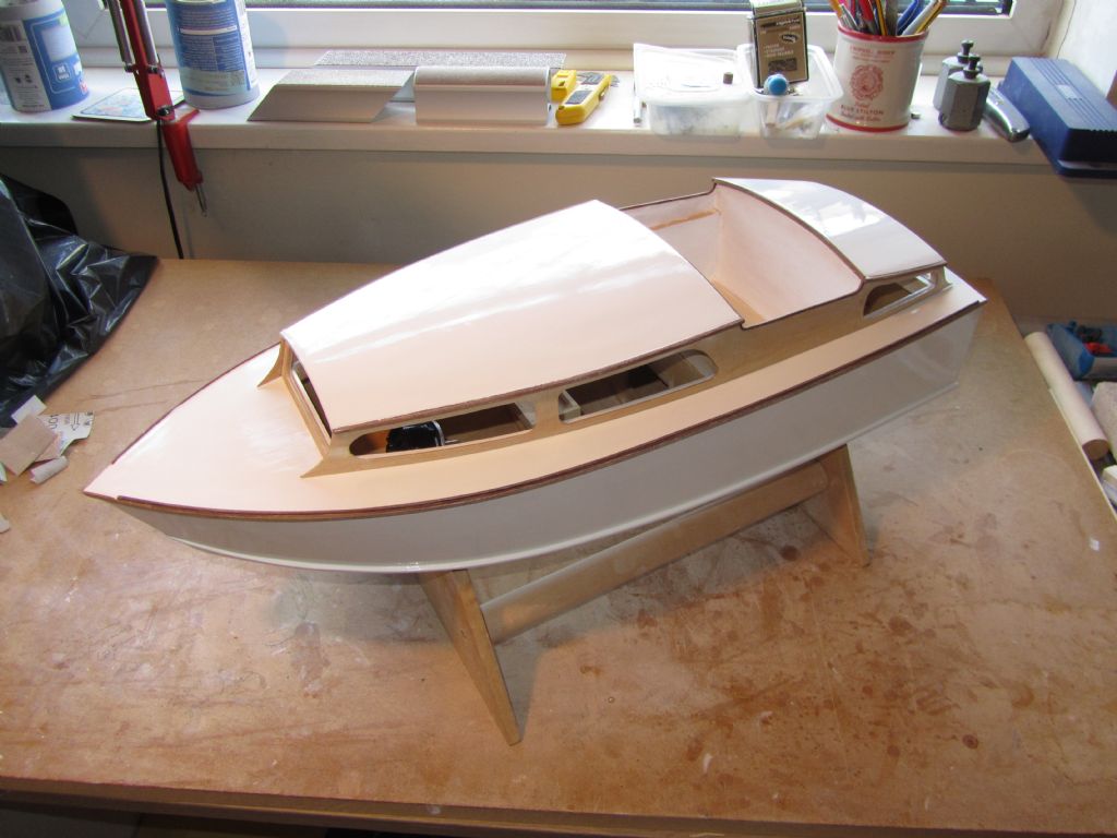

          I stopped painting the three hulls, including this one, coming up to Christmas! Since then I lost my mojo and haven't done much of anything really. Well, only thing of note was replacing the PC as the old one was grinding to a halt and so quite some time was spent in setting the new one up, reinstalling software and transferring stuff over. The opportunity was also taken to do some housekeeping on my many photographs and check that all my backups were in synch.

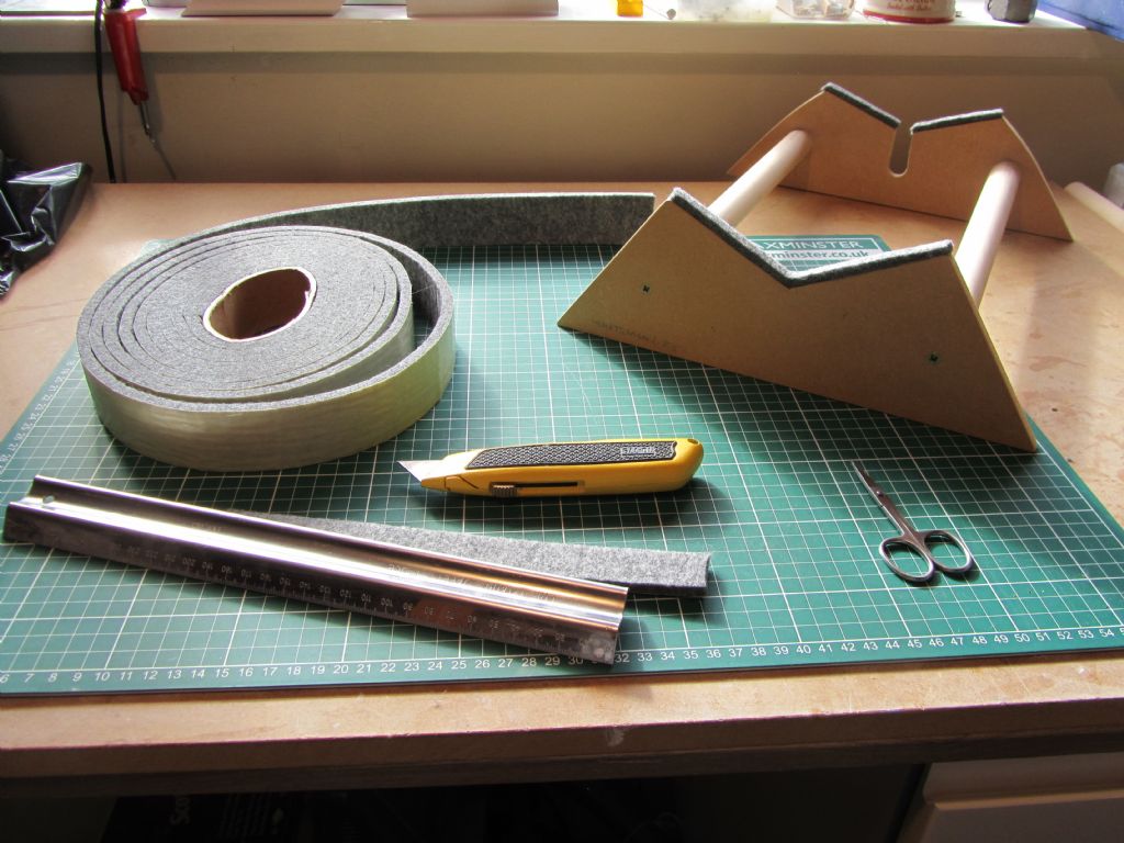

          Anyway. I'd applied another coat to the bottom of this hull when I left off and wasn't completely happy as I'd got a couple of prominent brushstrokes etc. But I've got sufficient coats on so I'm going to leave it there or I'll never progress! If I sand it down and apply another coat I'll probably have another defect! I can't even remember how many coats I put on the Huntress, but that looks pretty good so I'm leaving that one there now as well. This means I can progress with the superstructures and RC installations etc.

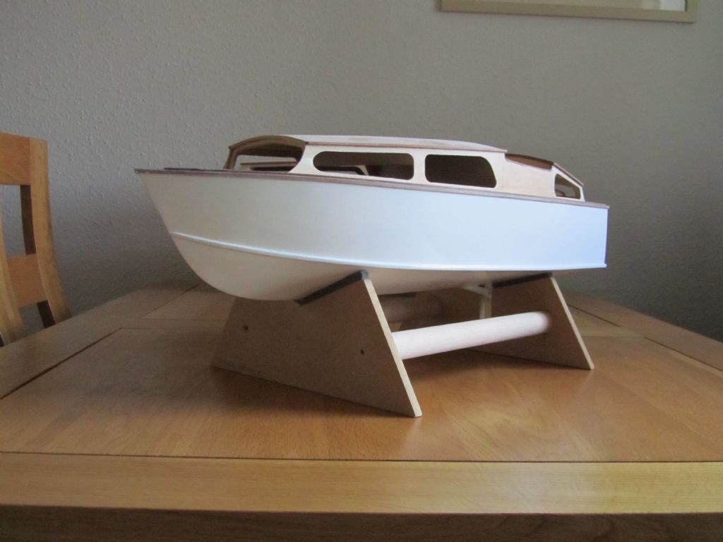

          Some may remember the thread we had where we discussed the cushioning material for our boat stands? After that I bought a roll of self-adhesive grey felt off Ebay. It was more economical to buy a wider roll, so I bought 40mm which is easy to cut down to the width required. So today I made a start on replacing the foam on my 6 stands. 3 done and on with the rest after this.
          Edited By Chris Fellows on 10/03/2023 15:24:03
          #104227
            Good job I've replaced the foam which was only put on a couple of years ago or thereabouts – probably longer!
            The Swordsman is heavy already and had stuck to the foam which has left black marks/deposits on the strakes. Not painted at the moment with the hull being finished with Eze-Kote with Styrene strakes. As I pulled the foam off the stands it was already starting to break-up. The Huntsman 31 was also affected but to a lesser extent.
            When I come paint them I'm going to have to modify the stands to spread the load and maybe have cut-outs for the strakes.

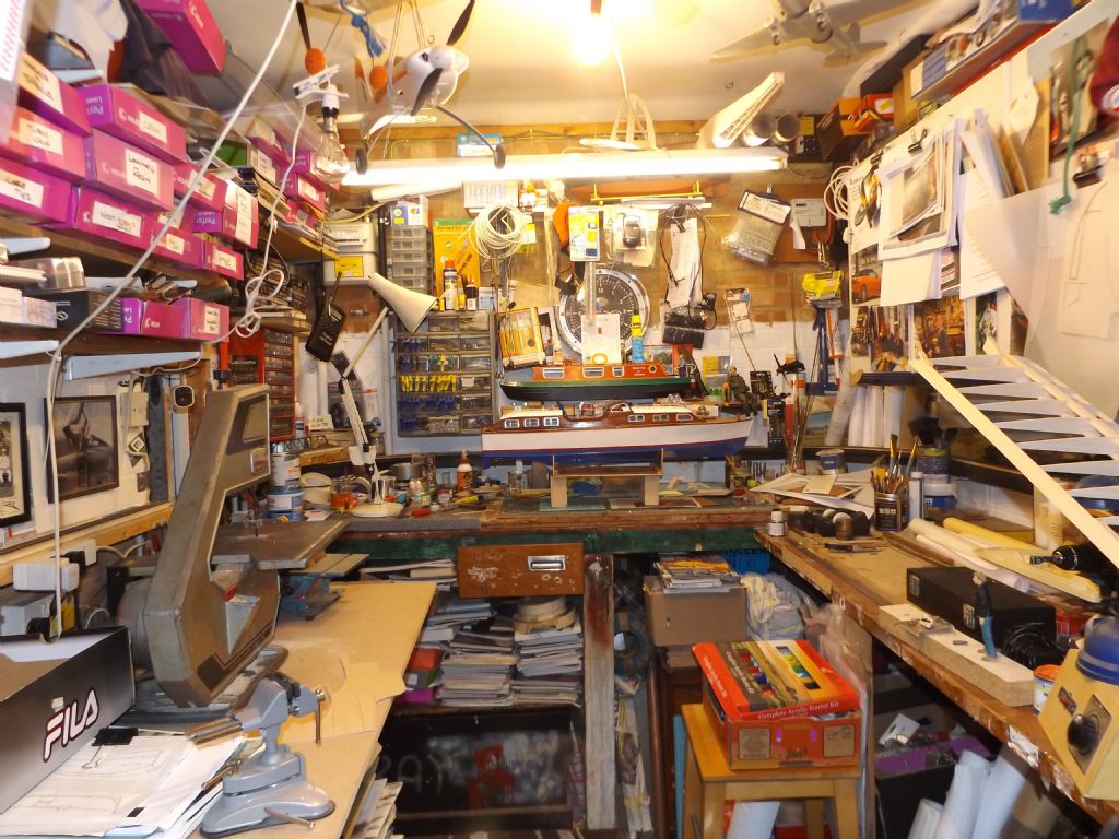

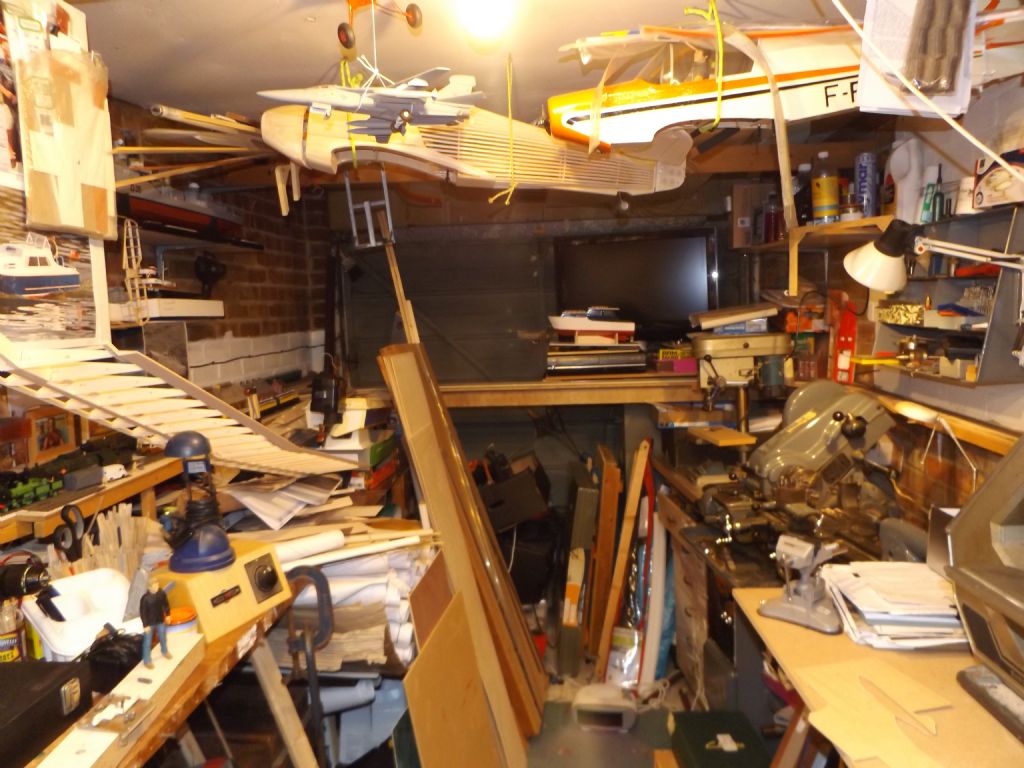

                wkshop1feb19.jpgHi Craig,
                Chris is a perfectionist in the best way possible, and is a seasonal builder with other interests, Multi build projects on the go at any wkshop2feb19.jpgone time I find is the best way to keep interested I probably have 10 projects currently on the go
                3 Boats 4 Aeroplanes 1 model railway 2 steam engines, so in comparison Chris is far from mad

                  Great workshop Ray, a joy to behold!

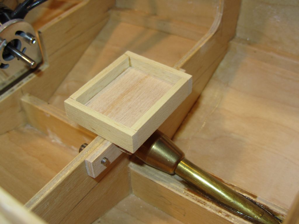

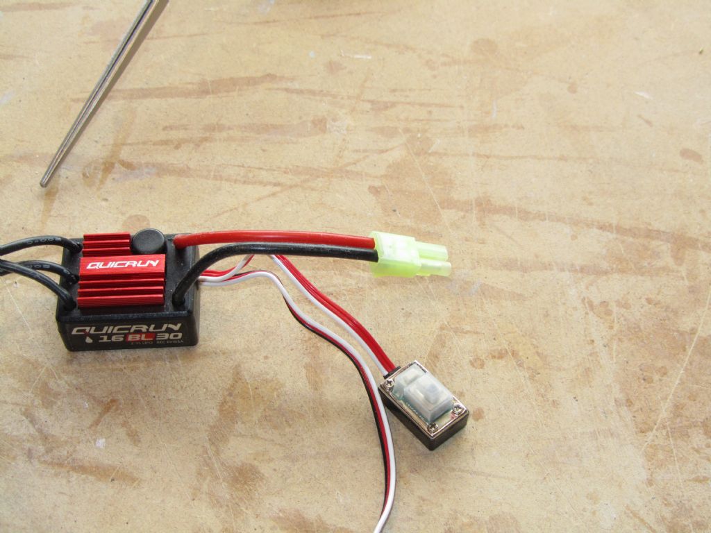

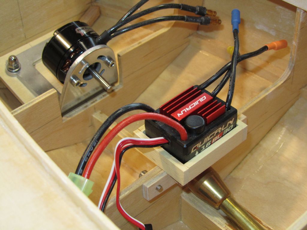

                      Anyway, as with the Huntress, I've made and fitted a shelf for the ESC. Positioning was straightforward in this one being the more usual layout. Again, as access is required, the shelf is bolted in place. Next job is a battery tray.

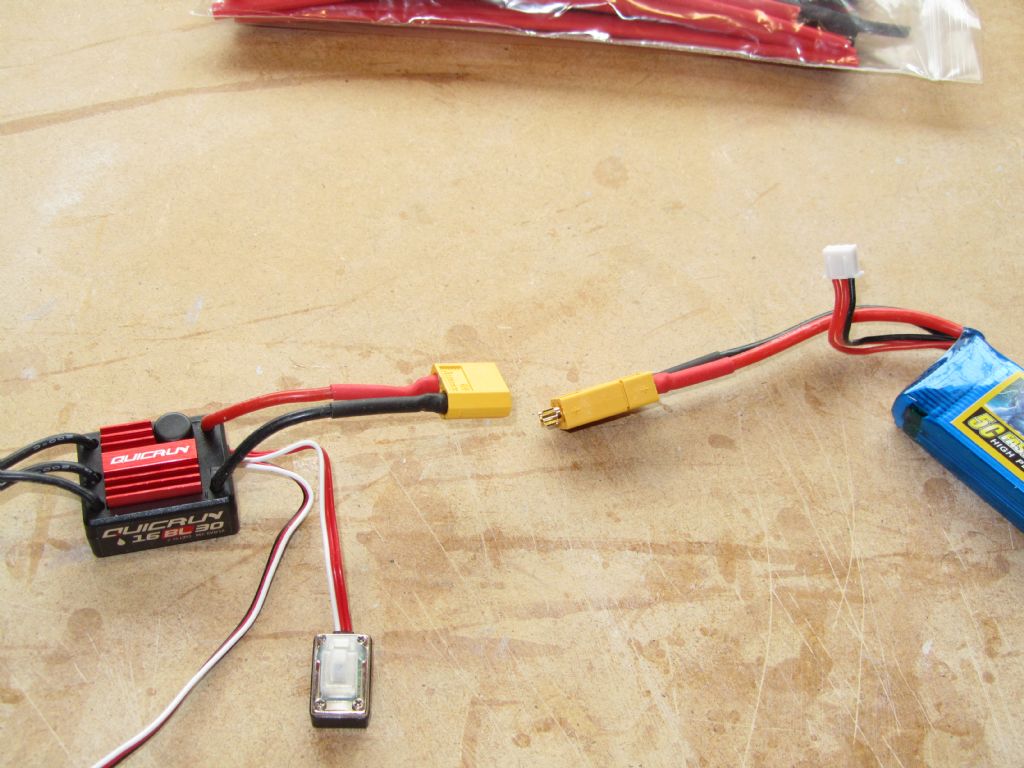

                        Chris, are you still using those horrid wossisname plastic battery couplings???
                        They will melt under the awesome power of your Fairey motor.
                        Deans for me, although the XT60 (or whatever) look good, they are pricey, and for changing over on my 40 odd boats, too expensive.
                        #104571

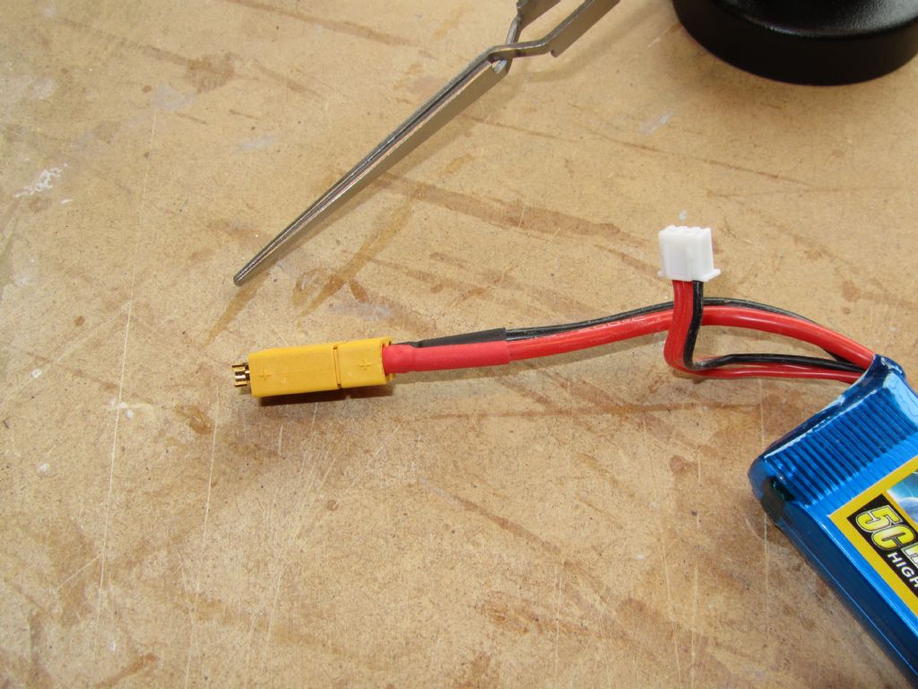

                          Hi Ashley. You spotted it then! laugh The 30amp Quicrun ESC come with those already on whilst the higher amp ones are supplied with bare cables. It will be going – I only use XT60 for my builds with an XT90 for the Swordsman. Most of my RTR raceboats are XT60 or Deans.
                          Funnily enough I have a 2S LiPo which I'm going to use in this model which has the standard size Tamiya connecter currently fitted to it. I can't remember for the life of me what I bought it for!!! Maybe it was for the Club 500 as that is the only boat that has a Tamiya connecter but it doesn't have a LiPo safe ESC.
                          Edited By Chris Fellows on 14/04/2023 23:02:16

                              #104629
                                Soldering iron in action this morning for this one as well.
                                The 2S battery I'm going to use on this had a Tamiya connecter on it which probably would be OK given the small motor and modest performance but I have a few XT60 connecters so changed it.
                                Can't say the same for the Mini-Tamiya connecter that the ESC came fitted with so Ashley will be pleased to see that has gone in the bin!

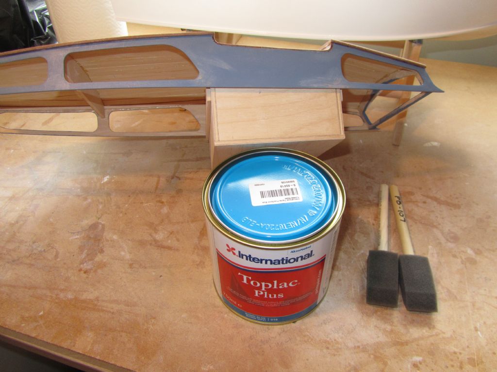

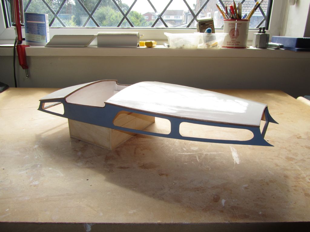

                                  This recent spell of rain has enabled me to progress the painting. The deck and roofs have been primer/undercoated and glossed.
                                  With the deck being done I can finish off the RC installation so that I can try it on the lake.
                                  Also just put a coat of blue primer/undercoat on the cabin/cockpit sides and front and rear windows.

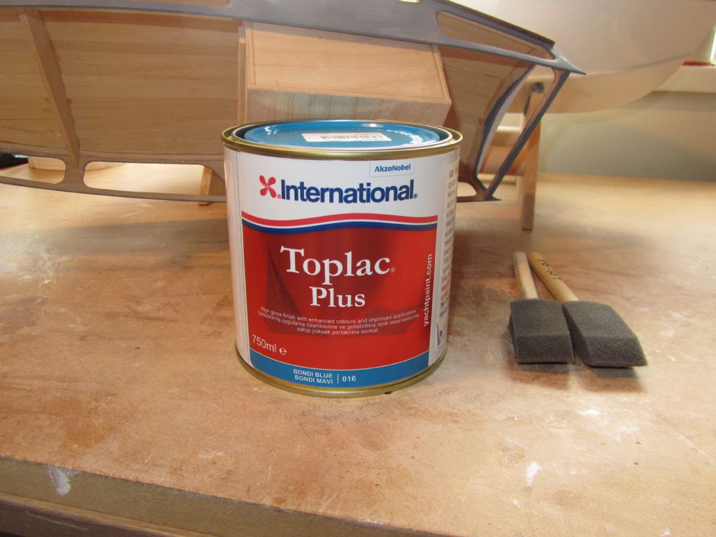

                                            I'm getting low on thinners and so rather than order online again I had a look for a chandler that stocked International Yacht Paint products. Decided on one at Braunston, near Daventry, which is a pleasant one hour drive away. I've driven past it before and the marina is not far from the junction of the Oxford and Grand Union canals.
                                            Whilst the River Cruiser was a prototype and it looked from the B&W photo as though on the cabin sides etc. they'd probably used the same bright blue as on parts of the Swordsman I'd decided on using the dark blue (Sapphire in my case) that Fairey used extensively, as I'd got a 750ml tin and it's expensive stuff.
                                            The chandler had got some of a bright blue that looked about right and after some hesitation, £36 for 750ml inc. the government's cut, I thought what the heck! I can use some on the Swordsman and other builds. Bought a couple of foam "brushes" as well which I will cut down to apply the varnish nice and lightly on my other builds.
