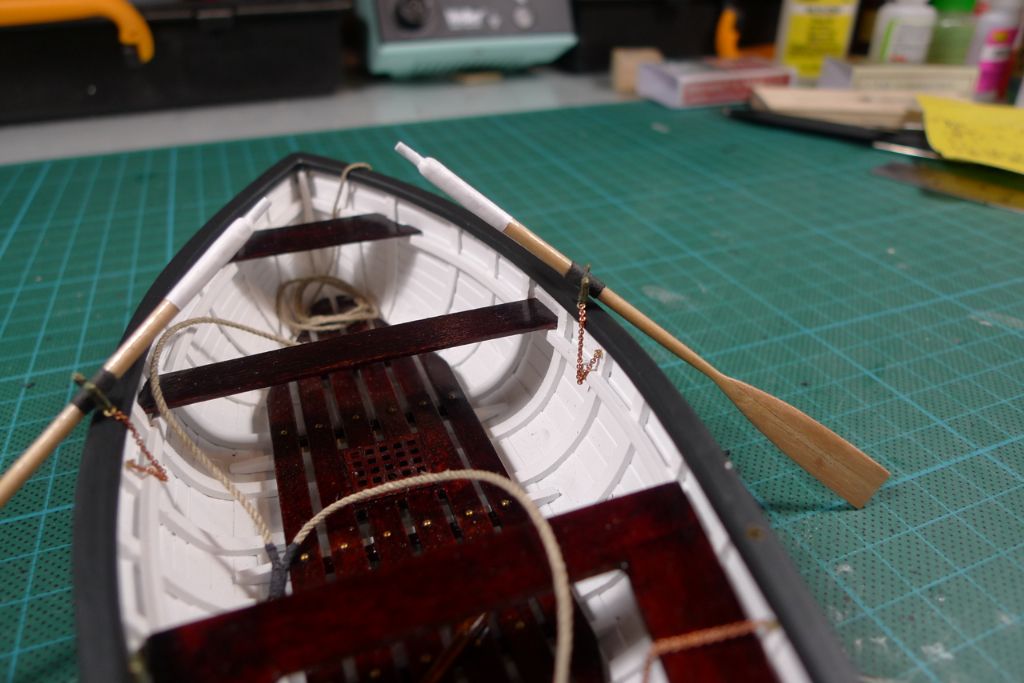

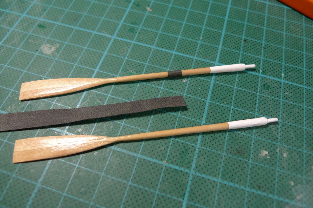

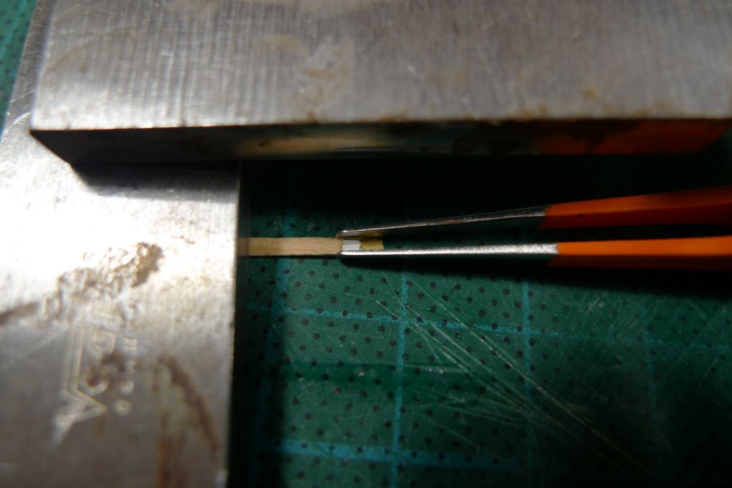

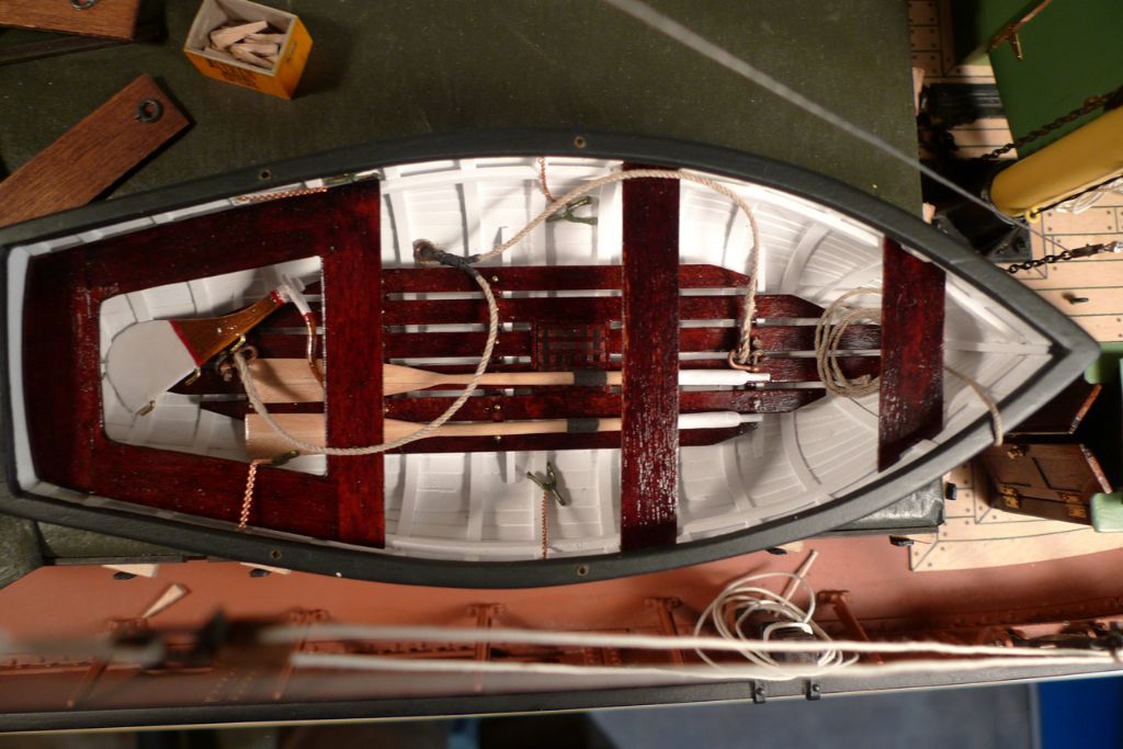

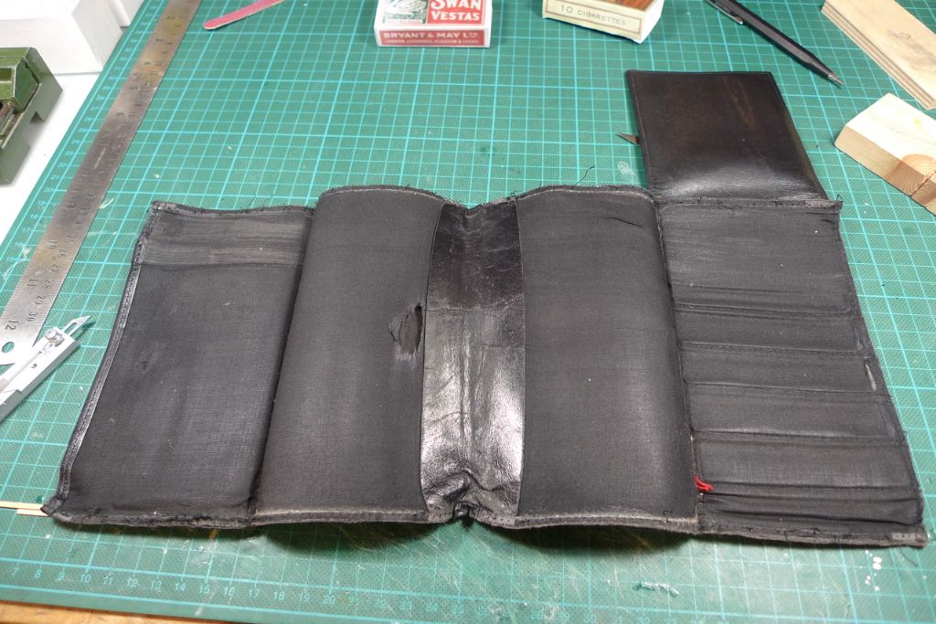

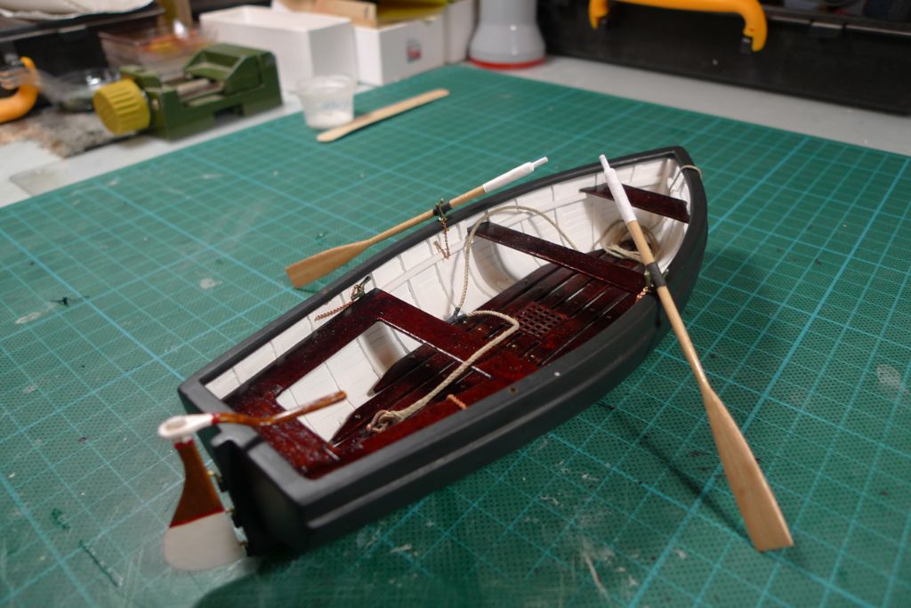

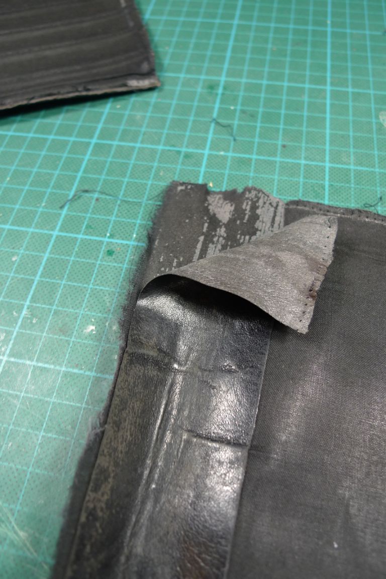

          Any road, to make up the leather facings for the oars, I had first thought about using painted masking tape, but decided to first have a crack at making them out of real leather.
          To this end, and old, worn-out wallet was found in a drawer, and taken apart.
          The middle fold had a nice, thin strip of leather glued in as reinforcement that I pulled away.
          From this, I cut a 6 mm wide strip that I thinned down considerably against a sanding drum set up in the Dremel. I actually sanded both sides of the leather, to remove most  of the, in my eyes, too glossy original finish.
          From the strip, short pieces were cut off and glued round the oar strakes …
          … with the following end-result …
          … when ,ounted in the rowlocks.
          The oars and the rudder will of course be kept stowed in the bottom of the dinghy.
          To be continued …

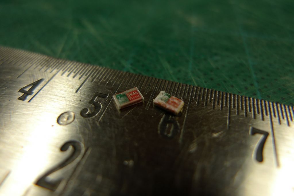

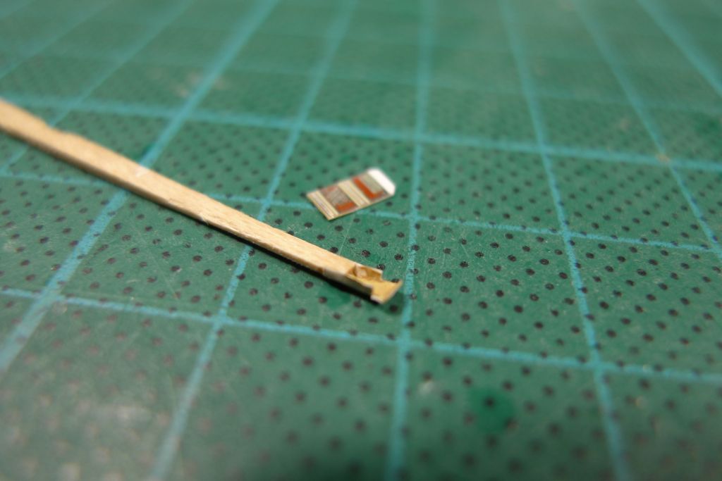

            As mentioned earlier, I was not entirely happy with the print-out quality of the cigarette packet and match box to go on the chart table in the wheelhouse.
            I therefore created a high resolution .jpg in standard 4×6 photo format, with multiple copies of the necessary images, and had it printed as a photo.
            This seriously increased the degree of resolution, so that even at 1:24 one can actually see that the match box on the left says "Swan vestas" (and that the logotype is a swan), whereas the previous attempt was just a green, red and white blob in the general shape of a box of Swan vestas.

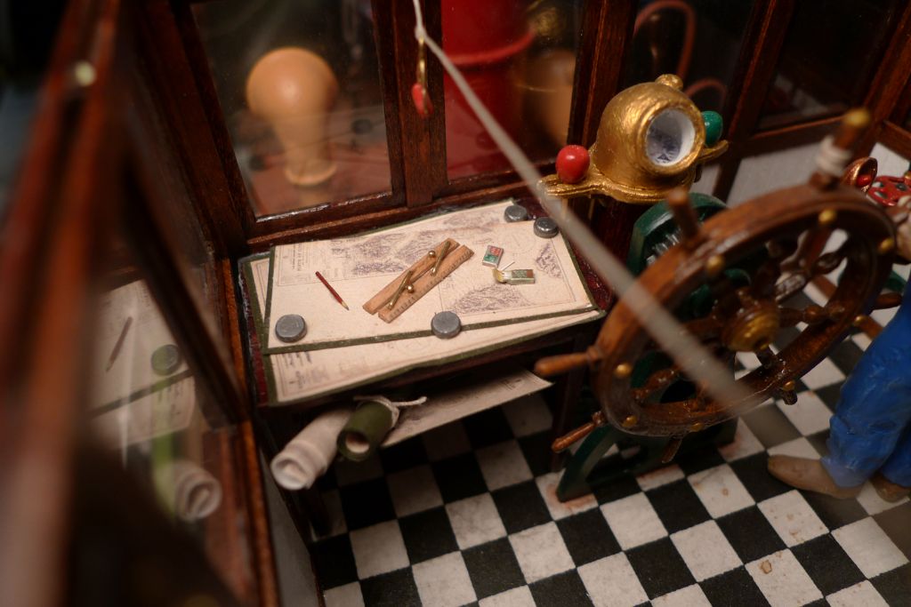

            As for the packet of Woodbines, I decided to try to add a bit more detail. These packets actually consisted of two parts: an outer sleeve and an inner cardboard box with end flaps that held the cigarettes, and which could be slid in and out of the sleeve.
            I thus began by glueing on end of the inner box to a strip of wood, sanded down to the appropriate proportions. The interior of the box was painted buff, as this was more or less the colour of the cardboard used in the real article.

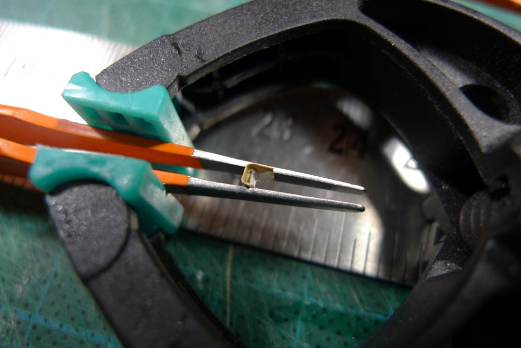

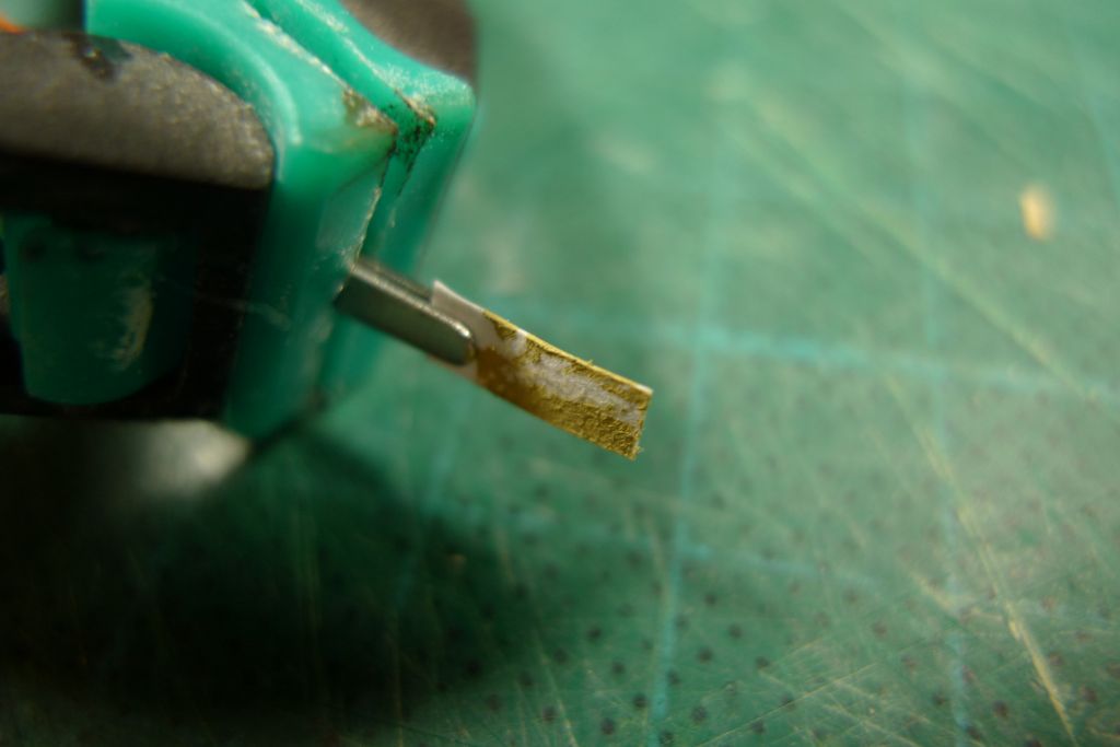

            In the open part of the inner box, I then glued seven 1.5 mm long pieces of 0.2 mm brass wire, painted white.
            To hold the sides of the box in the correct position while the glue set, without crushing the whole thing by appyling too much pressure …
            … I set up a Heath-Robinson-ish thingamjig , with the points of a pair of tweezers applying the pressure, and the pressure set to just the right amount – light but firm – by a weak clamp applied quite a way up the shanks of the tweezers.
            The back lower half of the sleeve blank was the also painted buff, as were the edges of this piece of paper. Bye-the-by, I should perhaps add that the photo paper, which was of course much too thick, was reduced in thickness by having the back support paper peeled off.
            Anyway, the sleeve blank was glued around the inner box, one face at a time …
            … until a half-open packet of Wild Woodbine cigarettes, with seven cigarettes still in it (and one loose on the table) was produced; this, together with the match box, was then glued doen on the chart table, like so …
            … and (in daylight) so.

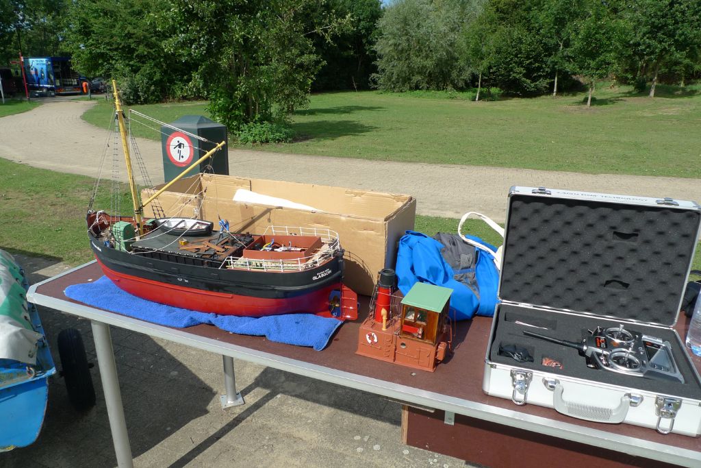

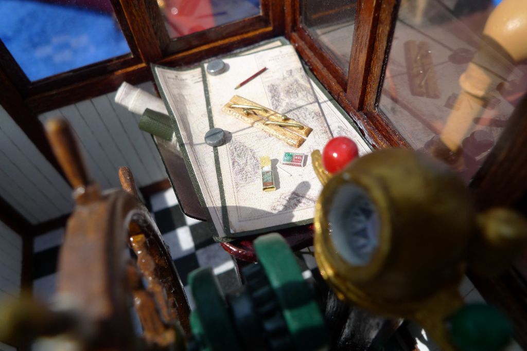

              Well, with the addition of those final two minor details – the cigarettes and matches – I consider this build to be officially finished!
              I dare say I may yet add summat here, tweak summat there or otherwise do the odd odd job on 'er, but as one has to draw the line somewhere, well, here is were I draw mine on this project.
              Dave Milbourn asked the other day what I would do when I was finished, and after the final glue joint had set at 9.15 this morning, I looked out the window, found the sun shing and decided to take 'er to the water!

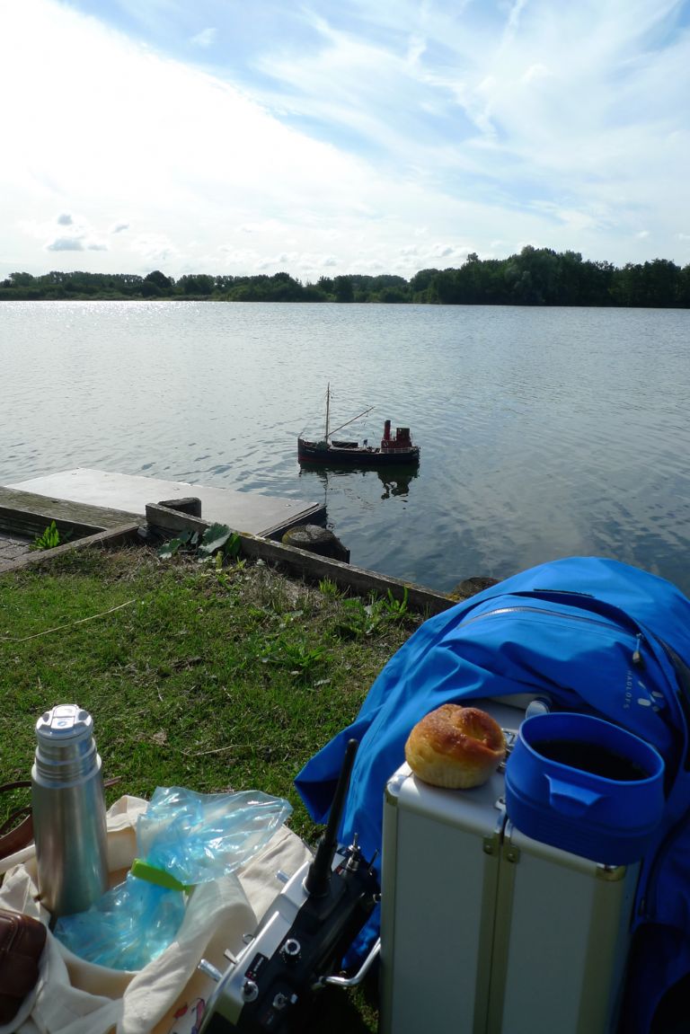

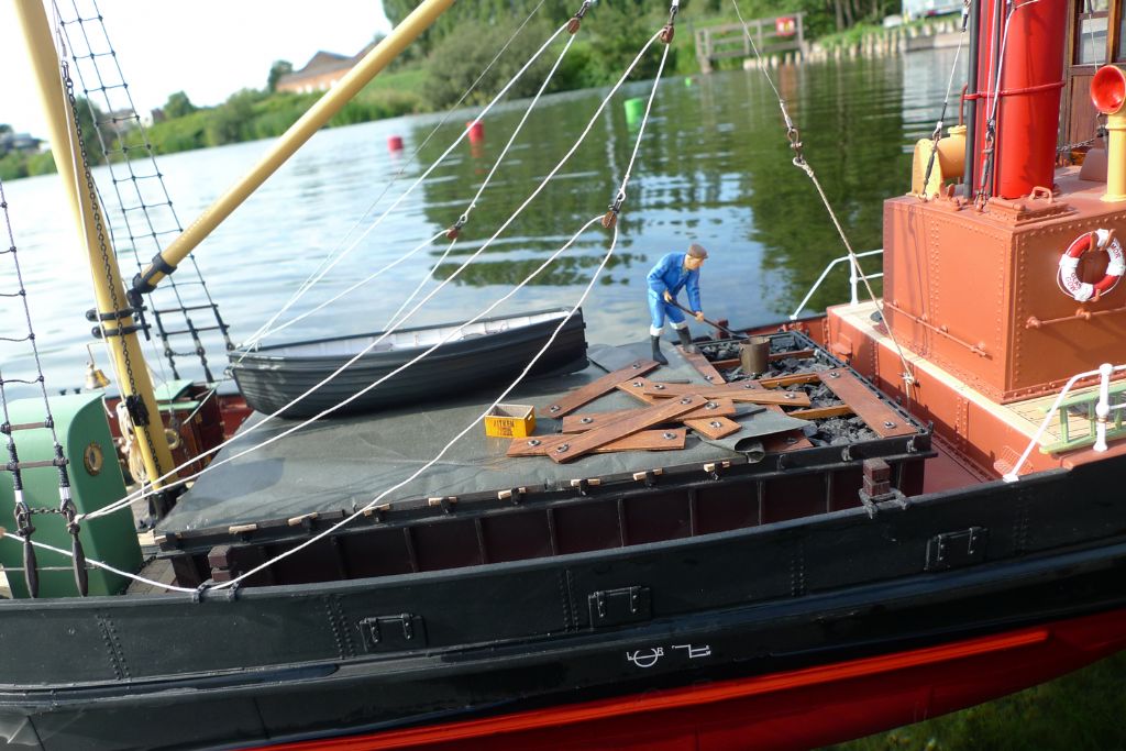

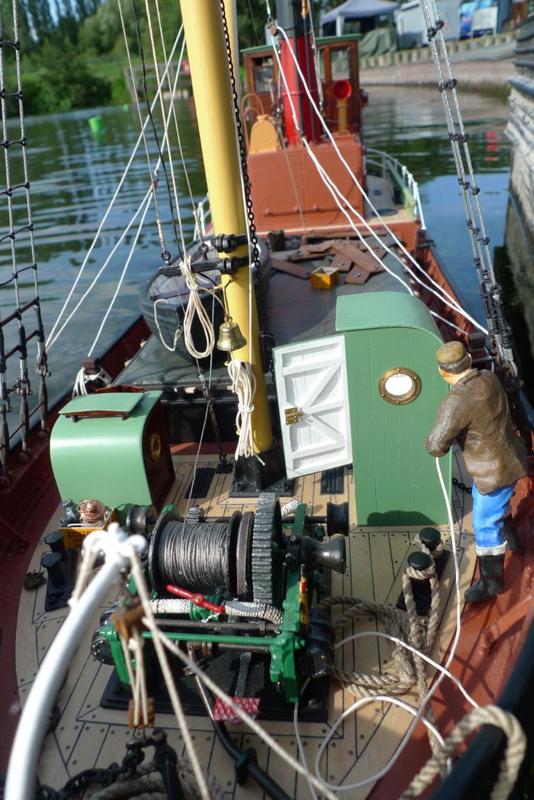

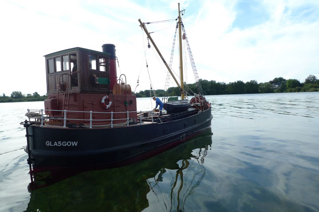

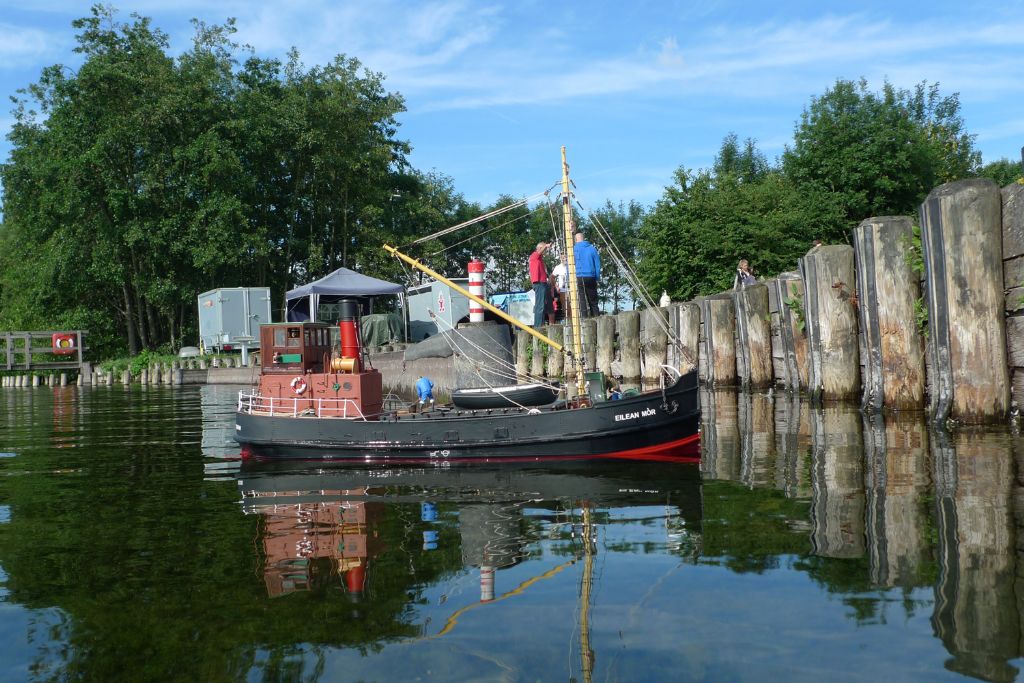

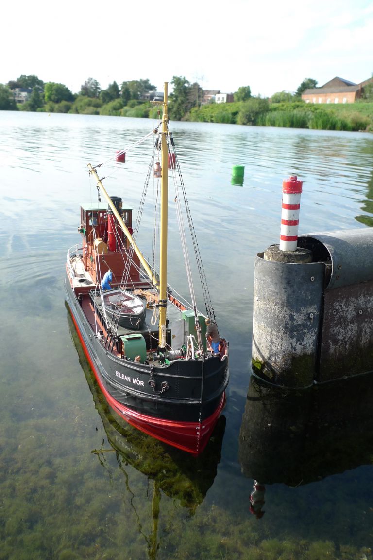

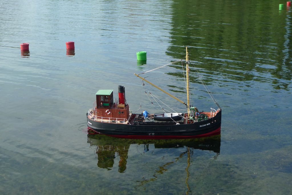

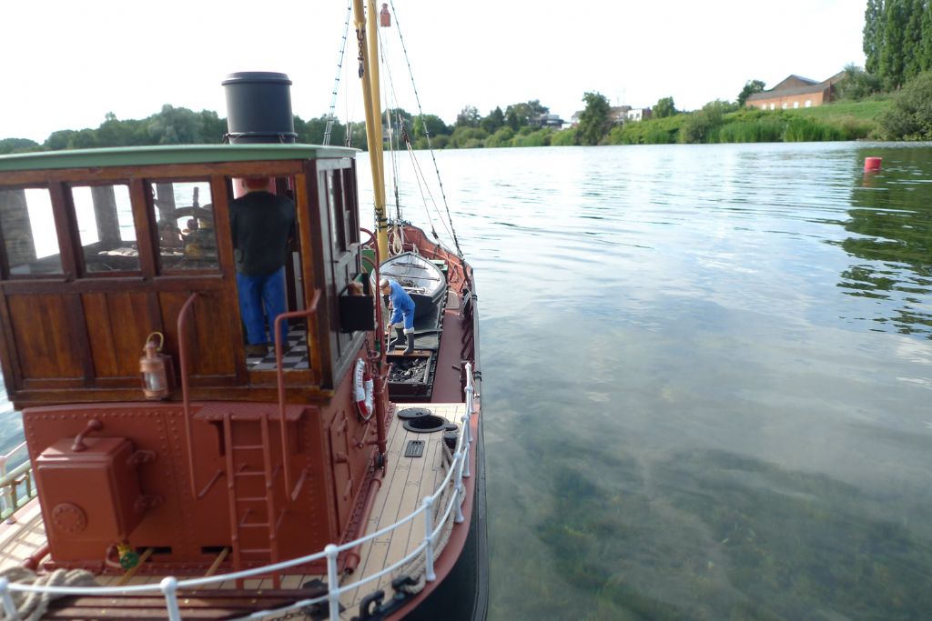

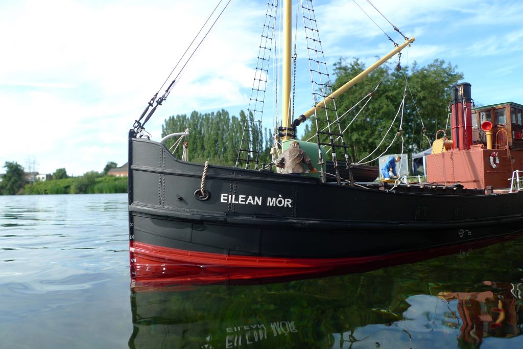

              Here, thus, are some photos of Eilean Mòr, taken at the pond (which, except for a posse of scuba divers, I had to myself) this morning:
              (time to stop briefly for coffee and a bun)
              To be continued (one final time) …

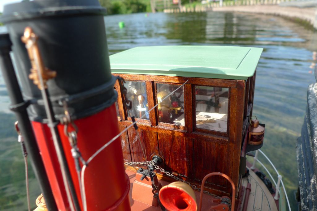

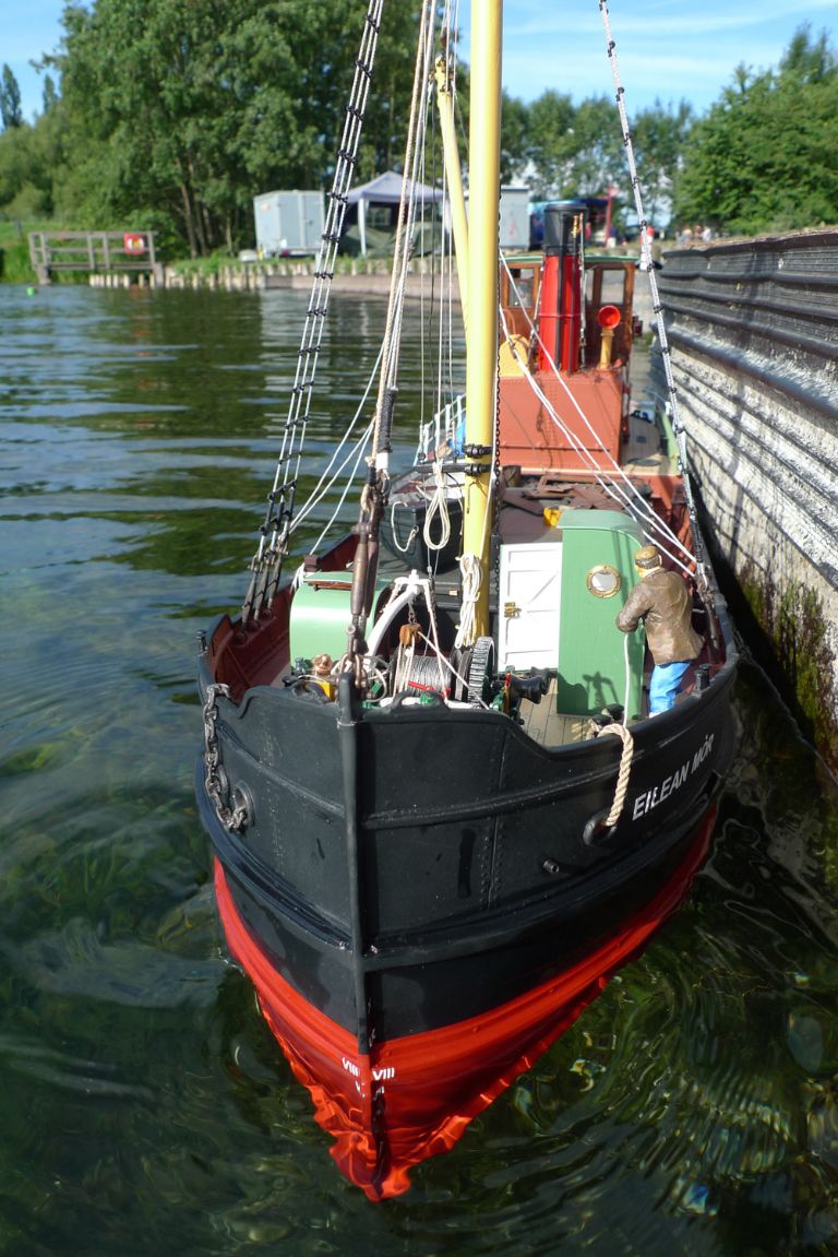

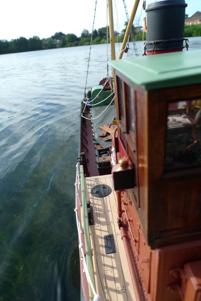

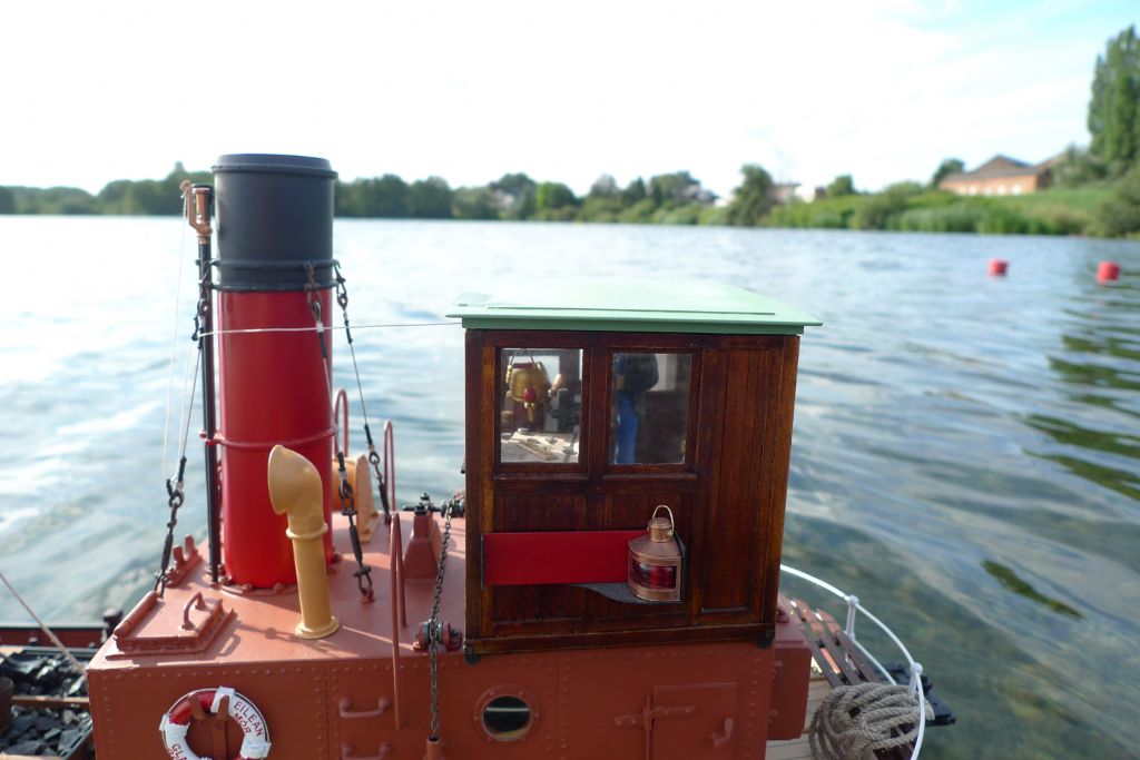

                I also shot a POV video sequence with a miniature camera attached to the shop, just forrard of the wheelhouse; it can be viewed here: **LINK**

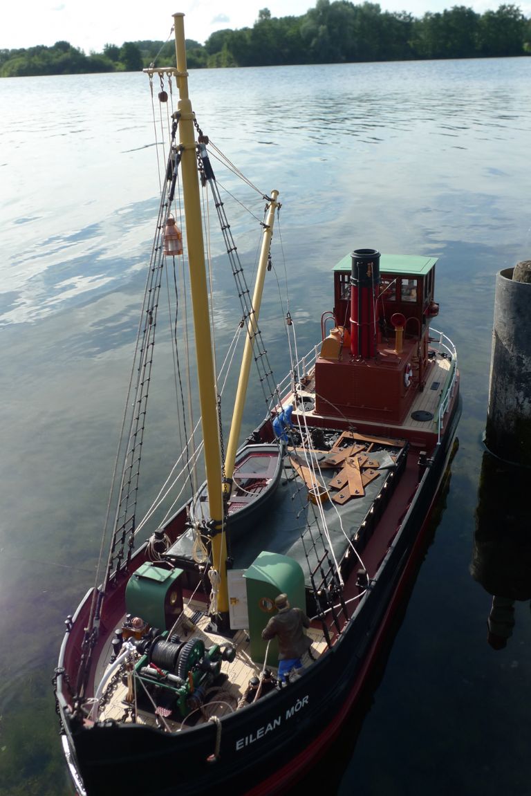

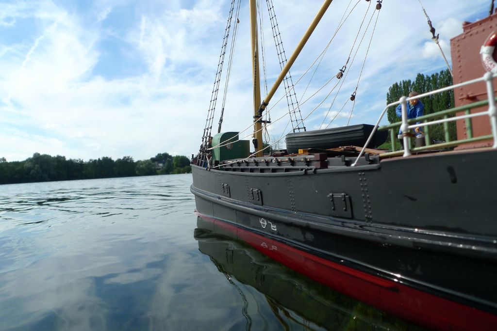

                Here, also, is the finals set of photos from this morning's sail:
                The end.

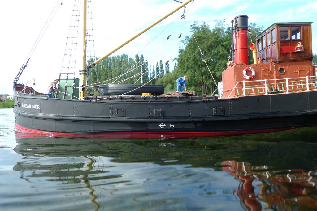

                        A few waterline shots to ponder…..
                        I suppose, a special waterproof box with a glass window, ought to be used, to protect the camera
                        Perhaps a floating box?
                        Finished with engines
                        Paddle wash
                        Sailing at New Brighton
