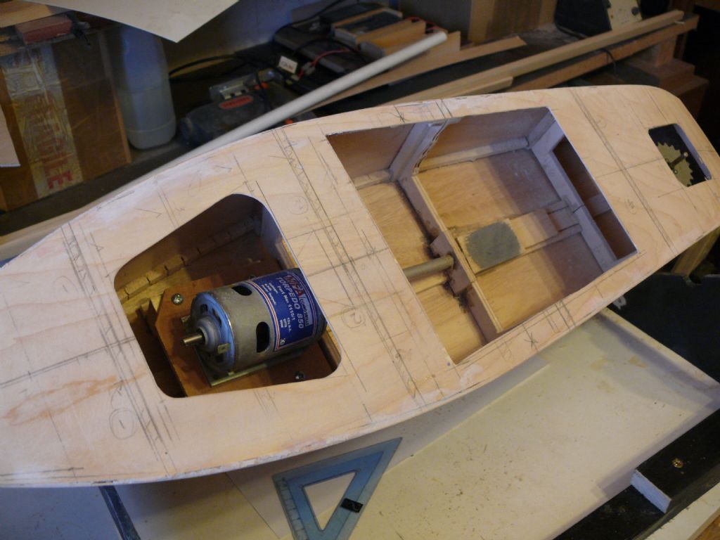

              Motor. Propshaft and Rudder in position now
              Need to squeeze in the Motor Controller, Radio Gear and battery in somewhere yet
              All good fun

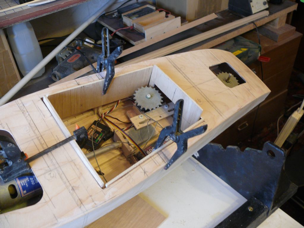

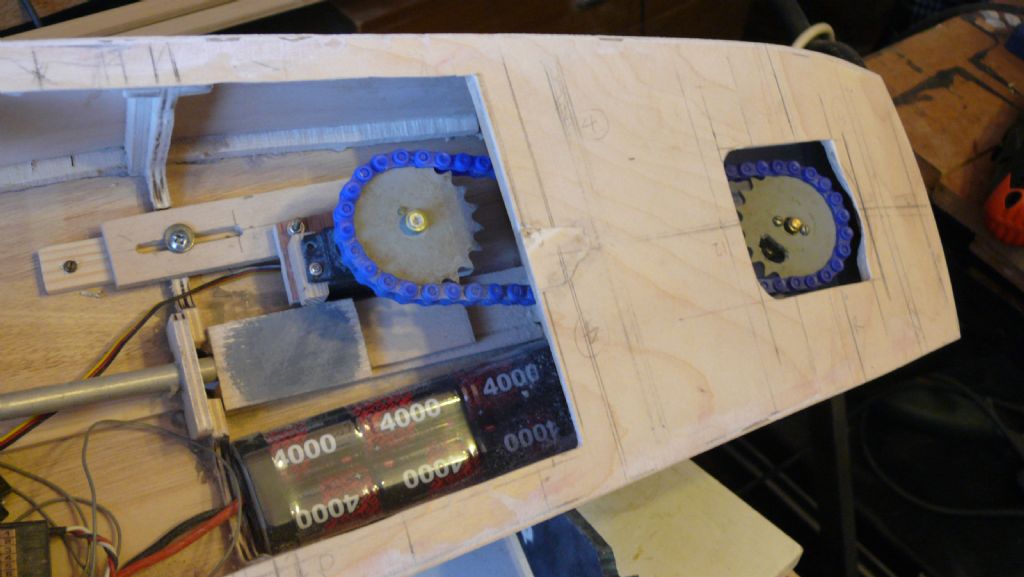

                                        My solution
                                        The rear seats will hide the sprocket

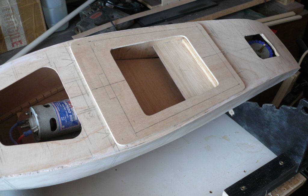

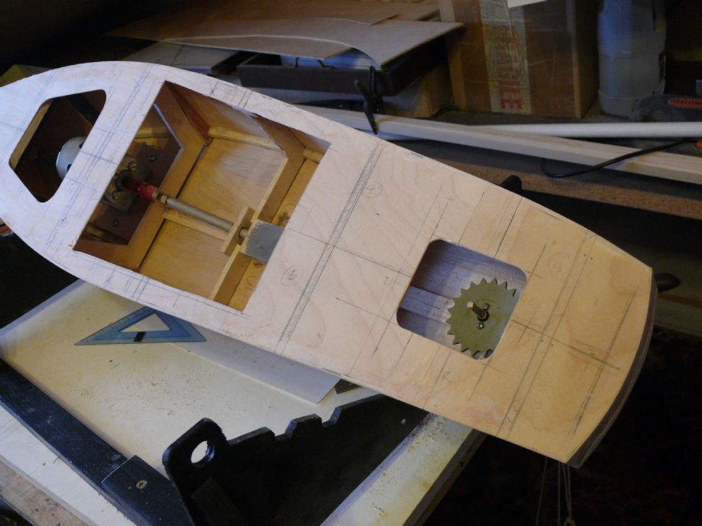

                                          Working on the crew compartment
                                          Only got room for two adults and a picnic hamper

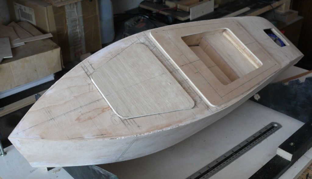

                                            Front hatch fitted
                                            Time to work on the keel section now

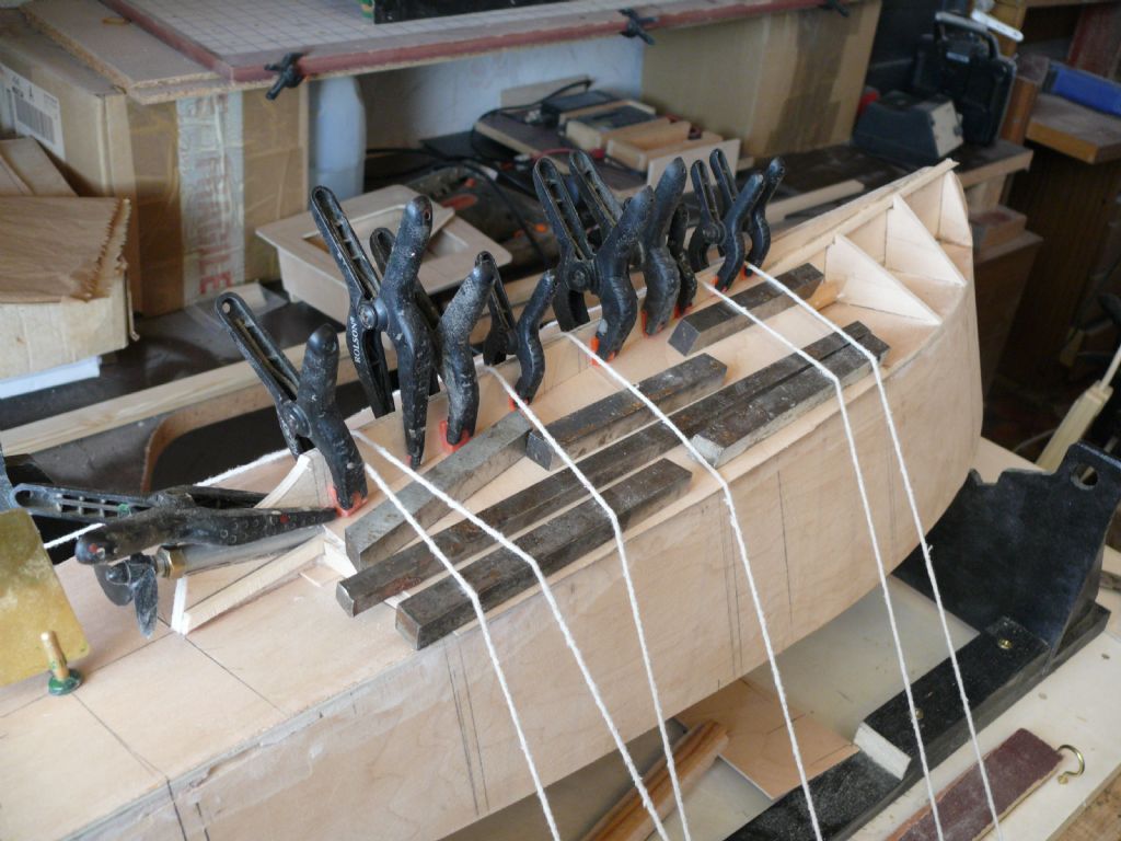

                                                  Hull construction
                                                  Sorting out the formers
                                                  A tricky area is where the sheeting moves from the keel ledge strip to the top edge of the keel, without looking like a dog`s dinner!

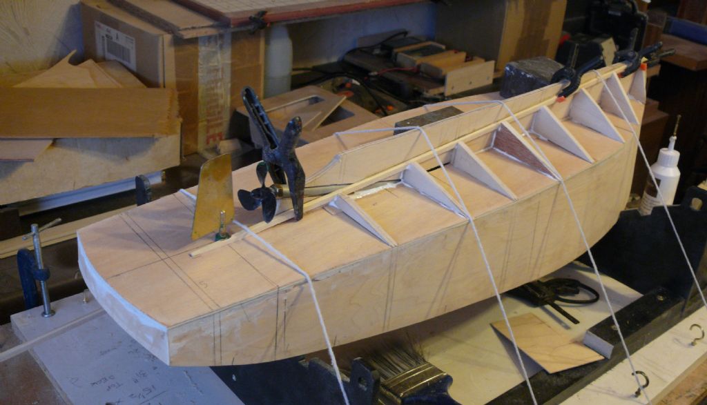

                                                  #95155
                                                    That didn`t take long!
                                                    Well, they are simple straight cuts, added a few more too

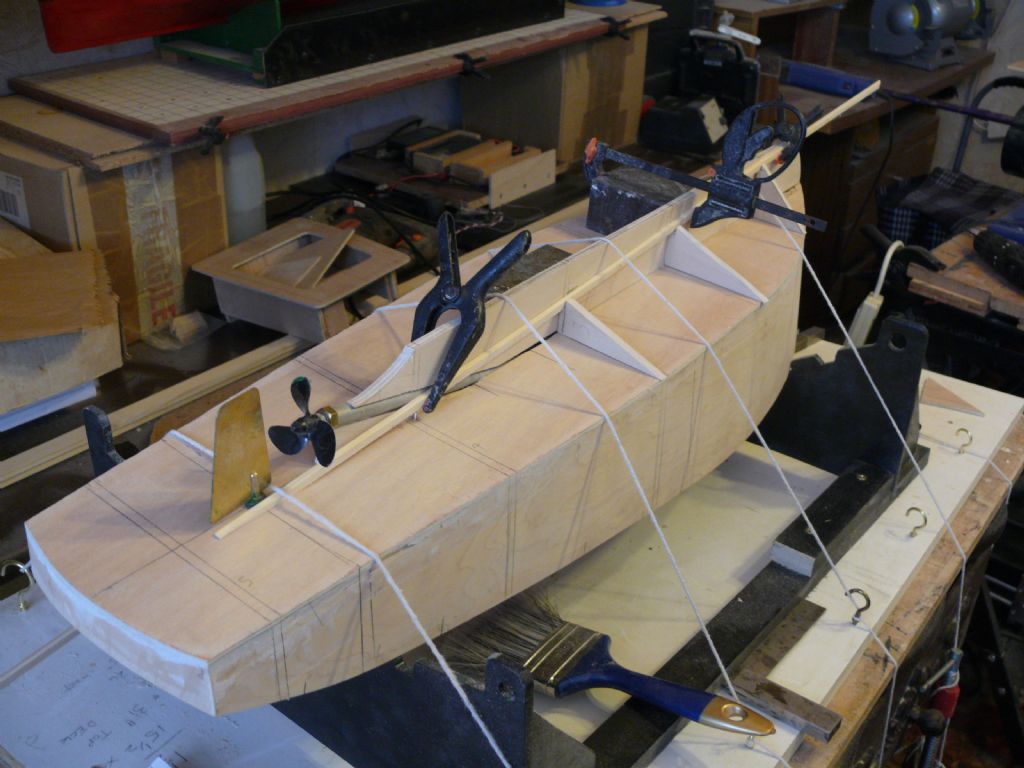

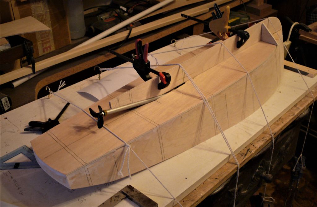

                                                      So far so good
                                                      Laid the first hull skin and it`s fits nicely
                                                      Very pleasing
                                                      The retaining strings are anchored at the back on screw hooks and pass over the model area to be clamped and a heavy weight, hangs down at the front as required. This is much better than lacky bands
                                                      Fiendishly clever, eh?
