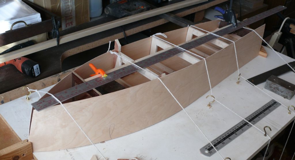

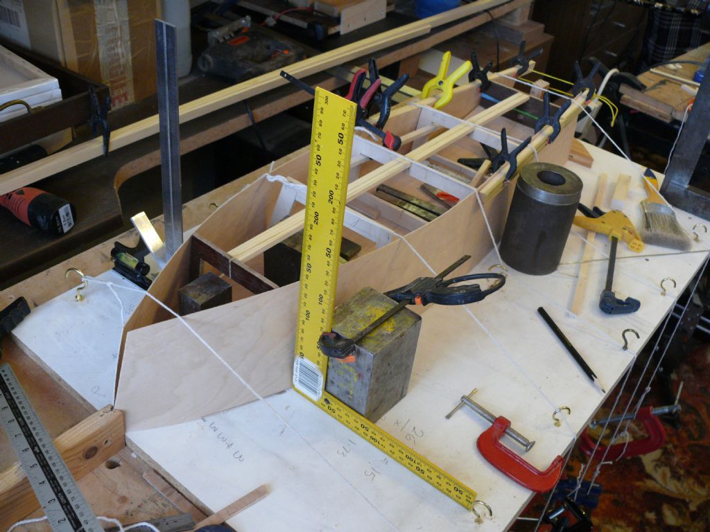

                  The search for squareness is very time consuming, but essential …….To a retired Engineer!
                  Still got a few adjustments to sort out yet
                  Old Bob

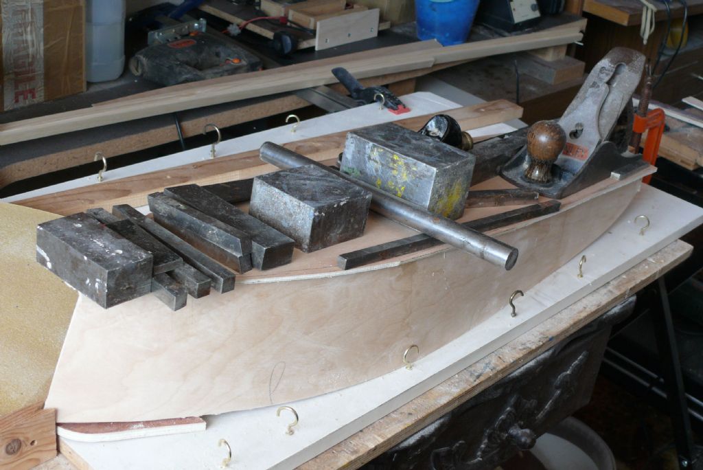

                        Nearly fully glued now and cast off the shackles!
                        Now for a close inspection and decide what to do next
                        Just been informed by the Club Webmaster that club blog has posted the link to this build
                        To demo the build for the pospective Challenge builders
                        Come on you chaps!
                        Latest state of play

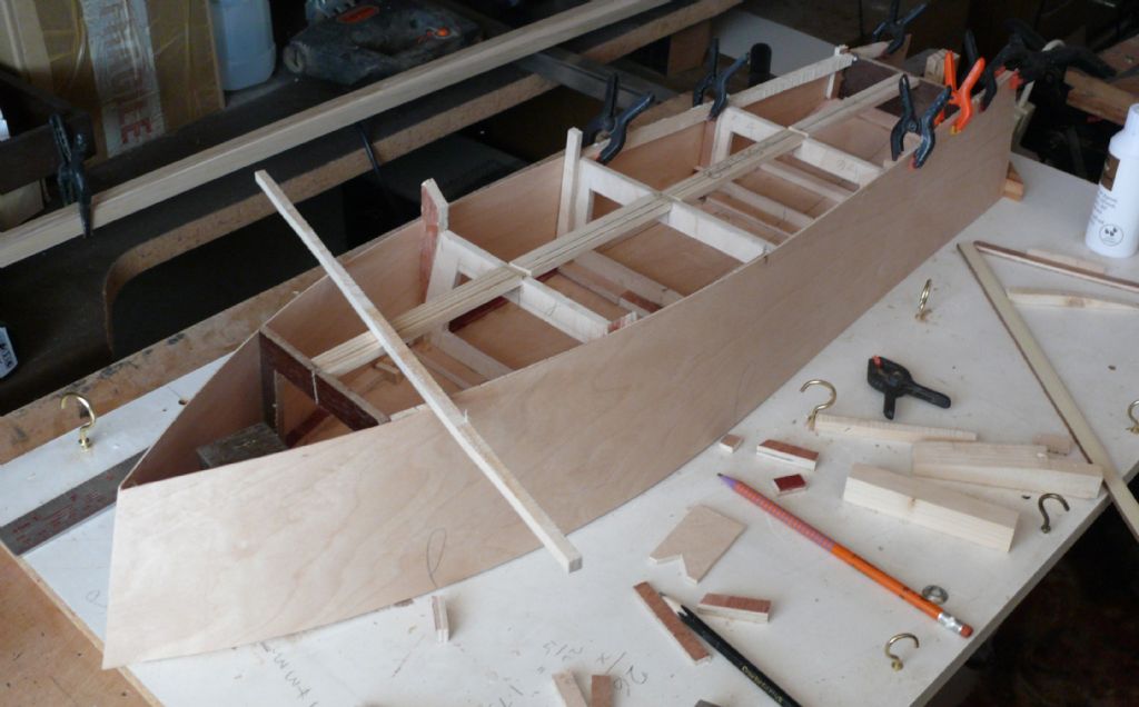

                        #94849
                          Ooops, This the correct photo

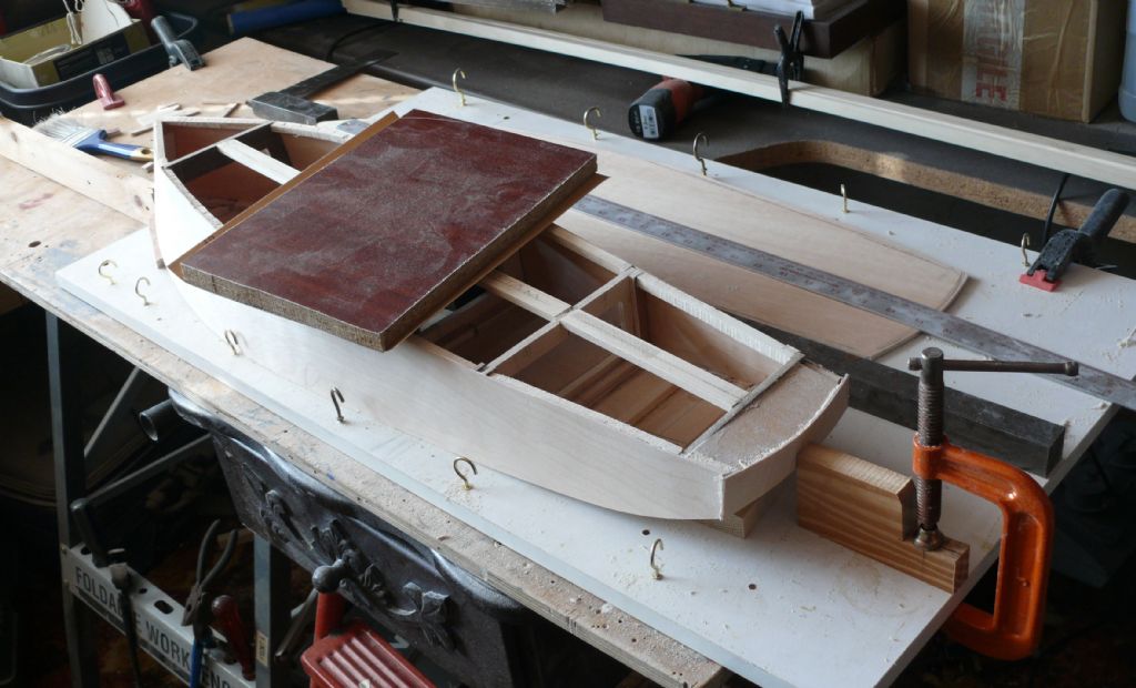

                          #94875
                            Clearing the decks now of clutter
                            Adding edge strips to accept a floor surface
                            Really enjoying the build

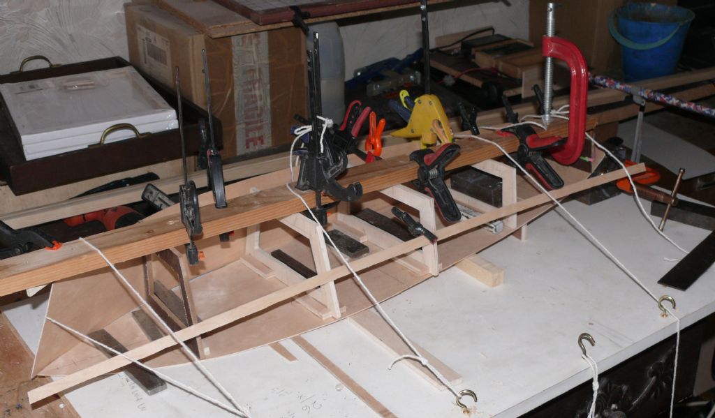

                              Ah!……The moment of truth………It`s turnover time at last
                              What a pleasure it is to sand down the overlapping edges etc and general tidy up
                              Very pleasing to see the Cygnet grow into a Swan!
                              Very pleasing part of the build

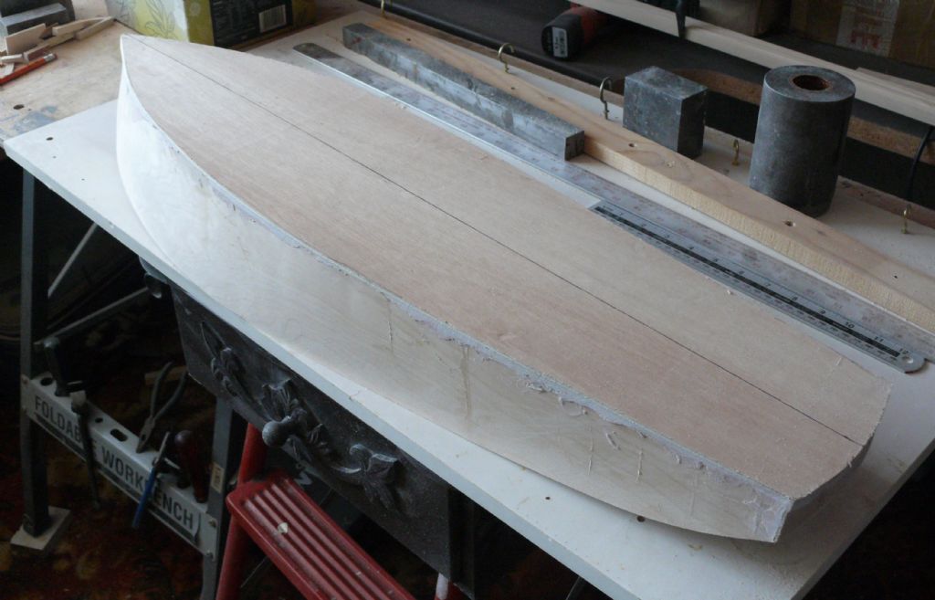

                                #94905
                                  Sanding the rough hull surface to recieve the vee hull formers
                                  The hull is secured fore `n` aft with clamps for a good solid grip
                                  Using a man sized sanding block too
                                  Very satisfying

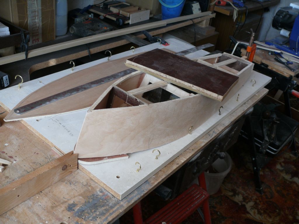

                                  #94908
                                    Just waiting for the glue to set

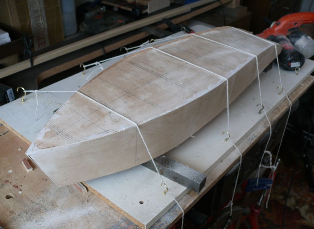

                                      #94914
                                        The sub base is almost finished
                                        Will cut out the top deck next while the hull is a stable platform to work on?….eh?
                                        Hoping to fit an MFA 850 motor inside, that should be ideal. since I`ve got two in stock already
                                        This going to be fun, fellows

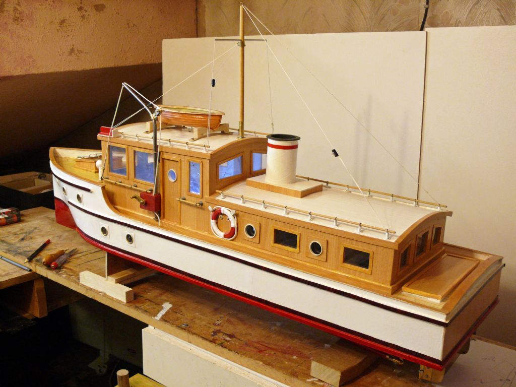

                                          #94917

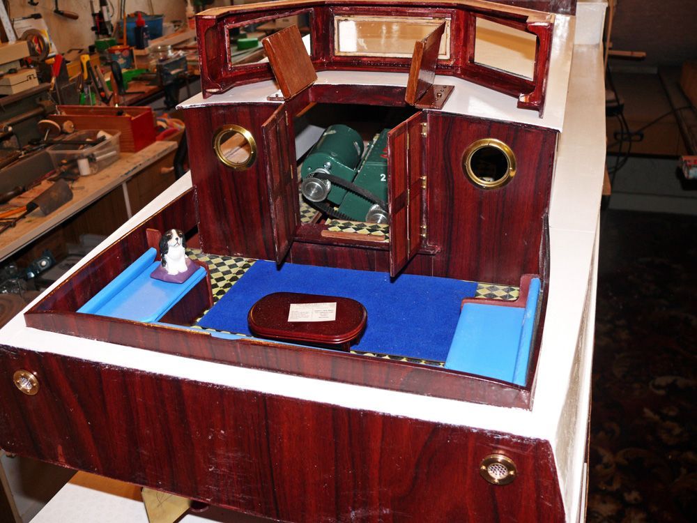

                                            Remember these two models?
                                            They both used Fablon successfully
                                            ps……I haven`t sailed the small cruiser yet!
                                            #94918
                                              I remember those Bob, and very effective, the fablon. Might be worth another go, would be much cheaper, and if varnished afterwards, would have that nice shine.

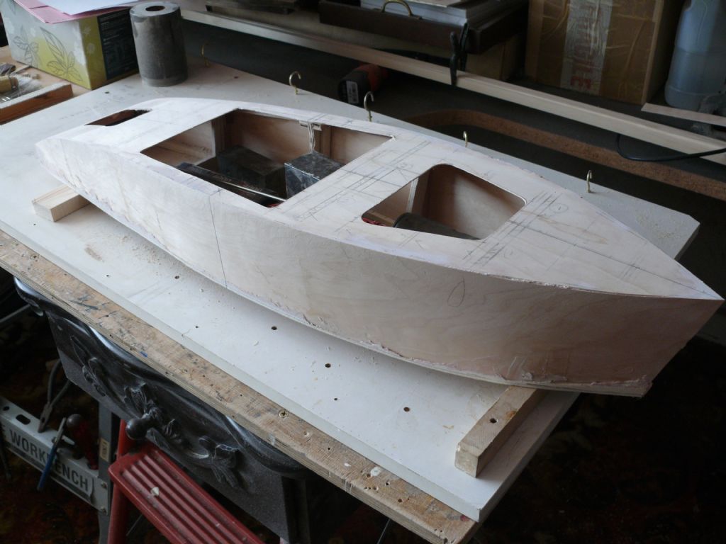

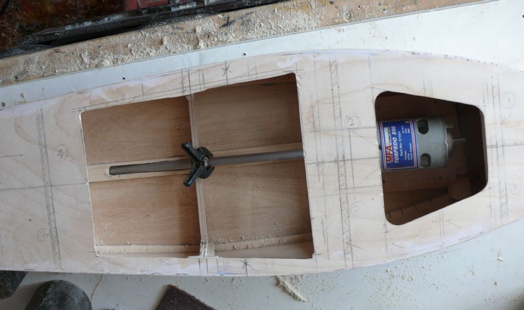

                                                Made a bold start on the main deck
                                                Cut a large hole to accommodate the seating box
                                                With further hatches for access to the motor drive, up front and a hatch at the rear for the rudder mech
                                                The MFA 850 Motor looks a nice size, in proportion with the hull length

                                                  Deck access holes sorted out
                                                  Might as well get the prop sorted out now, before the keel and vee hull are added
                                                  All good fun

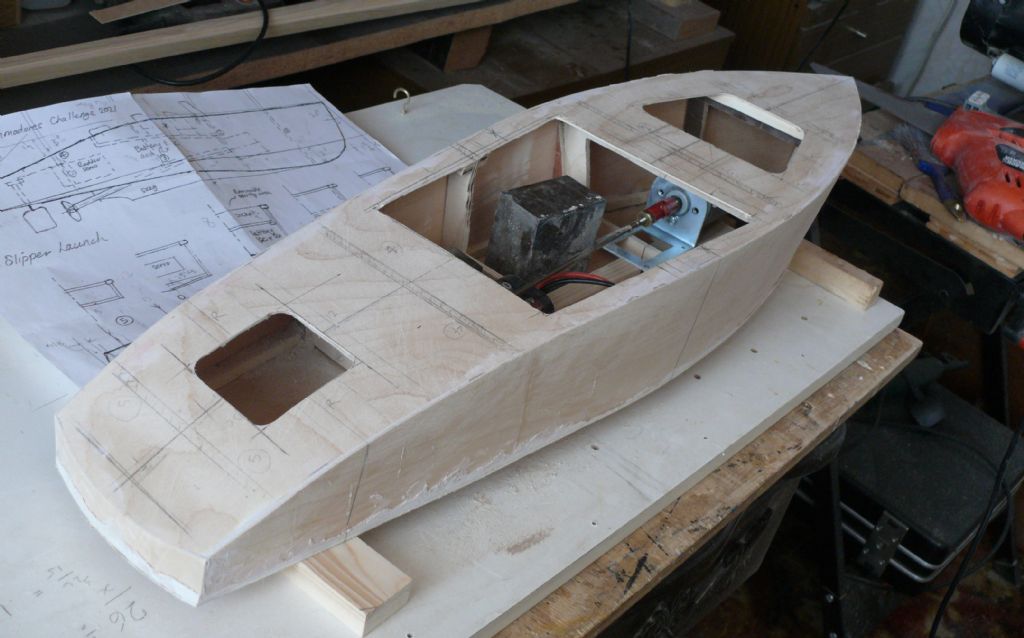

                                                  #94945
                                                    Fitted the Motor Drive and Prop Shaft roughly into position
                                                    Worked out OK
